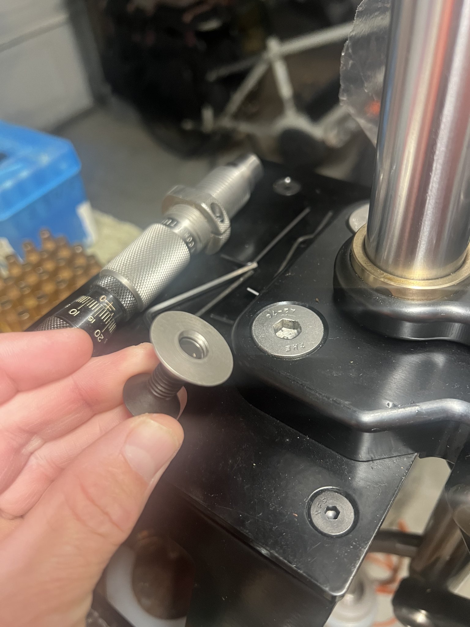

The little dinky thing in my hand in the photo is the undersized bolt with the machined makeshift nut that was sent with my in-line mount as a substitute for the proper large M12 bolt that you see beside it mounting the press for which the press was designed
It is because of the smaller diameter of the undersized bolt that the press mounts on the plate. I am not buying a $1200 press to have makeshift undersize bolts and fabricated nuts to mount it through misaligned holes.
Maybe I am just being anal attentive. To each his own.

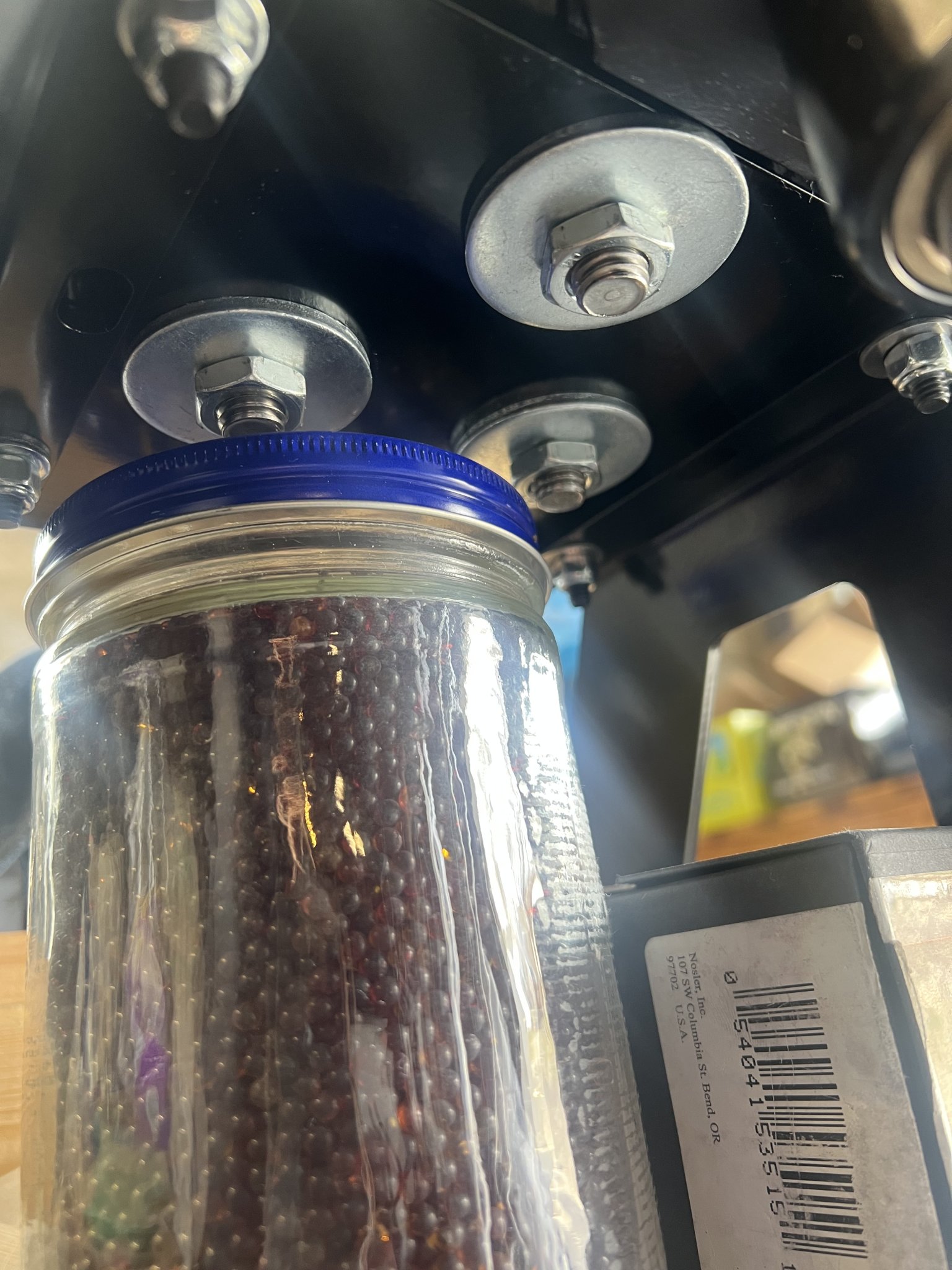

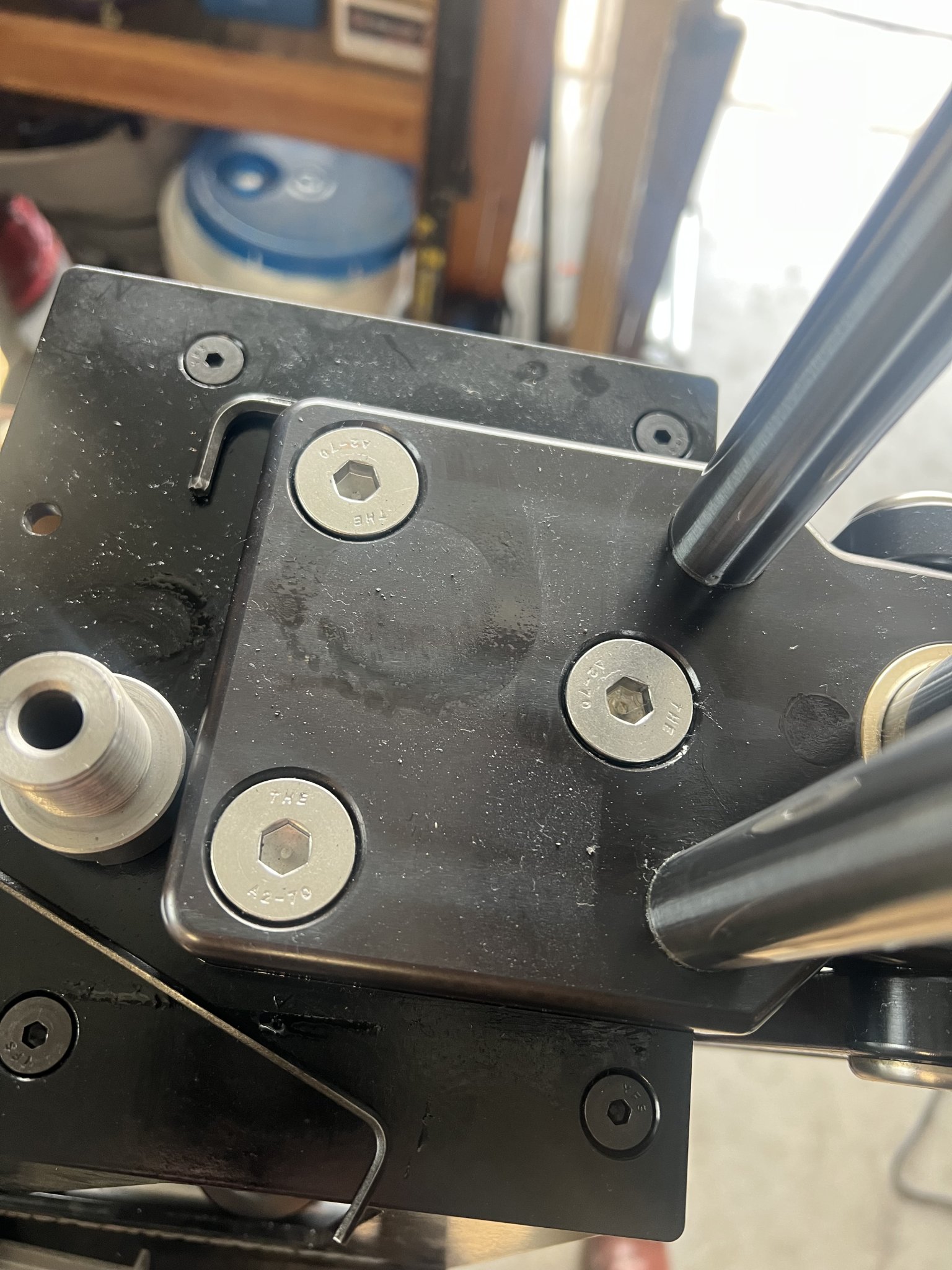

About the Inline mount and bolts… That was a bit of a challenge. For the Turban 140 there’s a 3rd bolt half underneath the ram and I had to move the bolts around to fit one that would not stick out beyond flush or the ram would hit it.
The bolts that came with the press were not threaded far enough.
That’s because those bolts are half ass makeshift workarounds
That press was intended to be mounted with a M12 bolt with the head going through from the top and then it would be flush with the base of the press with a washer and nut screwed on underneath. See my pictures above for clarification.

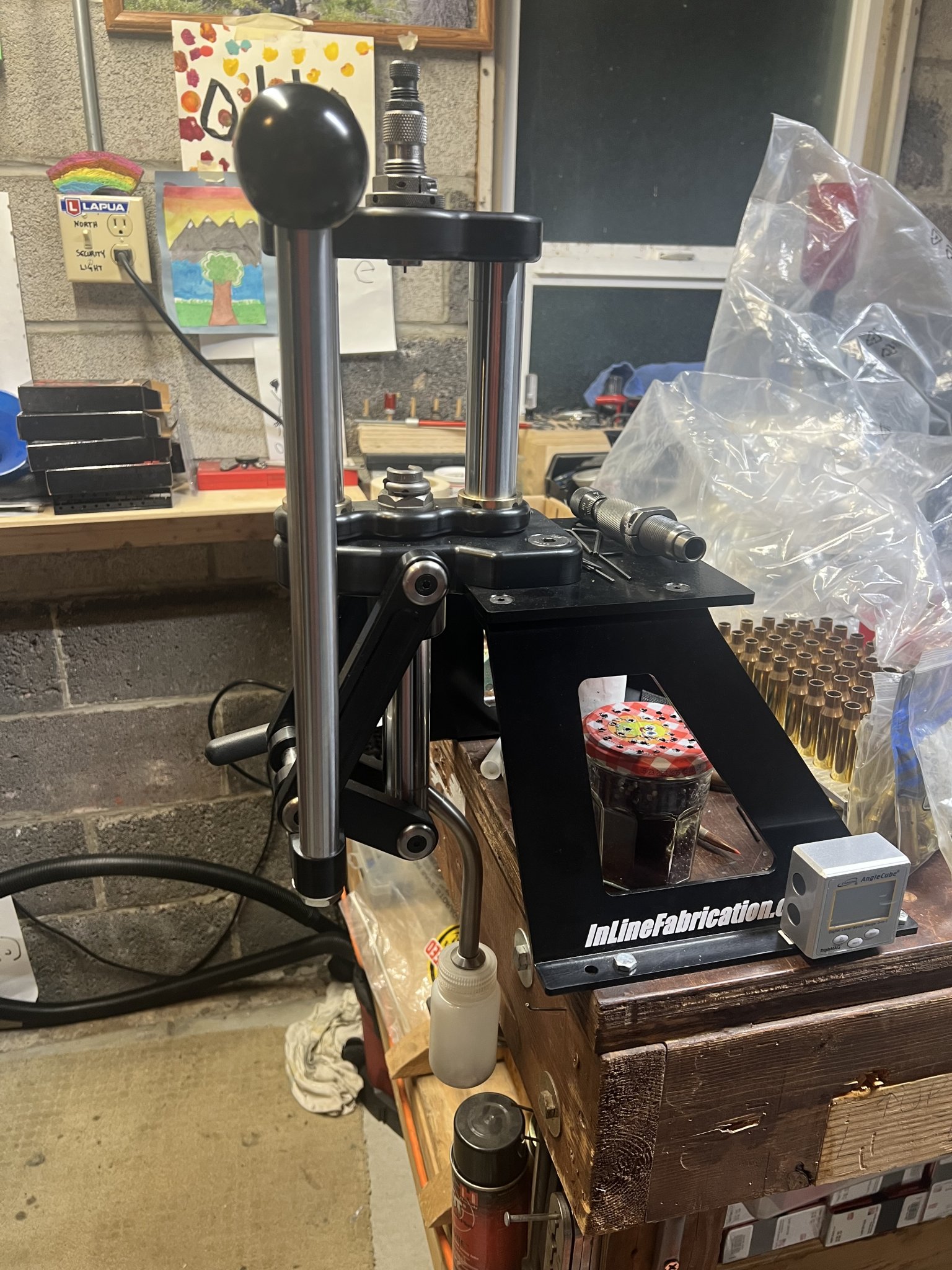

is it bolted there in that pic ? how do you like that mount location ?
I feel like mounting a/ANY press on the edge, needs counter weight on the other end. or a really really heavy bench setup.
I'm limited space...and have been thinking about where to mount.
and sounds like mounting it a little off edge might solve a absolute no bench wiggle setup.

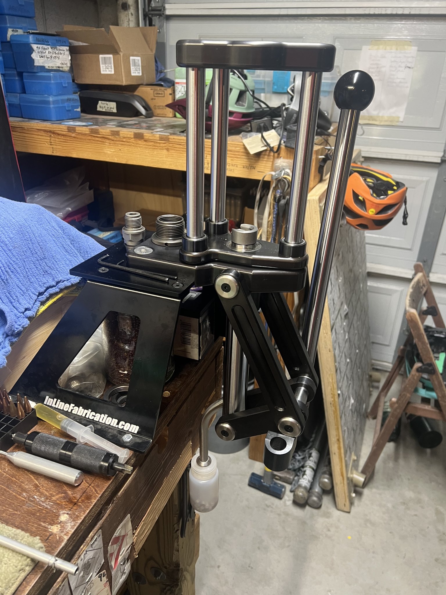

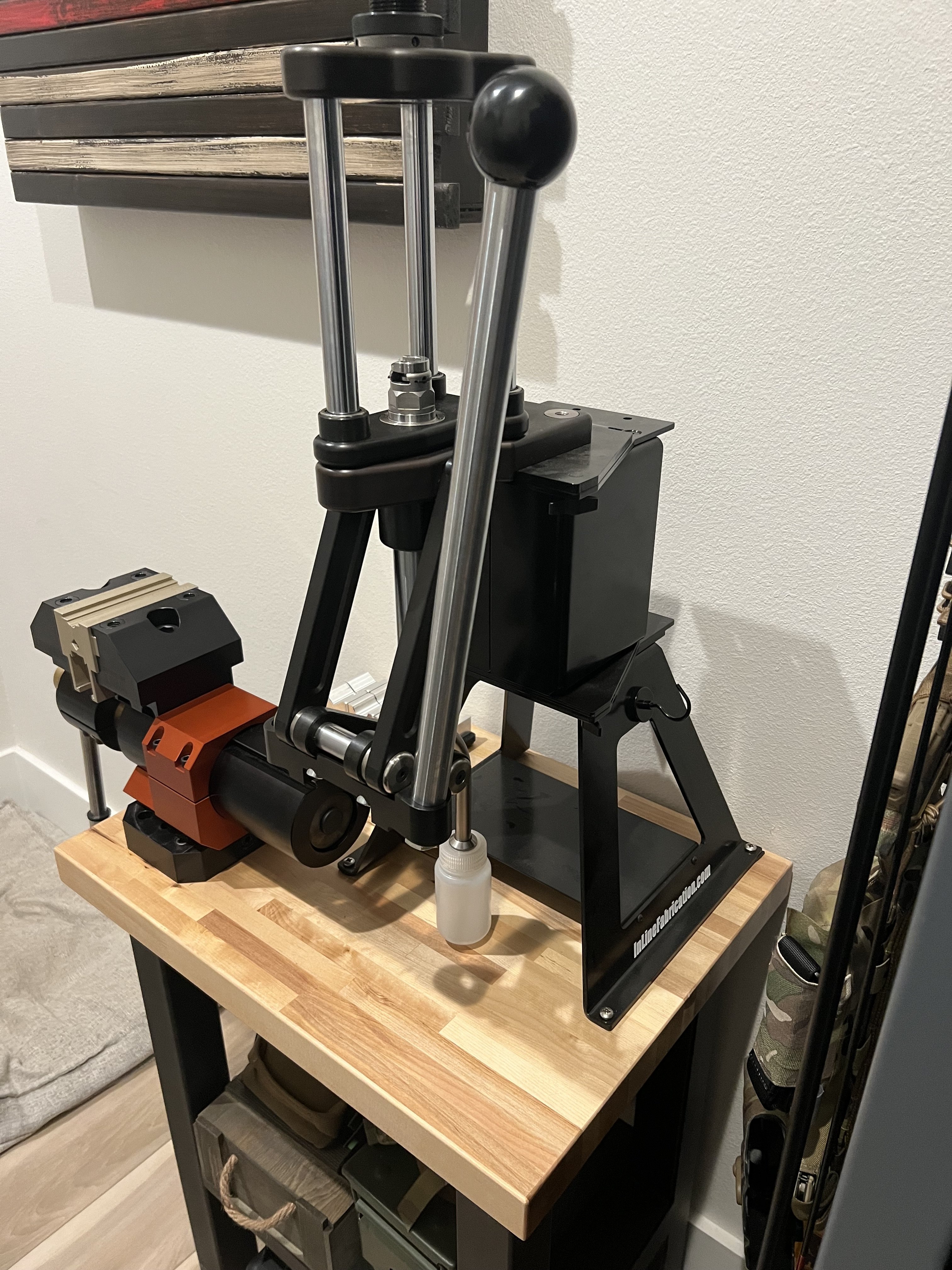

It’s bolted down in the Inline Fabrication stand. It’s mounted on a 24X24 stand/table from Uline I believe. I’ve never tipped it while resizing 375 CT brass.
Reactions: Marine52

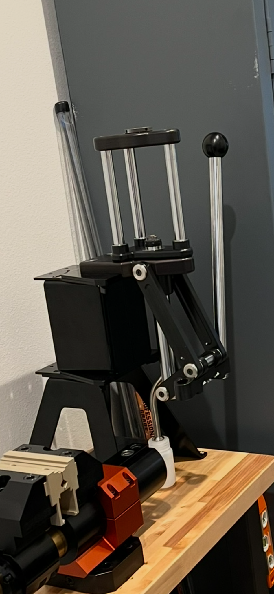

Here is the proper mounting of a PRAZIPRESS 150 with M12 bolts
View attachment 8646084View attachment 8646085

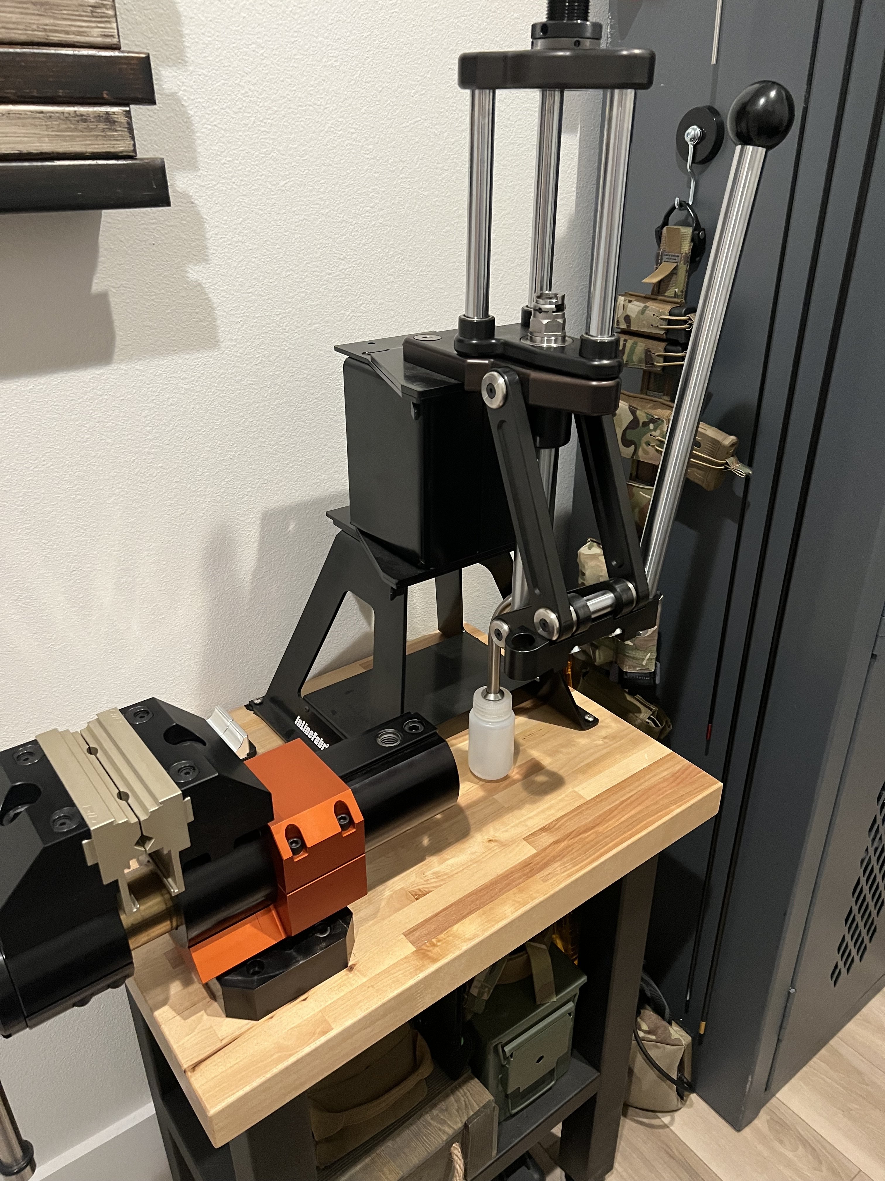

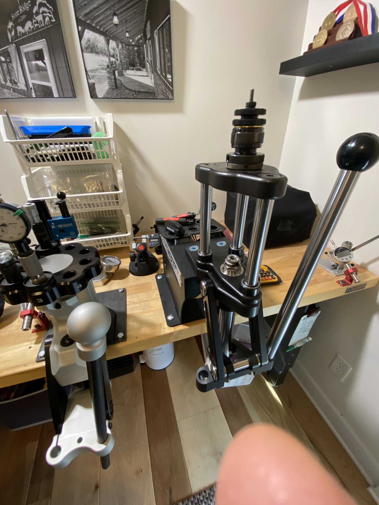

Thanks for going through the Prazi growing pains for the rest of us. My setup was easy with no complications using the Big Dog mount. One question: you mentioned some rust on bolts. Do you have the press in a high-humidity environment like a garage? I’ve had zero rust issues but I do keep a film of oil on it as you do.

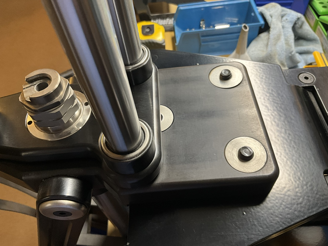

My rust is on the bolts on the top of Marine52's photo - the ones that hold the top plate to the pillars. They're not SS. I'm in a garage, but in SLC, UT, so not much humidity
I had the Big Dog mount, returned it. The holes were off. I informed him and sent him a drawing. Maybe he made modifications. I also didn't like that the tool holder was for 7/8" dies on a 1-1/2" die press, but no biggie. Glad yours worked out!!!
