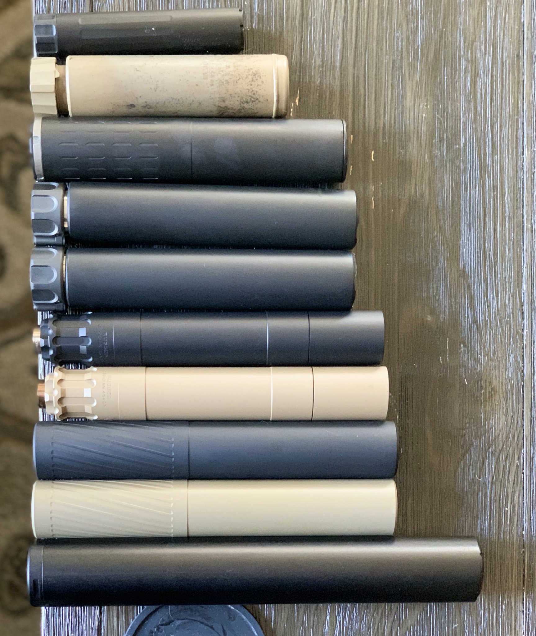

This is my "Can Case" ... literally everything in it is used on multiple rifles and pistols. I'm (obviously) not a fan for single-rifle direct-thread suppressors (except on my SC Sparrow-22). All the rifles I shoot have ASR Brakes for quick-changes. I also have a great tip for those that move suppressors around ... go to Amazon and get a cheap pair of Welding Gloves and a small Welding Blanket. The gloves make moving suppressors from rifle to rifle fast and easy, and the blanket allows the suppressor to cool "off" the rifle much faster than it would on the barrel when you want to put it back in the case and exit the range.

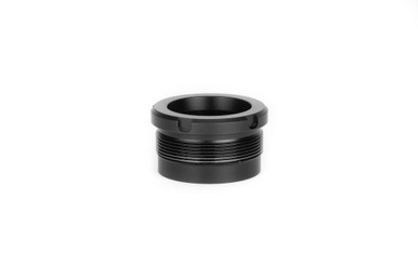

You will need an M18x1 LH direct thread adapter. And if you plan on the Dead Air Nomad series, here is the proper adapter that screws into the back of the can...
And then you need one of these in M18x1 thread pitch to screw into the can mount ^^^ to allow you to run it on your rifle...

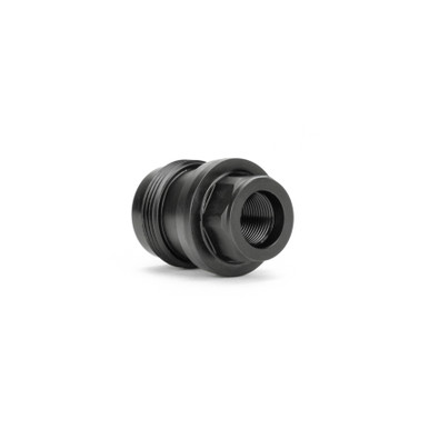

OR... There is another option... IMO, not quite as good of an option as the one listed above, but it will work.
You can buy this adapter, and just screw it directly into the 5/8x24 DT adapter that already comes with the Nomad-LT.
