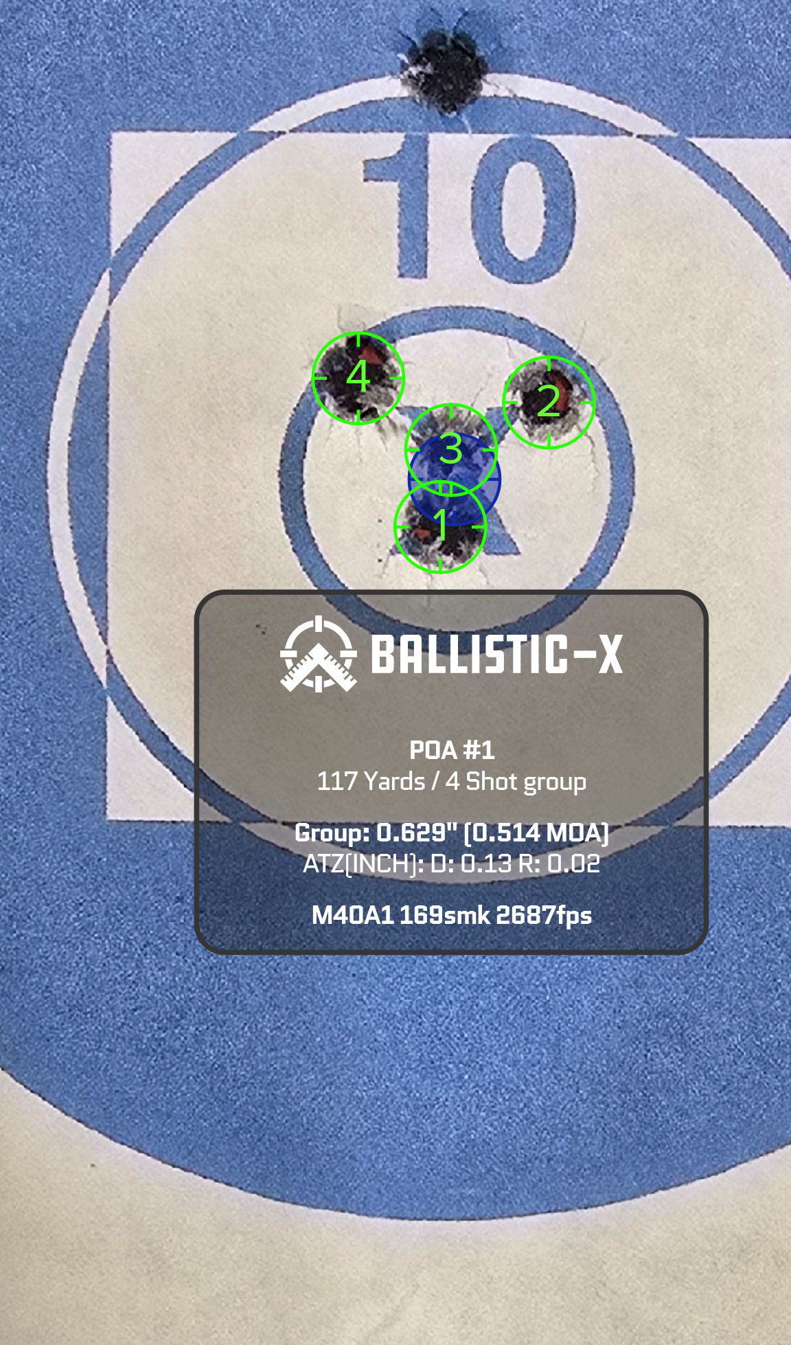

So, I shot the M40A1 today and wanted to fine tune the zero a little more as well as set the focus etc... after shooting it at my 117-yard target I then went to the steel plate at 430 yards. If I get the chance, I might be able to shoot the rifle in a vintage sniper rifle match in early Dec. out in MT. That match is shot at 300, 385 and 500 yards. So, I want to lock in the parallax/focus on the objective. Here is where it is at... but how do I lock it in without it moving on me? You can see the gap at the very front of the ring and behind the larger diameter ring.
This was my last group for getting a final zero on it at 117 yards. Yes... I was a homo on that high round. Probably too much time playing with all the adjustments and just blew it. More I think about it I didn’t blow it. I did bring the zero down on the scope with the allen wrench and locked it in. I needed about 1.5” down and tried to move it about 1 minute… I think I got it right! Only needed one windage adjustment after my bore sight job and first sighter…never touched the windage dial after that. So the scope is tracking and holding zero!
So happy with the 117 yard zero... I moved the elevation dial to 4 and initially moved the fine tune adjustment up 1 click also but knowing the 169smk have a higher bc than the old 173gr bullets and even more than 175smk... I decided to take the 1 click off the fine adjustment. On top of all that for the most part I've been having a tail wind mostly speed wise from 6-11mph. Glad I took that fine adjustment click off.
So, for 37 rounds down the barrel... I'm digging it! Average velocity is coming in at 2687fps. No need to run it any faster.

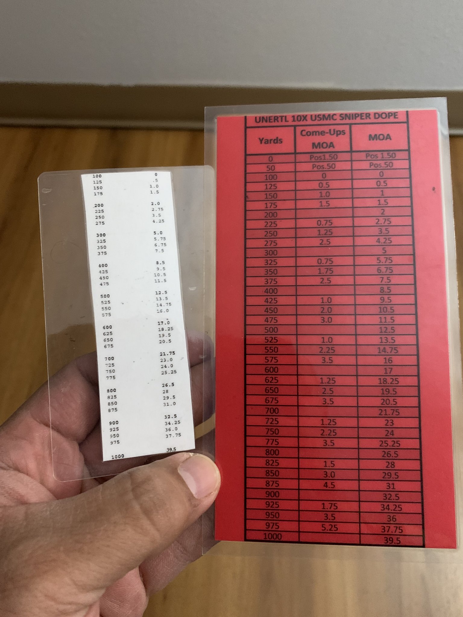

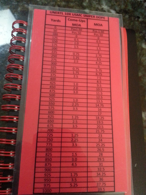

Additional Comment: Note that the come-ups listed above are for the USO MST-100. The come-ups for the Unertl MST-100 are slightly different. I’ll do some digging and see if I can a pic of them. Stand by.
Here are the come-ups for the Unertl MST-100:

I made that card years ago from a manual for my Unertl 10X. I still have it in my range bag/round count book…lol.

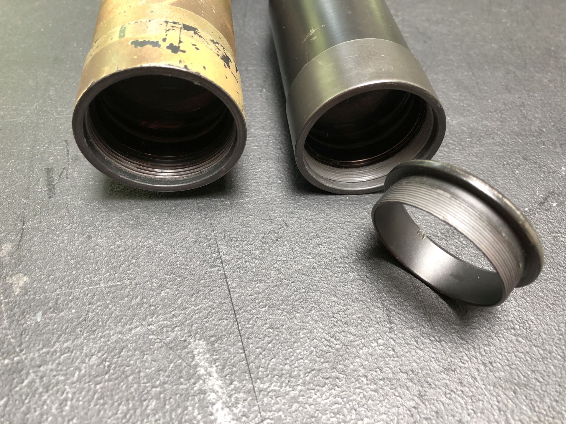

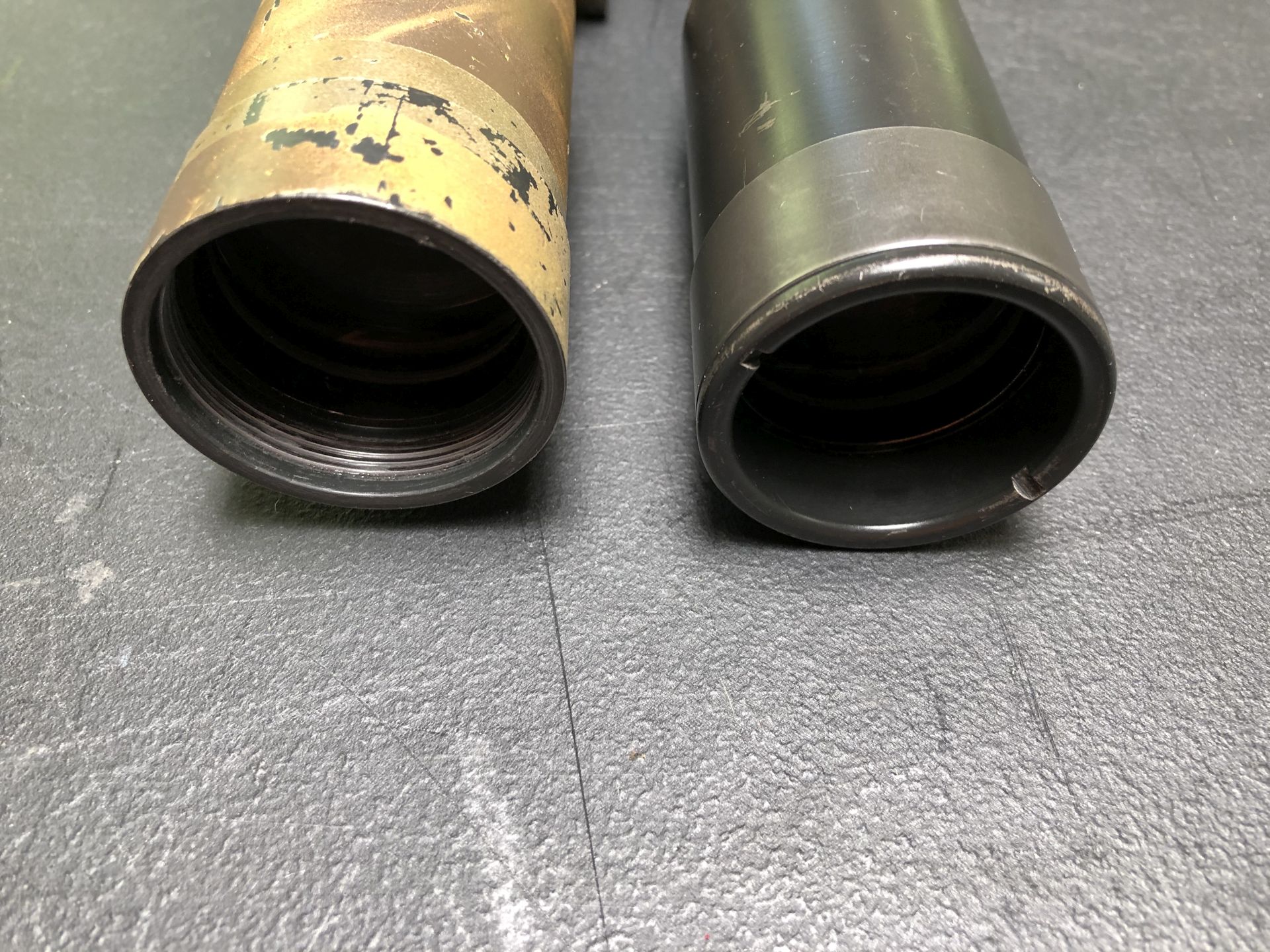

Frank, did you ever get this sorted? I have a Unertl (w/ uso mod) that I believe is giving me similar issues, if I understood your post correctly.
Problem: The objective lens cell housing that is adjusted (slid forward and backwards by the focus ring) to set the parallax does not come into contact with my locking ring when the parallax is set. So when I go to snug my locking ring down, it pulls the assembly forward and sets the parallax at something ridiculous like 5yds or so.
Note: Yes, I have set my ocular lens to where the reticle is crisp immediately upon shouldering. I have owned two other Unertl/Mst-100 and never had this issue. So I'm at a bit of a loss.
Possible Solutions: I have thought of having a spacer machined to fill the gap between the locking ring and the objective lens cell housing, which should fix the issue as it will allow the two to "lock" together without pulling the objective lens cell housing forward. I hesitate with this though, because the scope was never mounted after being rebuilt and it practically new "old stock" so surely theres not something majorly wrong, and instead some adjustments out of wack.

Both of the rings on the front of the scope are threaded and move fore/aft.
Set the parallax by turning the rear/wide collar in/out WITH THE LENS CELL PULLED AGAINST IT.
There is not a thing wrong with your scope.
Reactions: Frank Green
With the lense cell against the focus ring, the focus ring CANNOT push the cell far enough into the scope to achieve focus. I just tested this again. The only way to get the scope to achieve focus is to thread the locking ring further out, use the locking ring to push the cell further into the housing than the focus ring had the ability to do, and then tighten the locking ring to pull the cell slightly forward to fine tune the adjustment.
I will attempt to explain this another way. With the locking ring loosened, and the objective lens cell pulled out and positioned against the focus ring, the focus ring bottoms out before the picture becomes clear, setting the parallax at roughly 43yds (I realize I understated earlier, it had been a while since I tried this again).
The cell assembly has to travel further into the scope to achieve focus further out, say 300yds. Since the focus ring bottoms out and will not carry the cell further inward, how to I remedy this?
Is the ring you’re referring to as the “focus ring” spinning freely on its threads?
You should be able to completely remove the lock ring and then thread the focus ring off the scope to inspect the threads.
Yes, sorry. The patent doesn't discuss these threaded rings specifically so I've taken the terminology from other publications. When I am mentioning the "locking ring" i am referring to the outermost ring that requires a spanner wrench to remove. The "focus ring" I am referring to is the second threaded ring that is wider and located behind the locking ring. I have removed both and inspected threads and see nothing of concern. Threading them on and off is smooth with no rough patches. The focus ring is not free spinning, when I say it "bottoms out" I mean that the focus ring has threaded all the way on to the objective housing and come to a stop.
I’m concerned it’s been “worked on” by CMP, or CST, and incorrectly assembled.
If you’re sure the ledge on the inside of the focus ring is butting against the end of the scope body, you won’t be able to lock the lens cell any farther rearward. In that case, I suppose the objective lenses could be installed in their cell incorrectly, but I think image quality would be terrible.
Can you achieve a nice, clear, parallax free image by pushing the lens cell in the way you have been?
Yes, if I push the cell slightly further into the objective housing, I can achieve a clear parallax free image at 300yds. I was contemplating the spacer Idea but after further review it doesn't seem feasible. Other than messing with the objective cell assembly, the only way I can see to fix it would be measuring how far the cell recesses in the objective housing when it is parallax free and taking X amount of material off of the end of objective housing, somewhere between 0.020"-0.040"
It is possible the scope tube is not completely screwed into the turret….
Where on the objective bell is the dimple located? I mean the small dimple that engages the obj lens cell. It will look like a small rectangular dent.
The dimple is right about at the 6 o’clock position, maybe a few degrees off.
The scope just came back from ironsite, for repair on this exact issue. He’s repaired two other scopes for me in the past and they were great, so I’m not trying to knock his work at all. But when I got the shipping notice I called and tried to talk to Mike but he was busy with a project. I called again today but he’s going to be out for a few weeks. So I’m investigating fixing myself.
Your description makes me think that something could be assembled wrong. I don't know how that would be possible though.
The best thing to do would be to compare it to another Unertl and see what is going on. Some pictures might help.
Oh, so it has been worked on…
The objective lenses are specific in their position and orientation within the cell. Were they removed for cleaning?
Without knowing exactly what was done with the scope, we’re all just guessing.
Update, scope functions properly now as far as I can tell. Under better lighting magnification it appears the cell was flush with the objective housing when parallax free at 300yds. Also under magnification it appear the focus ring was coming to a stop just short of contact with the objective tube itself. After cleaning the threads and applying some fresh antiseize, it now sits all the way flush to the scope. I apologize, with the antiseize/grease on all the components these tiny differences (a few thousandths of an inch) were hard to tell and I incorrectly read them. Scope now locks the objective cell firmly against the focus ring properly and presents the proper parallax free image at desired range. Thank you @Skunk for helping me work through this.
