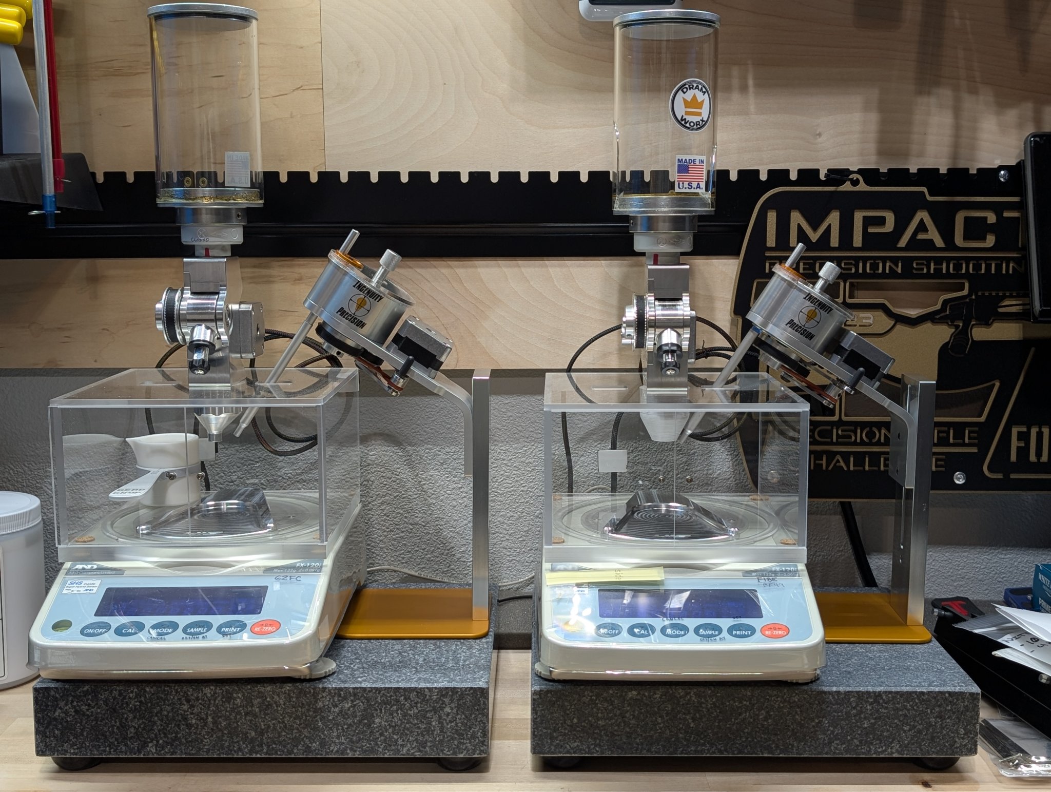

You will like it. Great quality. Here is my IP setup with them.
He's also a member here @justdreaminglr
Nice!
Fortunately for you, you were able to purchase V3s and oair em with IP tricklers.
I have to oair my V4 with an IP trickler…we’ll see how that works.

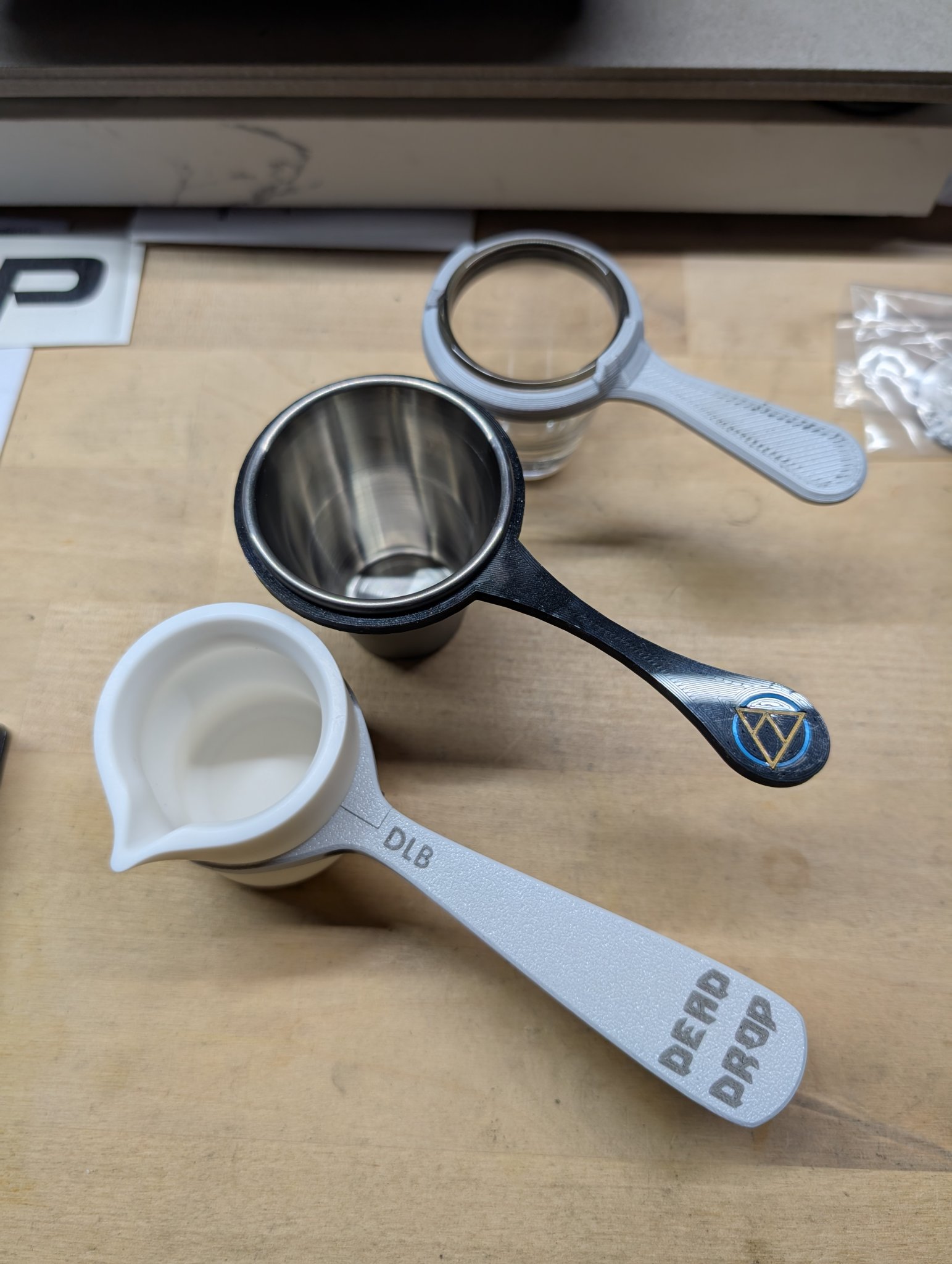

Questions;
1. Is that an IP powder cup you’re using?
2. If not, which cup is that? Does it significantly cut down on powder spills? Where dis you purchase it? Ebay?
3. Did you also need to buy a new/different nozzle to pair with the cup?
Nice! I have the exact same V3 AutoThrow/IP setup on my FX120i with the factory windscreen with Area419 top and I have no complaints. Runs great..

Questions;
Stock or area419 nozzle works fine. Zero kernel bounce.

The Ingenuity Precision trickler is amazing.
You can just buy an A&D FX120i (if you don’t already have one), ~$100 in parts, and the IP tricker and drop the bulk charge manually if you want until the automated bulk drop system is out. That’s how I do it and I love it, I probably won’t even get the automated bulk drop system since I love how simple and bonehead-proof my setup is.
Even dropping the bulk charges manually, powder for 100rds takes less than 10 minutes (including getting the powder in the hopper and then putting it back in the jug). No headaches, no over’s… ever.
