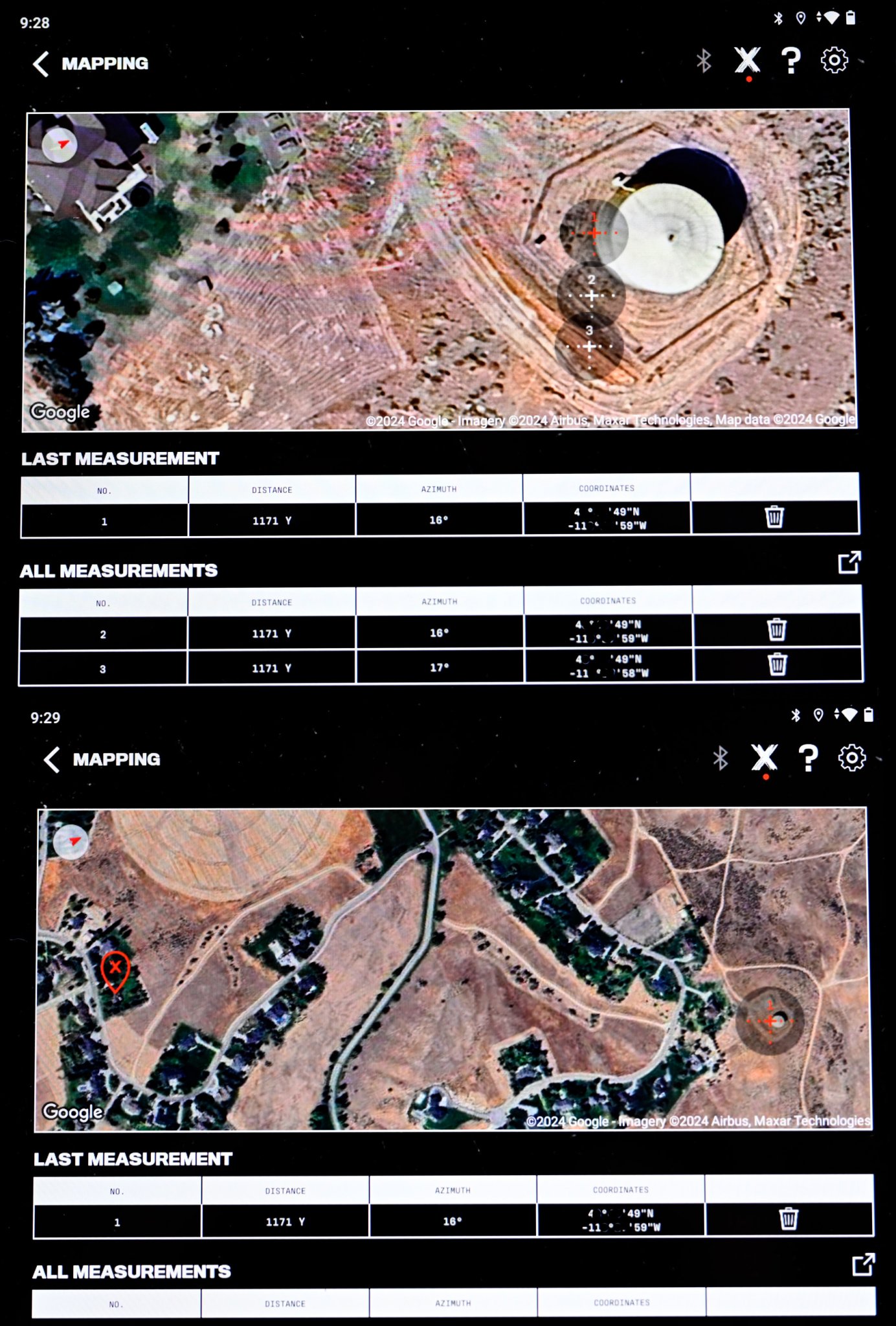

The Vector X bino/rangefinder has an app from Vectronix: VECSS. Oddly the Google Play store said it wasn't compatible with my Android phone or tablet, although it only requires Android version 9. I was able to download the app as an APK file and sideload it onto both devices. The device is remarkably capable and sophisticated, although as engineers are wont to do, the documentation does not begin to explain or explore these capabilities. The device has an internal compass and displays the target azimuth. Happily, in the Settings you can adjust for your magnetic declination (not mentioned in the PDF manual). The app makes it easier to set up and utilize rifle/ammo profiles but also has a mapping capability.
The mapping capability is remarkable, although I haven't quite figured out what I'll use this for! I paired the Vector X with a Lenovo tablet that I use for shooting apps (bigger screen and easier to read in the field without my #*&^$ reading glasses). You open the VECSS app, pair the Vector X with the device, and open Mapping. The app reads the rangefinding info, likely uses its internal GPS chip to find your location, then shows the location of your ranged target using the distance and compass azimuth.
Although my location should require 12.9 East, I had to fiddle with this a bit. There is a water storage tank for my neighborhood about 1200 yards distant. I set up the Vector X on a tripod and ranged this several times and found that using 7.3 East put me on the center of the tank. Maybe the magnetic pole is wandering, might be some metallic interference from the tripod, who knows? The Vector X displays a "chicken" in the display when it wants the internal compass recalibrated, and that seems to happen fairly often. Not important unless you need the azimuth for something like this.
The VECSS app works like most smartphone apps, so you can zoom in and out on the display and also rotate it to fit your shooting location and the target into a landscape display. You can do this with multiple different targets and it will mark each on the map display and show the ranging information in the table below. Being an old guy who grew up with paper maps, this is amazing technology.

That took a bit of research. For starters, the VECSS app's documentation is essentially nothing. The app seems to default to Google Maps, which works well. The sparse "help" says that one can choose between BaseMap, Google Maps, OnX Hunt, and civTAC (plug-in needed). However, I cannot find any option in Settings to choose the mapping app.
civTAC appears to be the de-mil version of ATAK so there must be some capability. I tried download it onto my tablet and civTAC worked. However, VECSS didn't seem to recognize it was there, still used Google Maps, and I could find no option for changing to civTAC. That capability may exist but is well hidden. I admire the engineering genius of Vector X and VECSS, but their documentation is abysmal.
I did note that VECSS will allow one to share this mapping "range card" by email and other means. The civTAC app asked for more permissions and more permanent permissions than any other app I've encountered. Google Maps is not nearly as intrusive, and I think I'll happily continue to use it instead.
