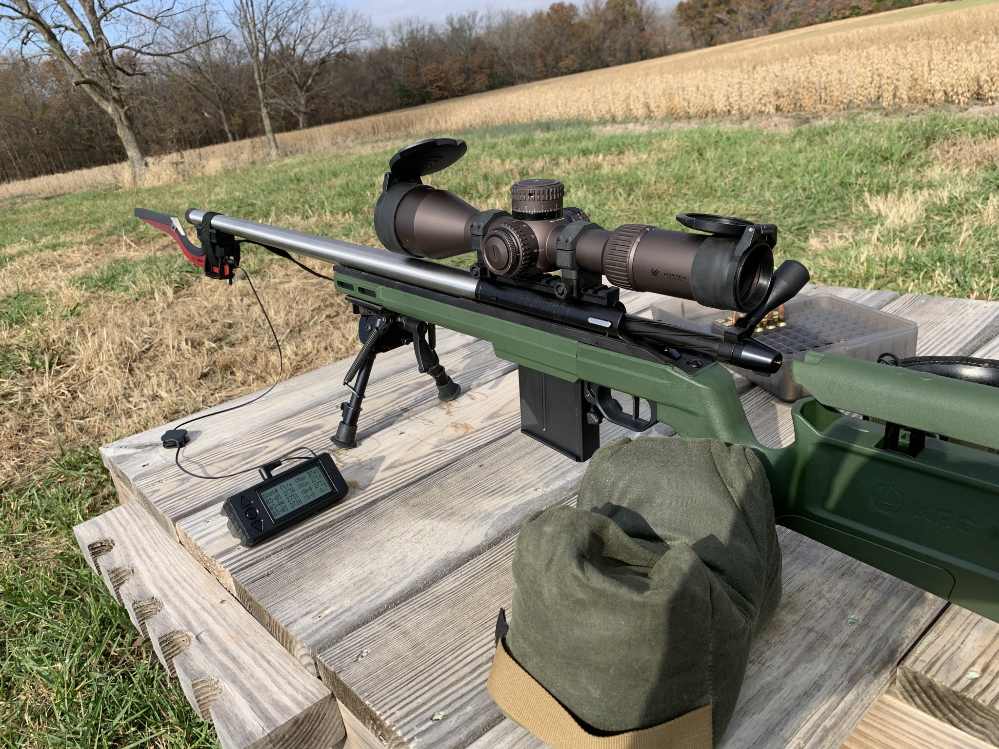

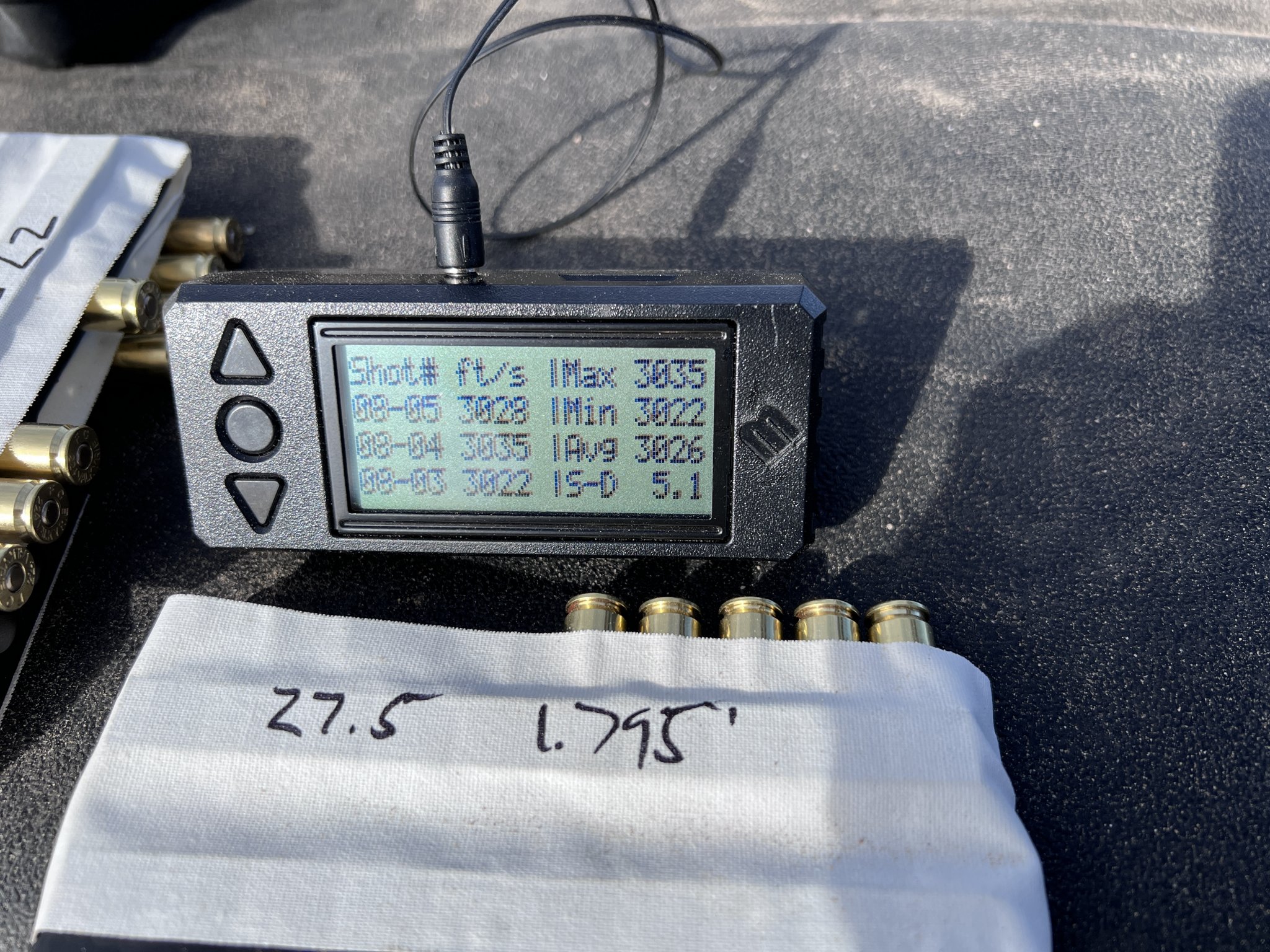

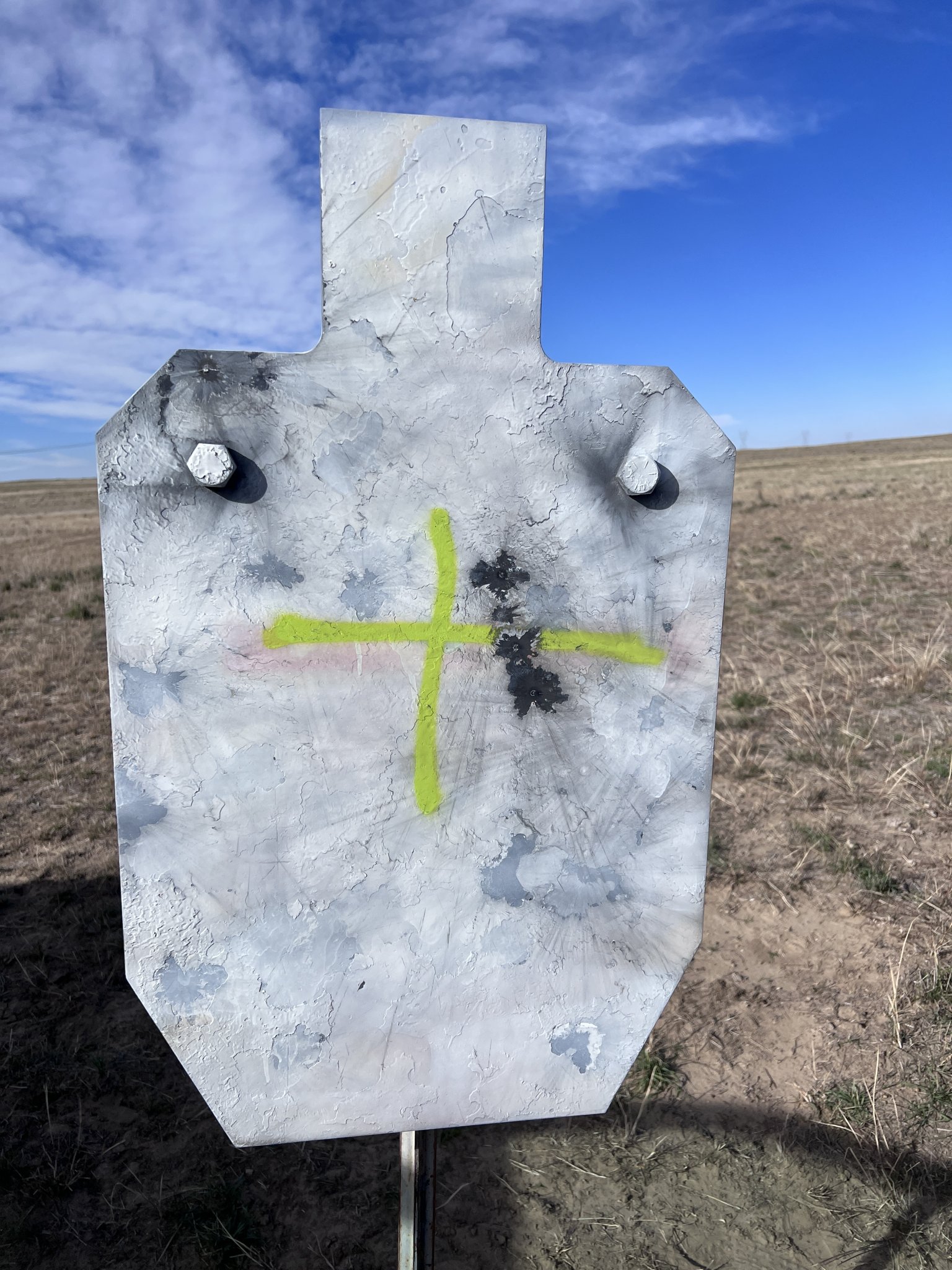

Put together my rifle yesterday. Origin action, osprey barrel from pva, trigger tech trigger, krg bravo, razor Gen 2 with badger rings and a Harris bipod. Spent today, my birthday, breaking in the barrel according to PVA’s suggestion. Worked thru several loads of h4350 and 143 eldx’s. Started at 41.5 and .020 jump. The higher I got the more my sd opened up on velocity. For now I’ve settled at 41.7 with a 10 shot sd of 13. Also I had been reading some articles on accurate shooter on bullet jump nodes and tried .060. It seemed to help tighten my groups a bit. But I’m still getting more vertical stringing than I’d like. Any suggestions on things to look at? It’s shooting half moa 5 shot groups but I’d like better. Maybe it’s just me and I suck
The Magnetospeed hanging on the barrel can certainly affect POI. Whether people want to believe it or some barrel’s temperature has been seemingly associated with vertical stringing. This is highly debated but seems it does sometimes IMO.
A magnetospeed will "move" the group, but I have never see it "affect" the group size
So please tell me how the Magneto is changing the group cause in my experience it just moves location not size
I really figured with that heavy m24 countour the magneto speed wouldn’t cause much issue. Like was said maybe change poi but not group
Theirs a good chance it’s me. Any tips on loading the bipod or using the rear bag?

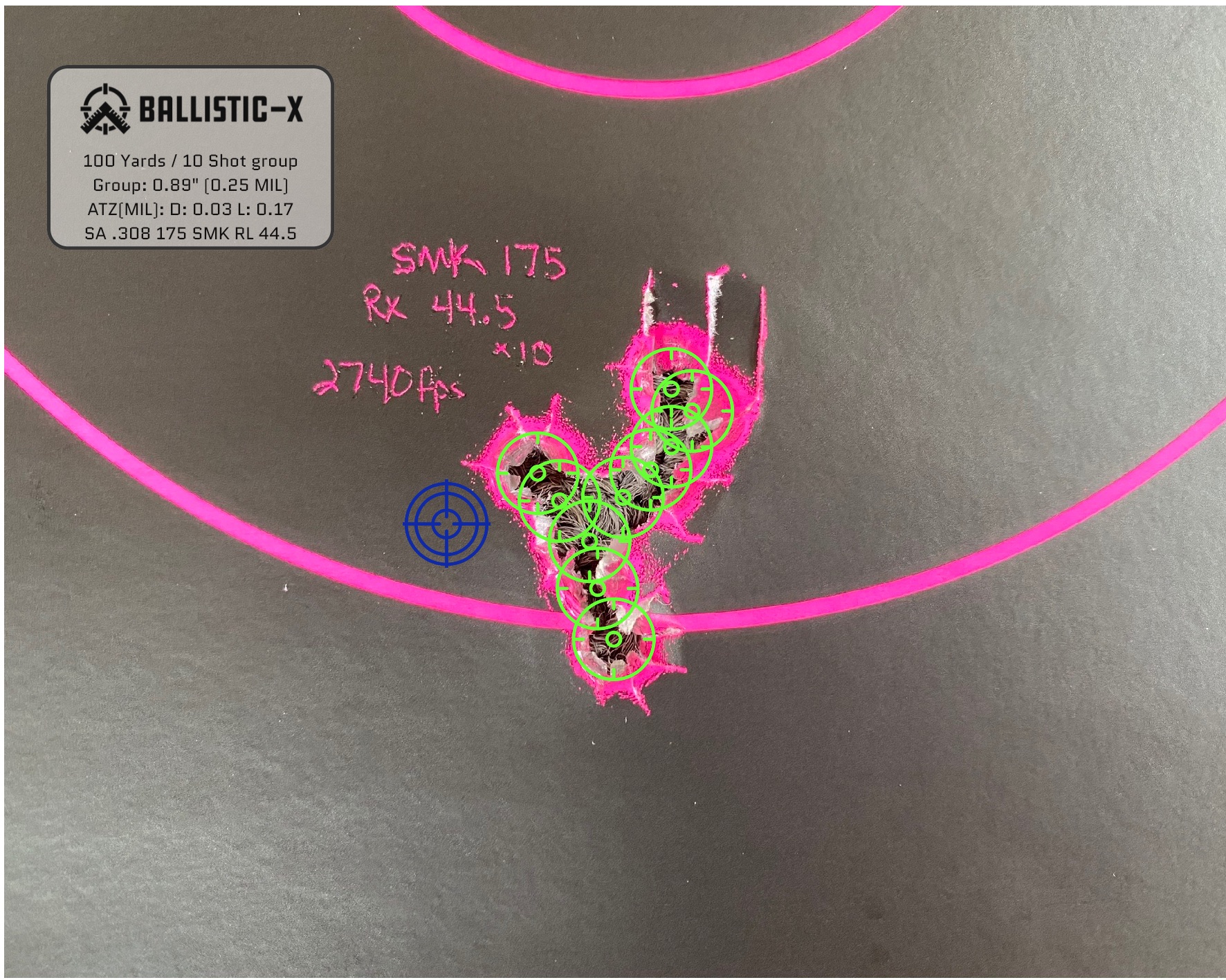

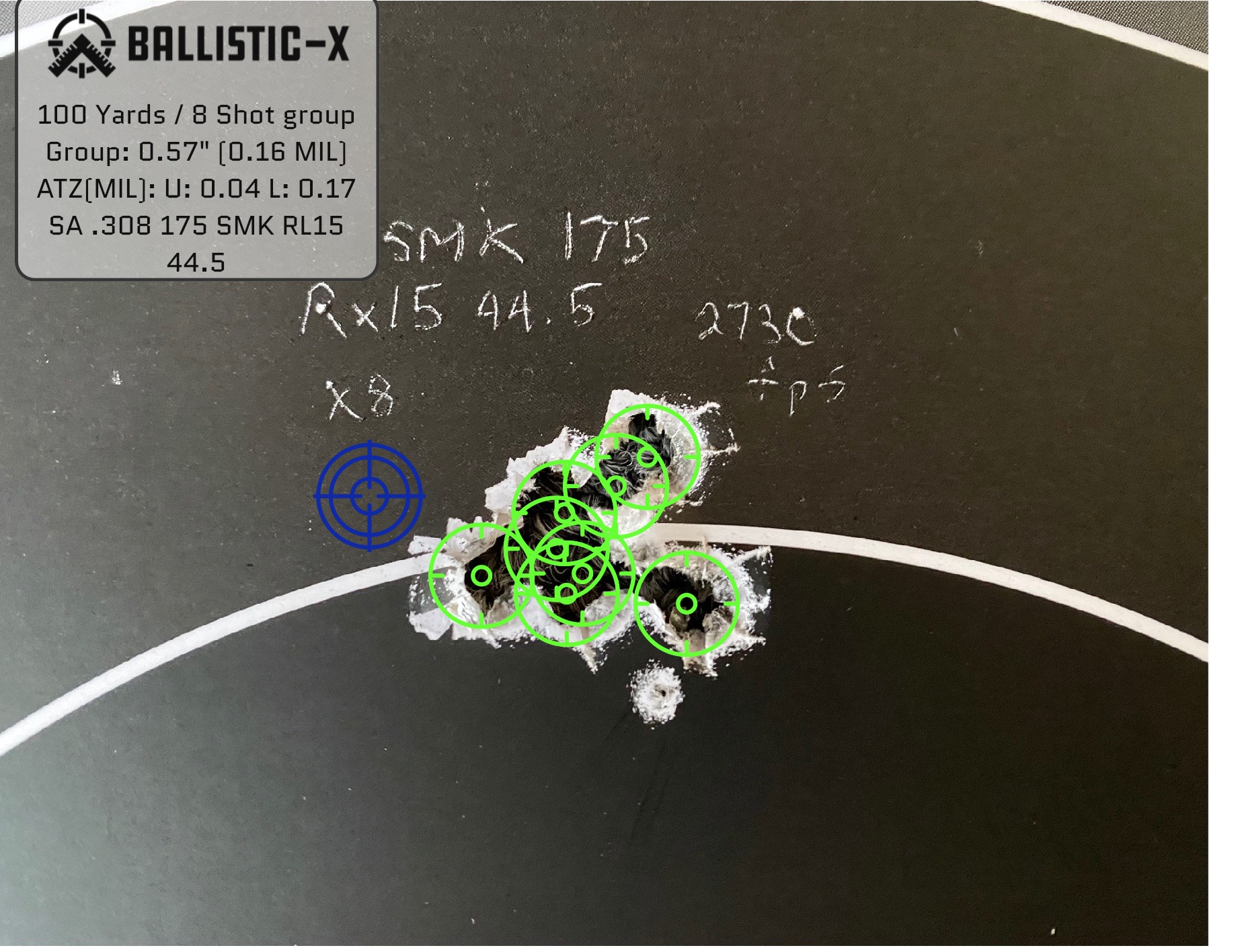

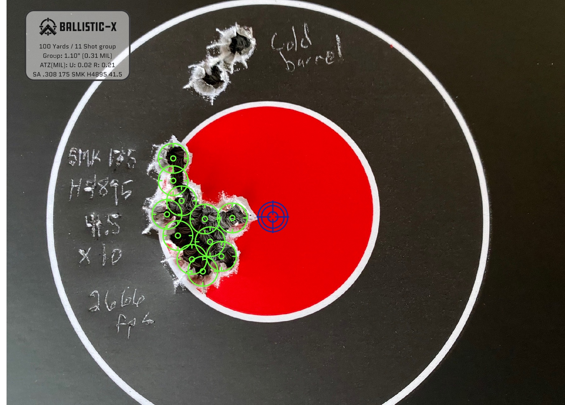

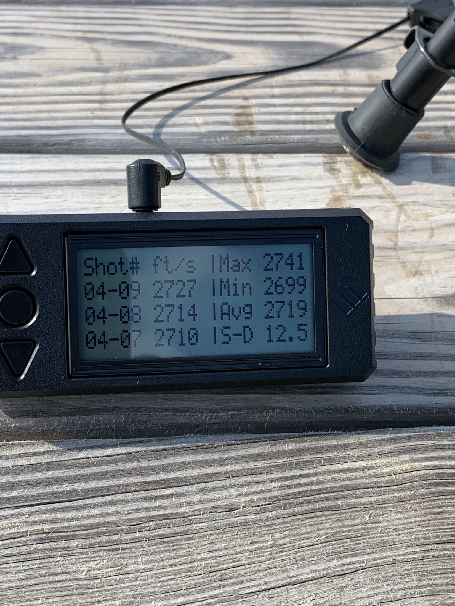

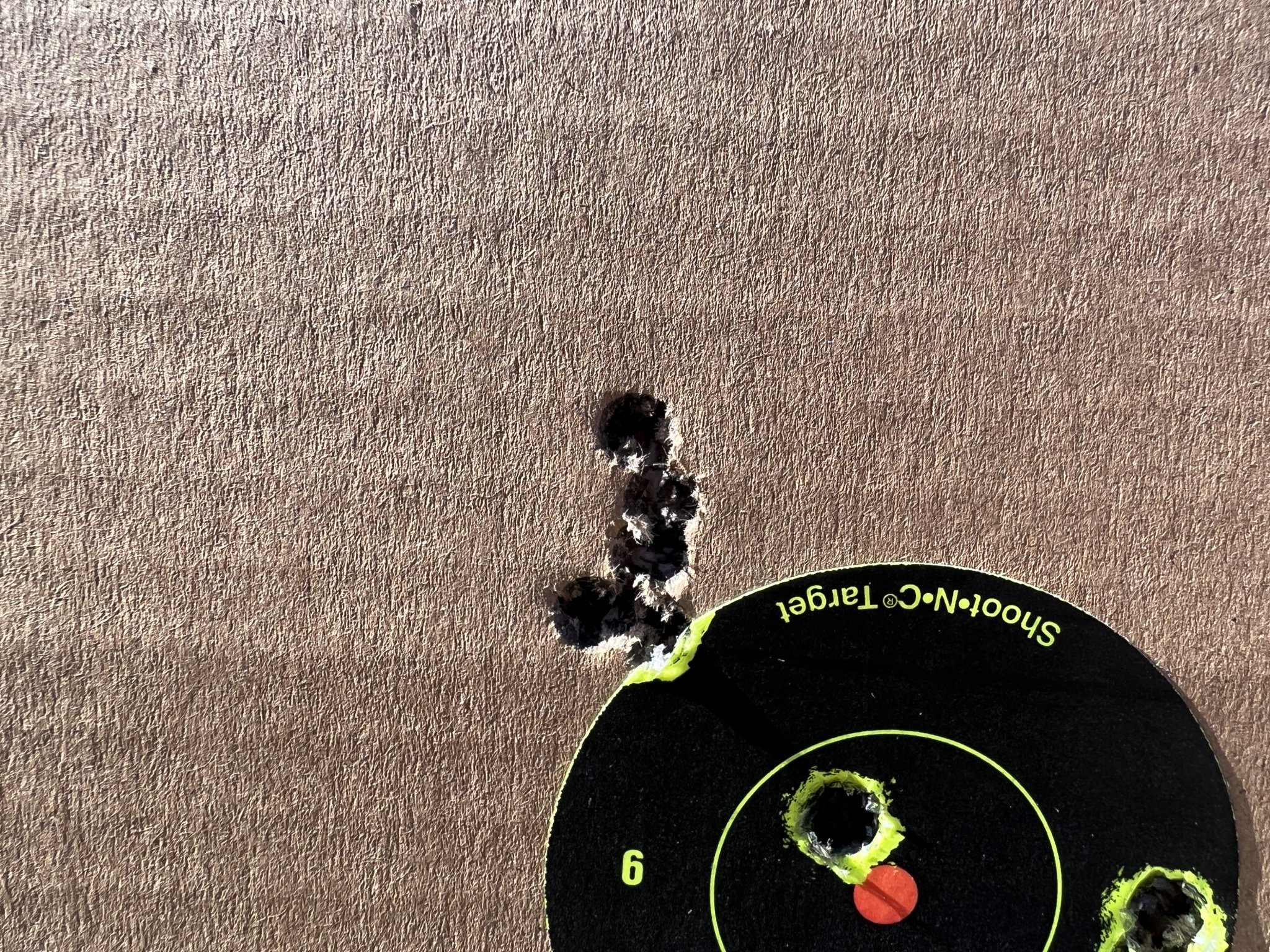

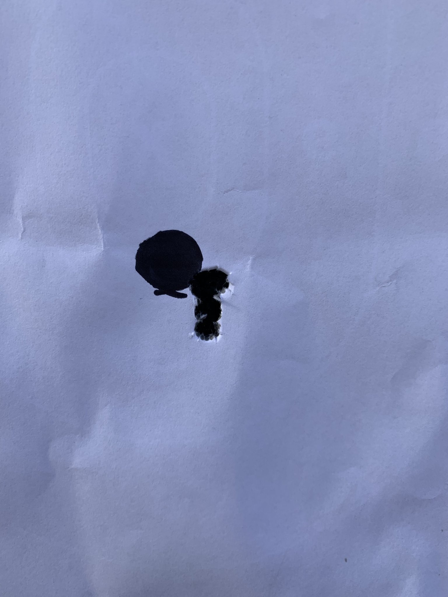

I got no rhyme or reason but these had a Magnetospeed on the barrel because I recorded the velocity on the target. Seems stringy to me. Also were shot close together with a suppressed barrel that wasn’t cooled. 🤷‍♂️
Different powder but same day, gun and bullet.

I got that the other day with my Valkyrie load,
Strung at 100, and again at 600
I figured seating depth so I stuck a tuner on and decided I will tune it out rather than chase the group,

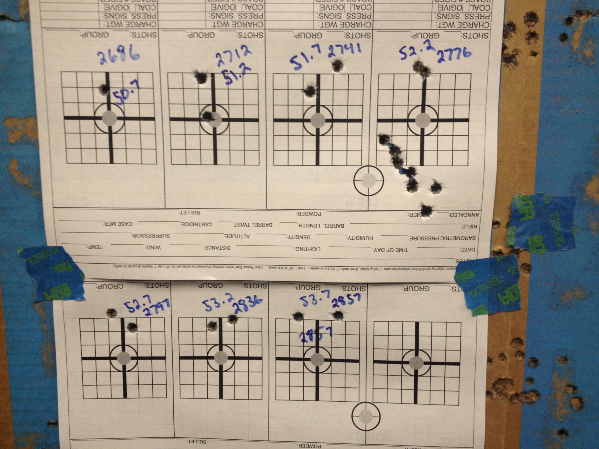

The group that is a long string, is one from each charge weight shot over a magneto speed . There is an extra variable though because the OCW was shot with a suppressor, then i removed the suppressor, and attached the magneto speed. Each successive shot landed below the one that preceded it. I can't think of another time I have seen it happen like this though. Probably kin to shooting a half MOA group with wolf steel case.
Reactions: Hobo Hilton
I’ve always wondered if it’s because the Magnetospeed moves, albeit very little but still moves, towards the muzzle with recoil causing the linear change in POI.
