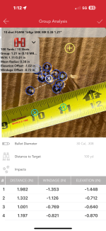

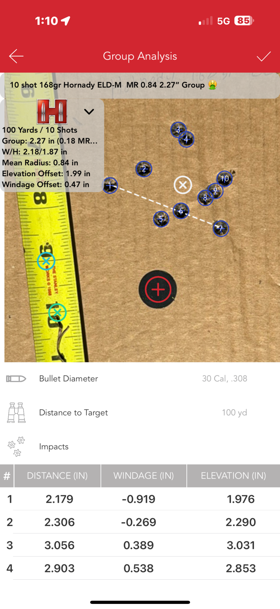

168gr Hornady ELD-M
100 yards
65ish *F
30% humidity
$44 a box/20
CZ 600 Range
Vortex 5-25x56
Vortex pro rings
Ultradyne appolo muzzle brake
Hilariously this was probably my best shooting far as focus and trigger pull…

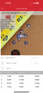

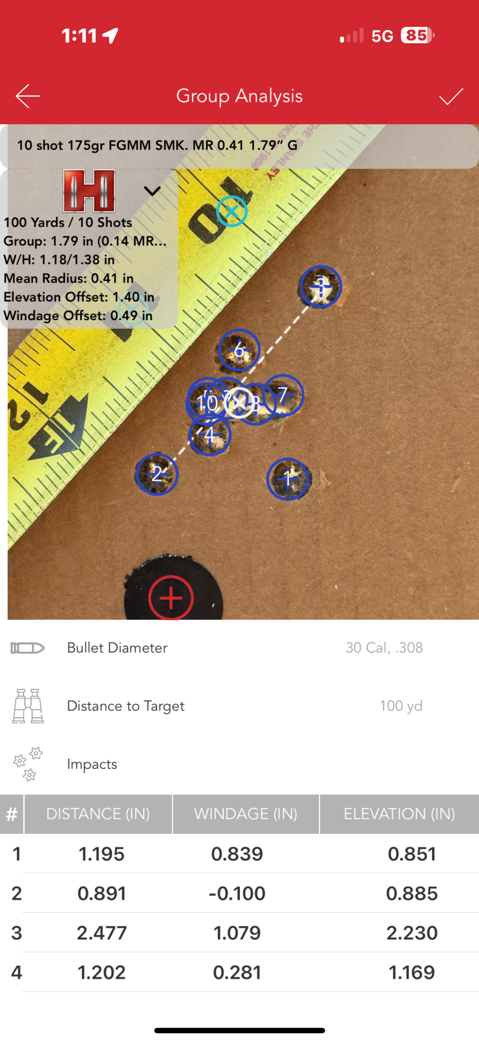

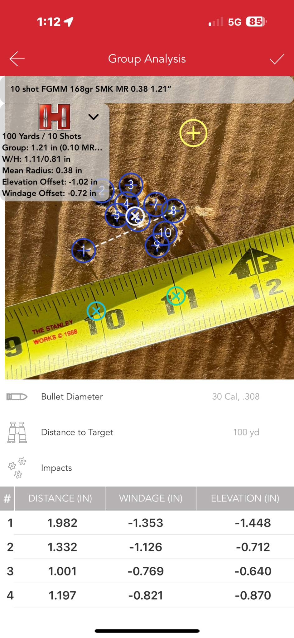

10 shot FGMM 168gr SMK
Best mean radius and best group… I guess it doesn’t like secant projectiles? Which is unfortunate since I bought 100, 178gr ELD-Match for hand loading….

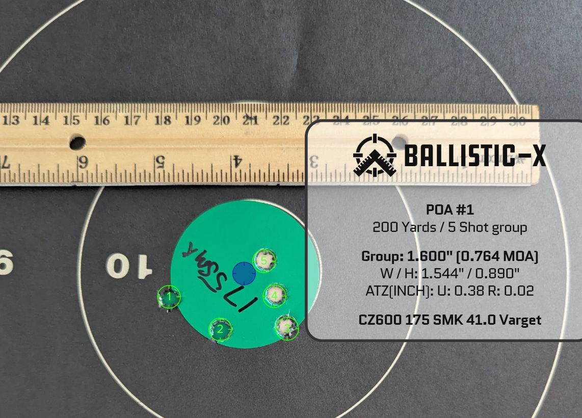

Other than 4 shots for bore sighting, 15 total shots of each of the 3 loads. (Didn’t post the 5 shot groups) so 39 rounds in total, cleaned and lubed before shot, and never let it get hot.

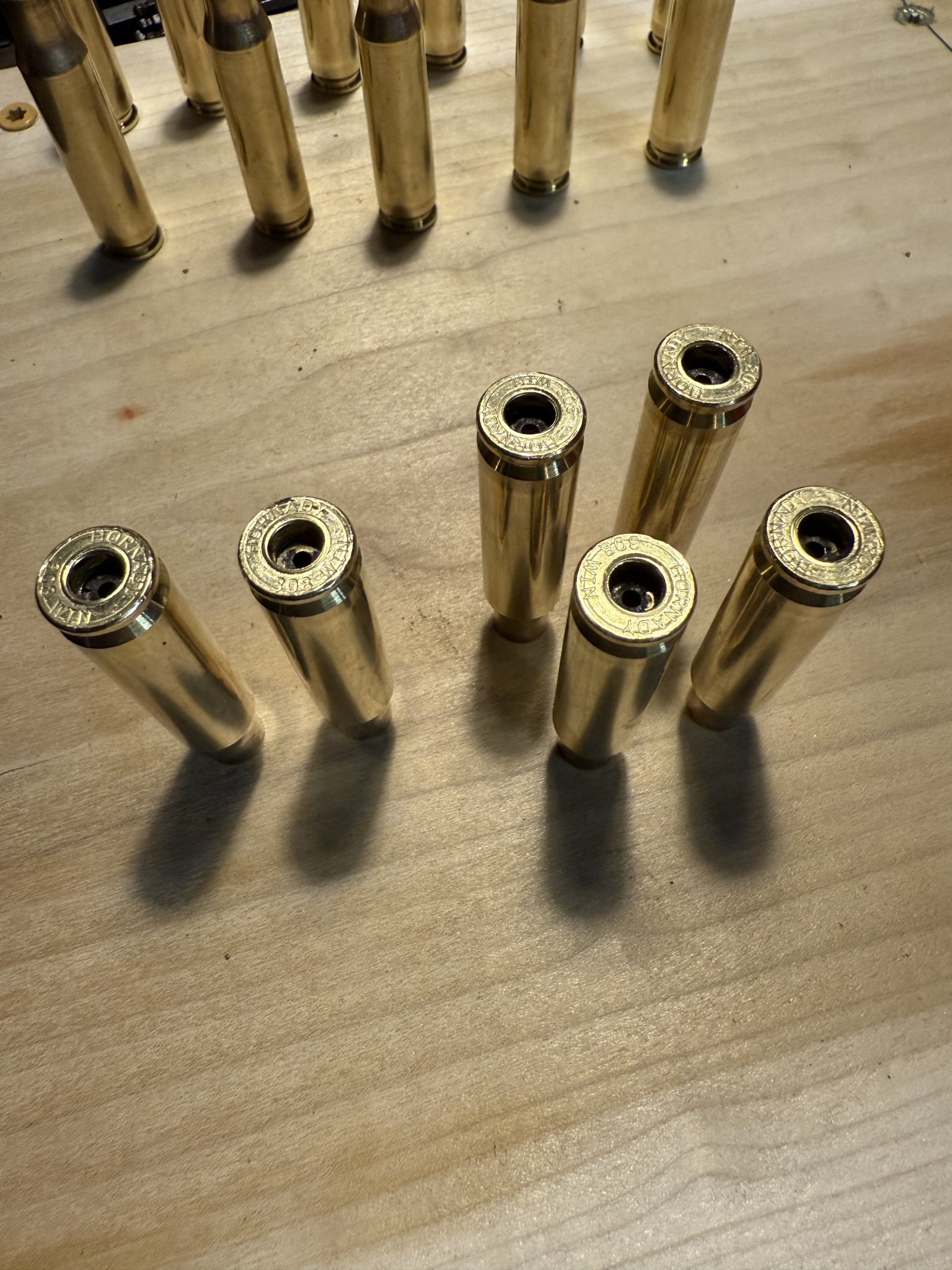

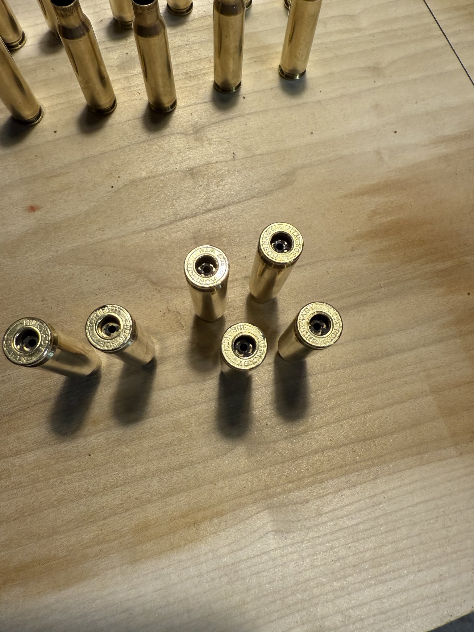

I'll post pictures tomorrow as the brass is in my shop, but the Hornady brass has a lot of marks on the case heads, the FGMM looks perfect. Makes me really wish I had recorded more of the velocity readings from that stuff... definitely not loaded weak...
Not sure if it plays into it at all, but this rifle has a manual ejector. So maybe head space could cause the marks I'm seeing on the Hornady brass if the shoulder is to far back from the factory?

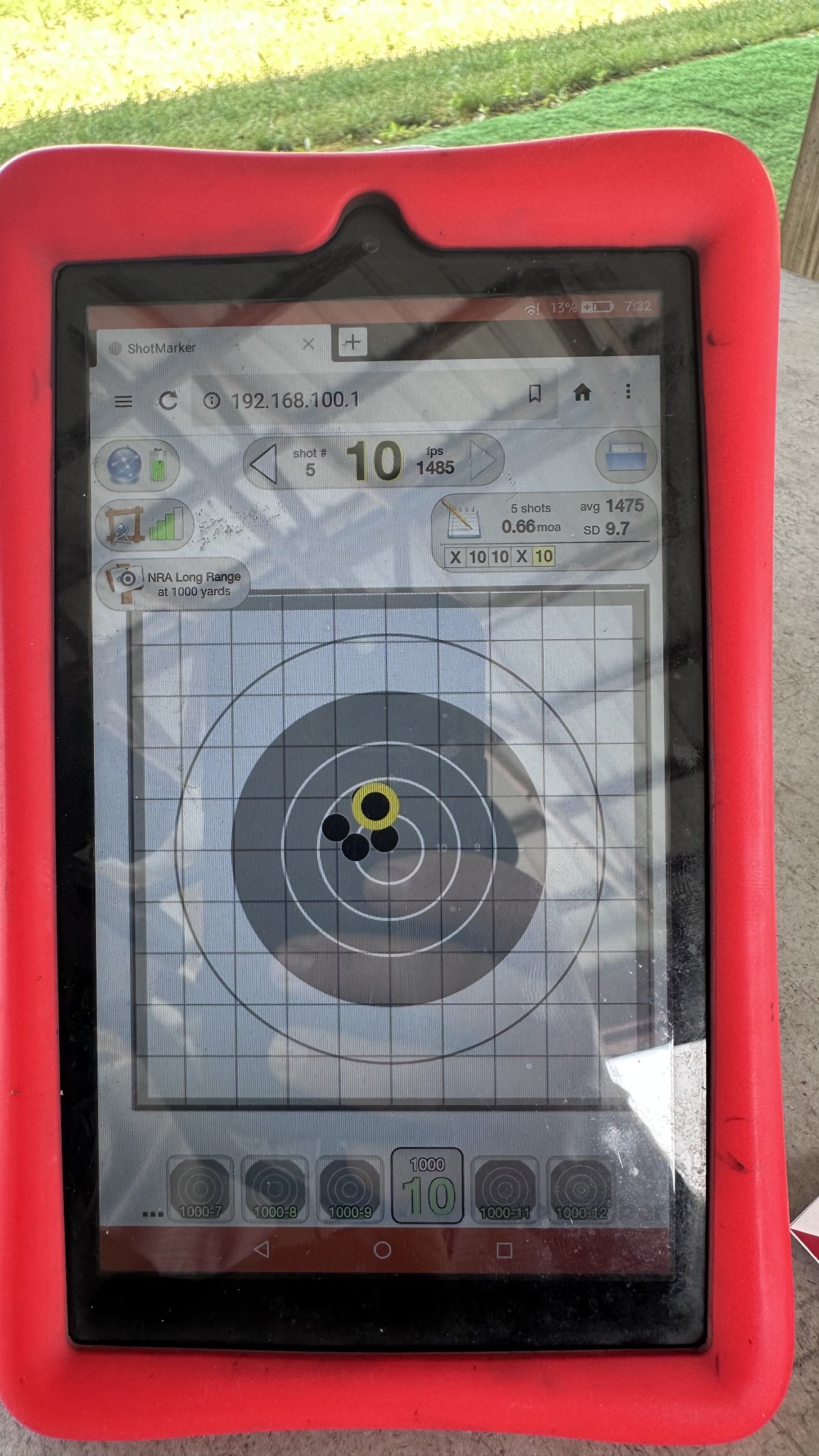

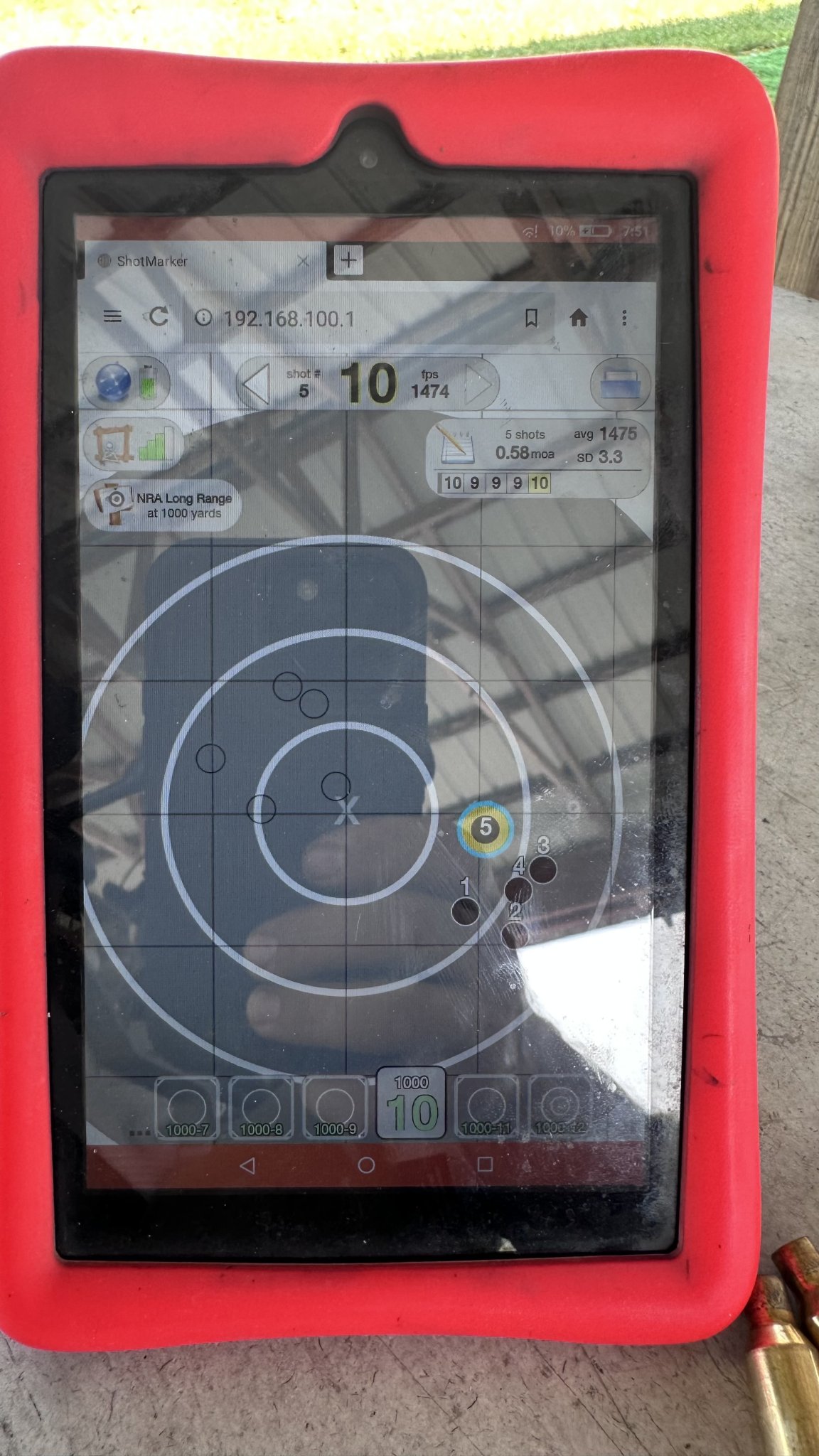

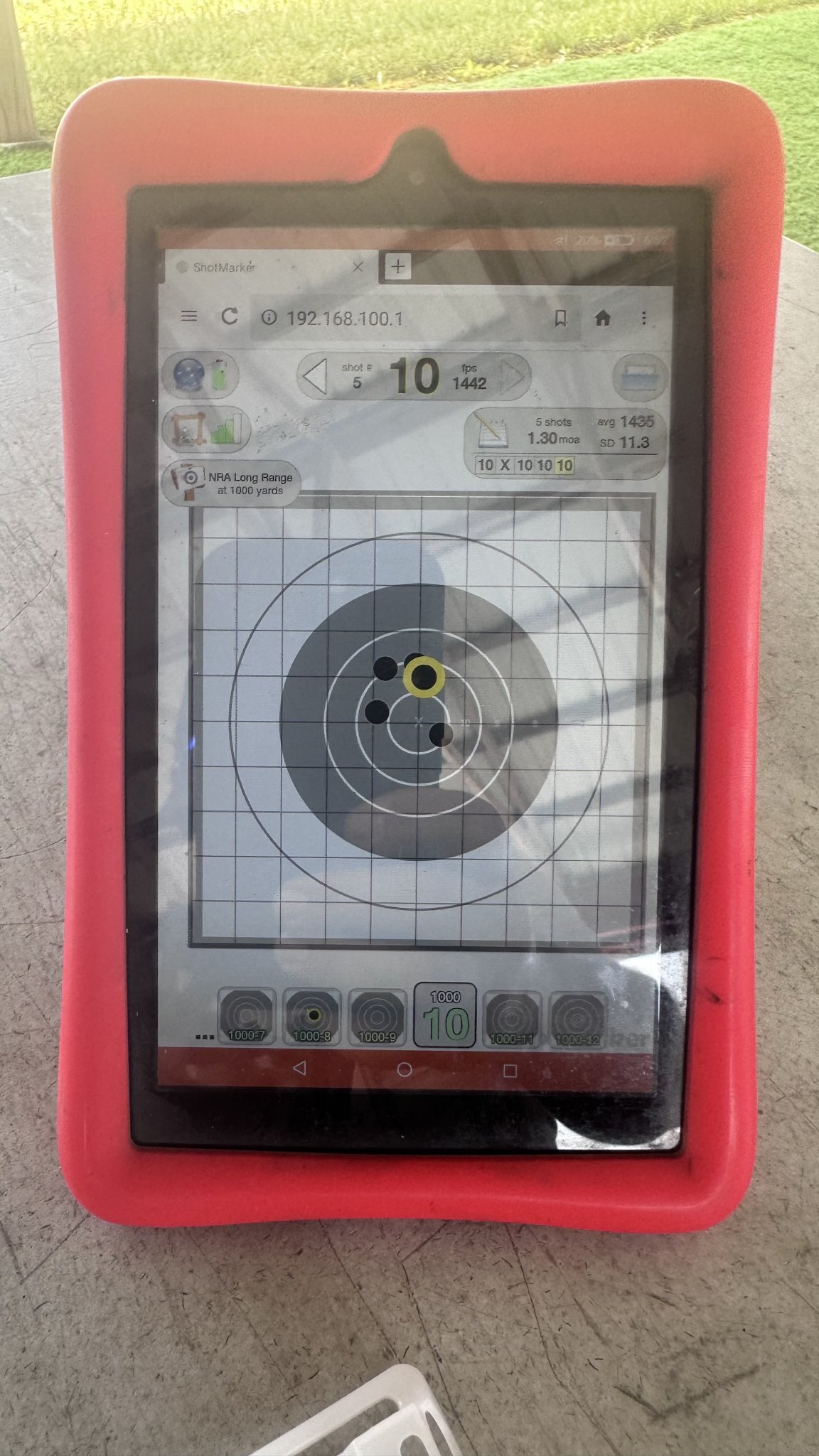

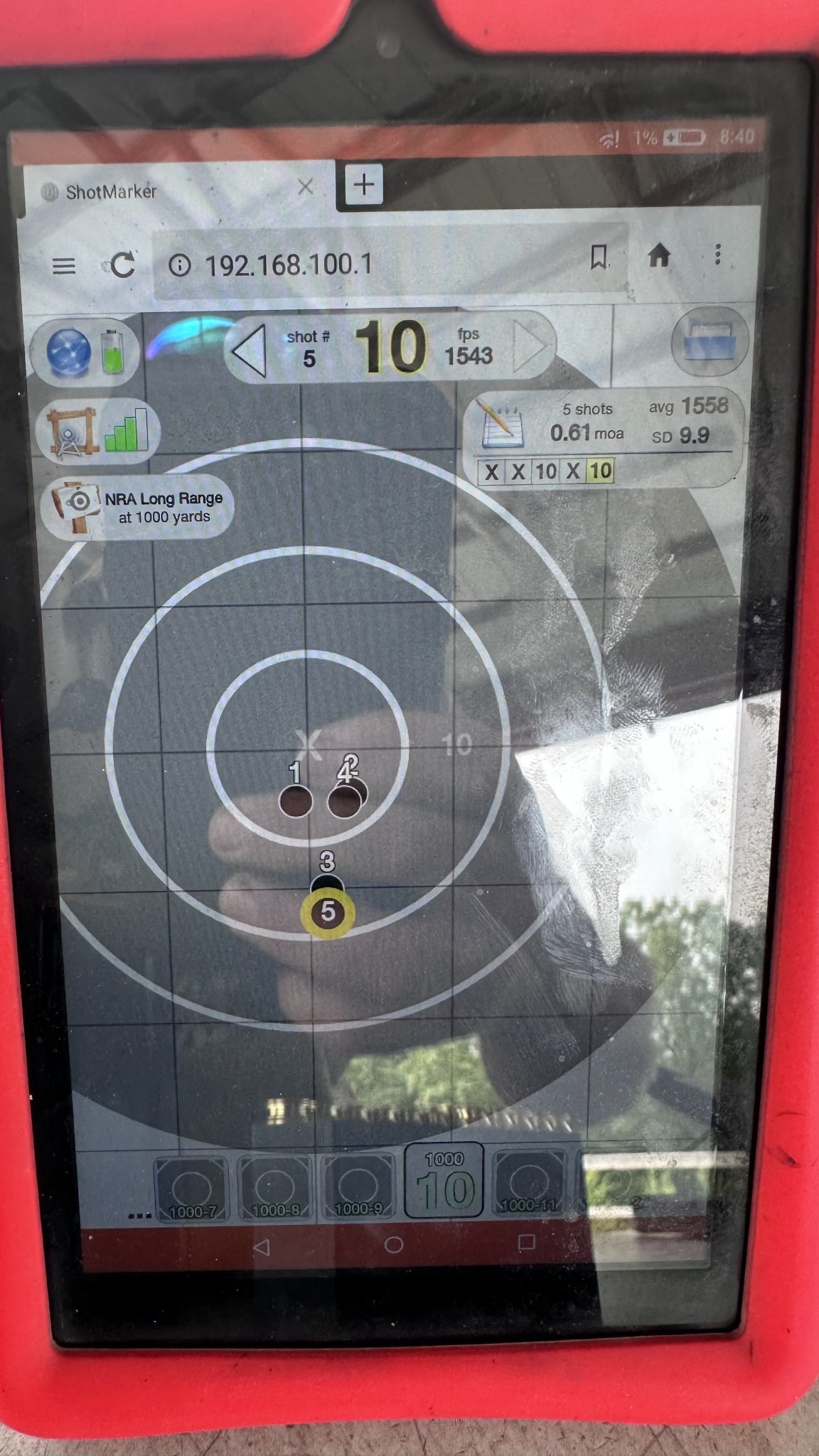

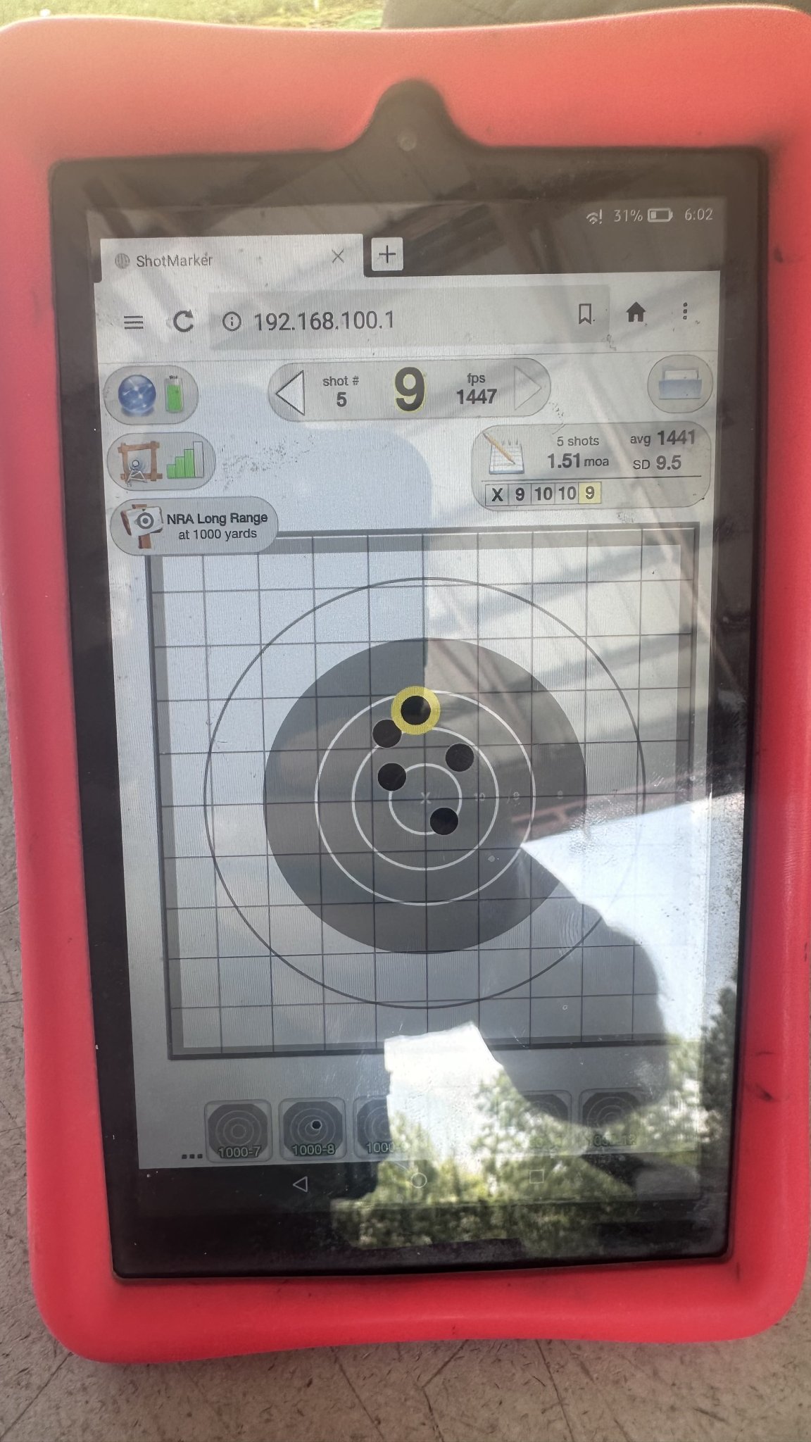

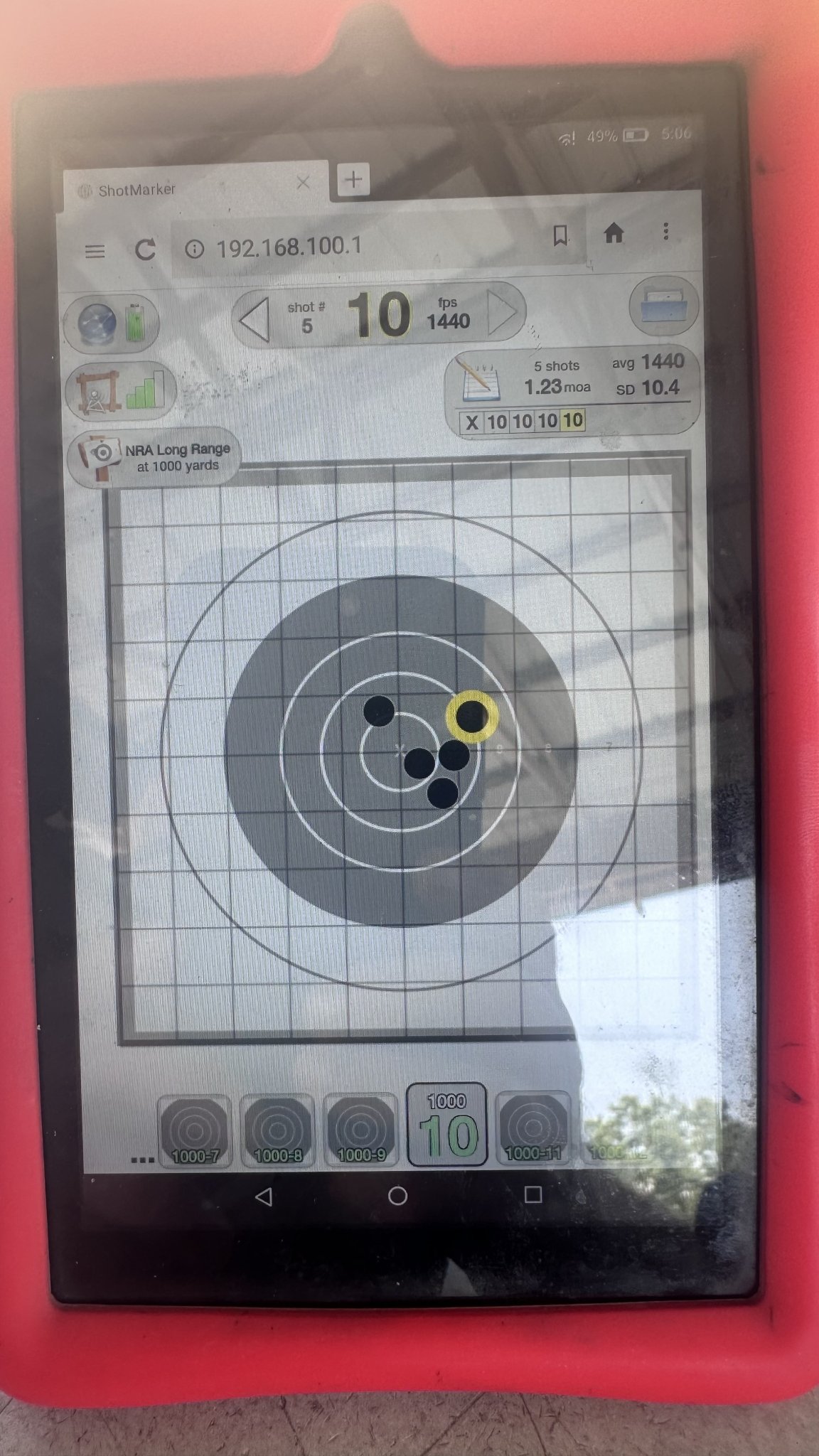

If you look at the photos I posted above You will see the 3 top photos have an average velocity of around 1440 fps @ 1,000Y (FGMM 140gr SMK)
2 of the bottom photos are around 1475 fps @ 1,000y (Sierra Custom Competition 140gr SMK)
One of the bottom photos has a velocity of 1558 fps @ 1,000y (Hornady 147gr ELD Match)
They must be pushing the Hornaady ammo much harder than the FGMM and Sierra Custom Competition to get a heavier bullet travelling that much quicker. It stands to reason tht you will see ejector marks and flatter primers.

Deprimed Hornady brass on the left, FGMM still has primers, neck sized the Hornady brass, measured case length, washed with lacquer thinner (to make sure all case lube was gone) cleaned primer pockets, loaded some CCi 200’s and loaded 5 with 43.8gr of W748, 5 with 41gr of RL-15 before wife got up to make pancakes… gotta go up and load 5 with CFE 223 in a bit… humidity was at or below 20% when I loaded the first two sets of 5… (have heard humidity exposure can slow down powder but probably talking about in a humid environment for prolonged exposure)

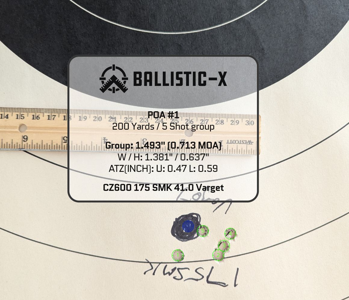

I've got a 600 Alpha that shoots the 175 FGMM at about 3/4 MOA; that was the first ammo and groups I shot with the rifle. It shoots the 178 ELDX Federal ammo right around MOA, but it seems like that's a fairly mild loading. That's all the factory ammo I've tried so far. The stock on that rifle seems like the limiting factory since the fore end is so flexible.
I just started working up loads for the CZ with the 175 gr. Barnes LRX and N540 gave me the best accuracy and velocity so far. What I've seen so far is this rifle likes hotter loads. With minimal work, it's just under .6 MOA with the LRX and N540. Dad has one in 6.5 creedmoor that seems like it will shoot too. He's only put about 15 rounds through it though.

That’s my MO… didn’t have time to today but I found out how to use my torque wrench with a crows foot to torque the muzzle brake to apex to cross that one item off the list since it’s the one thing I didn’t do by the book and want the peace of mind so I can just focus on the ammo and shooting.
Someone recommended me calling CZ USA and asking what match ammo they used and I may do that…

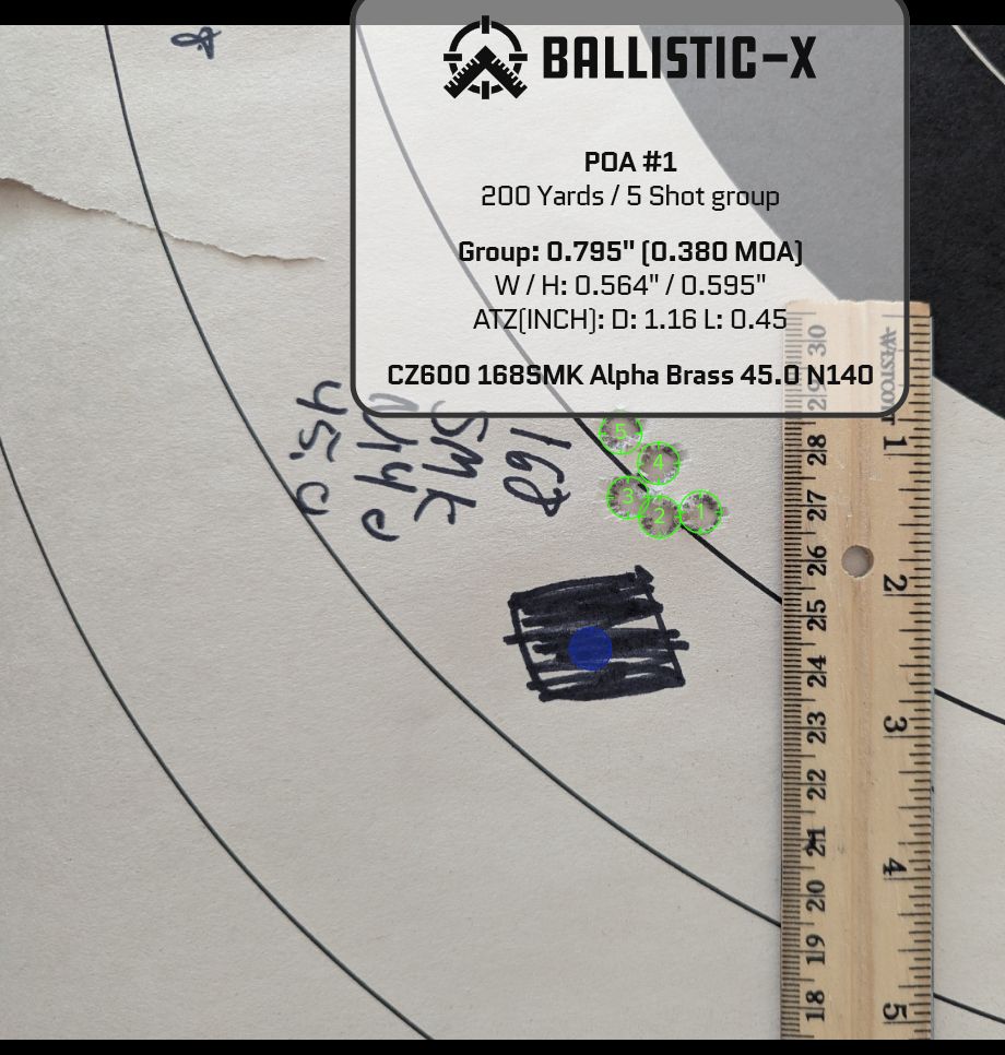

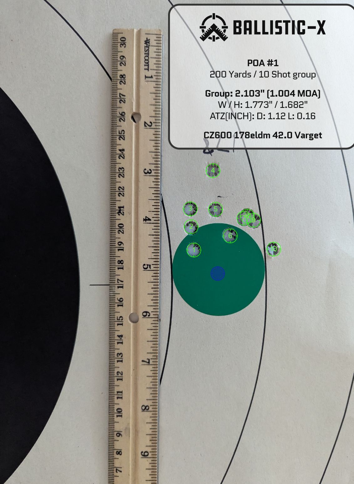

Loaded 5 rounds of the 178 ELD-M with 40 gr of Varget to go with the other 3 powders I loaded 5 of.
40grns is pretty low. Be prepared to jump up some.

Waiting on a crimp die and the weekend to try the hand loads with the ELD 178's.... I expect the best will be the RL15 or Varget load of the 4. I know some (including the mod that's been helpful here) say you don't need a crimp.... but I have heard at least one manufacture note that a mild crimp actually improved dispersion on some of their testing... my guess is improved ignition consistency. Soooo whichever does the best, I'll re-test without a crimp and see which did better or if it made basically no difference.
Obviously not wanting to crimp much as I don't want to damage the jacket of the bullet, I just want a little kiss around the case mouth. Maybe it's just me but seating them seemed......easy LOL. So a peace of mind thing perhaps is what's driving me to do it. Using Lyman dies, which thankfully liked the ogive of the 178's and didn't mark the bullet or anything like I have seen happen with some dies.
The Hornady 168 ELDM WILL NOT group in my CZ 600 Range. Usually 2+MOA. I have tried different seating depths, powders, etc, it plain wont shoot. The 178 ELDM is much better, usually about 0.75moa for a 5 shot group. 168 SMKs with Varget or N140 and Starline brass have been exceptional with plenty of sub 0.5moa groups.
