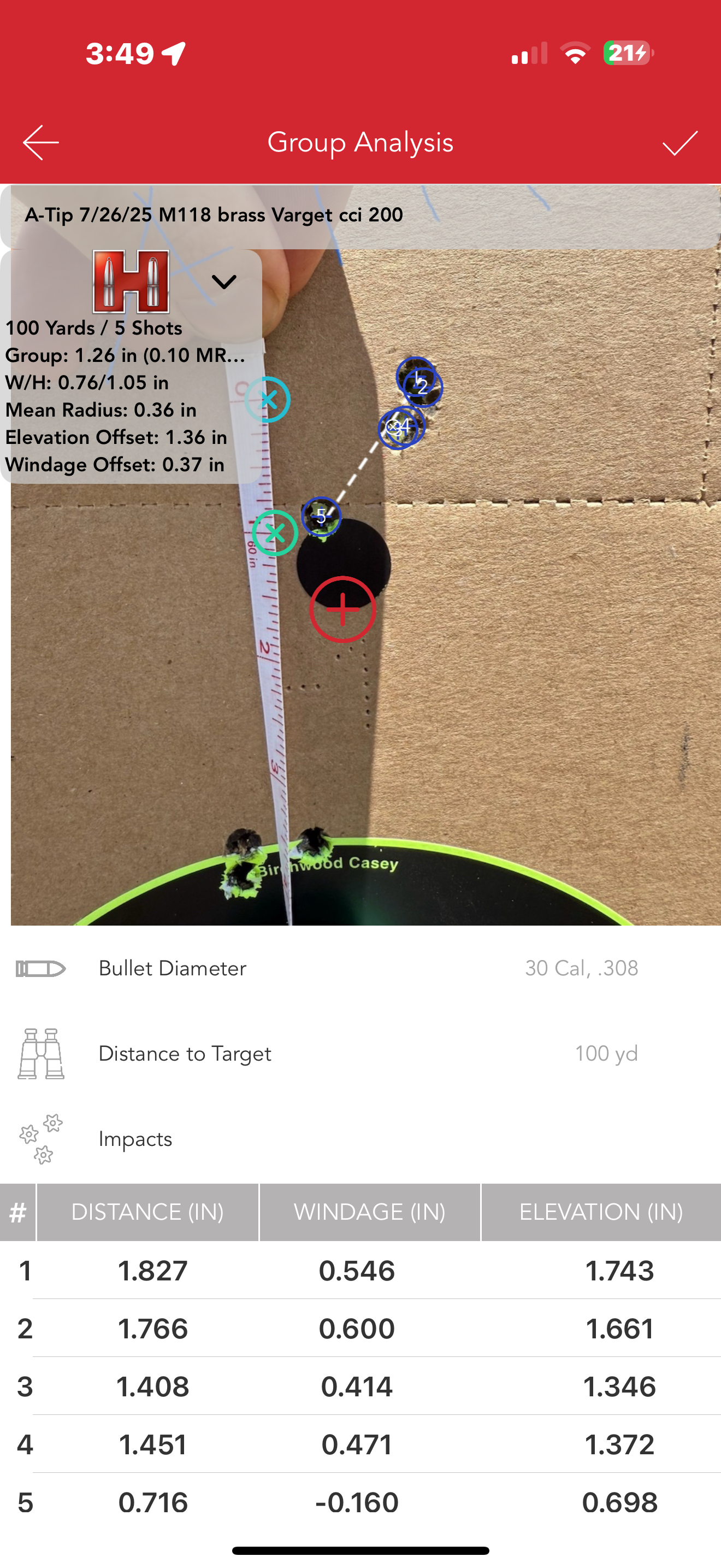

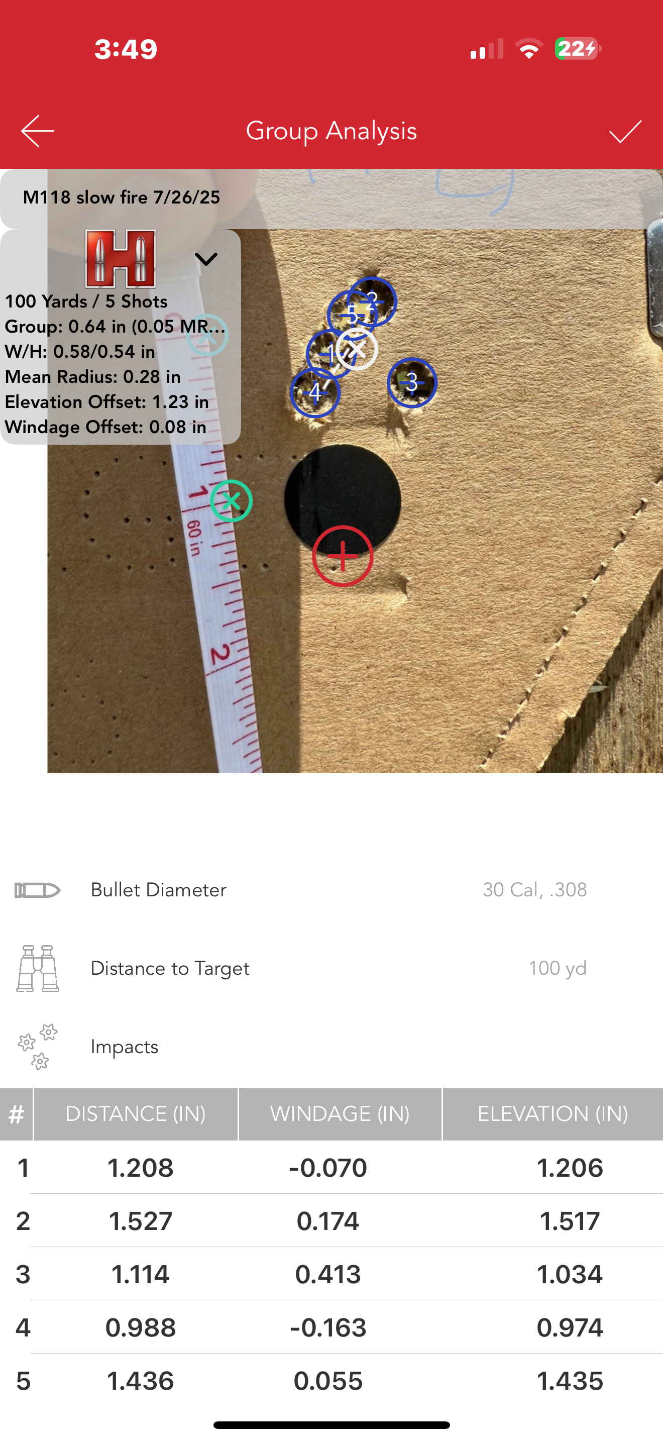

Any way, ELD-M’s are going much slower I’m sure than the M118 or FGMM since they’re 2600fps average vs my hand load, which I didn’t chronograph but I think 40gr was at or below 2400fps. They shoot to the same point far as windage but tend to impact a half inch lower.
Here’s the FGMM and a M118 group. Img_5989 is the M118 the FGMM was a 3 shot group while the M118 was a 5 shot group.
