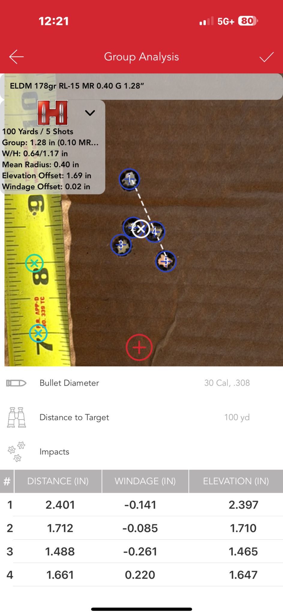

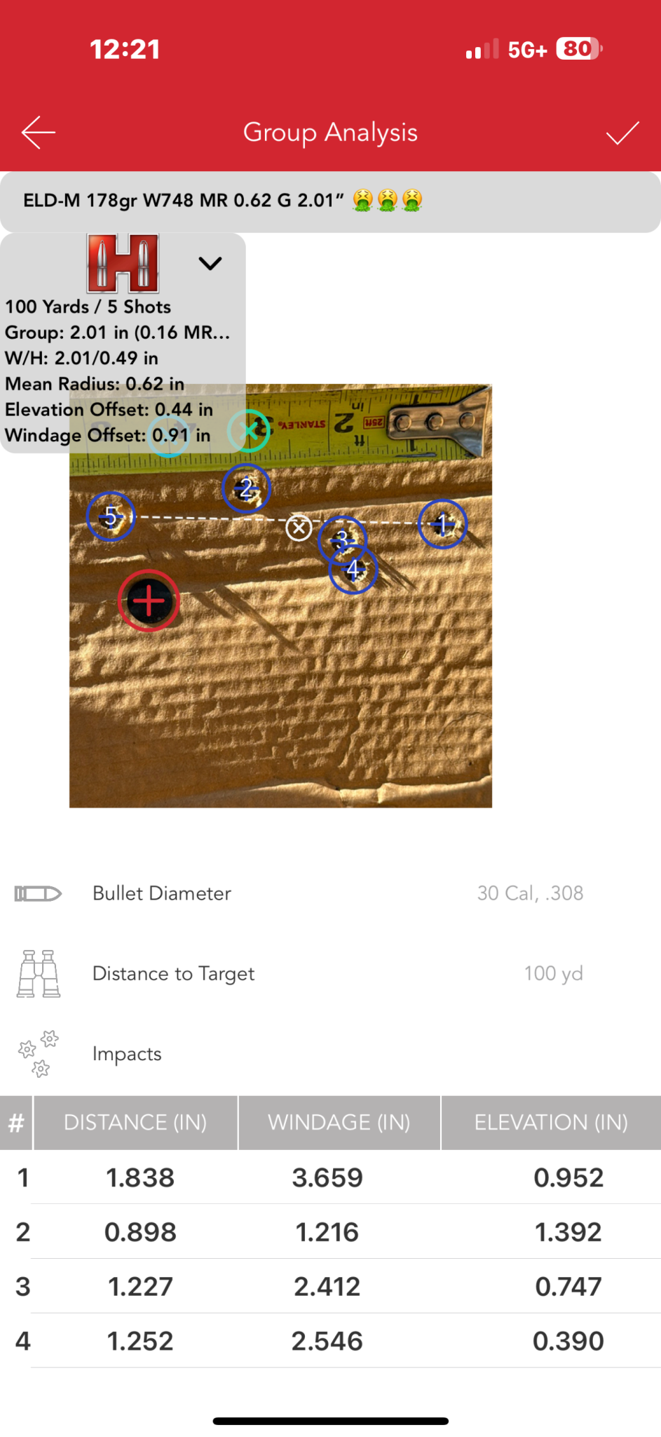

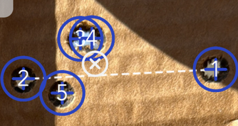

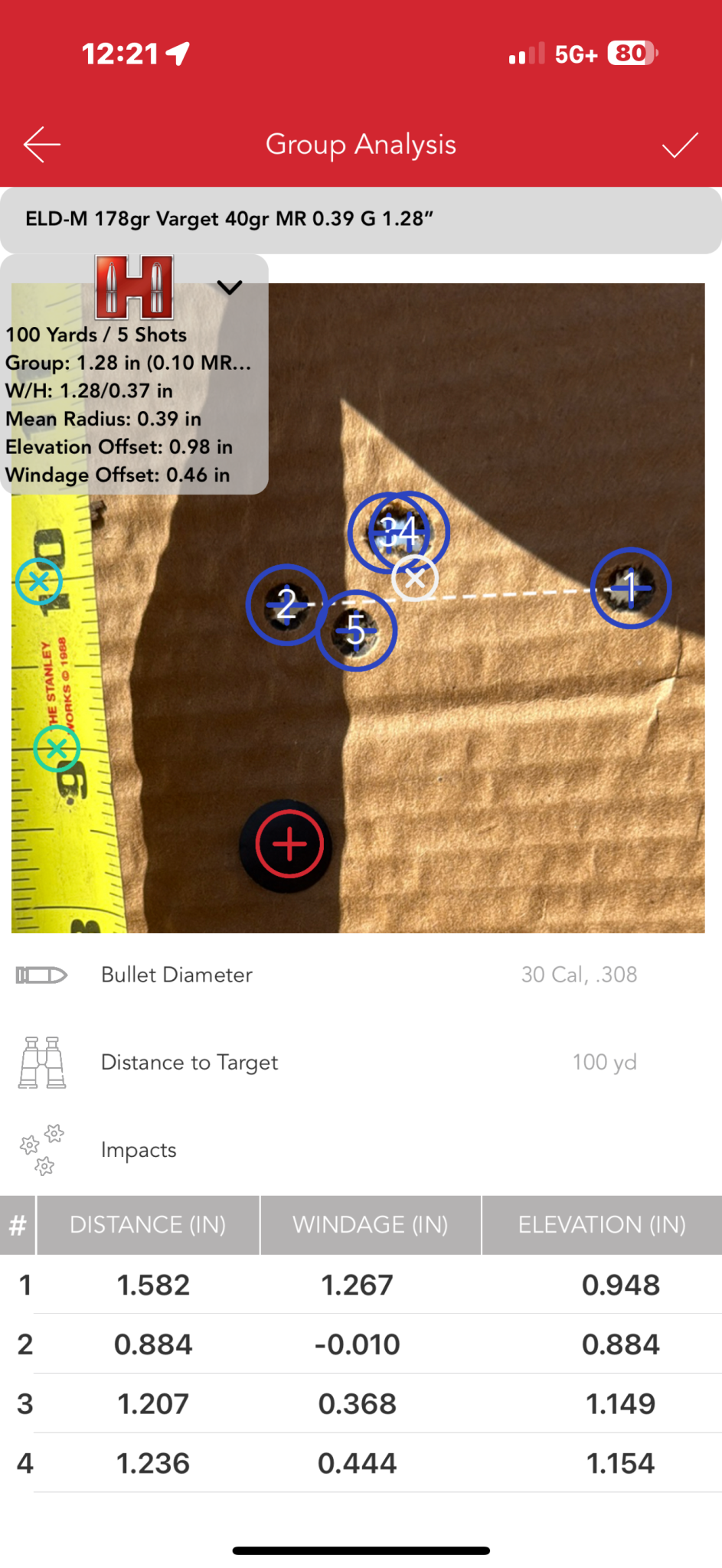

That makes 73 shots on the barrel.
Just ran a bore snake down it a couple times after the first outing. Also funny thing about the CFE powder group… the sticker dot fell off after the second shot…I just used the reticle to bracket where I thought it was relative to the other impacts
NOTE: These were all fired from once fired brass from my rifle, only neck sized. the CFE, W748 and RL-15 were all Hornady match brass, the Varget load was FGMM brass.
The rifle possibly throwing fliers, ~1 per group. I'd first 100% rule out mechanical issues with that dispersion pattern. IMHO.
View attachment 8635469View attachment 8635470View attachment 8635483

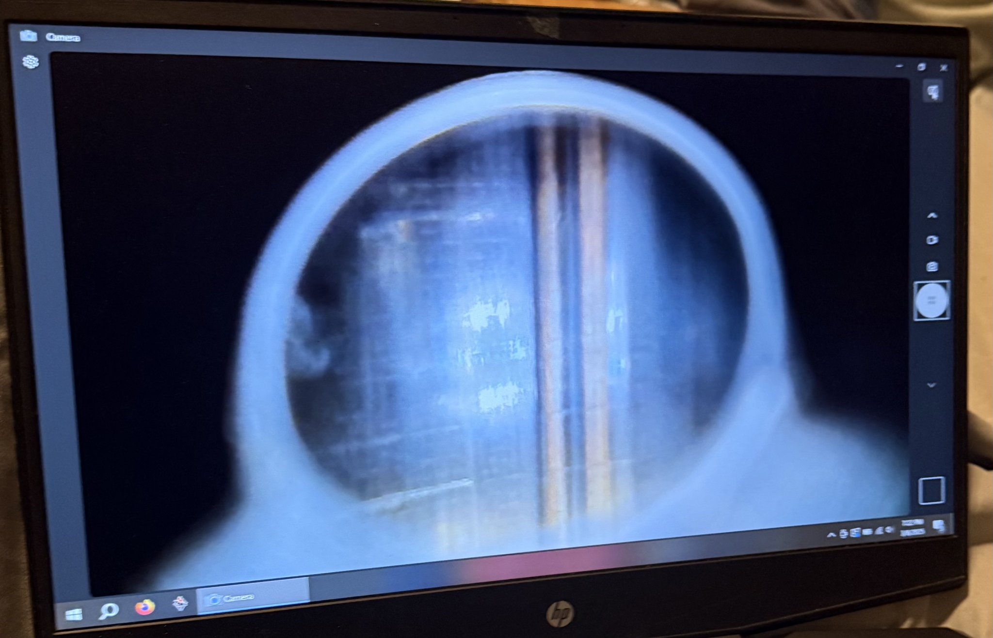

I guess I’ll bore scope it later today and see if there’s anything that sticks out to me.
If it weren’t for voiding the warranty and they would publish torque specs I’d remove the barrel myself and just take sure everything is torqued to spec and mated up nicely….
I have a bore scope... I think I'll try to get it working and look down the barrel from chamber to muzzle some time today and take a few pictures. It certainly looked like it was trying with the Varget load on the 178's.
Do not do that. Biggest mistake people make. They see something and then it’s in their head. Affordable bore scopes have cost more issues than they fixed. Just work on the load and clean the bore every few hundred rounds. Maybe less if a rougher factory barrel.

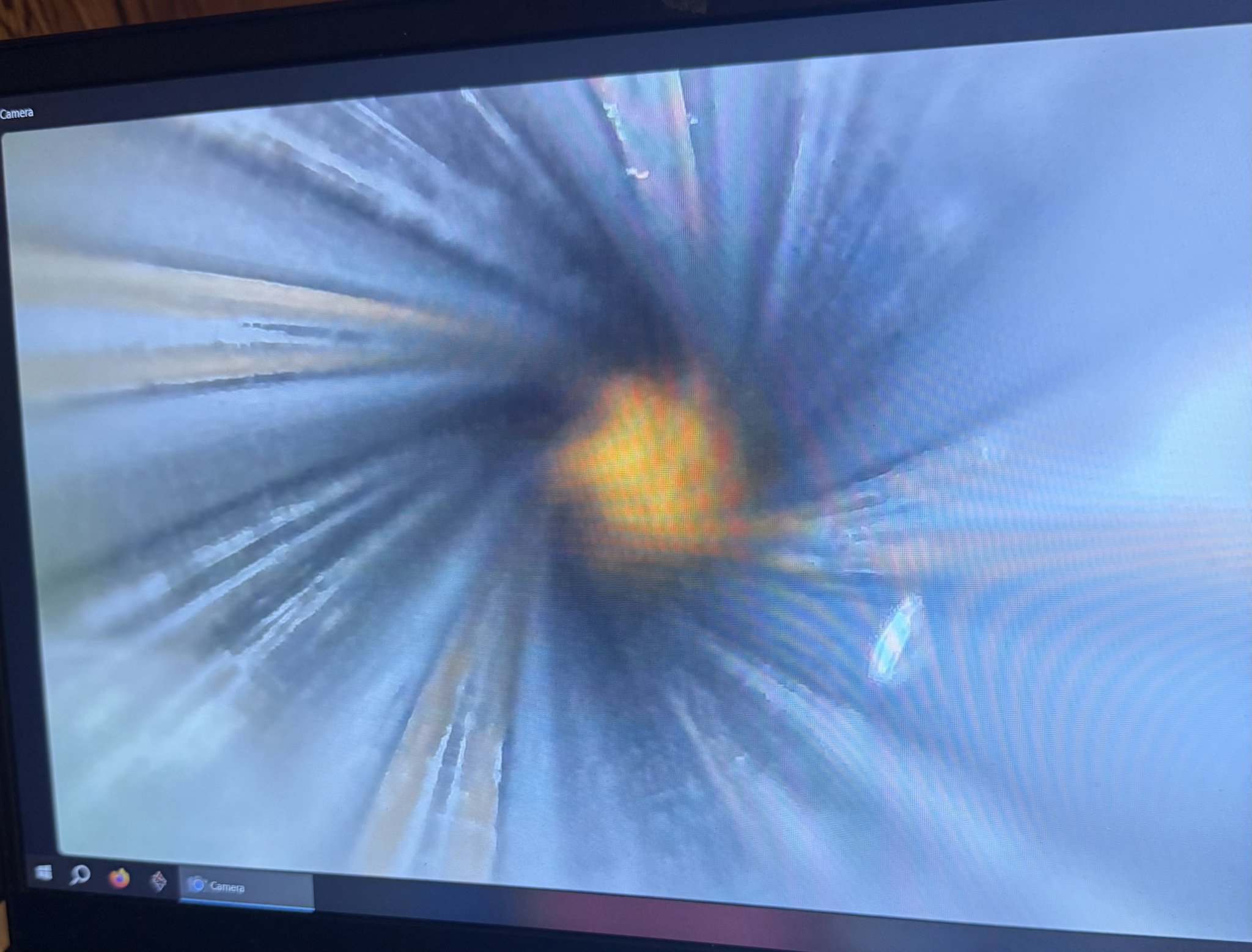

Okay! with that in mind! seriously I'm not doing this to piss you off, I'm just curious and in this case more so of how the cleaning went. The two solvents I have are Brite Bore and CLP. not the brand but the stuff from when I was in the Army, has a NSN number.
ANYway.... so I did scope it, but again not looking so much at the bore as how clean it is. I will say I didn't see any bad spots far as the machining or anything goes IMO, everything looked good, but after several times times with the bore snake, then I don't have a brass brush for .30 but I had a nylon one, so I sent that down several times, then a patch with the bore brite nice and wet... let it sit for 8min or so, then several dry patches until I didn't get much, then moved to the plastic .30 cal jag (can't find the brass one) repeated that process and every or every other time down the barrel folded the wipe over and sent it down until it came out pretty much clean, then bore brite bore, let it sit, scrubbed again a couple times always from chamber to muzzle though I don't see how it matters with a nylon brush... But anyway then the snake again, then some more wipes nice and wet with the bore brite... repeated until dry and clean looking, then sent one down wet with CLP and it's soaking.... before I did that though I scoped it.
There's still copper in the groves....
Again you need to get a class on cleaning a precision rifle before you damage your rifle. Not pissed off as it’s your rifle you are screwing up. Toss those “solvents” because they aren’t solvents. Go buy something worth while and the right tools I already mentioned to clean your rifle. If you just want to clean it like a cheap AR in the Army then have at it. Your rifle.
