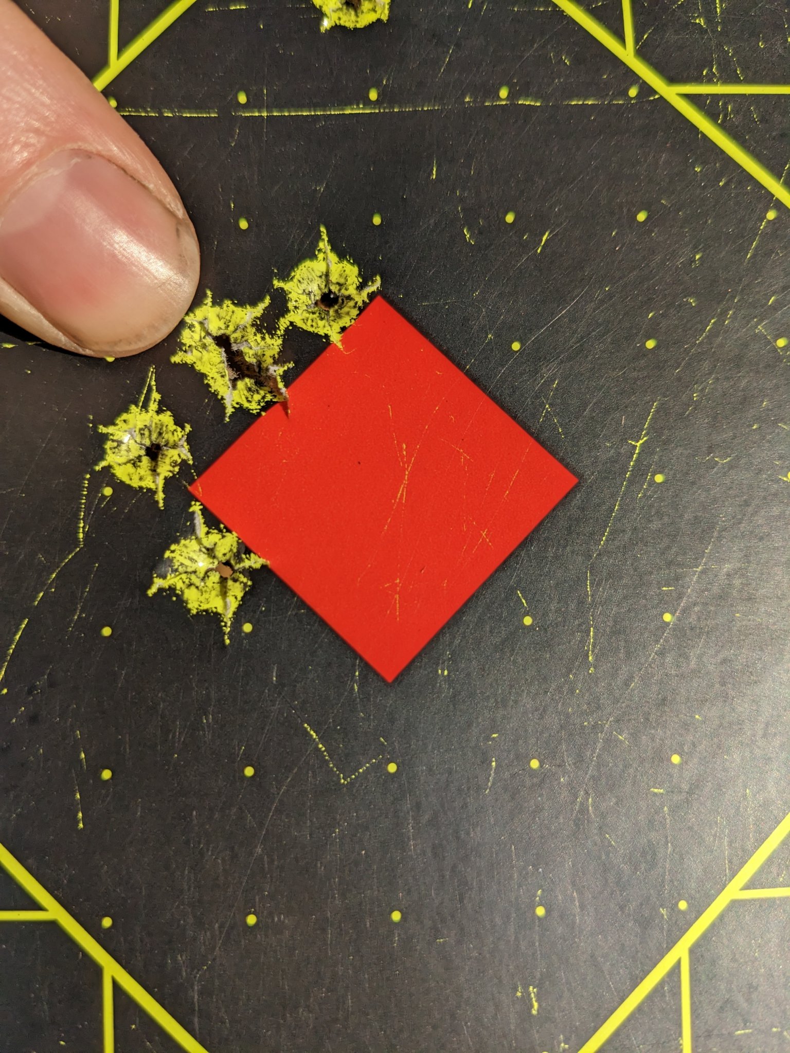

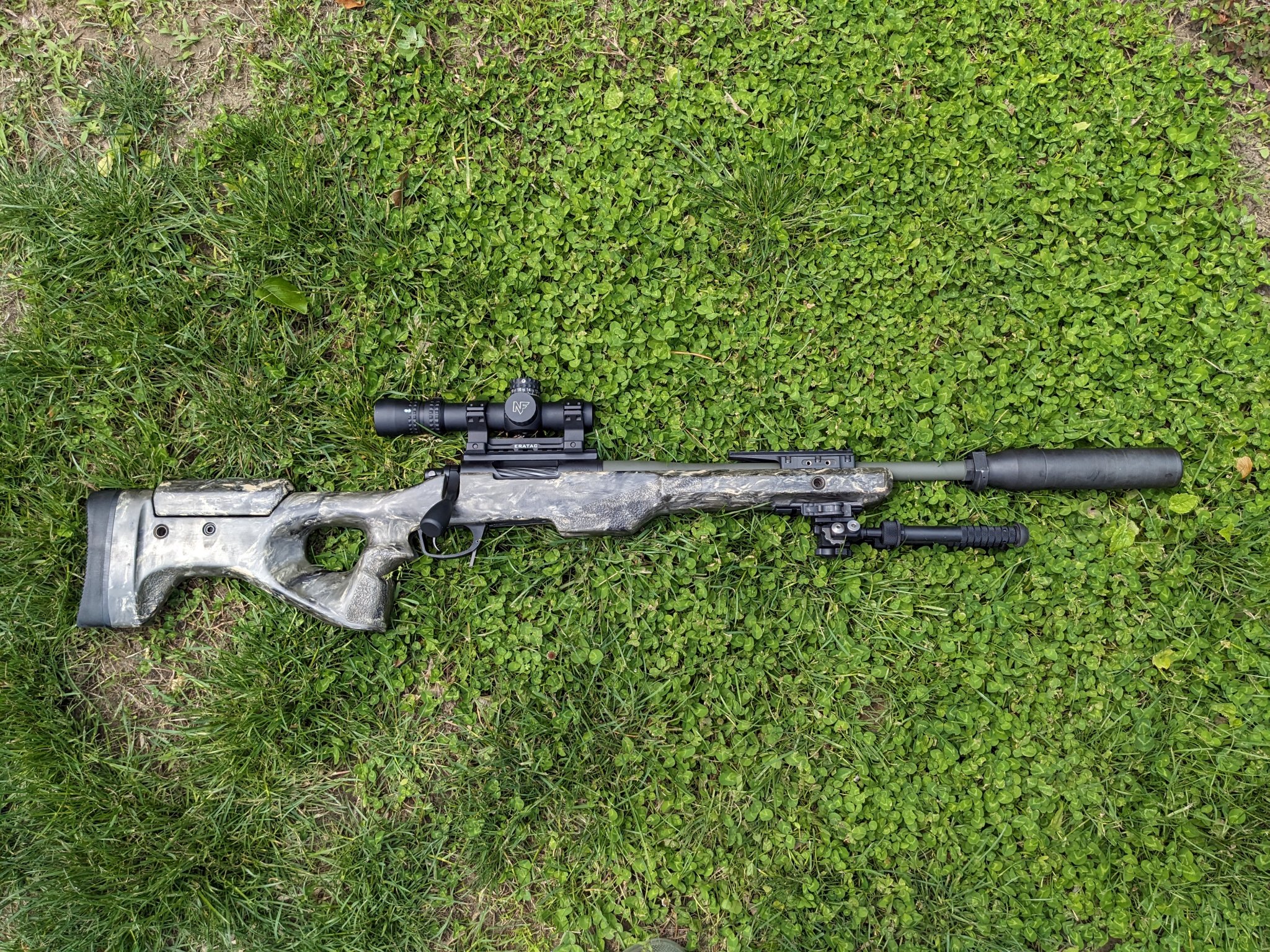

    Built a 16" 300blk bolt gun with a Wilson barrel. Figured I would start a thread here to share the load data journey.
    With the limited data on N110, I did a quick test to see where the limits of the charge would be using Hoosier 220gr lead powder coated bullets and Noslers 175 Custom Comps. I shot 6 loads of each. Figuring this would also be barrel break in, I used crappy Ginex primers in the Starline brass.
    I forgot to adjust the settings on the chronograph for the 7.5gr 220 load. Was surprised at the 8.0gr 220 load (Velocity of 1089fps SD of 7), seemed to shoot close to an 1" at 100 yards. More to come there. Gun didn't like the Noslers lighter bullets as much.

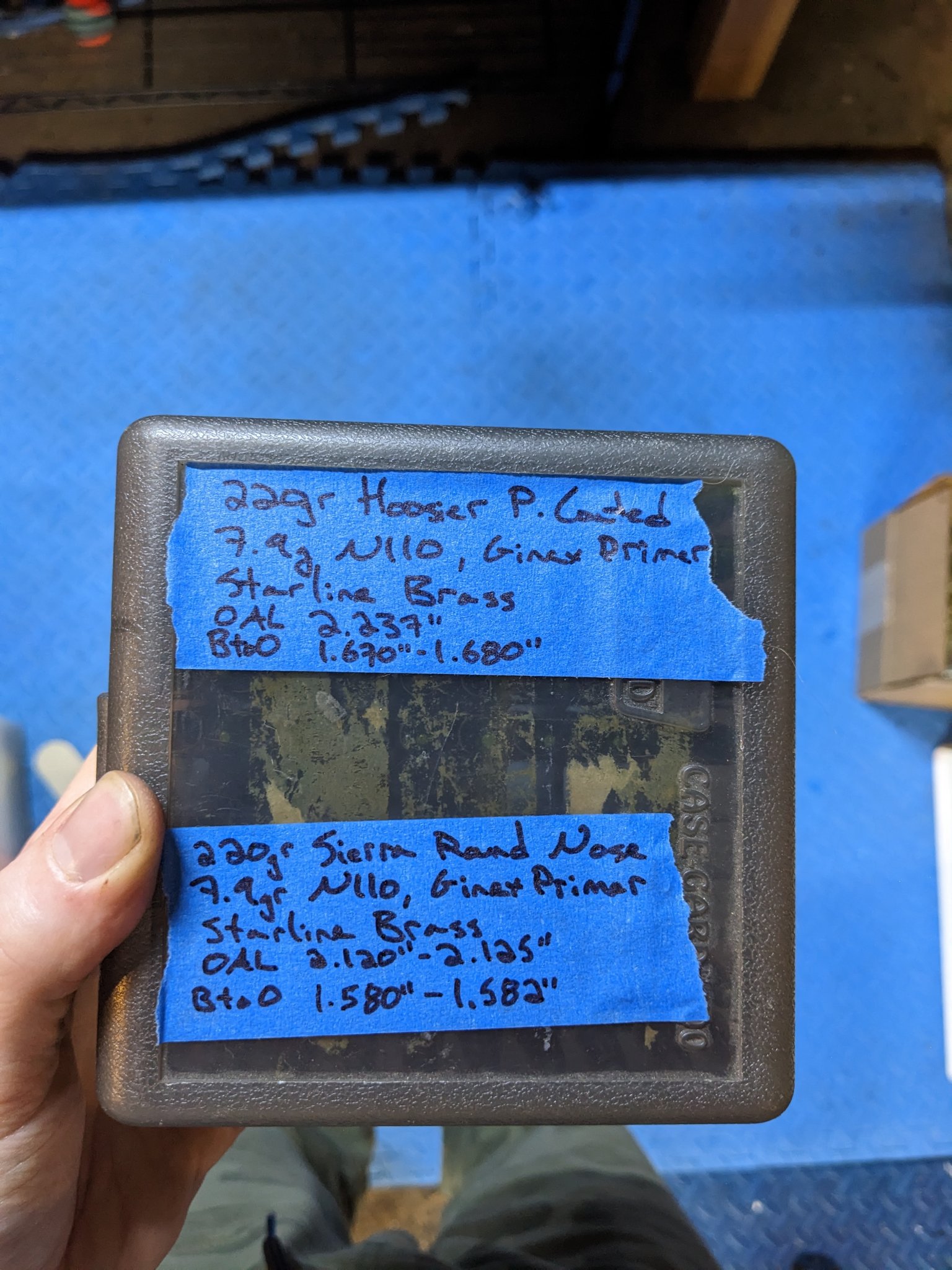

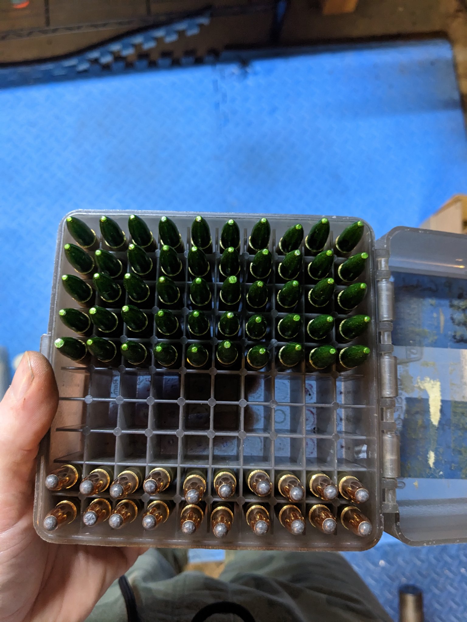

    Test loads for tomorrow. The Hoosier bullets have a ton of variance and you can tell some are deformed. I did back the charge down to 7.9gr to get more breathing room on the velocity to keep it subsonic.
    I'm hoping that I see similar SDa out of the two bullet types. If the Noslers Custom Comp 220gr arrive before I shoot, I will load 20 of them as well.

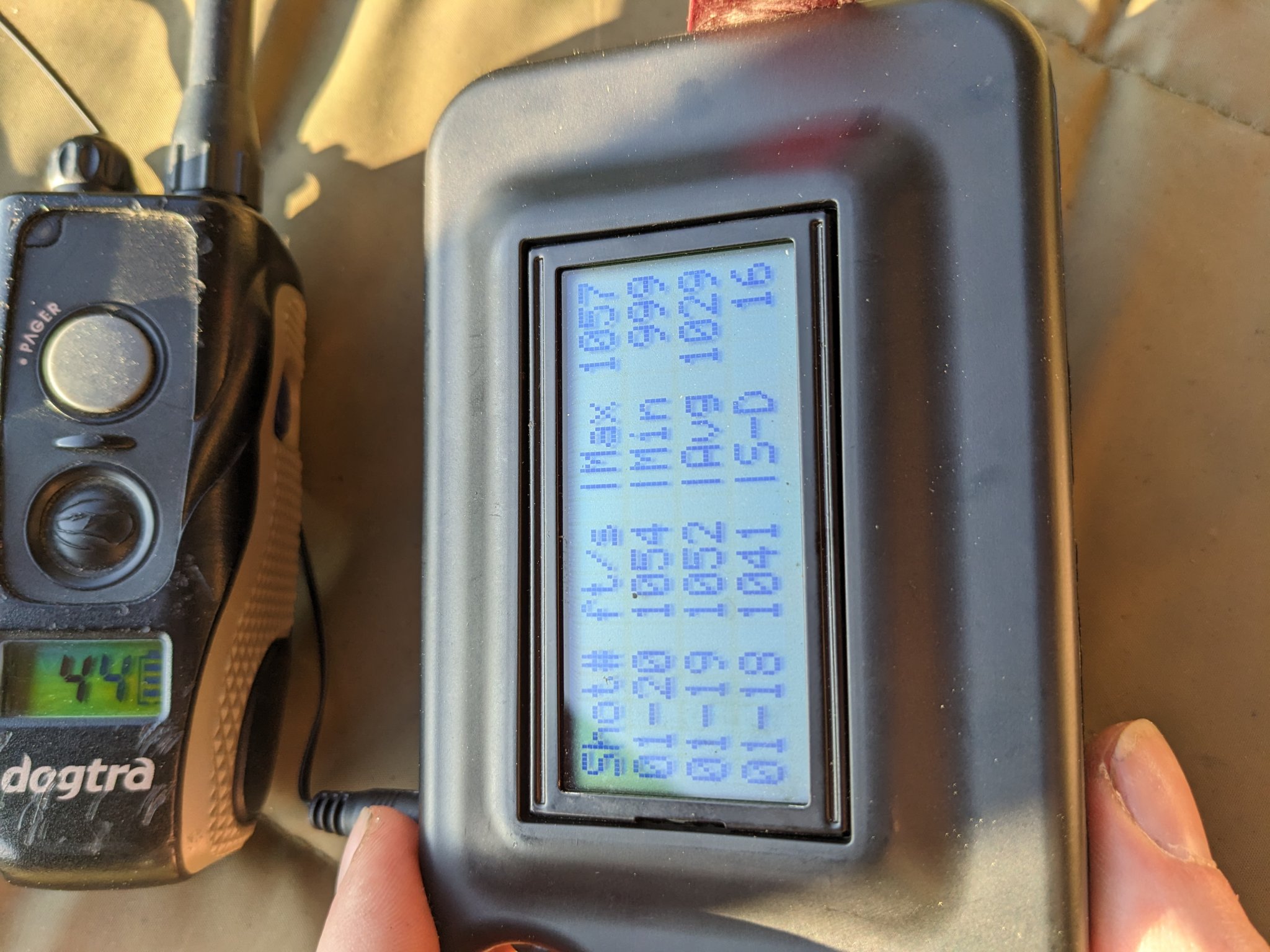

    Updates on the reloads...
    The gun did not like the 220 Sierra Round Nose Soft Points. I was getting 3"+ groups at 100, but it seems to really the 220 Noslers Custom Comp. Accuracy with them was around 2" at 100 yards but the velocity was slow in the mid 900s with a charge of 7.9. I juiced it to 8.1gr and the SD tightened from like 24 to 16 (20 rounds fired) with a velocity of 1029fps. Groups tightened to about 1" at 100 from prone with a rear bag. I am going to try swapping primers to see if the SD can tighten further, but I had no issues hitting plates at 300 yards with the load.

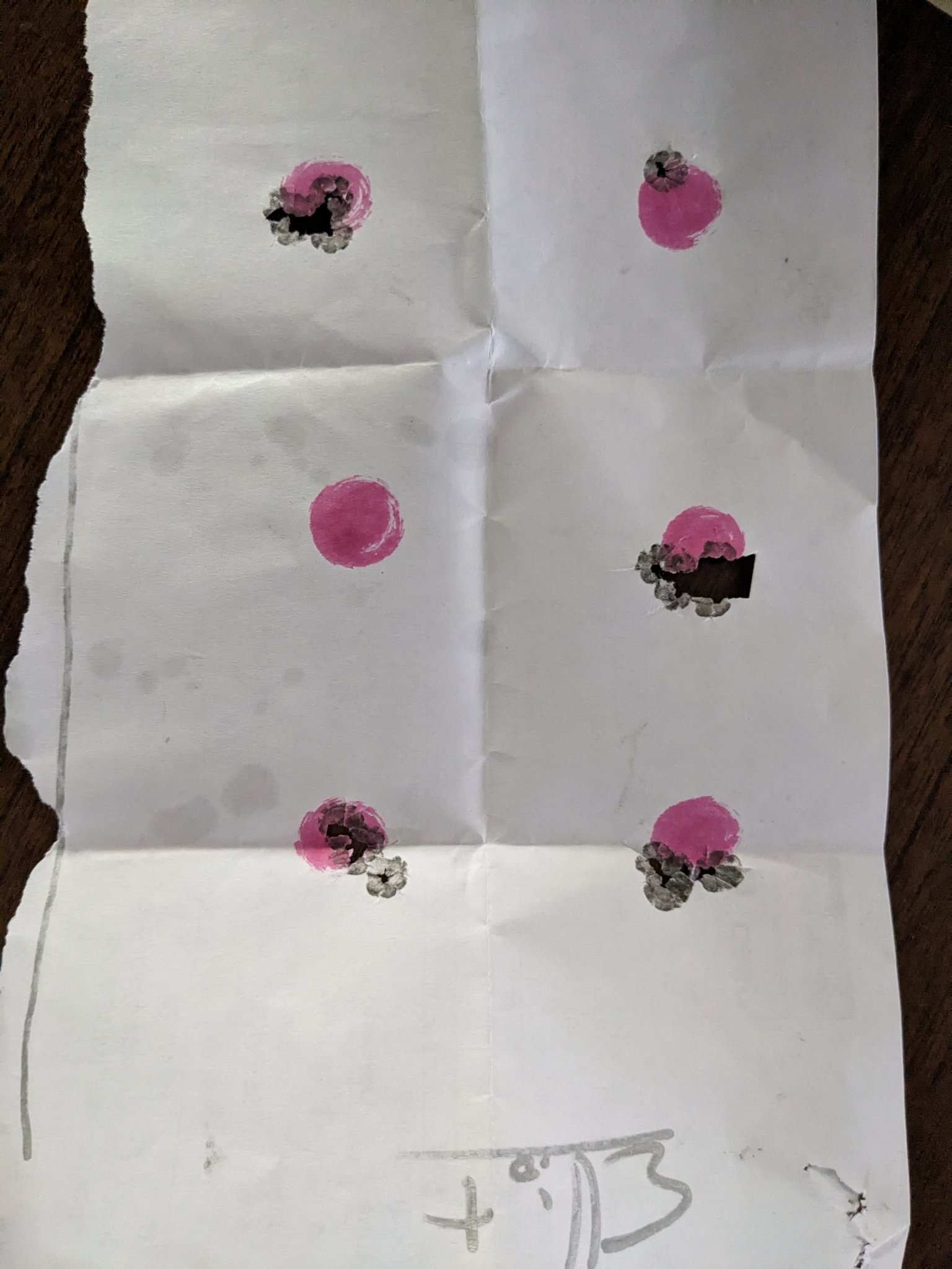

    This load flat out shoots. Loading to 2.242" OAL and 1.635" Base to Ogive. Have taken it to 630 yards.
    Groups below at 50yds, all 5 round groups from prone with a bipod. The bottom right was shot by @WillHugh, so the gun and load is consistent.

    Gun looks great. What stock is that?
