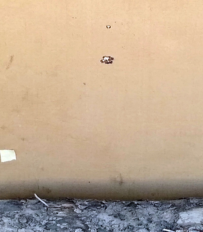

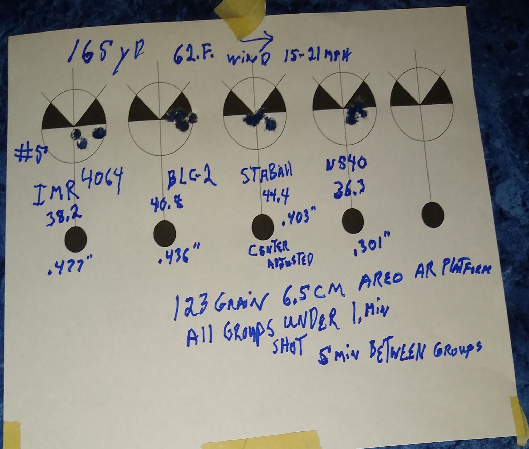

Powders N540 ,N555 Shine in 6.5CM accuracy is outstanding . Bruno shooter supply has VV N 160 for $260.00 sale now ,I personally don't care for it in 6.5 but it works well in other cartridges . Powder trials with 123 Gr. at 165 Yd and MY 129 Gr. hunting load stacked #20 under 0.5" at 278 Yd. N540 Works for ME .
