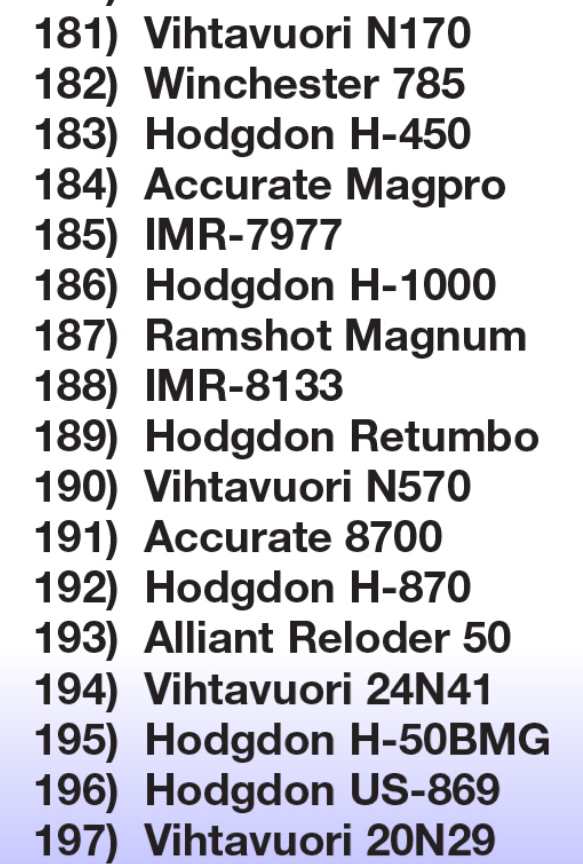

Has anyone used VIHTAVUORI N170 for loading 375CT?
I ask, as being in the U.K., Retumbo isn’t available here, but (according to my burn chart) it’s the same burn rate as N170. Hence my curiosity.
I’ll be running Lehigh Defence 353gr Match Solids and Cutting Edge 377gr MTAC’s with Reloader 50 (Elcho 50 in the U.K.) through my 35” Lothar Walther 1 in 10” twist barrel, but am open to hearing any anecdotal evidence from anyone who’s had any good results with N170 (or not, as the case may be)
