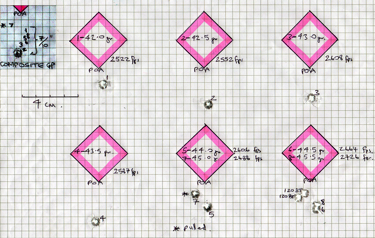

    OK, I'll be first over the top, seeing as I have just sold a kidney to buy 1kg of N555 for £90!!!! and don't even start me on what I paid for the 140gr SST heads/bullets and BR2 primers!
    I no longer target shoot. I manage deer -Fallow, Roe and Muntjac - and foxes on local estates. So, small targets out to 300-350m. I'm not out to shoot the plums off a rabbit at a mile (though the chance to try would be nice). Anyway......
    I read the Vit' data for 6.5x55 SE/Skan (41.1gr min - 46.1gr max)and loaded 8 rounds for a ladder test:
    Sako fire formed cases, batch weighed, TTL, neck sized, primer pockets uniformed.
    CCI BR2 primers.
    N555 42 to 45.5grains in .5 grain increments (did I say this stuff was expensive?).
    The max seating depth to lands is 2.505" measured from the ogive. I sat the bullet to 2.460 which gave me a calibre in the case neck.
    Lightly crimped using the Lee collet crimp die.
    Rifle is a Mauser M12 Impact chambered for 6.5x55. 20" barrel with a 1 in 8 twist. An ASE Utra Jet Z Compact sound moderator fitted.
    I shot off a bench resting on bags. Weather was Sunny, Nil wind, temp' 22C. BP 1013. Range was 100m.
    Shot a 120 B/Tip load at target 6 to check POI.
    Then shot the string 1-8 waiting 10 minutes between shots, except shot 4. This was delayed by me watching deer feeeding, so the barrel could have cooled more? Shot 7 declared by me as pulled. The final shot was another 120 B/Tip onto target 6 to check POI.
    Total shots 10. Rifle is guaranteed to shoot sub MOA straight out of the box. The targets below show that all 10 shots were sub MOA!
    Conclusion:
    No obvious velocity node.
    No signs of excess pressure.
    Perceived recoil was very slightly more than the 120 B/Tips but perfectly acceptable wearing just a T shirt.
    The 45.5gr load fill was about quarter way up the case shoulder.
    Shots 5 - 8 offer sufficient velocity (I laser the range and dial in the scope) to do what I want.
    The obturation was not as clean as the RL16 used with the 120 B/Tips. But it did not go past the base of the shoulders and improved by shot 7.
    The barrel fouling was maybe slightly less than RL16 with no copper fouling.
    Need to do a .3 grain ladder from 44.0 - 46.0 grains at 200m (maximum range on our improvised rifle range).
    Not very scientific I agree, but it shows promise. I hope it helps

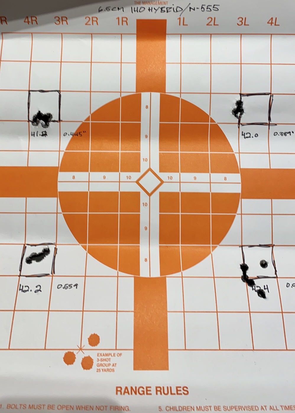

    I just started playing with this powder and it shows promise. I never used H4350 and can't compare to it, however I have used lots and lots of RL-16 to good effect. I've been trying to find a velocity node with Berger Hybrid 140's/Peterson LRP brass, and so far have only found one between 42.6 and 42.8. I loaded up 50 at 42.7 and will validate next weekend. I am not sure how temperature stable this powder is. RL-16 was pretty bad in the summer at 100+ degree temperatures, giving ungodly velocities and blowing primers in a known good load before, as well as being a carbon-cake maker in my barrel. (I may have had carbon ring as well, to compound the issue, that has since been removed and is being managed)
    However, N-555 wants to shoot well. It's much cleaner than RL-16.
    Resulting target with differing charge weights which I needed to fill in my Satterlee test entries missing from a previous session which failed to trigger the Labradar. (which is why some charge weights are skipped on target)
    I shot 5 shot groups in round-robin fashion (1 shot at each charge weight sequentially with a 10 minute wait in between every 4-shot string. (I will update with velocities when I get home to my notes) I believe the 42.0 charge yielded avg. velocity of 2820 and SD of 6.0 but I'll update that later.

    I know this is a bit old but for what it’s worth I tried N550 and N555 today in a 6 arc bolt gun. N555 was way slow and full to the brim. The N550, on the other hand at 30.2gr was 2780ish from a 22” barrel seated at 2.300” - no room for more powder.

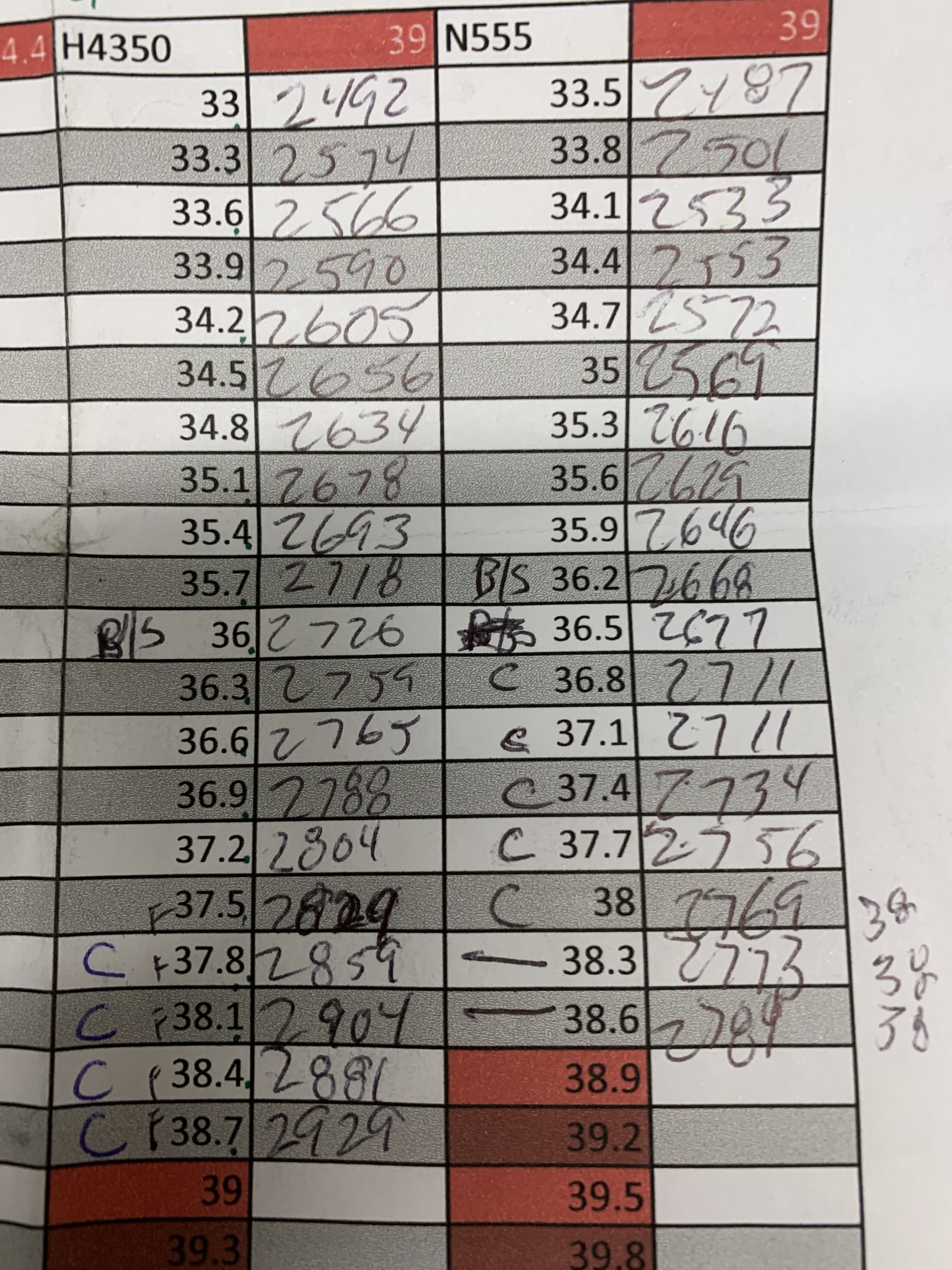

    I didn’t do any development with it as the H4350 met my needs and I have a lot of it. I shot one 3 round group with the N555 @ 38.0.
    2769 2673 2689 It grouped pretty well. To not derail three thread here. I started one for the 25GT

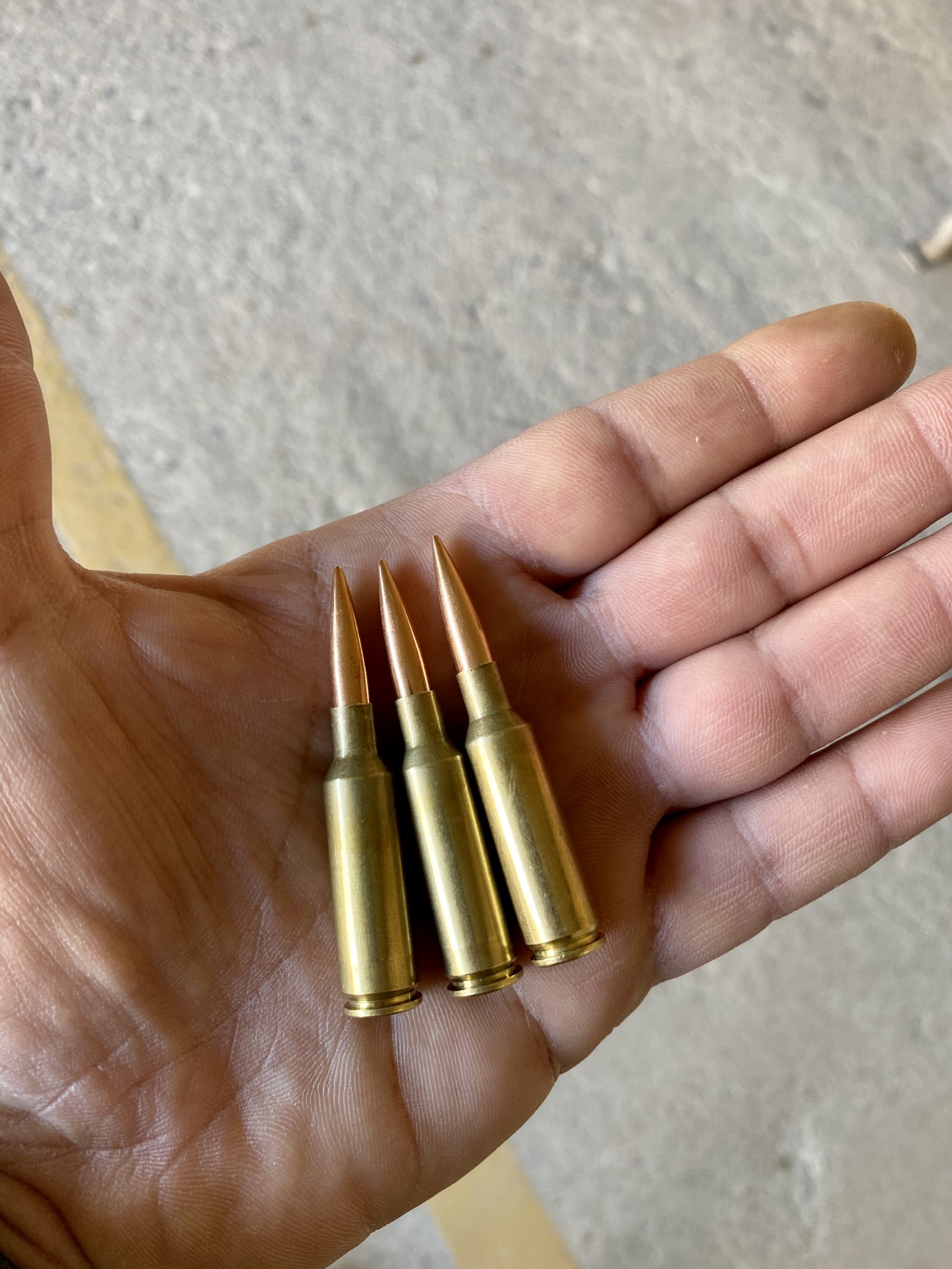

    The 85.5gr Berger Hybrid shoots very well for me loaded 1.818” base to ojive (2.368” coal).

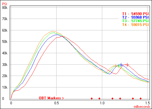

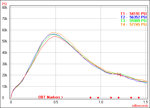

    I have a pound of N555, but haven't shot it as of yet. In my 300 WM and my prototype 153 gr bullet, which favors the faster side of the 4350 burn range due to the thicker Gunwerks brass used, low friction, and a long tail, I started with N550 as I thought N555 would be a tad too slow when compared to prior RL16 and H4350 results and in speaking with VV directly. All my VV powders are newer lots from late summer of last year during the buying frenzy that occurred then.
    I had high hopes for this combo. I simply shot a four shot workup at a temp of 64F, moving up one grain with each shot, extrapolating data from different resources as load data for the 300WM and a 150-155 gr class bullet isn't available for N550 (or N555). This first iteration was just to get a gage of where this powder was at with this combo. Velocity was acceptable, not earth shattering, but acceptable (top end was 3402 fps). I hit the upper end of what I'd consider my personal threshold on pressure in the load up sequence, and it is well below when pressure indicators exist (I have a pressure sensing system to gage actual pressure over time, see graphs below). I actually didn't expect to see pressures that high in the first four shot workup, but velocities were what I would have expected, so, in combination, that was a bit of a downer. Several problems existed as can be observed from the wild pressure traces in the graph. The most prominent is the secondary spike towards the end. While there are many things that can create this phenomenon, two things typically contribute to this, a double-based powder, and a powder too slow for the combination. In this instance, top end case fill was probably only 97% and it was a tad higher pressure than what I'd like to run for a hunting combination, so if anything, it was on the faster side for that combo. The double-based nature of the powder is probably not doing me any favors in this particular instance, but isn't necessarily the only reason as previously mentioned. The low friction plays a role for sure, but low friction is a good thing for increased velocity and reduced barrel fouling and heat in general. In summary, "large case - light bullet" in a moderate overbore like the 300 WM, I wouldn't recommend N550, or probably N555. With a small case and heavy bullet, like the 308 Win, or possibly even the 6.5 Creedmoor shooting heavy pills, probably a completely different story.
    300WM - Gunwerks - N550 - 153gr - 64F
    Back to the N550 work up, the group on paper wasn't fantastic, and the muzzle exit times (crosshairs) from the graph correlate with that. Yes, these were all at incrementally higher charge weights, but the beginning of the ignition phase was inconsistent, which then really destroys the rest of the timing out the muzzle. The bullets were substantially crimped with a collet crimp die and far off the lands, so this area, the ignition phase itself, should be very consistent, in general, and up to about 7 ksi, they all ran together, which is about where the bullet started to release. I've also attached two work up loads, one for H4350 and the other IMR4350, as a comparison to show what I mean for a consistent profile.

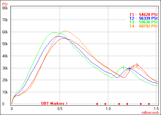

    300WM - Gunwerks - H4350 - 153gr - 89F

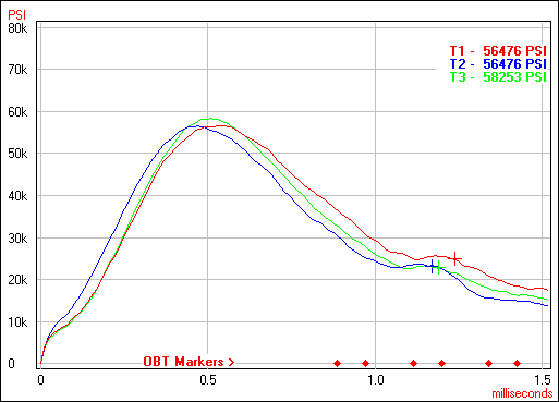

    300WM - Gunwerks - IMR4350 - 153gr - 89F

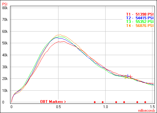

    Not to veer off the VV subject too far, but also attached is RL16, from two different days, both identical work up loads as well. I missed the first shot on the hot day, so it only has three showing. Don't correlate the colors between the two, but rather look at last charge weights and work upwards, graph to graph. Any of you ever wonder why when doing temp sensitivity studies on RL16, some have reported a decent jump from low temp to mid temp, then at high temp, the velocity goes LOWER again? So the total spread from low to high is very low, but it looks like a bell curve, not a regression line. Well, as far as combustion dynamics are concerned, I can at least show what's going on, even if I can't explain it. Strange indeed, and has made me move away from RL16 for this combo as well. Unfortunate too, as at 3450 FPS, it had real potential in 90F heat. It wasn't as consistent as IMR or H, but it was a bit more consistent than shown below when loaded to the same charge weights. It was around 3470 FPS at 64F with mediocre groups.
    300WM - Gunwerks - RL16 - 153gr - 89F
    300WM - Gunwerks - RL16 - 153gr - 64F
