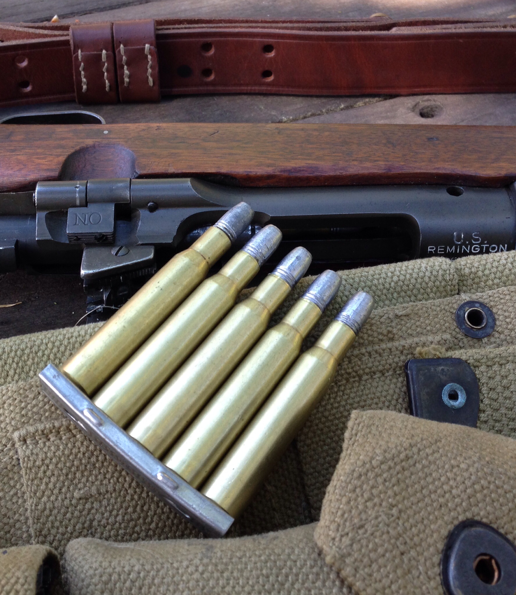

    My favorite load for my Remington Springfield 1903A3
    My favorite handload for my Remington Springfield 1903A3 consists of a 150 grain flat nose cast bullet from a custom Lee mold.
    I use CCI200 primer, R-P case, 20.0 grains of SR4759.
    Off the bench resting on bags I can hit a 6"
    square regularly at 200 yards.
