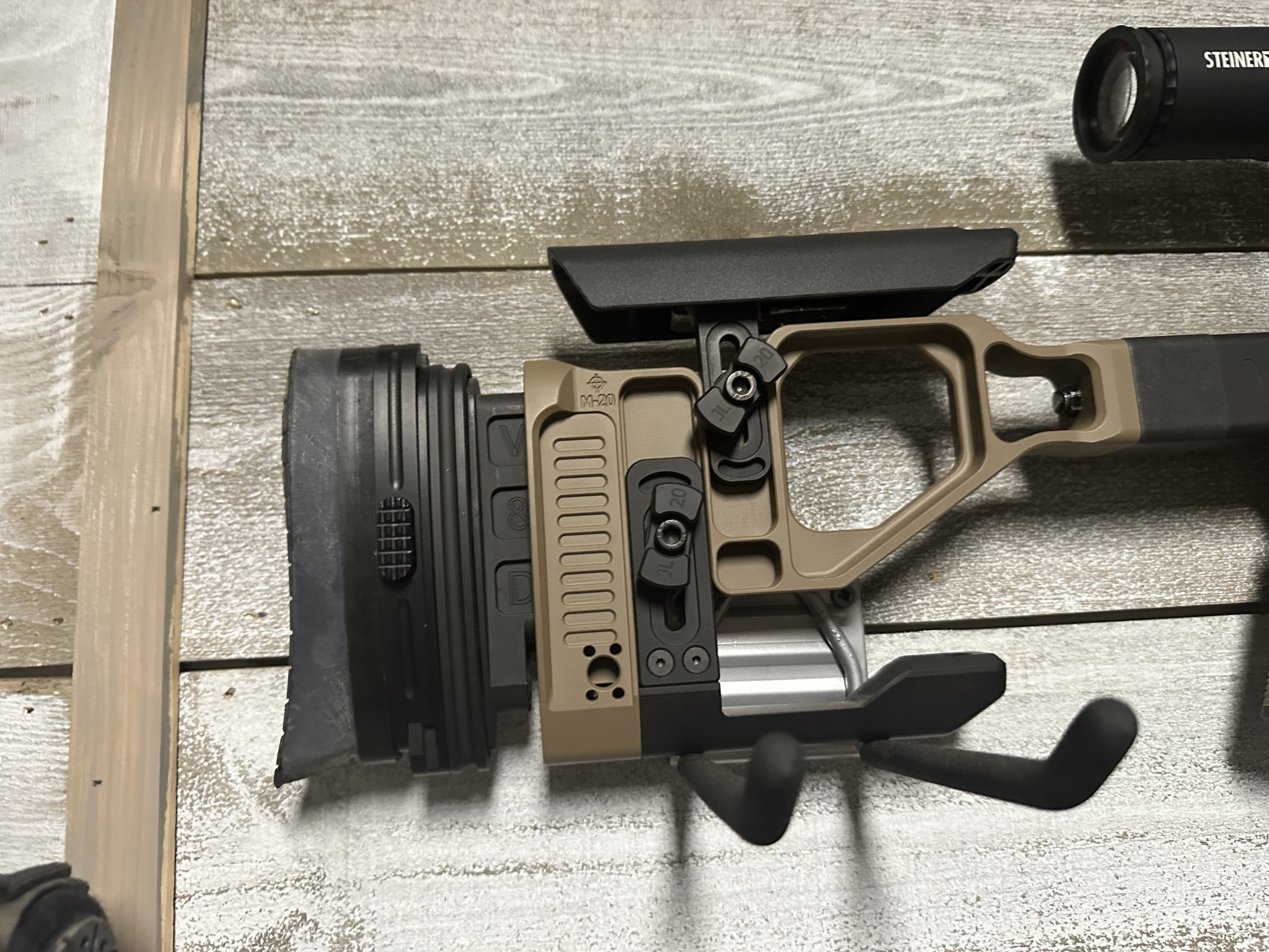

This is one of the first Visions that came from GCP. Not sure if it’s the same as what’s coming in now. The original butt pad had the knurled knob embedded in it that was used for cant adjustment. I never needed to cant it and it hurts on the collar bone so I drilled and tapped the metal plate to accept an AI butt pad. The shape of the pad/spacers is almost perfect and if I remember correctly one of the screw holes lined up. I just needed to drill and tap a hole for the other screw and it looks like it was made to go on it 🤙🏼. No cant adjustment now but I don’t use it on this rifle anyway.
Believe it or not the cheek piece is from a Bravo, strange but it works really well. This was a little more tricky as I had to make a bracket for it to work. I don’t have a lathe or a mill so I had to do it old school with a torch, a hammer and a file but it worked out really well.
The real reason I did the cheek piece is because the original was too far forward for me. I use a really long LOP and my cheek wanted to land off the back edge of the riser when LOP was at max. When I first got it I suggested they extend the cheek piece back as far as it would go bc there wasn’t really any reason not to. There’s blank space there and plenty of room to do it. I’m curious what the new one looks like.
