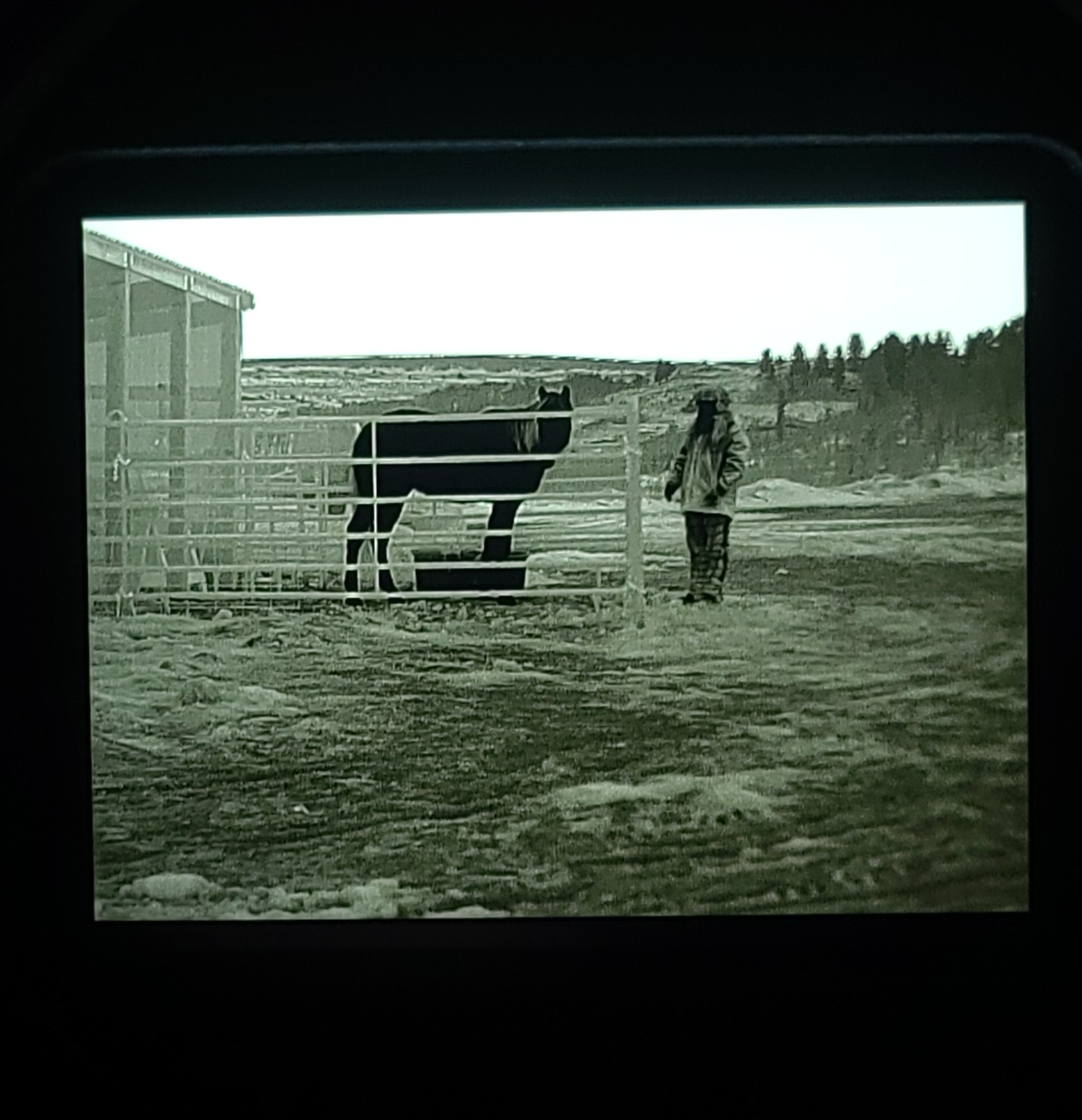

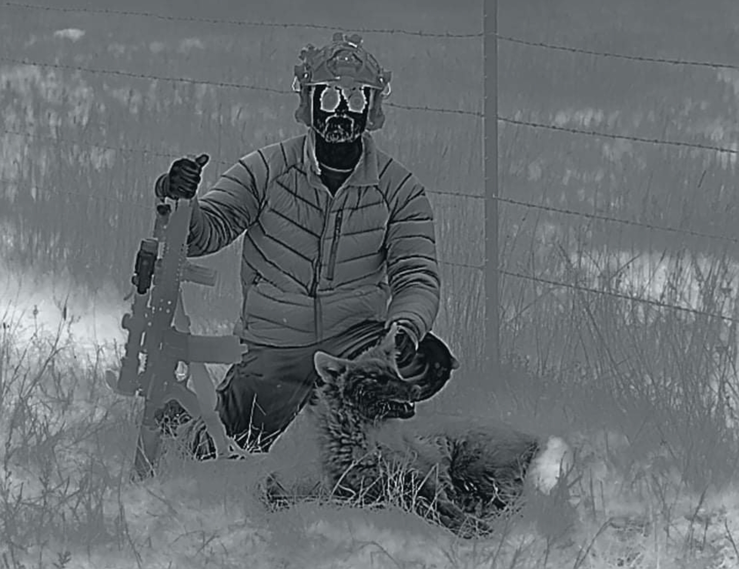

Enough words, here's some photos! The difference in color is a mix of my camera settings, using jay's SNR filter, and the unit itself (one had a bluish hue and the other more brownish).
