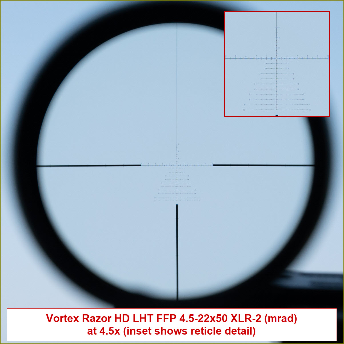

Here's the reticle at 4.5x. Is it usable, ....yeeeeesssssss... (that was a hesitant yes) but you are not going to see hash marks very well and center might be difficult with busy backgrounds (this is where the G2H reticle excels). While the illumination is daylight bright, I would not rely on it with anything but darker backgrounds at this magnification. Will this reticle be good for running coyotes at 4.5x in bright daylight, maybe not (not many coyotes in bright daylight out here, haha), but once light levels get low or on a clouded day the illumination will definitely help. If your game is stationary I do not think there will be an issue at all.
Unfortunately that's near impossible to tell as we all experience different conditions, situations, etc. that can affect the "robustness" of a scope. The only way to know is for long term reviews from similar situations. When you say they are losing zero, you mean that you set zero before a hunt, go out, shoot at an animal, but miss, and when you get back to range you test zero and it's off by a margin of error greater than your capabilities?

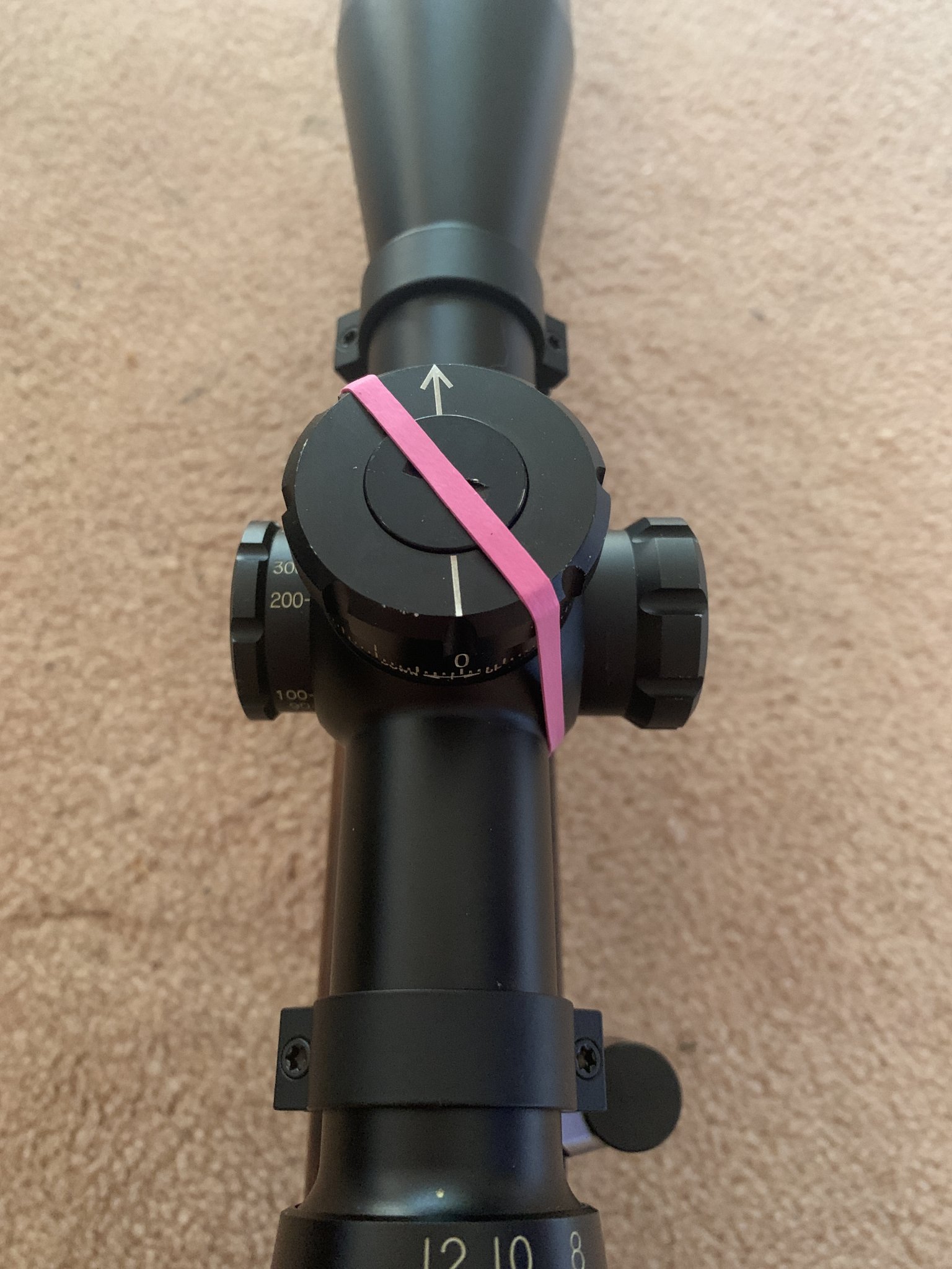

Rubber band around the tube and turret, boom.
Grip/gaffer tape > ranger bands
Just tested it. At least with the diameter of ranger bands that I have at my disposal…but the bigger problem with this hack is I can’t tell at a glance if the turret spun. With the gaffer tape, I don’t cover the “0” so I can tell at a glance.

It sounds like you want to buy a scope with a capped elevation turret to be honest. I train because what happens when your locked down turret STILL moved and you didn't catch it because you assumed it was solid? Been there, done that. Thank god it was at a stupid gopher and not a trophy bighorn. If you have buck fever to the point of consciously needing to think about chambering a round, you should be training more anyways.
And for the record: If a turret as a lock on it, I want it to require some effort. I think the LHT's lock looks too light. I just don't think you should be relying on that lock regardless of what optic.
Just got mine in.
I've never had the turret on my LRHS spin on me and I've carried that plenty while hunting. For me the light unlock of the Vortex is a non-issue.
Turret feel is a little disappointing for something that says Razor on it and especially with only 6 mils per turn. It should be a lot more tactile.
Have not had a chance to really look through glass but I did spend some time with the reticle at various powers. I like the general thickness of the reticle, however they should have made a bigger center dot. Even at 12X I can't really make it out. IMO they need to get rid of the .2 hashes closest to the center dot. Makes the center too cluttered and difficult to use, especially at lower power. This is my biggest gripe and potentially a dealbreaker for me. I'll mount it and use it before I decide whether or not to replace my 3-12 LRHS with it.
