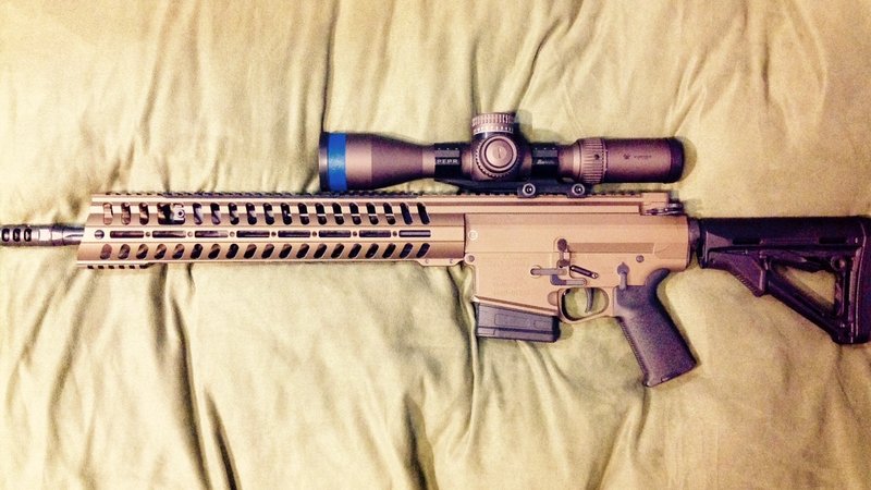

I have two Gen II 3-18X50 I do like it ( on my POF P308 AR-10 & HK MR556A1 AR-15 "just for try it " ) only bother me is weight 3 lbs

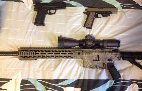

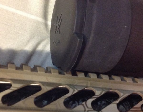

This is finally set up for this scope ( Vortex Razor HD Gen II 3-18X50 ) on NEMO XO Carbon 308 20" barrel ( Ultra Accurate Precision .308 Patterned AR )
I'm going to say, you choose wisely!!!

"" Nice Job mounting it low ""!!!!
