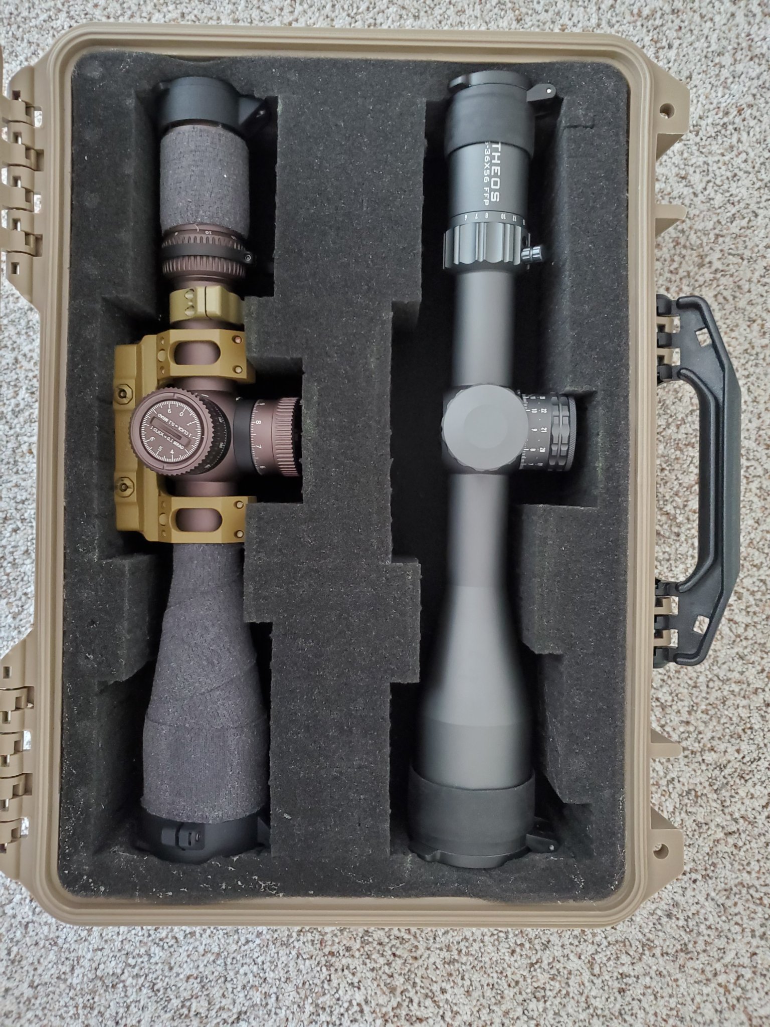

The Element Theos 6-36 is the new turret king. I will compare my Theos to my Gen III in another thread as they share many similarities, in some ways its possible they are the same optic coming from LOW. The quick and dirty of it is the Theos has the best turrets of any alpha level optic, and the Razor III has some of the best glass.
Better than Theta?! Shut the front door......They may share the same physical dimensions but the FOV numbers are different, the element has 7mil less internal elevation. Things are definitely different. You lay a 6-36 S3 Zeiss next to these 2 and it looks the same as well. Low prob has em all being made in their facility. There are three different scopes available on the same frame as the S3 4-25, Tract and another company out of S Africa. That one's a blatant give away when you see 40+ mils on dial in a short body, clone give away.

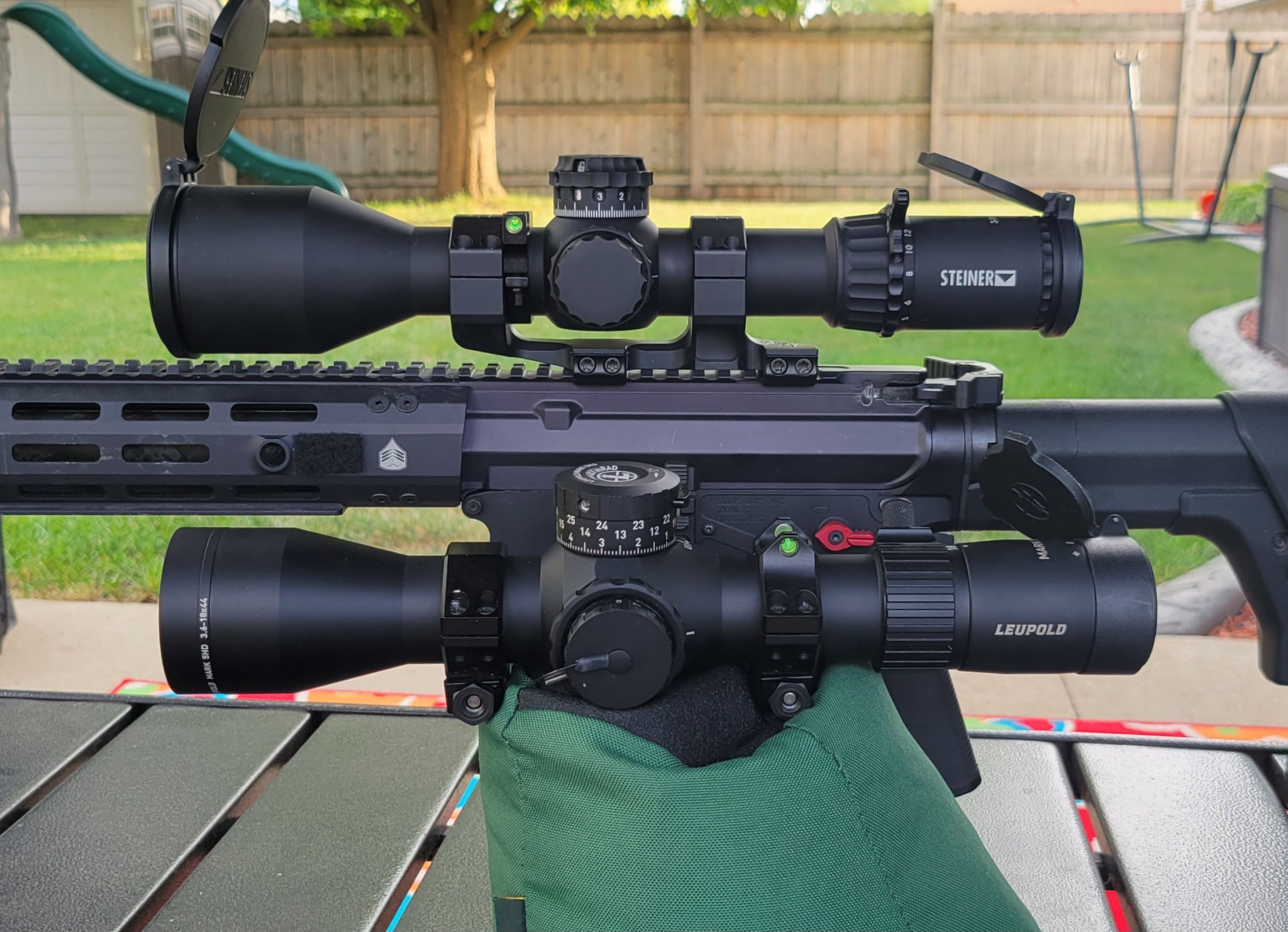

I've got a t6xi msr2 on my suppressed 6cm hunting rifle(like the reticle!). Under recoil impulse the targets is typically 0.5 low and 0.3 R of center. I had a razor HD LHT 4.5-22 on it prior with a tree, the tree didn't obscure things. But we all have our preferences. Brakes with top ports typically keep targets at center of reticle line, some even a bit above depending on rifle balance in my use.
How do you like the T6xi? How is the glass and tracking? There is not a lot of information out there on the T6 series. This is an optic I have really been wondering about.
I like the fact that Steiner does the MSR and SCR both.
I like it quite a lot. It's the 3-18 model. Eyebox and depth of field are very forgiving. Good glass, tracks true. Turret locking mechanism is different. Turret clicks have never been a win for Steiner/Burris(haven't touched xtr pro to compare) these aren't great, some what similar to a quieter less tangible atacr turret. Not bad at all, just not gonna make you say "oooo these are nice".
