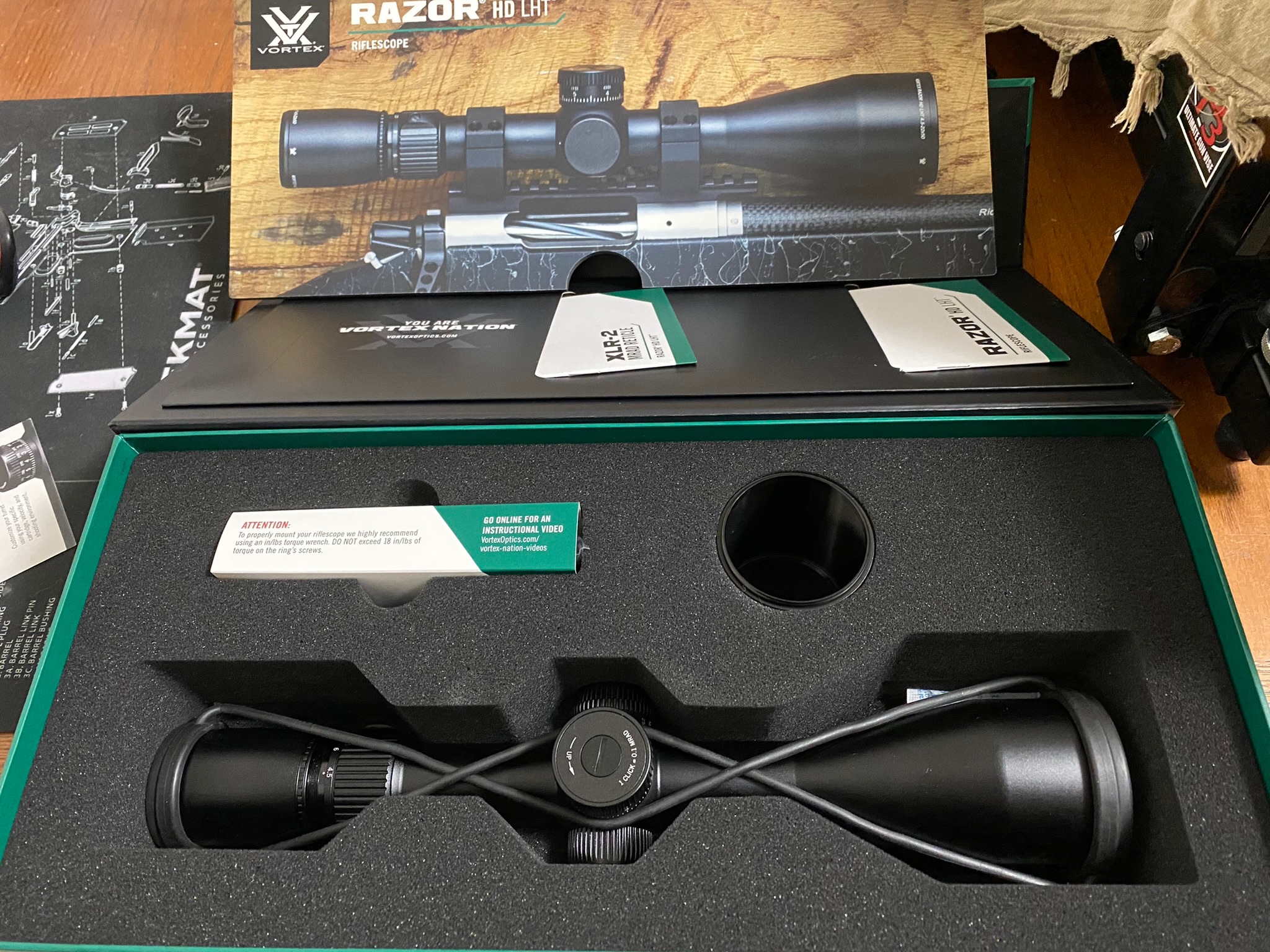

Mail call......Looking forward to hunting with this glass!

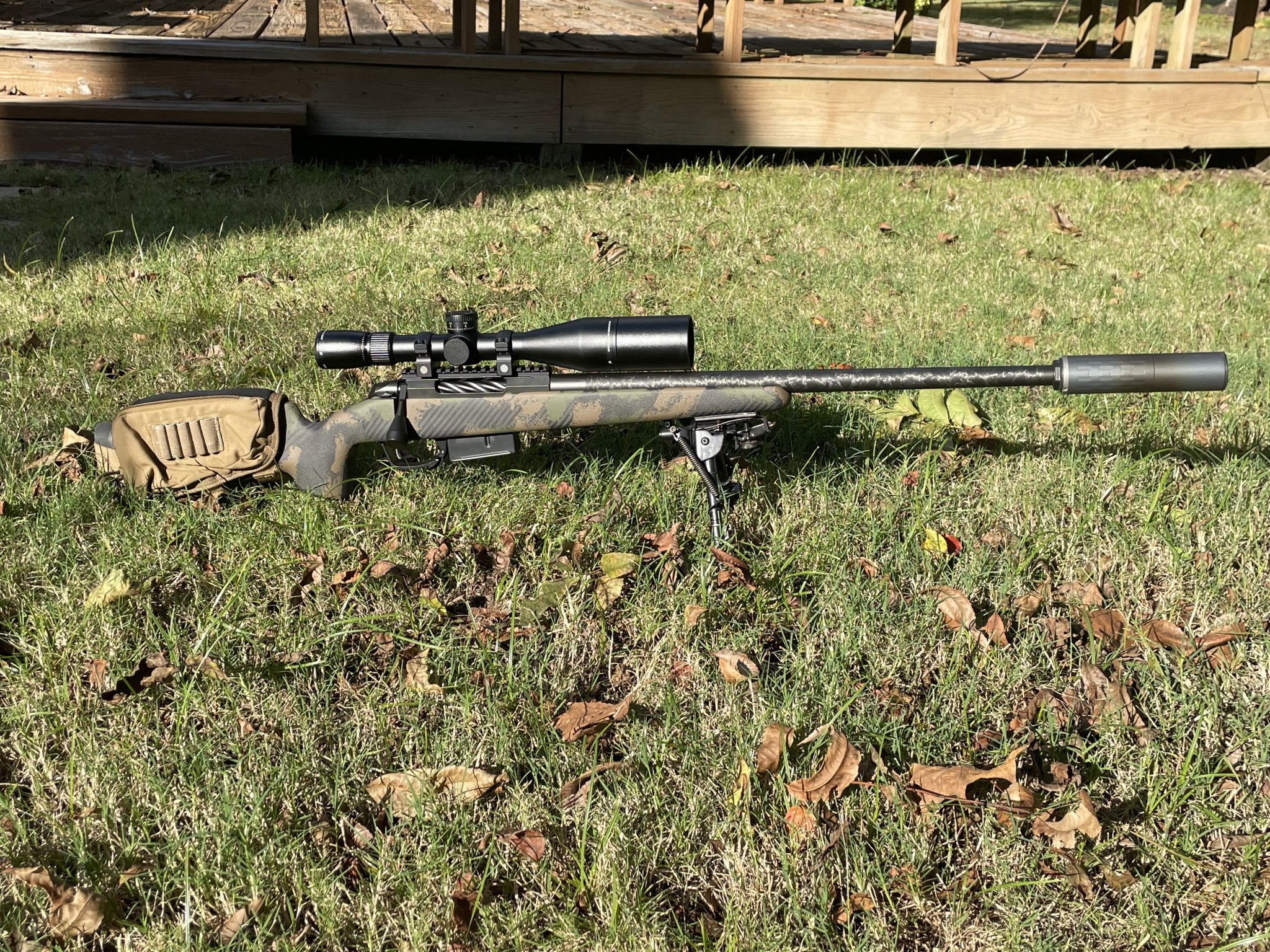

I’ve given thought to taking the AMG off my 7 Sherman short and putting an LHT on it to save 6oz.
