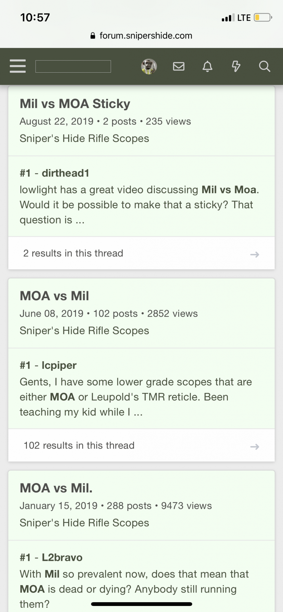

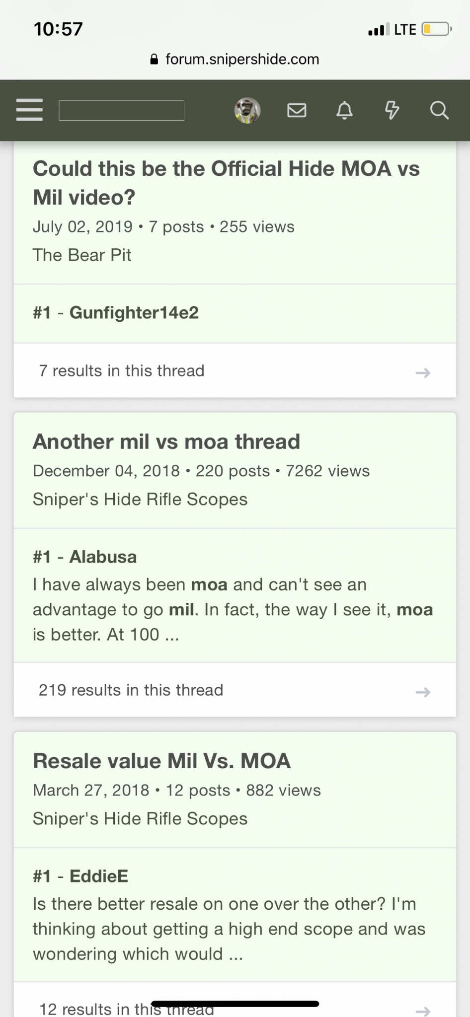

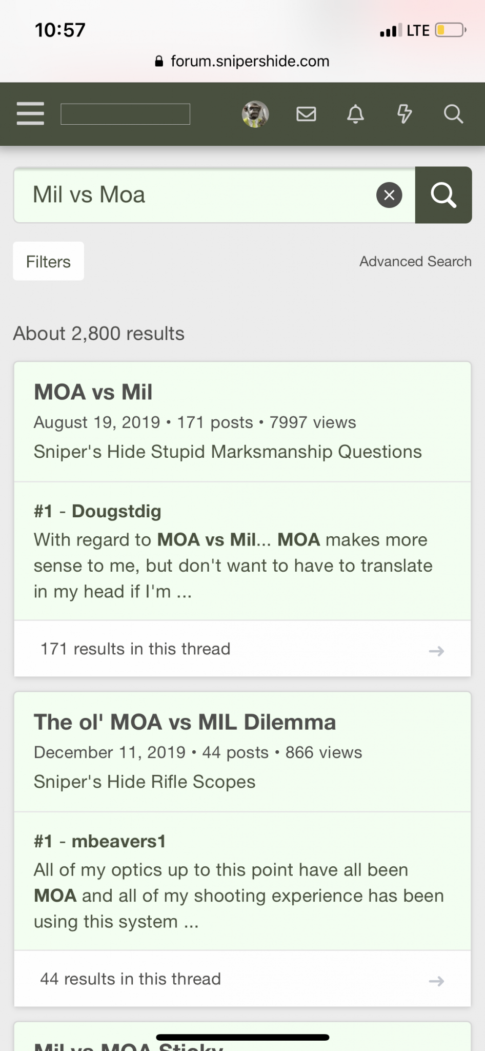

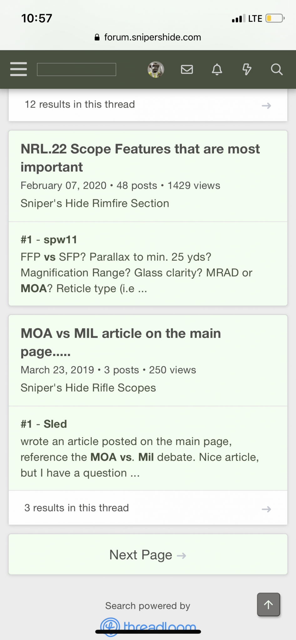

For the love of all that is good in this world....
Before you go mil or moa, go to the search function.... This is the most dead horse beaten topic on this whole site.....
Also, we need you to post a pic of your field gear before we go any further. Thanks!

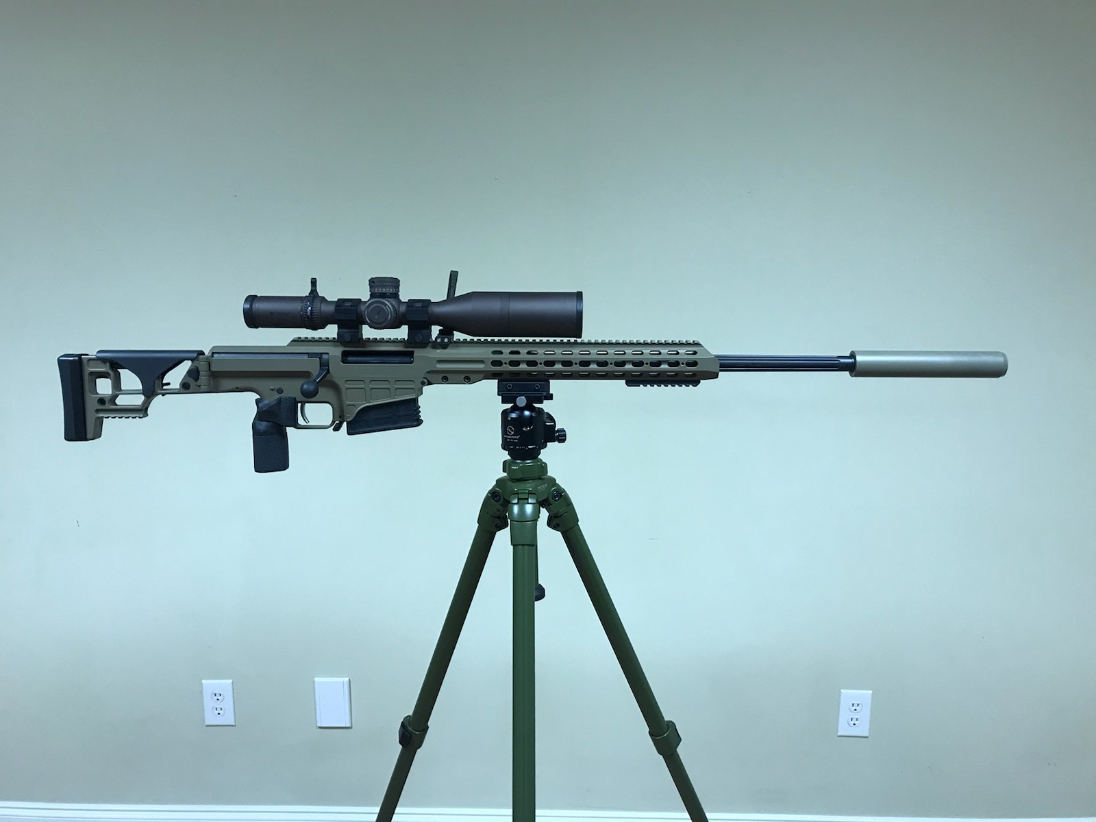

Thanks - here is my main ELD gear.
Barrett MRAD (300PRC/6.5CM/338LM) - Vortex Razor EBR2C MOA - Barrett AM30 suppressor - MPA grip
Mounted on PIG tripod w/Arca Swiss adapter & 52mm sunfoto ballhead

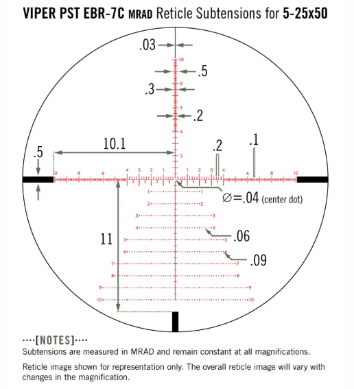

Does that scope have a reticle? If so and if it has subtensions and isnt just a duplex then that is the fucking ruler you nitwit
See this? This is the ruler
Notice the units are in mils (or moa if you wanted to choose that version) and not any linear-measurement-at-a-prescribed-distance? Thats because they are in angles and angles dont change with distance. So converting it to distance is only creating work where none existed previously.
So instead of thinking you are smart, realize that you are an idiot who is arguing about something that he doesnt understand (which is clear to everyone else in the thread).
