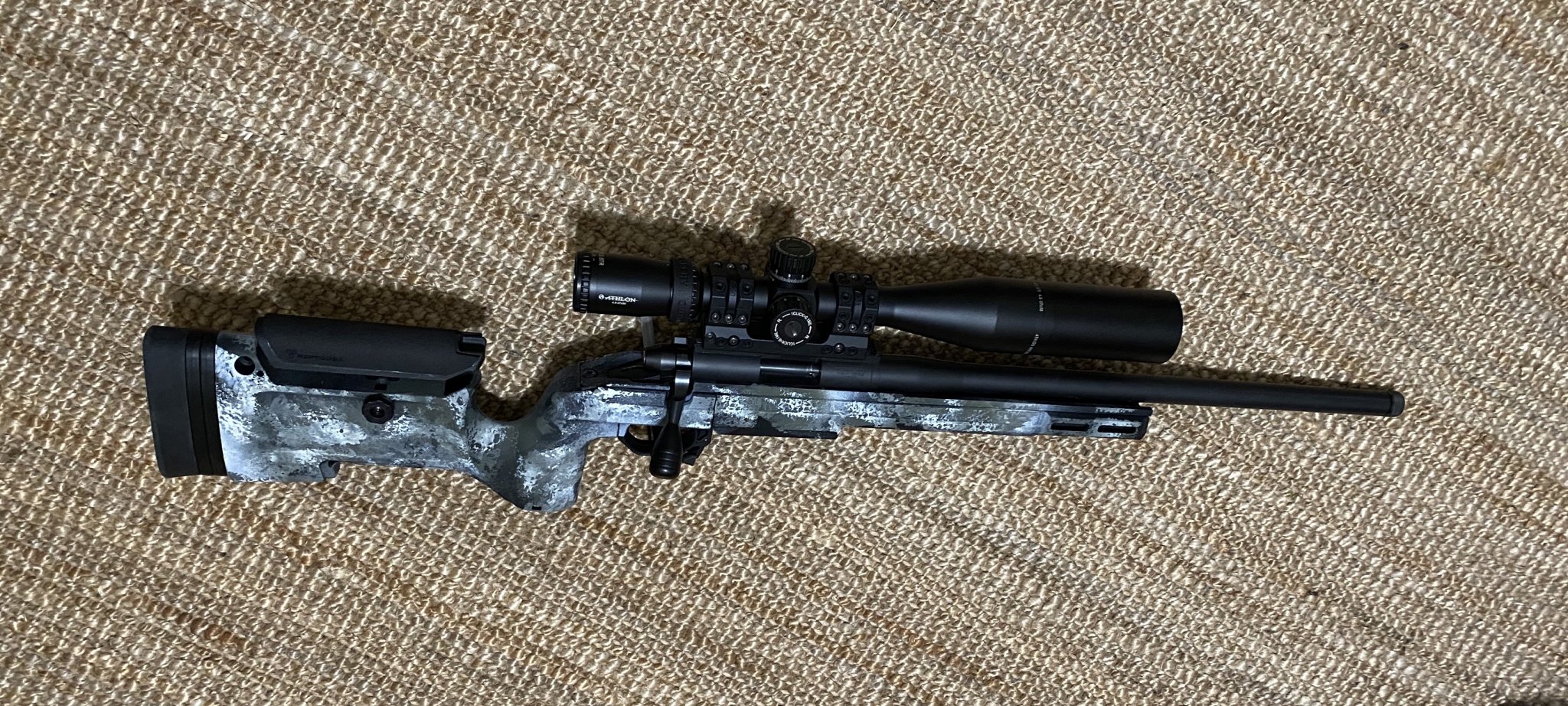

Starting the paperwork on mine tomorrow! Setting it in to a KRG Bravo that is already here. Fingers crossed no hiccups with the TT Diamond.
Same setup here. Got my Vudoo BA and Bravo last week. A419 had a delay with their TT Diamond trigger order, so still waiting on my trigger to arrive.

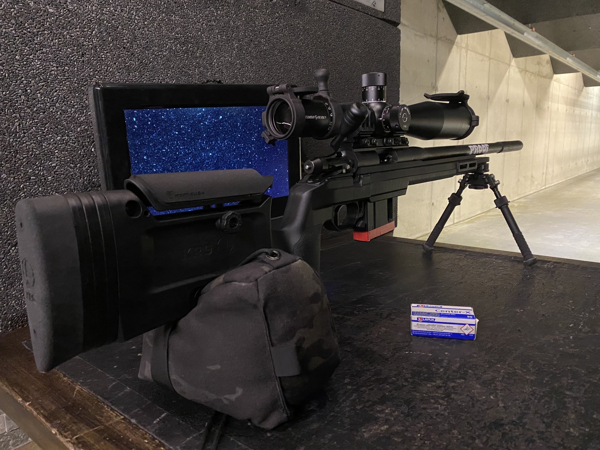

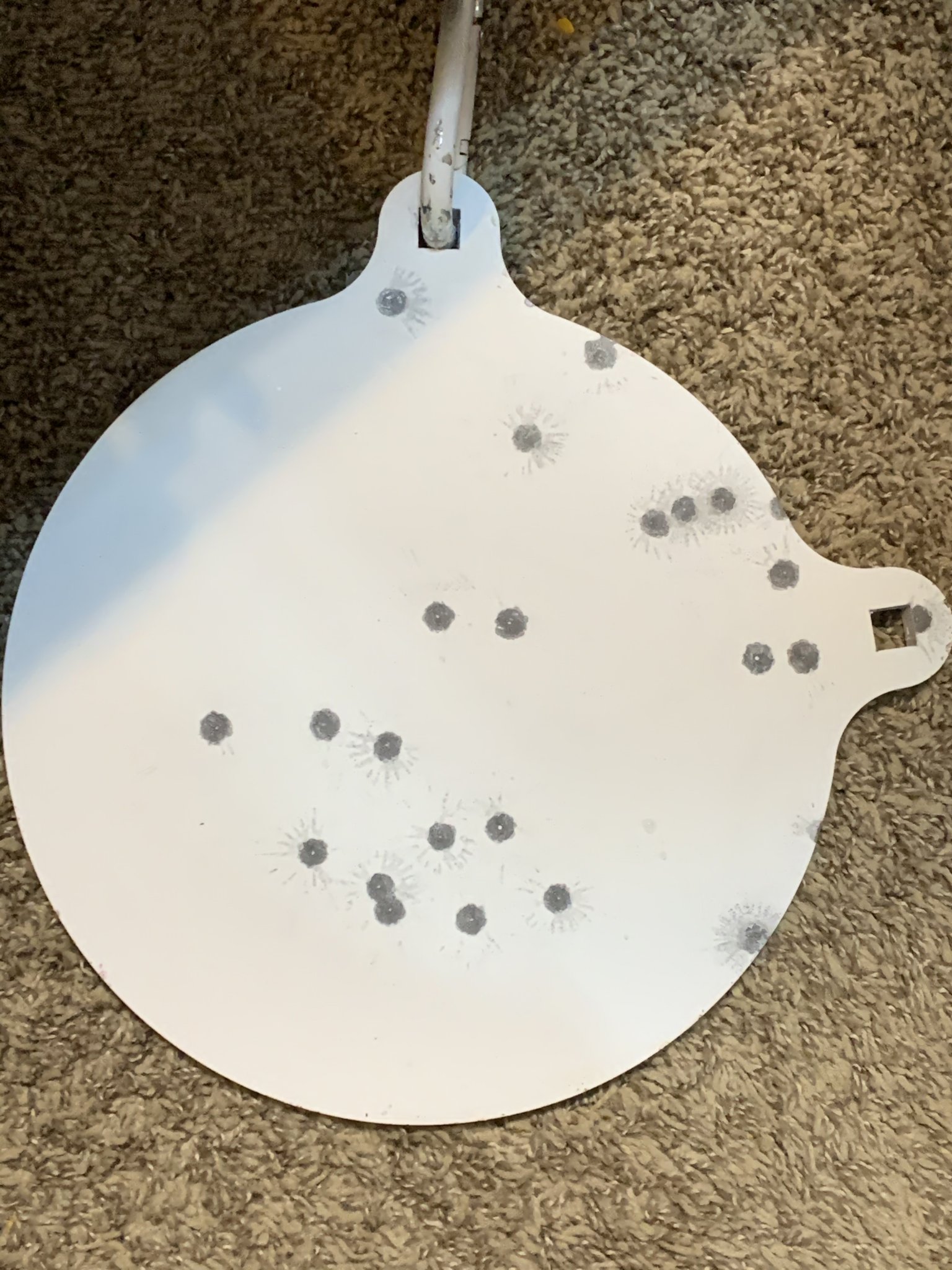

Finally, it's finished and in hand! 18" MTUish contour, Trigger Tech, McMillan A3-5, Vudoo DBM. First day results, Wolf Match Extra is a no go. Won't chamber 70% of the time. Tried it in all 04 of my mags. Switched to SK of various runs and Lapua of various runs. Feeding issue resolved! Switched back to Wolf at 600rds, again, no go. So Lapua and SK only so far. Will continue to try the Wolf as I put more rounds down range.

Mine was super tight with Eley products, Took about 1000 rounds to loosen up. A buddy is sending his back for repair. You'd break the bolt before most eley would go in his. Our actions are considerably different. Bolts, bolt release... About a month apart in purchase.
I got my rifle in February and it will not chamber Eley ammo well either. This really stinks since I have about 6k rounds of Eley ammo. It is a little better since I got it but I still wouldn’t consider using Eley ammo in a match. Right now I’m stuck with SK/Lapua ammo which I don‘t care for. I’m hoping that as I shoot the rifle more I will be able to feed Eley ammo. When Eley chambers correctly it shoots great you just need to really slam the bolt home to get it to chamber. For now I will keep shooing my Tikka in competition since it will chamber Eley ammo flawlessly.

Looks great! I might have to venture out to the hardwares store for paint. Did you clear coat it after painting? I'm waiting on my TT Diamond to arrive from warranty replacement (the safety stuck in the safe position), it was shipped yesterday. Athlon 10-40x56 should arrive Friday. Slowly getting there, and the range opens Saturday. Hopefully, I get to shoot it next week.
I've read the V22 chamber was designed fo SK/Lapua ammo. I think Eley and CCI SV was the longest overall length of any bullet I measured, might explain why it's hard to close the bolt. It's probably pushing the lead into the rifling.
Still need to add a few more details then clearcoat. I used the Rustoleum camo paint. For the money I prefer the Krylon stuff. Nicer texture.
I have had some of my best groups with cheap eley and CCI SV (but only after 1000 or so rounds to loosen it up.) Definitely feel the lead engaging. A buddy's was far too tight. He sent it back for inspection. I hope it's a shooter when it returns
