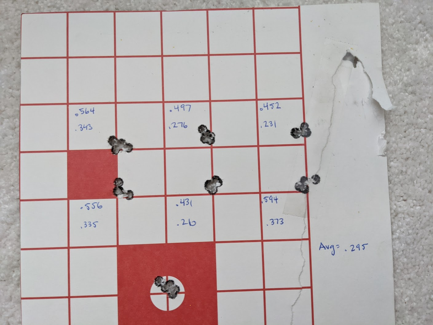

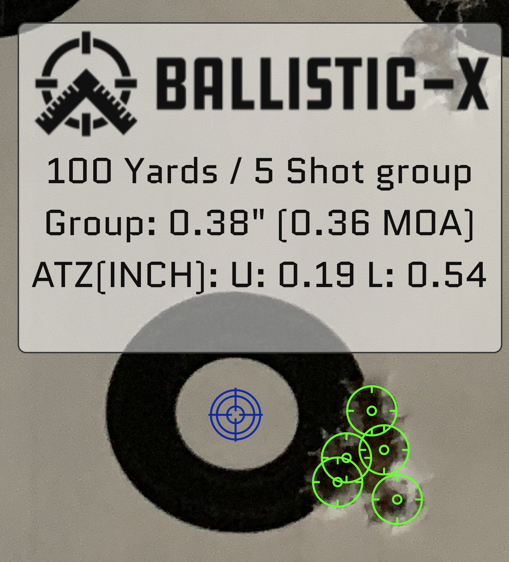

One of my better cherry picked groups. 🤠

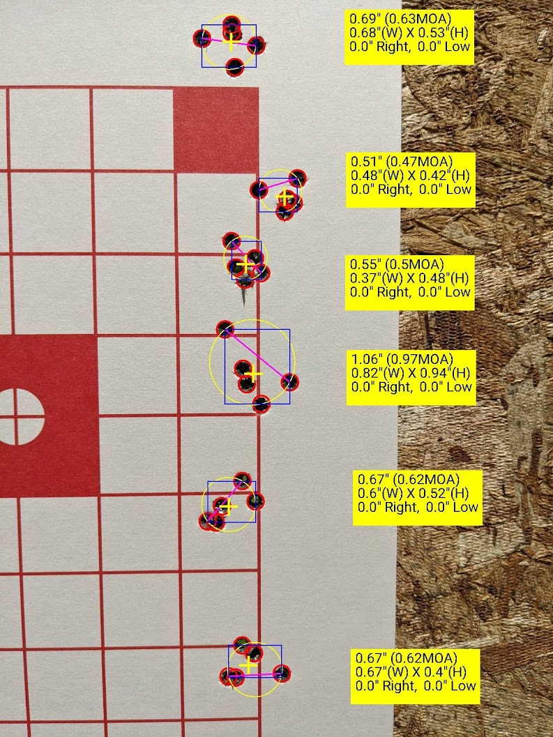

Finally broke down and paid for the Ballistic-X app. :geek:
Ballistic-X-Export-2020-05-08 20:25:29.263993.png

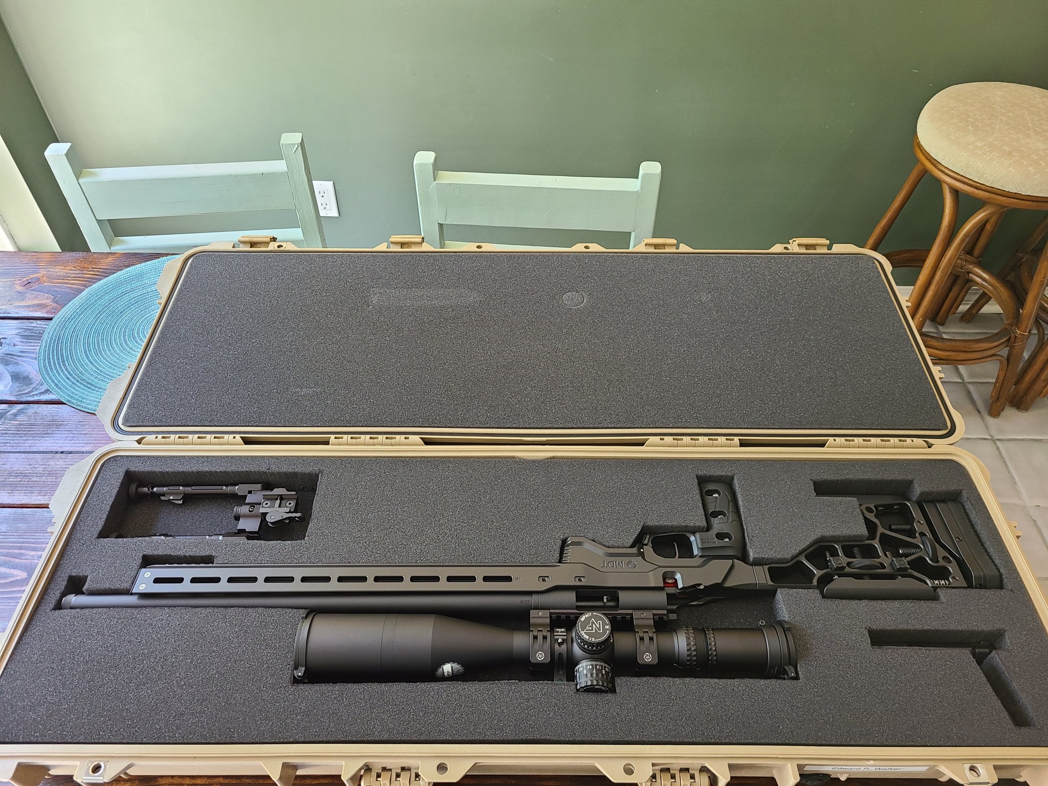

Which case is that? It fits so well.
I just ordered a Vault V730 and waiting on Pelican to ship it which I think will fit very similar to your above picture. Also my Terminus Zeus will go in there and I'll pull the barrels and cut foam cutouts for the barrels.
That's a Pelican 1720 with the 22" barrel. I would prefer a little more padding on the ends, but this would work great for anyone running barrels 20" and shorter.

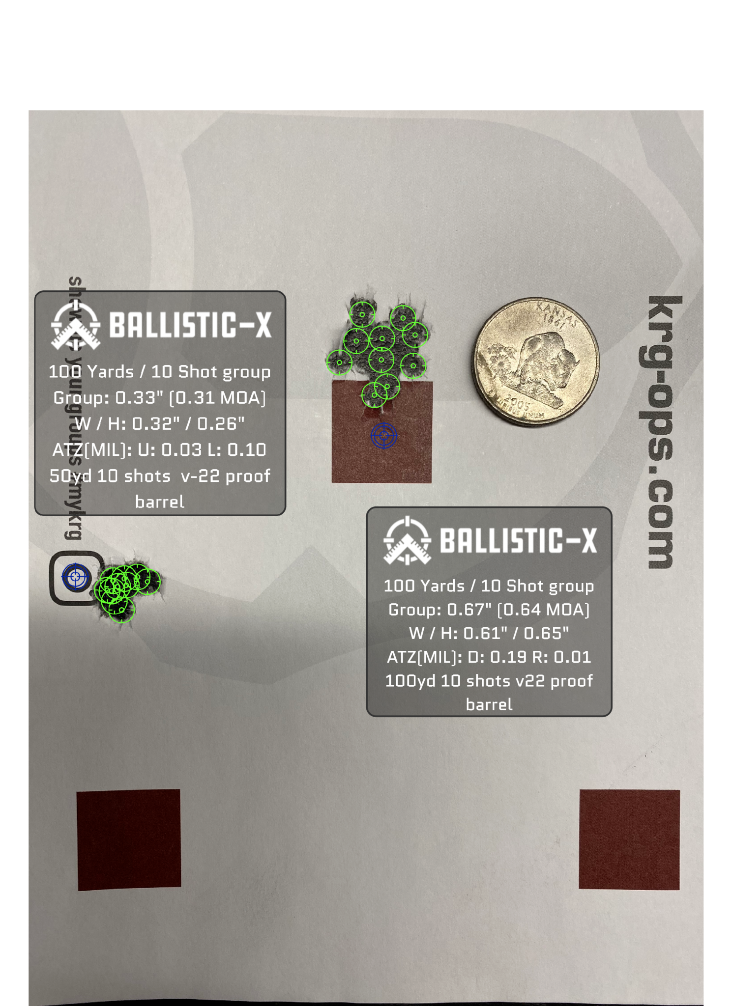

Indoors? For 10 shots that's remarkable. That's would be one of the top shooting groups at the Lapua indoor testing facility.
.67" + .221" converted to mm = 22.6mm (edge to edge)
Indoors yes, I’m fortunate enough to have a indoor range 10 minutes from my house lol I was apprehensive to buy a vudoo with a proof barrel as there really wasn’t much data on group sizes at 100yd and hardly any at 50yds but it had far exceeded my expectations. I figured if @RAVAGE88 is selling them with proof barrels they must be damn good, and they are!

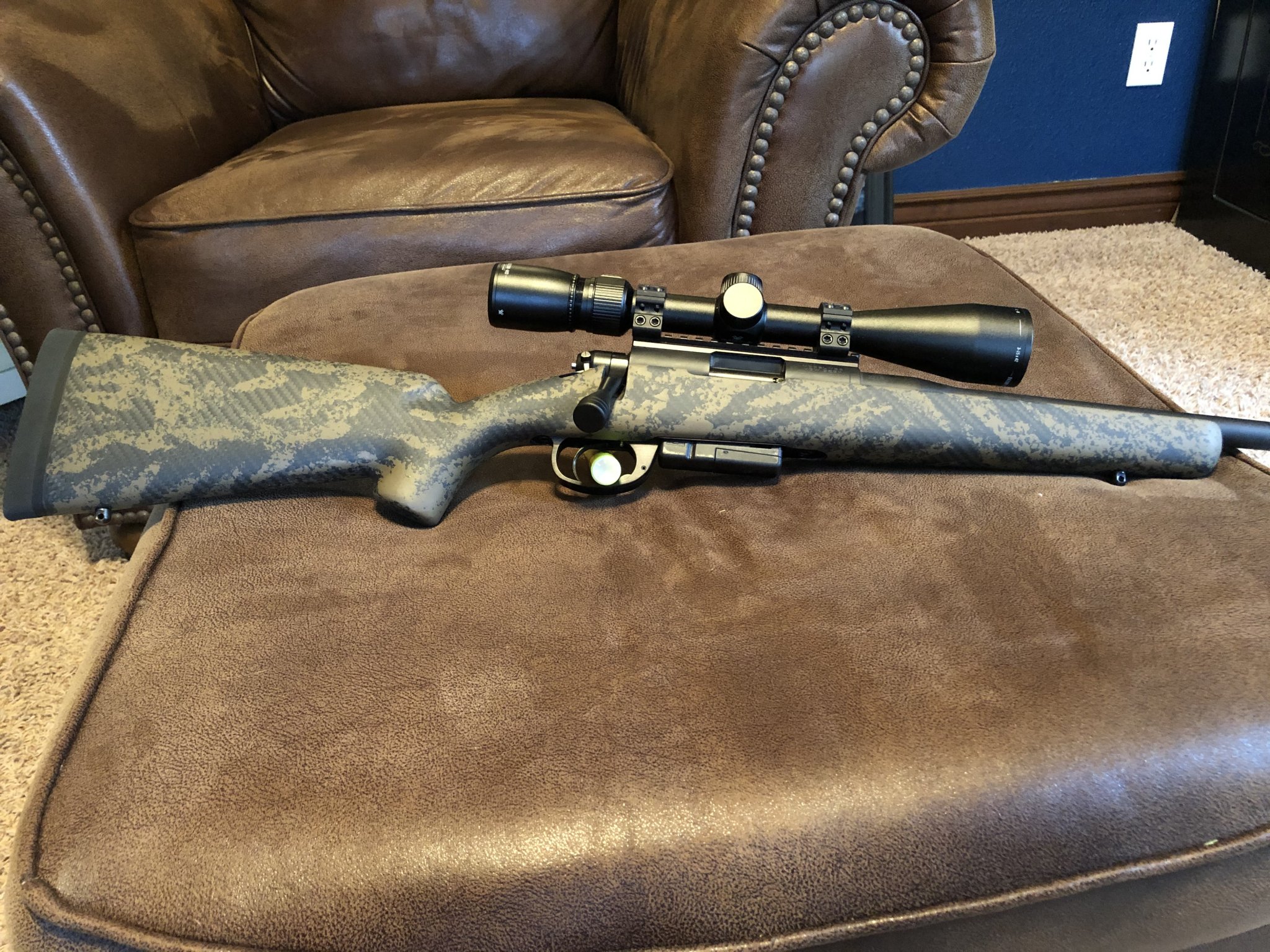

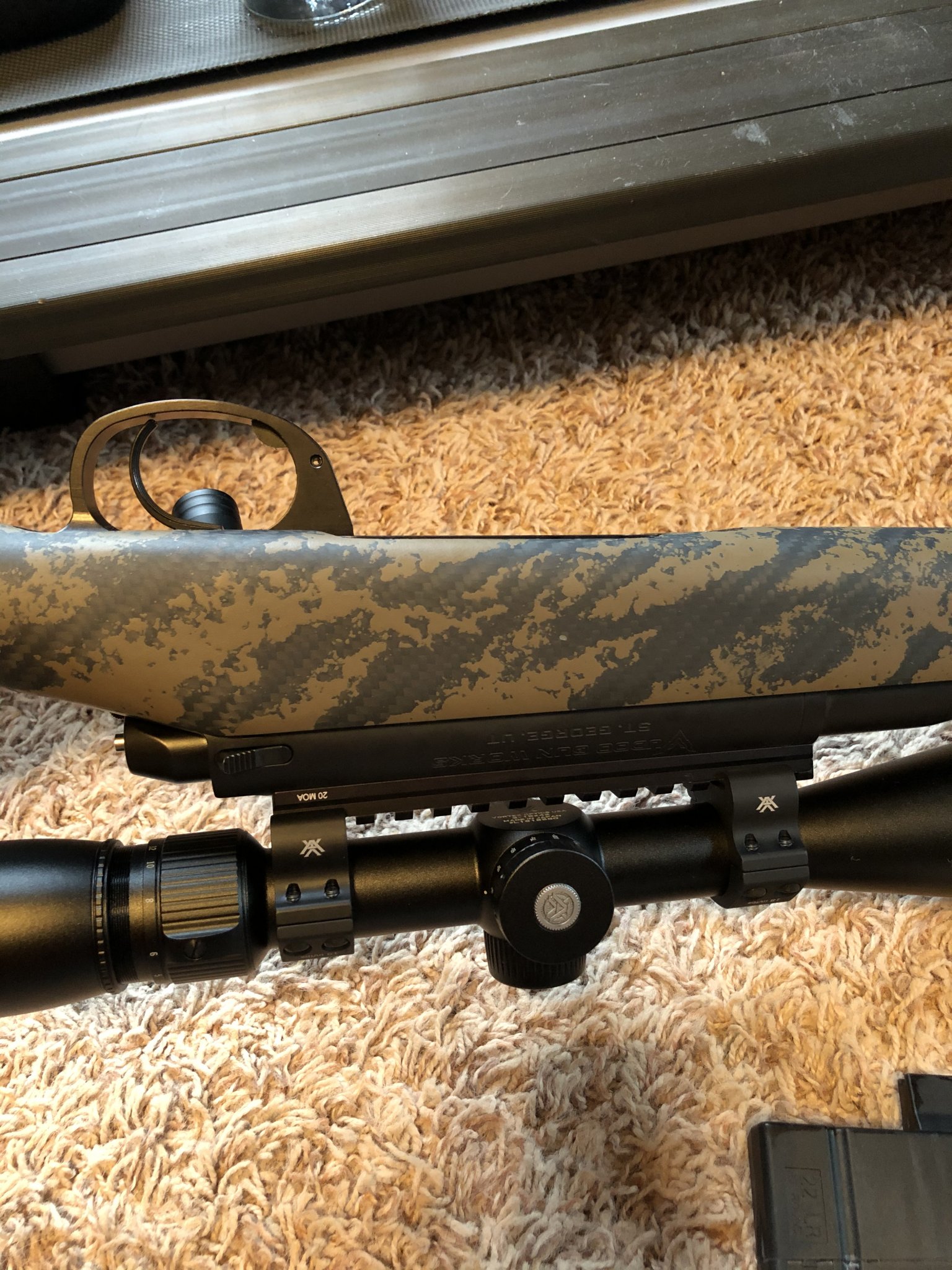

When I started my build back in February, I wanted to keep my new toy as much of a sporter as possible..ordered a 18” ranch profile.
I went with a AG Composites privateer in carbon bronze.
Bottom metal is a PTG flush mount oberndorf.
Trigger is a triggertech special set at 1#.

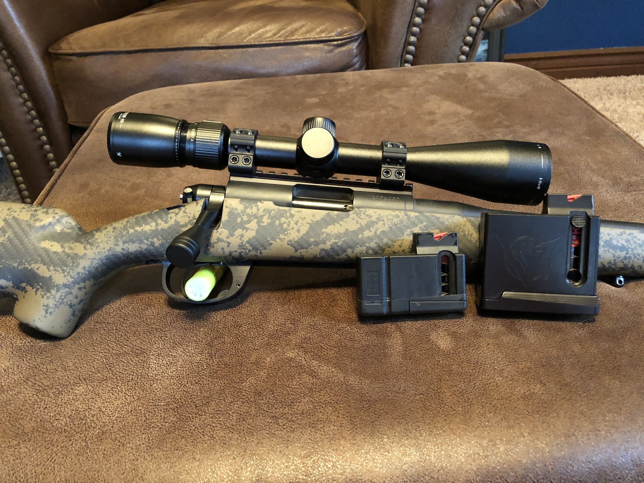

Today I did a “slight” modification to the polymer 10 rd mag... here’s a few pics. (5 rd aluminum also in pics).
Put a vortex razor HD LH 3-15 on top of it.
