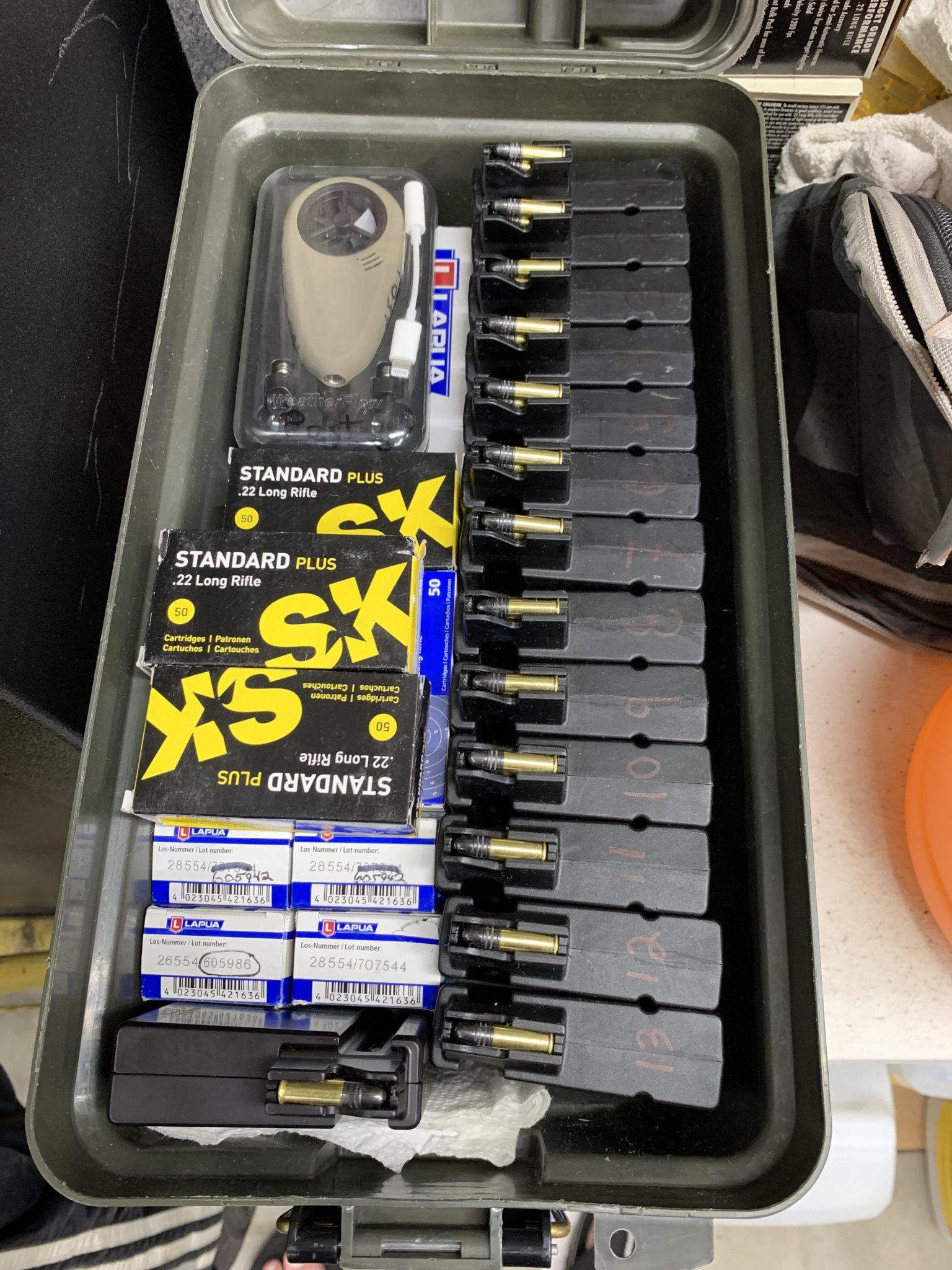

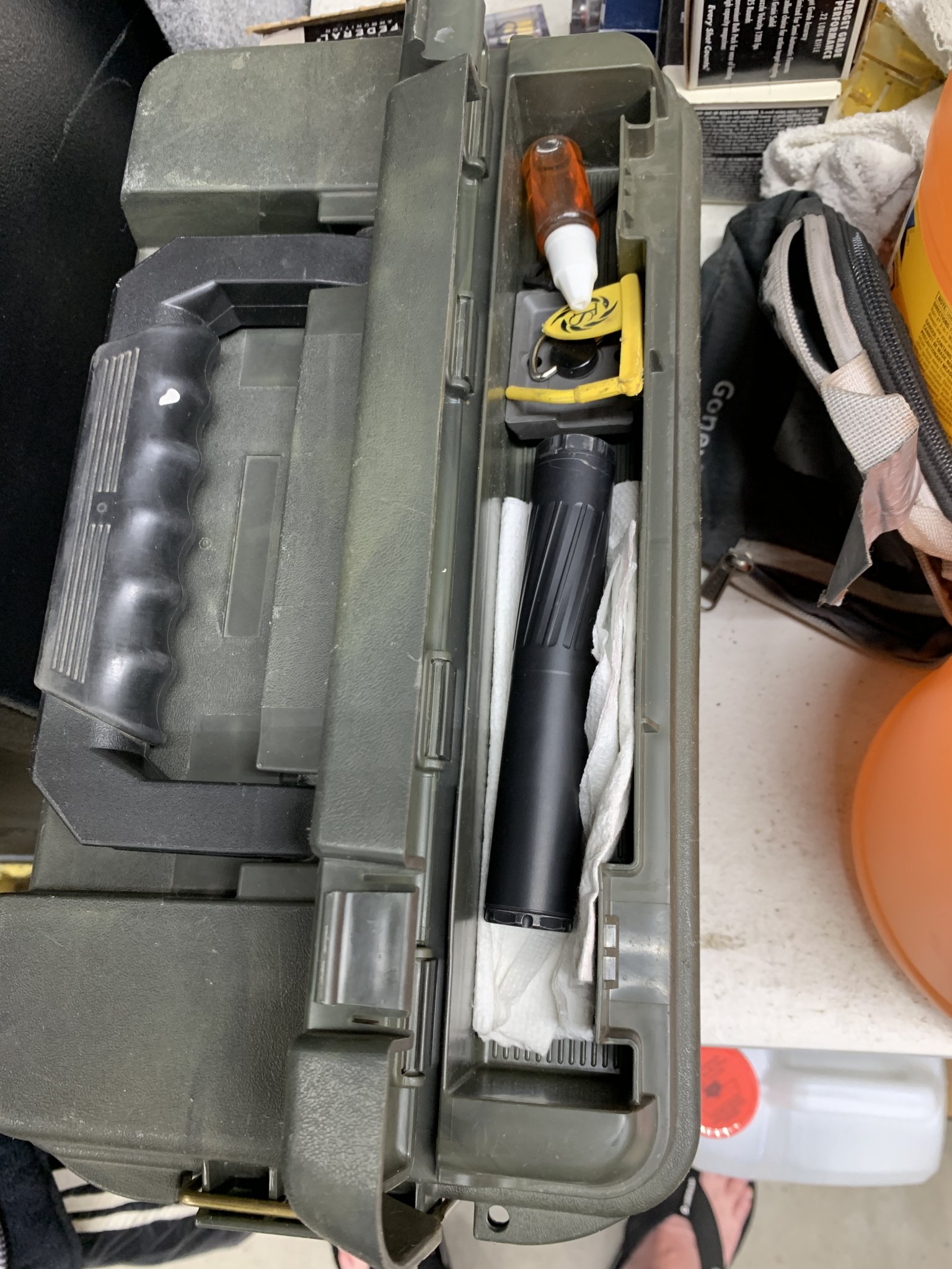

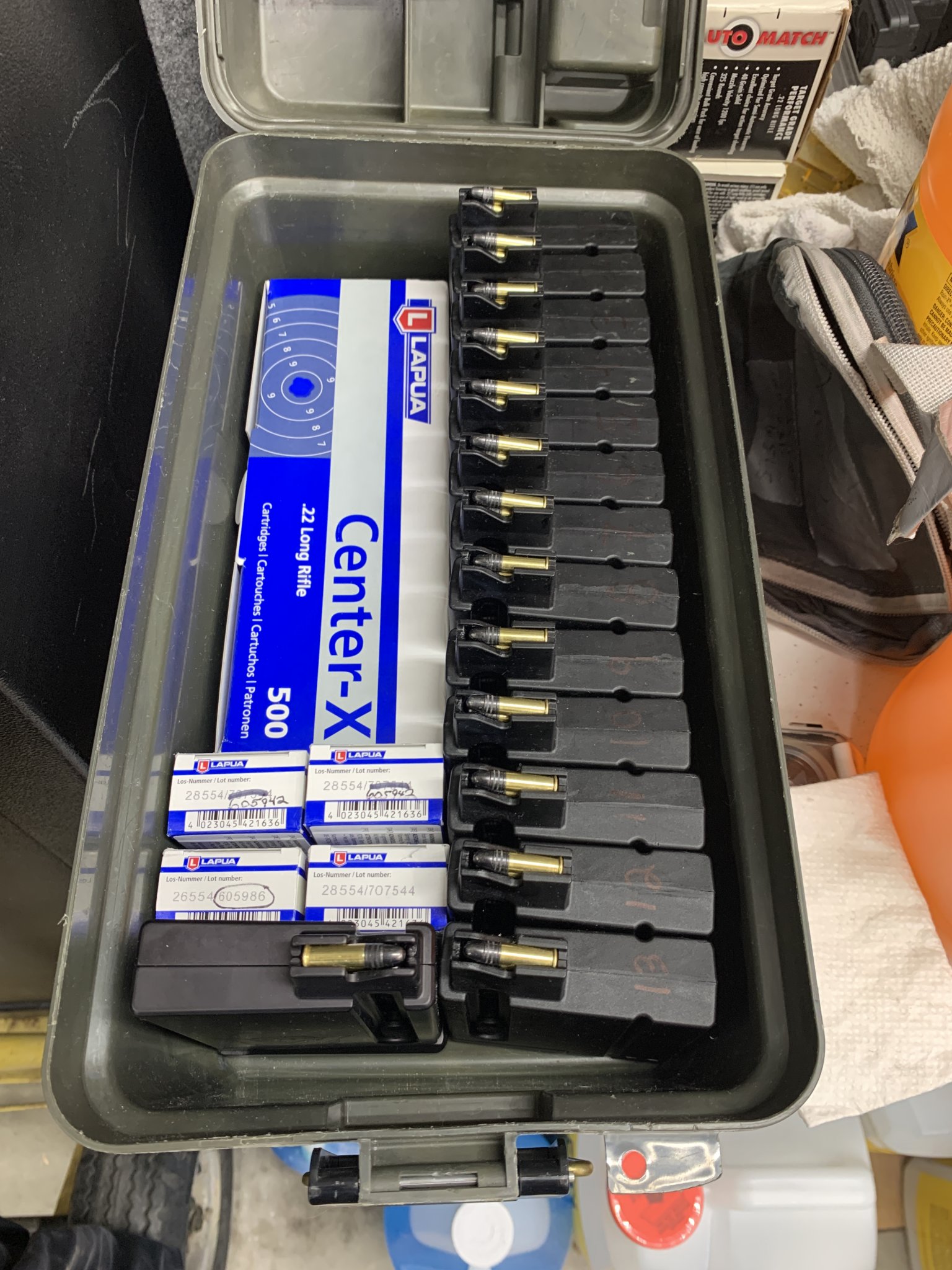

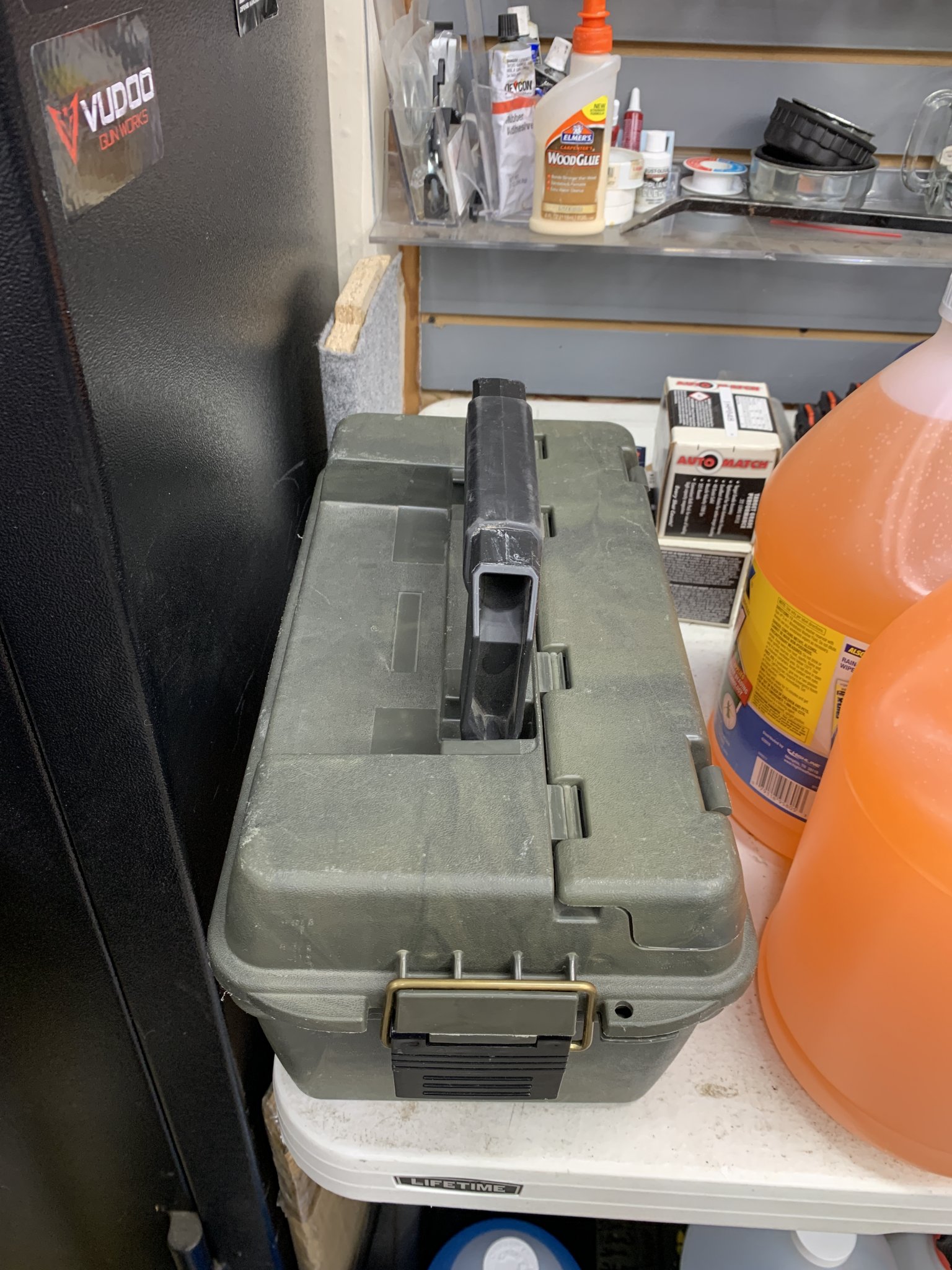

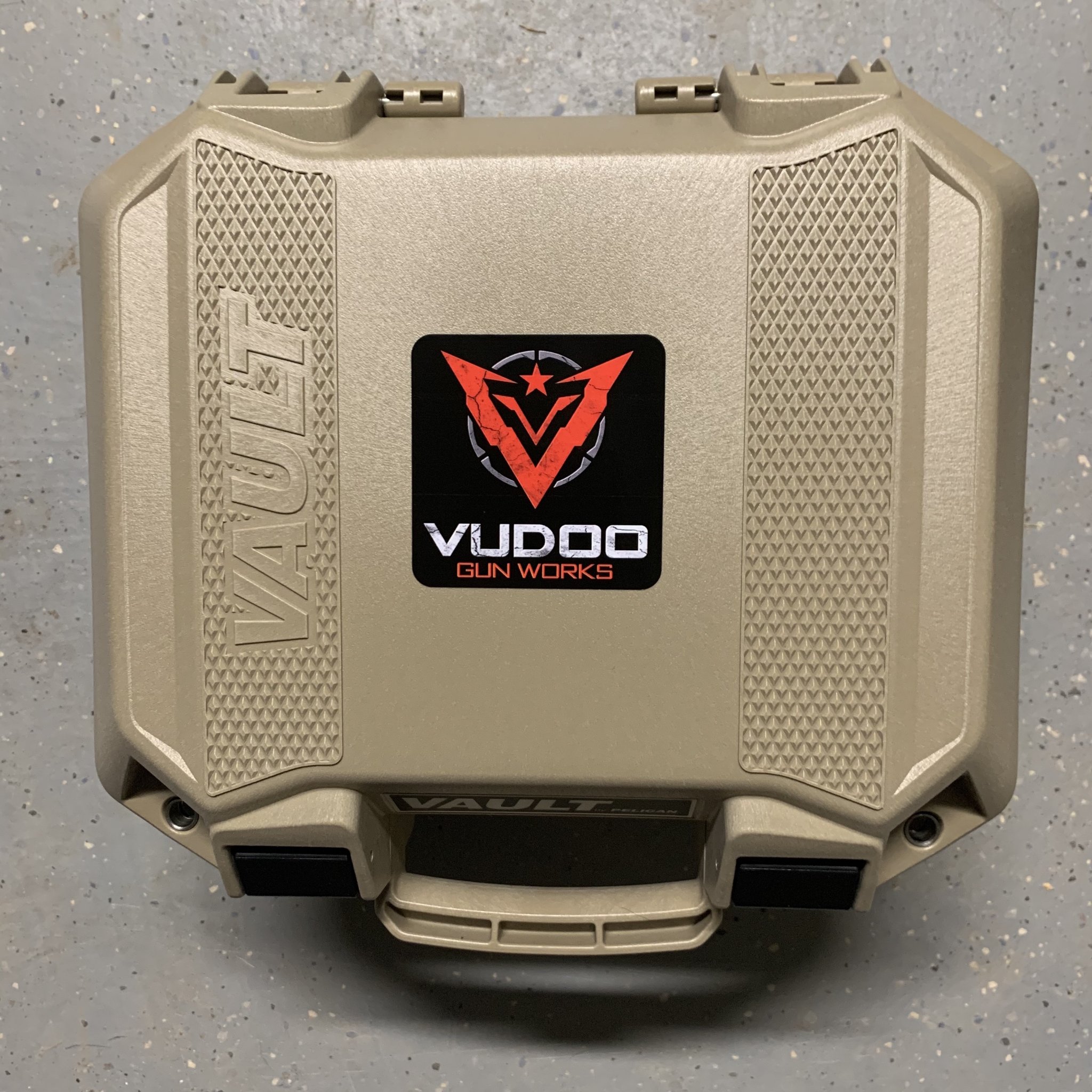

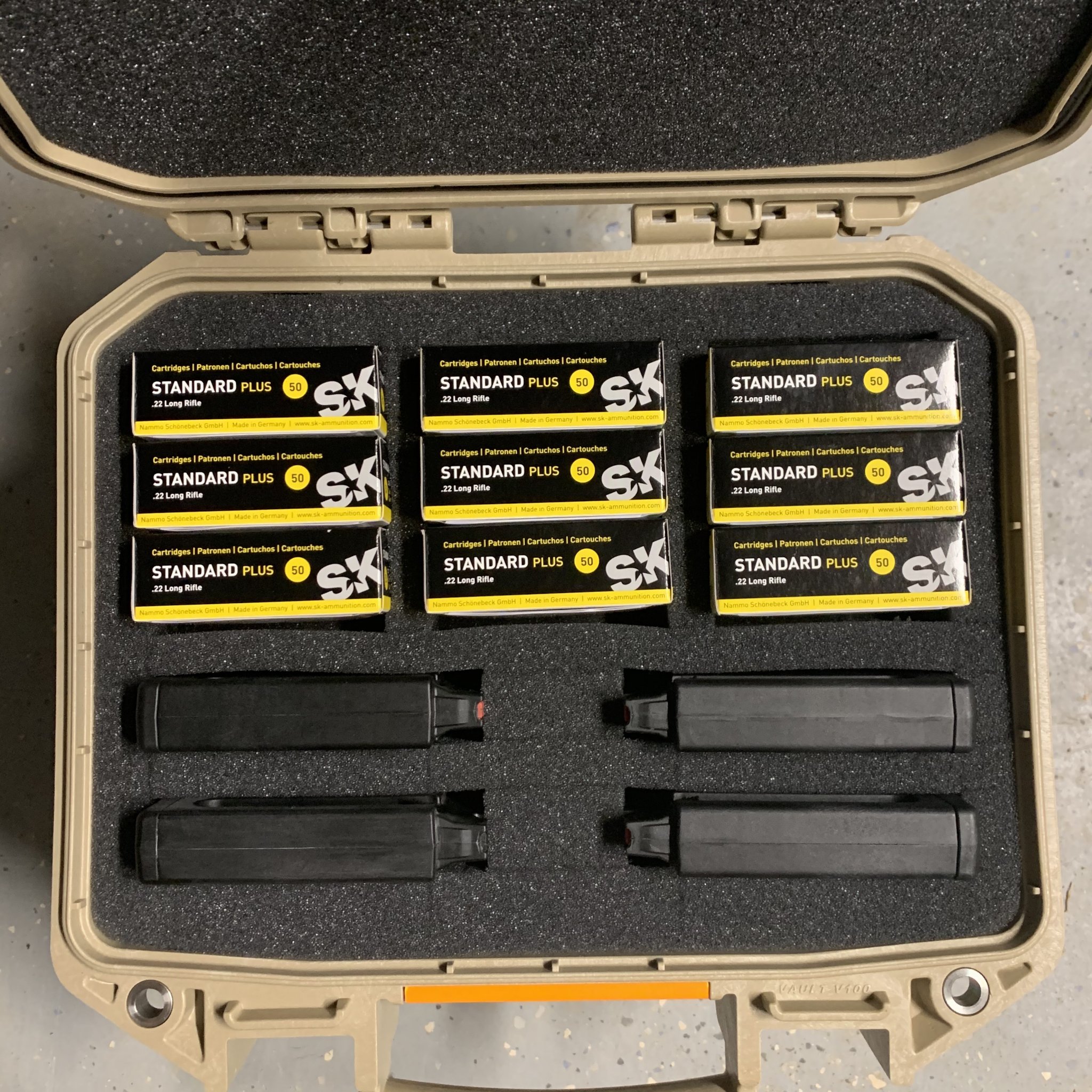

I just use a ammo box my FIL gave me nearly 20 years ago. Works well for matches. All my mags plus a brick of ammo and then some. I usually keep my bolt wrapped up in there w/ the Weather Flow wind meter/weather station and the suppressor and the items in the storage tray on the lid. Going to continue to add mags and less boxed ammo.
I call it My Pot O'Gold.🍀

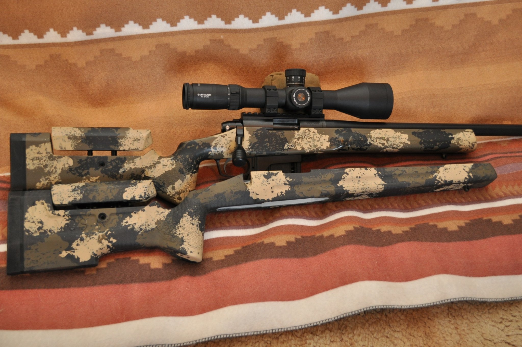

If anyone wants something to drool over, GA Precision has a Vudoo build ready to ship in a GAP camo A5 stock with a Bartlein barrel. OMG ... Beautiful! This reflects clearly on the quality of the Vudoo system to me.
They don't mention what chamber reamer they used on the Bartlein on that V-22. Have to wonder whether GAP bought it as a bbl'd action from VGW, or did the bbl work themselves. I kind of like the GAP camo pattern - that's my 1st V-22 in its original Manners T4A in molded-in GAP, with the PRS1-T stock it's in now in front of it.
This is $1k more expensive than a similar built directly ordered from Vudoo. The Gap rifle has the Ingenuity rail and is bedded, but that's not enough to justify the premium....Unless I'm missing something...

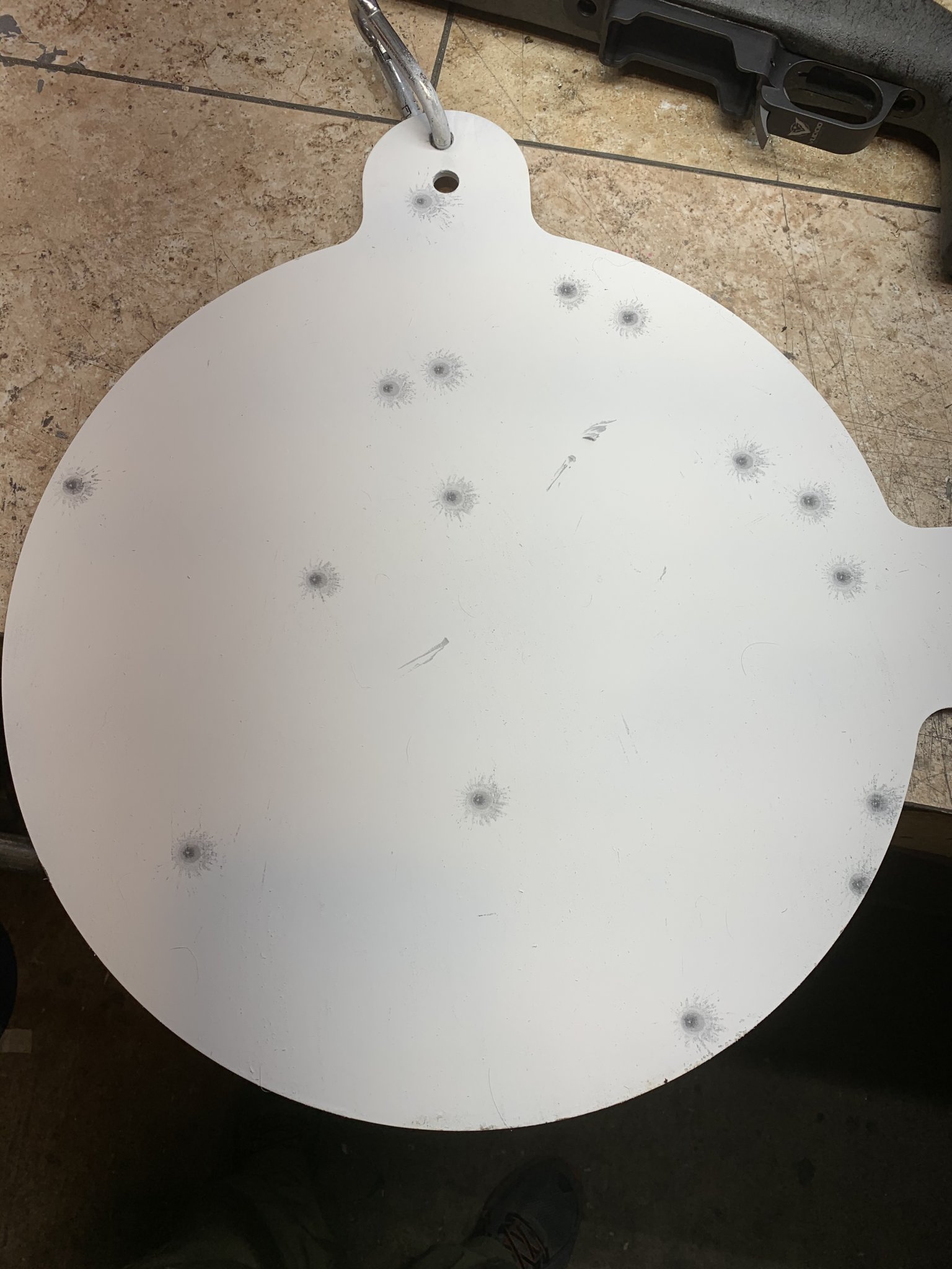

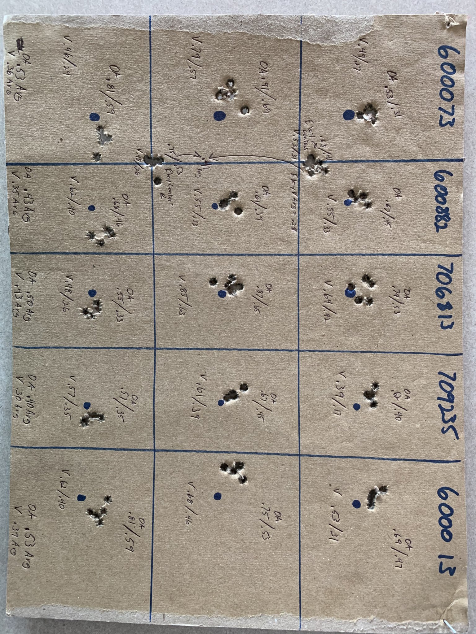

Having an issue with accuracy and my vudoo all the sudden. I have been shooting to 260 regularly and was able to consistently hit a 5” plate. I was out of ammo from previous center x lot and had just been shooting CCI and SK match still able to hit the 5” plate with it. I have 5 lots of CX to try and when I first got my vudoo I was able to shoot in the .2’s at 50 yards pretty consistently, Now I’m struggling to get .4 at 50 and something really happened at 260, I cannot even hit a 18” plate. I took the suppressor off and shot it without, no change, I changed back and tried SK and CCI. Still throwing rounds all over. Only thing I had changed was I cleaned the bore with hoppes #9, two wet patches, then a nylon brush wet about 15 strokes. Used vudoo bore guide, cleaned with dry patches. I have cleaned it this way about 5 times prior and it was just fine. I checked my scope and all is tight with it. Any ideas what could be the issue, seems very strange that at 50 I am at least still in the .4-.5 range but at 260 it’s like 3-4’ now.

Sometime after a true cleaning you need a few rounds to “season” the barrel back and I guess the groove to find it’s place or whatnot. Are your shooting in the same place? Outside? Weather conditions?
Yes, after the cleaning I was able to shoot the top two rows of the card board, so that was 50 rounds, before I shot for those groups I shot 10 rounds of CCI SV to reseason the barrel. Yes shooting in same location out of my basement window. There is a berm at 91/205/260
I had a similar accuracy problem with my V-22 that I've fortunately corrected. Before I get into the details I want to set the stage.
There's two schools of thought about rimfire barrels, the first is that they don't need cleaning very often or not at all, the second is to shoot their best they need to be as clean as the you can get them. The positional, PRS style shooters, as a general rule fall into the first group, the rimfire benchrest competitors into the second.
I began shooting my V-22 with very little regard to cleaning the barrel ... after about a year of modest maintenance, much like you described, accuracy fell off dramatically. I'd estimate I had four or five thousand rounds down the barrel when accuracy dropped off. I talked to Paul at VGW and considered sending the rifle back to the factory but before I went to that extreme I convinced myself that the drop off was in the barrel and I needed to remove the dreaded "carbon ring". At that point I hadn't added a bore scope to my kit bag.
Here's what I did to solve my problem ... a thorough scrubbing with J-B Clean concentrating on the chamber but treating the entire barrel. Before I used the J-B Clean I used my standard protocol - a soaked Bore Tech Rimfire Blend patch to wet the barrel followed by a brass brush cycled several (5 to 7) times back and forth through the barrel and then wet patches until they come out clean.
Then I used the J-B Clean and followed again with my standard protocol ... I was amazed how dirty the patches were that came out of the barrel. I repeated the standard cleaning once more to make sure I removed any residual J-B Clean and off to the range I went.
My range-day results were far better than I'd seen over the previous three months and I was encouraged that I'd identified the problem and had a solution that would work. By the way, my V-22 wasn't nearly as fun to shoot when the accuracy disappeared - ain't that the reason we buy these rifles anyway?
A couple more thoughts - there's several similar cleaners you can substitute for J-B Clean. Bore Tech makes C4 Carbon Remover and Birchwood Casey makes a Lead Remover and Polishing Cloth. Both are available through Amazon. A fellow Vudoo owner uses the Bore Tech product with great results and it may very well become part of my standard cleaning protocol.
My second thought is that you might consider adding a bore scope to your cleaning protocol. I bought one from Teslong that works very well on rimfire barrels. I scope the bore prior to and after each cleaning to ensure that I've returned the barrel to pristine condition. You just can't see what's going on in your barrel without a scope.
Like I said at the beginning of this post there's two schools of thought on barrel cleaning ... obviously I'm in the benhrest shooter's camp. My shooting is at three yardages, 50, 100 and 200. I participate in monthly competitions at these distances and keep records of my target scores, round count and barrel cleaning. The data I've accumulated has convinced me that a clean barrel is a happy barrel. Sure, you'll have to shoot a few rounds (for me about three) to settle the barrel but then you're back in business with the Vudoo accuracy that always puts a smile on your face.
Hope this helps you and others with similar experiences.
