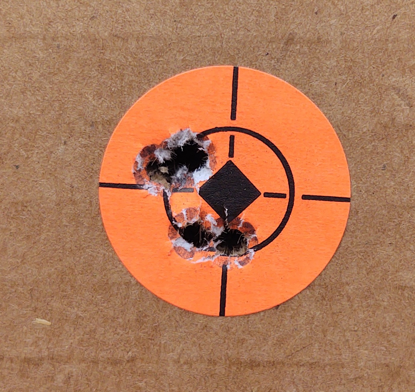

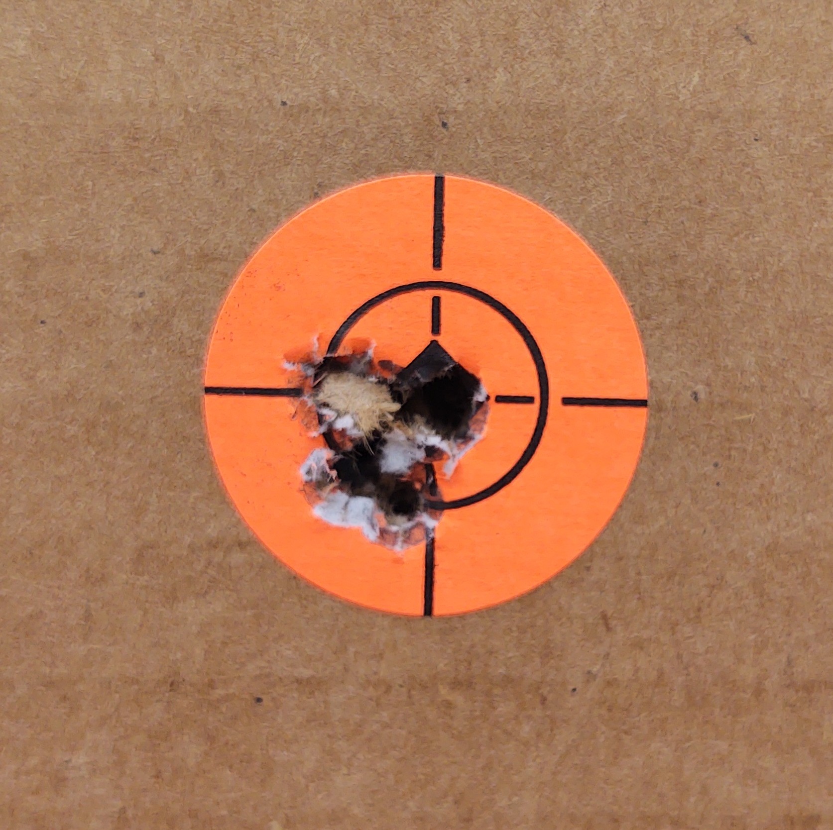

Some 50 yard, 5 shot groups with my skunkworks .22 tonight...

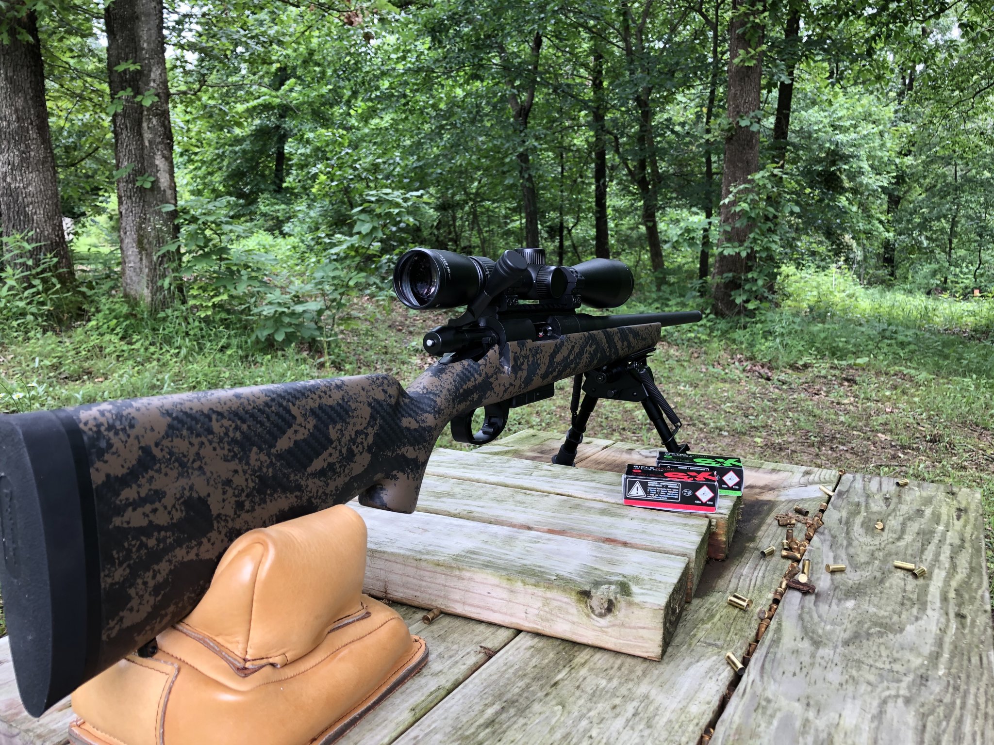

First time out since I dropped my ranch profile into the ag composite stock. Im really loving this rifle.. the gun will flat shoot, no doubt.
Like any sporter, inconsistencies in form are magnified greatly. Here’s a few groups from today with sk rifle match and pistol match.
I quit early because of the wind and for some reason I just couldn’t get comfortable.

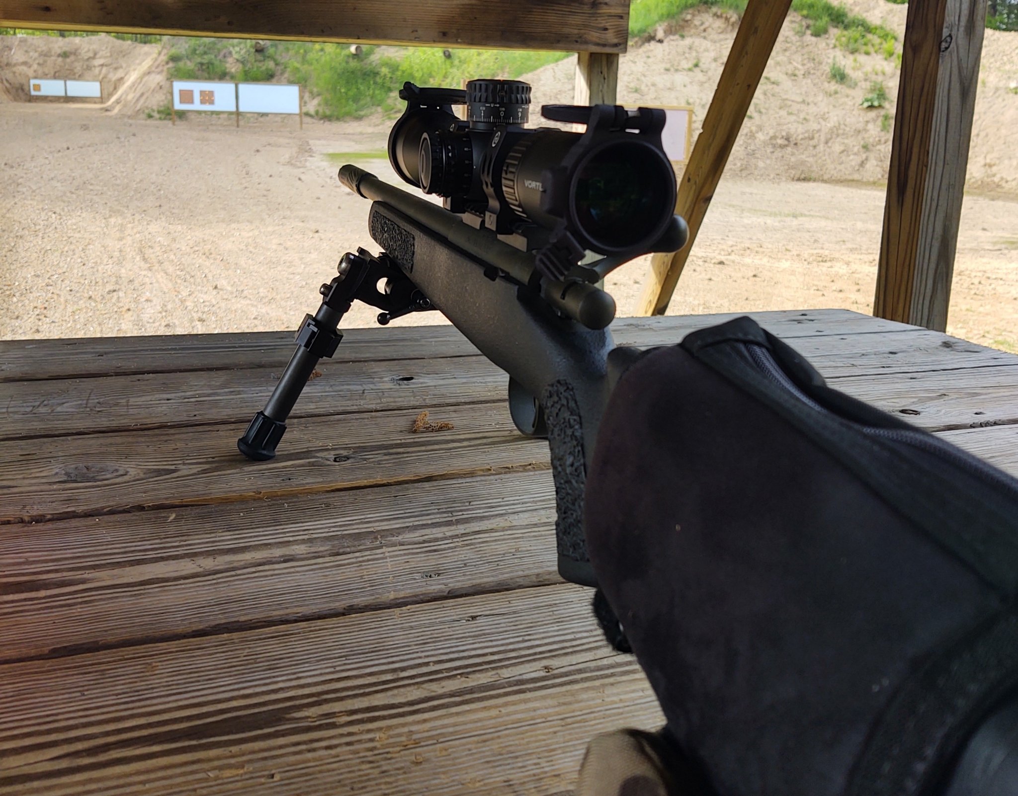

Any negatives in using a 60MOA rail if most of my shooting will be at 200 yards or less? The scope will have enough adjustment to to still zero at 25 yards and I want to be able to dial out as far as possible occasionally. I’ve just never had that much slope in a rail and it looks kinda weird in pictures.
I mostly shoot 50 and 100 yds. I zero'd at 50 yds. with a 30 MOA rail and have some room to adjust down to 25 yds. if I ever need to. I could have gotten by with the zero or 20 MOA rail.
I have a 60MOA rail on my Vudoo. It works just fine. Zero at 25 yds and the ability to reach out and touch Rimfire ELR distances. I like having options on board!

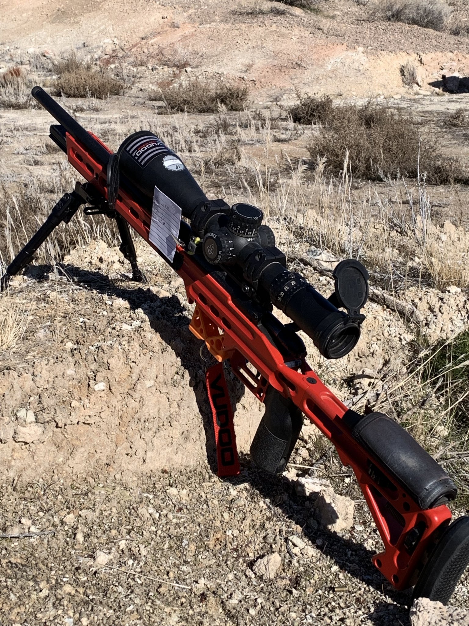

What height rings? Seems like a long scope would be close to hitting the barrel at that angle. Maybe I’m just over thinking it. You got a picture of your set up?
Depending on the scope, you may lose some optical attributes running that close to the edge of the adjustment range at closer distances.
Scopes are optically optimized at the center of their adjustment ranges.
A 20-30 MOA base should work fine for your application, and you can always hold over for extra long shots.
On most higher quality scopes a 30 MOA base will still let you dial 350 to 400+ yards.

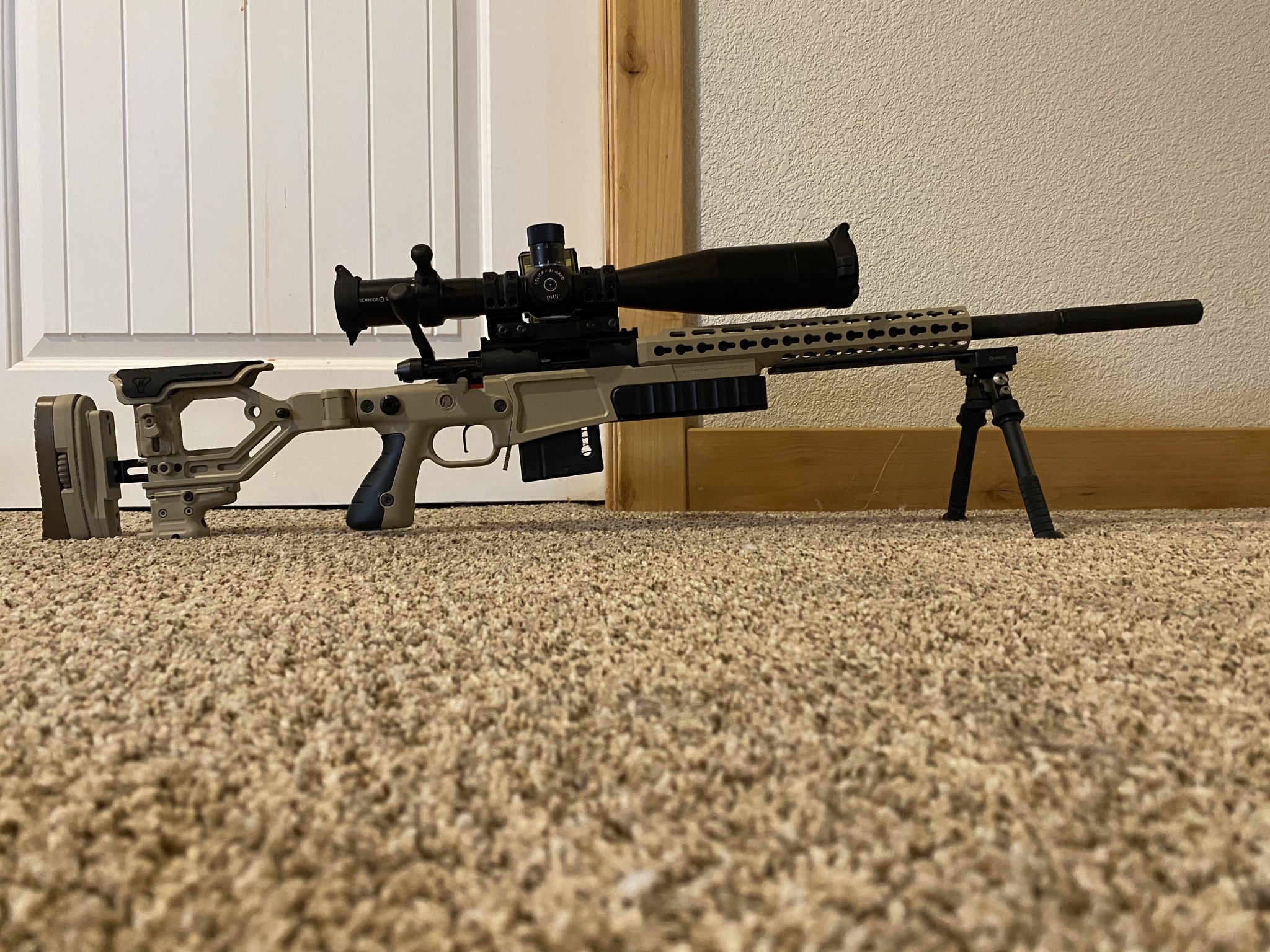

Guys, does anyone run a Cadex Strike Nuke Evo chassis on their Vudoo?

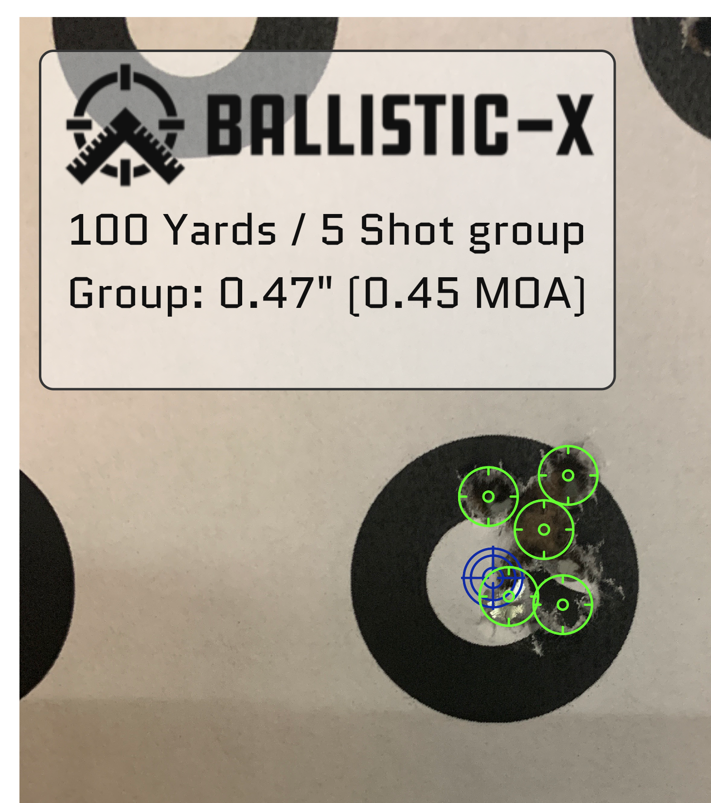

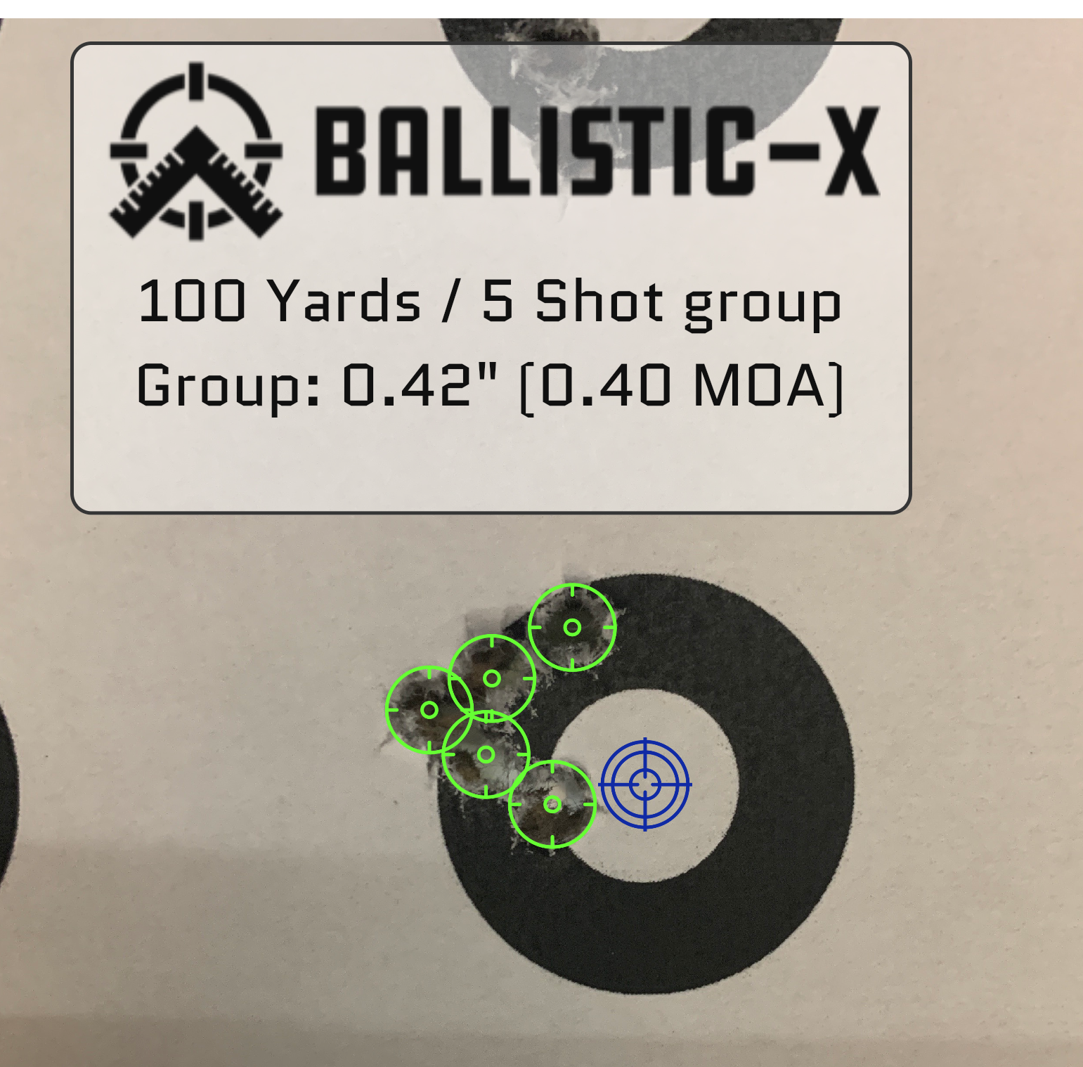

And a couple gratuitous five round groups I got when seasoning the barrel after cleaning. Cherry picked of course. ;)
