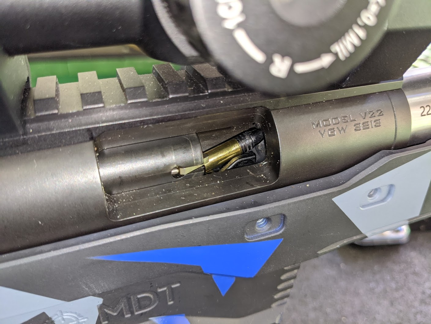

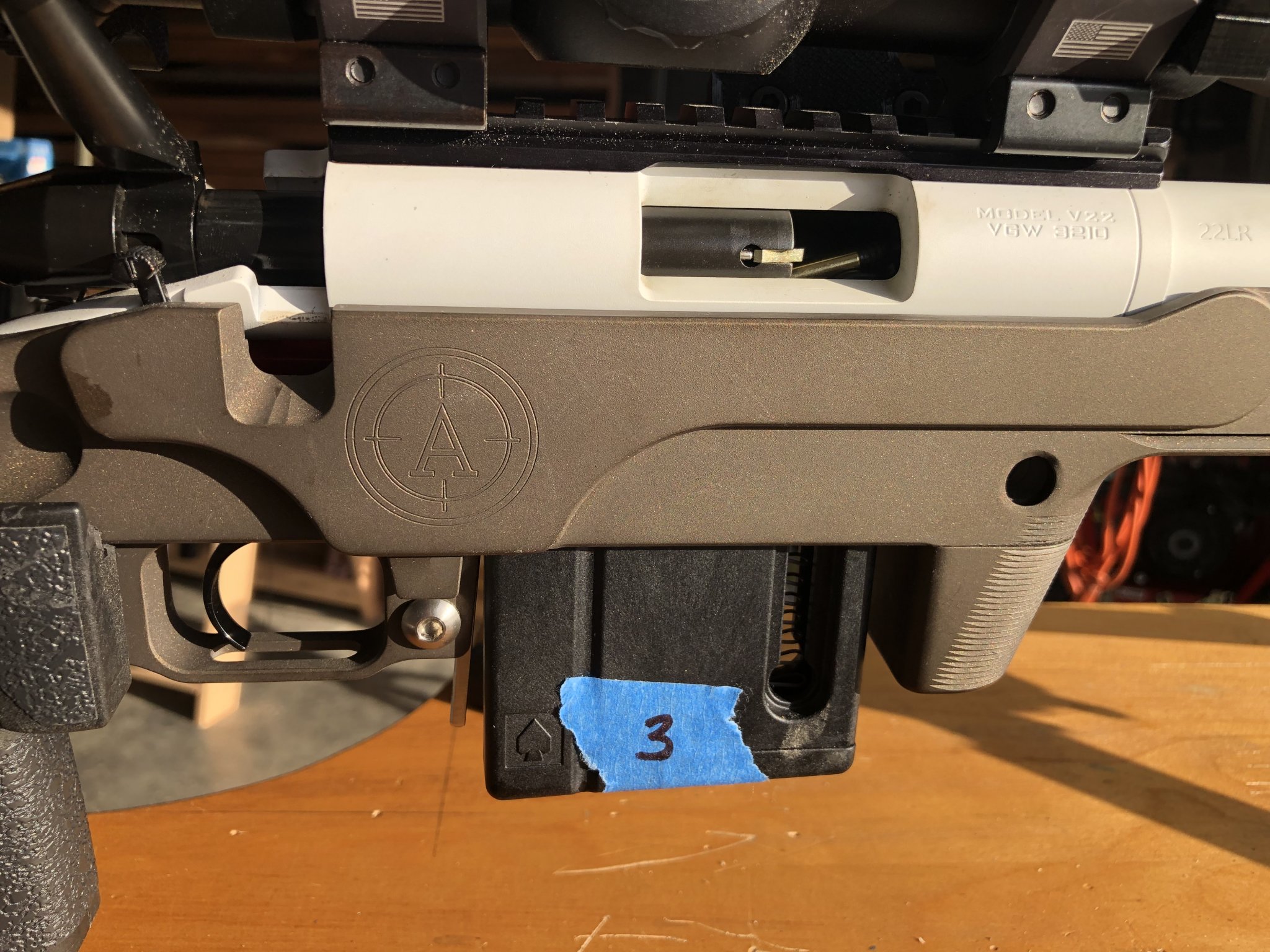

Shot a local match today. Did decent but fought hella feeding issues with Midas plus on every mag and sometimes every other mag for 8 stages and 240rds. The front of the round was popping up it seemed and getting stuck and the bolt would dent just under the neck on the case. They’re factory 10rd poly mags and the rifle has the gen 1.2 FCG. It’s happened with center x and Midas plus both. If anyone is having similar issues and fixed it or know what it might be please let me know! Other than those issues, the gun shot great!
Shot a local match today. Did decent but fought hella feeding issues with Midas plus on every mag and sometimes every other mag for 8 stages and 240rds. The front of the round was popping up it seemed and getting stuck and the bolt would dent just under the neck on the case. They’re factory 10rd poly mags and the rifle has the gen 1.2 FCG. It’s happened with center x and Midas plus both. Other than those issues, the gun shot great!
definitely drop a line and let them know. When they get it fix please share the remedy =]
a friend of mine was having the same exact issue today. He ended up shooting a backup rifle because he couldn’t get it to feed properly.
a friend of mine was having the same exact issue today. He ended up shooting a backup rifle because he could get it to feed properly.
there were a couple other guys having issues today as well. While not world ending its frustrating when you’re on the clock and jamming up and not feeding rounds properly. It is what it is, I’ll be doing more testing hopefully Monday night running all four mags fast, slow, medium paced, to see under what specific conditions it happens and hopefully get some pictures of the issue through the ejection port.
Was it in different shooting positions where the mag could get bound or in prone too?
Prone, barricades (mag had zero pressure on it), sitting behind my tripod. Unfortunately it didn’t matter what position, it just struck randomly.
What chassis or stock/bottom metal?
Vudoo will get you fixed up, but this seems to be always a "magwell holding the mag in the wrong place" issue.
Sounds like the mag is a little low, if the bolt is skipping over the rim and hitting in the middle of the shell.
I can't believe there are not a lot more of these issues, with the HUGE variety of chassis and mag well combos out there.
@Krob95 were these magazines relatively new? Purchased in the last 6months or so? My mag that came with my Vudoo ~ March had this issue. I called them up and they sent me a new one. They said they had a problem with the mold which caused the mold to be too narrow, causing the round to not sit up high enough, thus not control fed, and it was causing the round to push up and get caught.
I bought a used mag, and then I bought an aluminum mag. Both those magazines I could tell that the follower was sitting a lot higher in the magazine compared to the defective magazine. The replacement magazine I got also looked like the used magazine (1.5yrs old) and the new aluminum mag with where the follower was sitting.

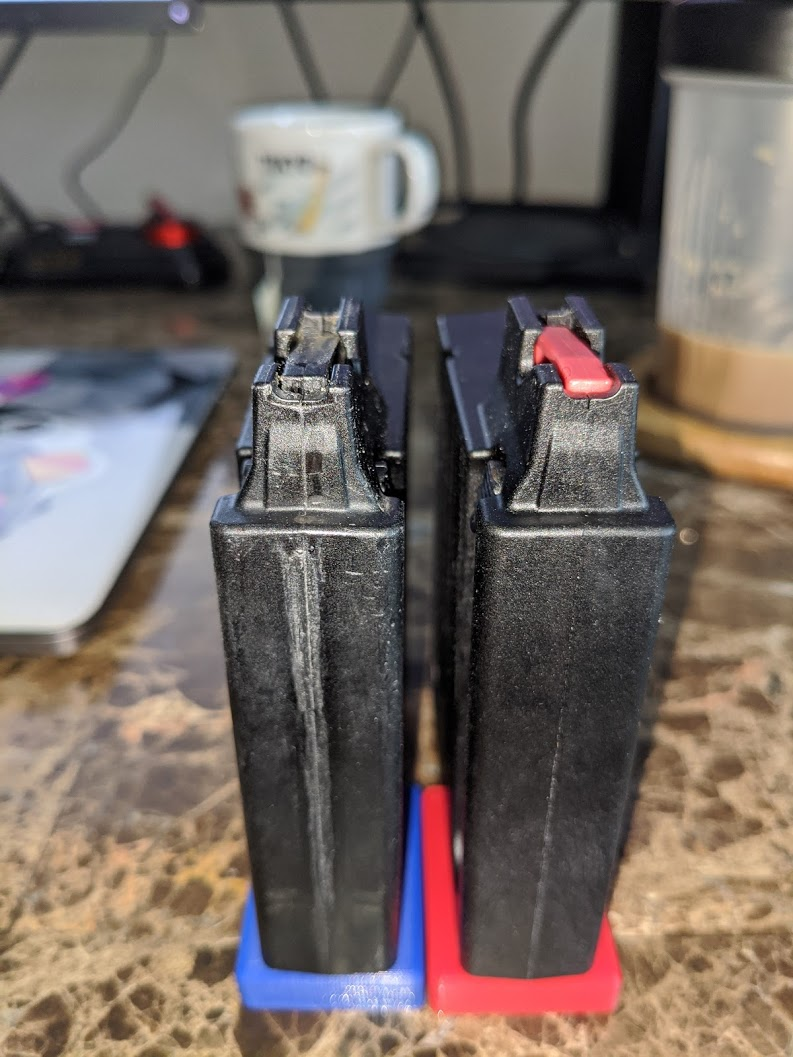

Not a good image - was from a while ago
You can notice the red follower is sitting a mm lower compared to the black follower (left one) that sits pretty flush to the top of the feed lips.

Mine looked like this during a malfunction before they replaced it. Haven't had an issue once in the last 300 rounds through the replacement mag.
Thank the lord, that’s the exact issue I’m having. The front of the bullet is catching the top of the chamber/breech face at 12 o’ clock. Glad you have a picture of it, you’ve saved me some ammo!

15 round mags. I received 2 yesterday, shot a match today, tried to use them during sight in, no go, consistently failed to feed, bolt slid right over the rounds. Running an MDT ACC, all my 10 round mags run fine. Any one else running the aluminum mags?
