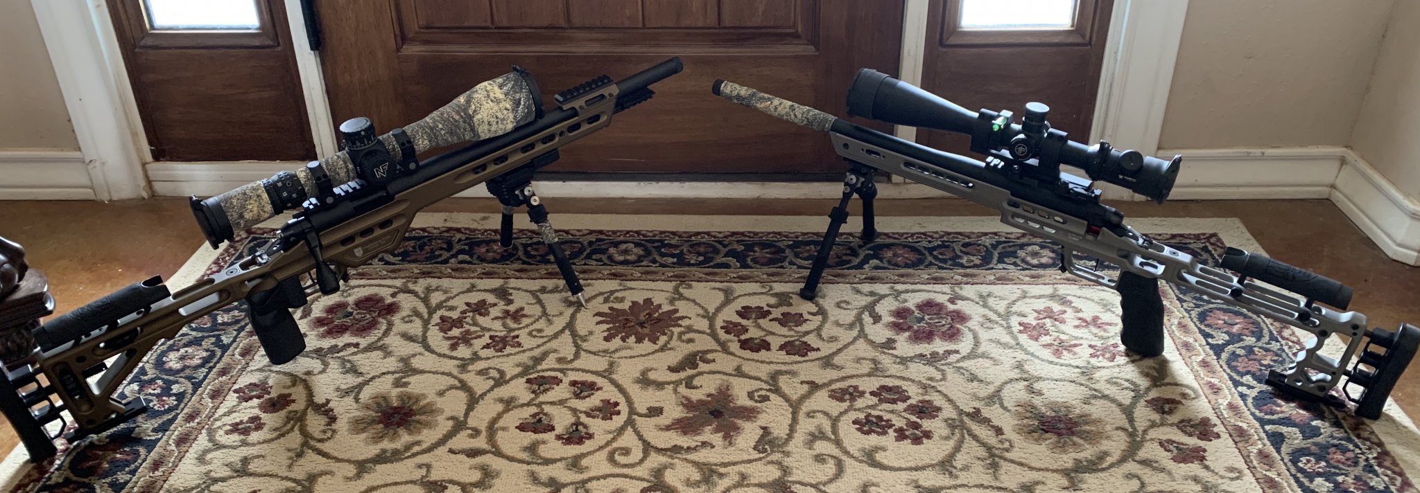

We originally got one to share.... that didn’t work so well, so now my son and I have our own..

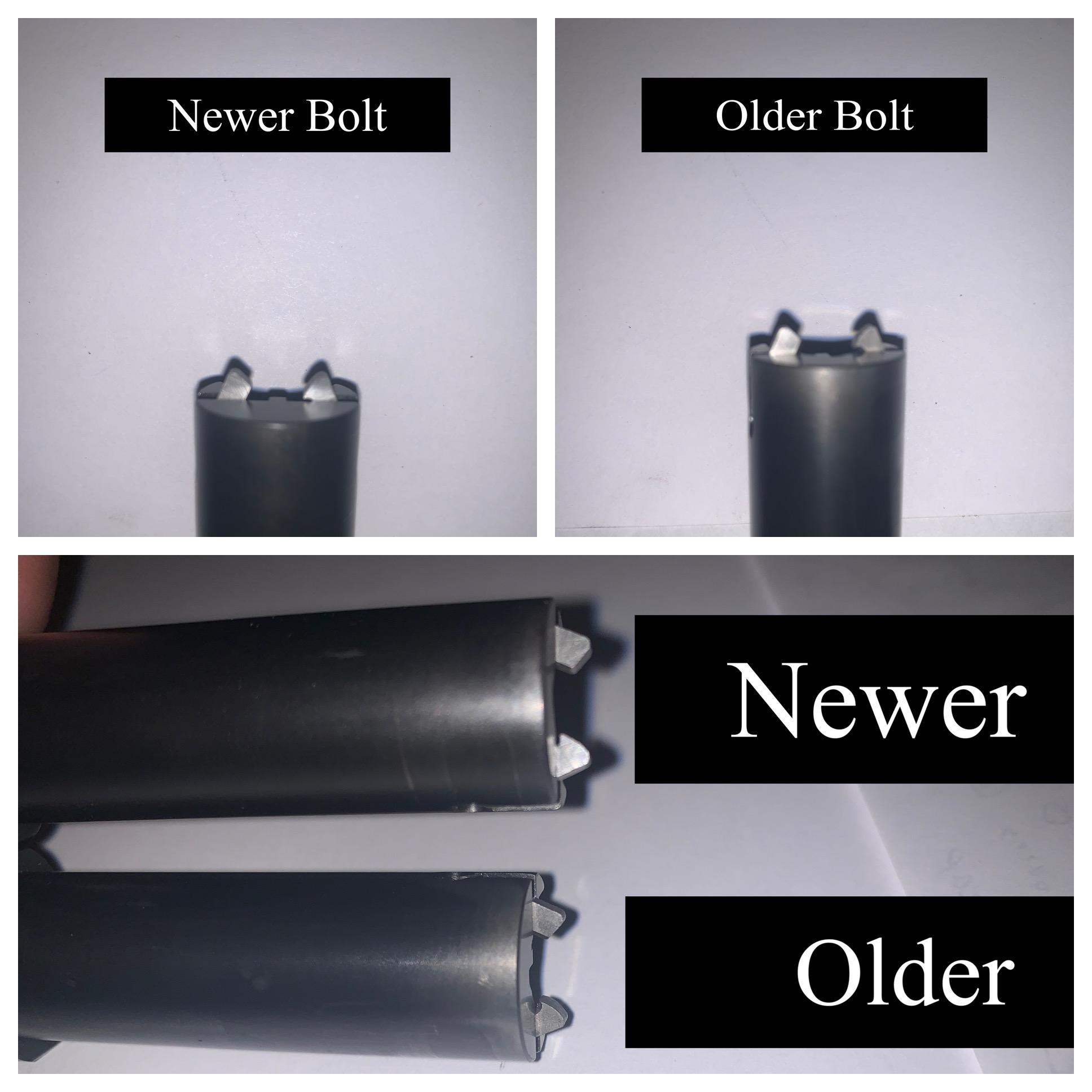

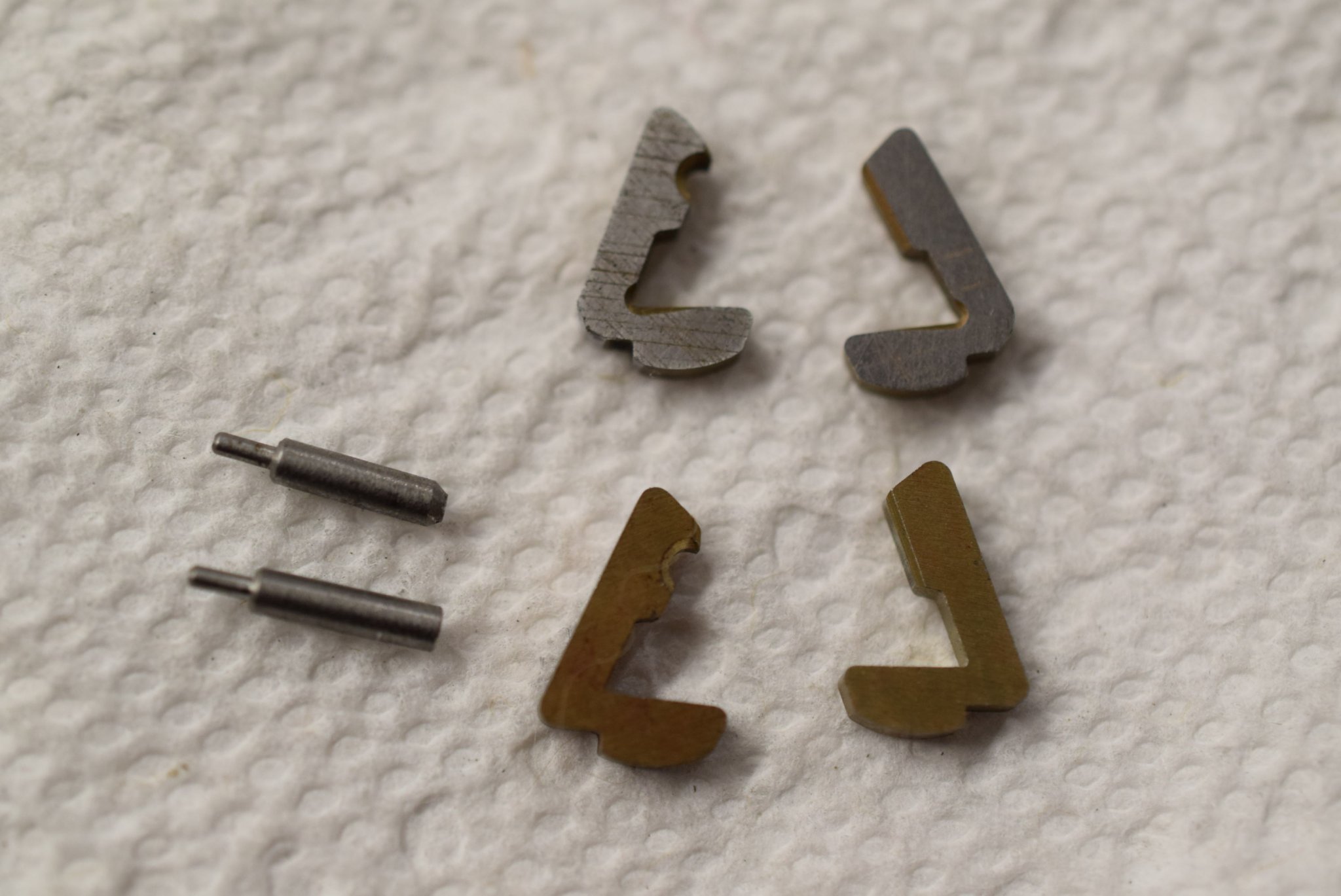

I read through a lot of this thread, but does anyone else have FTE's with rounds that load with no issue? IE running SK std, RM, even center X, sometimes after firing a round, and cycling the bolt, the extractor doesn't pull the spent casing out of the chamber, this is problematic in a timed stage when having to drop the mag and manually pull the casing out of the chamber.
I have a little over 1000 rounds through my Vudoo and I have not had a failure to extract. I’ve shot FGMM, CX, SK Rifle and SK LR Match.
I have two, the second one has had no issues thus far, however it would seem to my untrained finger that the extractor spring is quite a bit stiffer on the second than the one with the issue? This is purely a guess based on feel as I can see nothing different between the two.
2000 rounds through my Vudoo and never had a single extraction issue. I've short stroked it and had a feed issue before (user error) but never had an extraction issue. Since you have 2 and one works and one doesn't, seems pretty easy to just have Vudoo fix it since you know it's not user error :)
one thing I have not tried is bolt 2 in gun 1... and vice versa...
How old is the action that's giving you extraction issues? Some of the very first V-22 actions had issues that were easily remedied by some minor filing on the extractor/pusher pieces, rounding the ends of the plungers, and shortening the plunger springs. It took me about 30min to remove, modify, & replace those parts in my 1st action, and I haven't had a hiccup out of it in the 3yrs since then, with close to 5k rounds through it in that time. And if that makes it sound like I don't really shoot the V-22 that much, it's because I've got two newer V-22s, a CMP 40XB converted into a repeater to use V-22 mags, and several CZ457s, a couple of which I've done Shilen bbls for...so my 22RF shooting is spread over several rifles...
It is an earlier production run I believe.. in the 1300’s. We were able to get to the range today and verified this same procedure several times.
Gun 1, shooting Sk std +, failed to extract, drop mag... close bolt... no extract. Switch bolt with bolt from gun 2, close bolt... extract...
Gun 1 with bolt from gun two, ran about 50 rounds, no FTE... switch back to its bolt, FTE in first few mags...
Strange thing is that bolt 1 in gun 2 never produced a FTE...
That's well within the range of s/n actions that had extractor/pusher issues. If your other action was made 300-400 numbers later, it should have the modified parts in the bolt nose. You should compare the back corners of the extractor & pusher of the problematic action to those of the newer action. Updated parts will have that back corner radiused to the extent that they can't possibly contact the bolt bore while holding the rim of a cartridge. That's the most easily identifiable part of the updated parts, and it's very likely that if they have that portion radiused, the other modifications (such as a rounded front face of the extractor & pusher plungers, as opposed to a flat-faced plunger. If your older action does not have those updated parts, you should call VGW and talk with customer service about it.
@fencewire , I had this extraction issue some time ago, and @RAVAGE88 sent me the updated extractor kit. He also sent me a little cellphone video showing how to swap the pieces. When you get your kit, PM me and I'll send you the video. I've cleared this offer with Mike. The video does the job but it wasn't "produced" with wide distribution in mind. However, when you deal with Vudoo and you have a problem, first&foremost is getting the problem solved.
Reactions: Rimfireshooter99
Please excuse my crude photo of the parts, but time is short... The upper extractor (on the left) and pusher (on the right) have had the 'corners' - for lack of a better term - radiused, while the bottom pair have not. A little explanation of my terminology - the 'foot' of these parts is the bottom part that fits into the bolt nose, and are not visible until they're removed from the bolt. The corners I'm talking about are on the backside of the parts, at the point of the transition between the upper portion where the extractor hook or pusher faces are located, and the foot. Visualize how these parts move as they have a cartridge case rim shoved up between them as it's fed out of a magazine - they both pivot outward as the rim puts pressure on their faces. That corner I keep talking about can rub against the bolt bore of the action as this happens - a tiny amount of contact, but contact nonetheless. If this contact occurs, when the cartridge case is pulled back to the point where it contacts the ejector after firing, it makes it basically impossible for the extractor & pusher to spring back a tiny bit to more easily release the empty case and allow it to fly out of the ejection port cleanly.
The plungers are the small rods to the left of the other parts in the photo; they bear on the notch in the foot, with the plunger springs kept concentric to the plunger axis by riding on the smaller diameter spring seat at the rear of each plunger. The face of the top plunger has an angle (should be a radius, but they're so tiny I had a hard time holding them and wound up with more of an angle instead of a radius on this one). The bottom plunger hasn't been modified, and so has a flat face. There's a certain amount of 'break-out' force that has to be applied to the working faces of the extractor & plunger before they'll overcome the spring pressure on the plungers and pivot enough to allow a case rim to either be pushed up between them when it's fed out of the magazine, or to release a fired case when it hits the ejector as the bolt is retracted after firing. Reducing the area of the plunger face by cutting a radius on it reduces the amount of pressure it requires to constitute the 'break-out' and allow the extractor/pusher to pivot and pick up or release the case head. So, not only do these modifications make ejection more reliable, they can also contribute to smoother feeding. Paul sent me a text containing perhaps the same video that DownhillFromHere mentions in his reply above, and working with a Dremel tool and magnifying headset, it was relatively simple to duplicate the mods he described. But as Mike said, with the updated extractor kit, it's a fairly simple process to swap out the original parts for the new ones.
