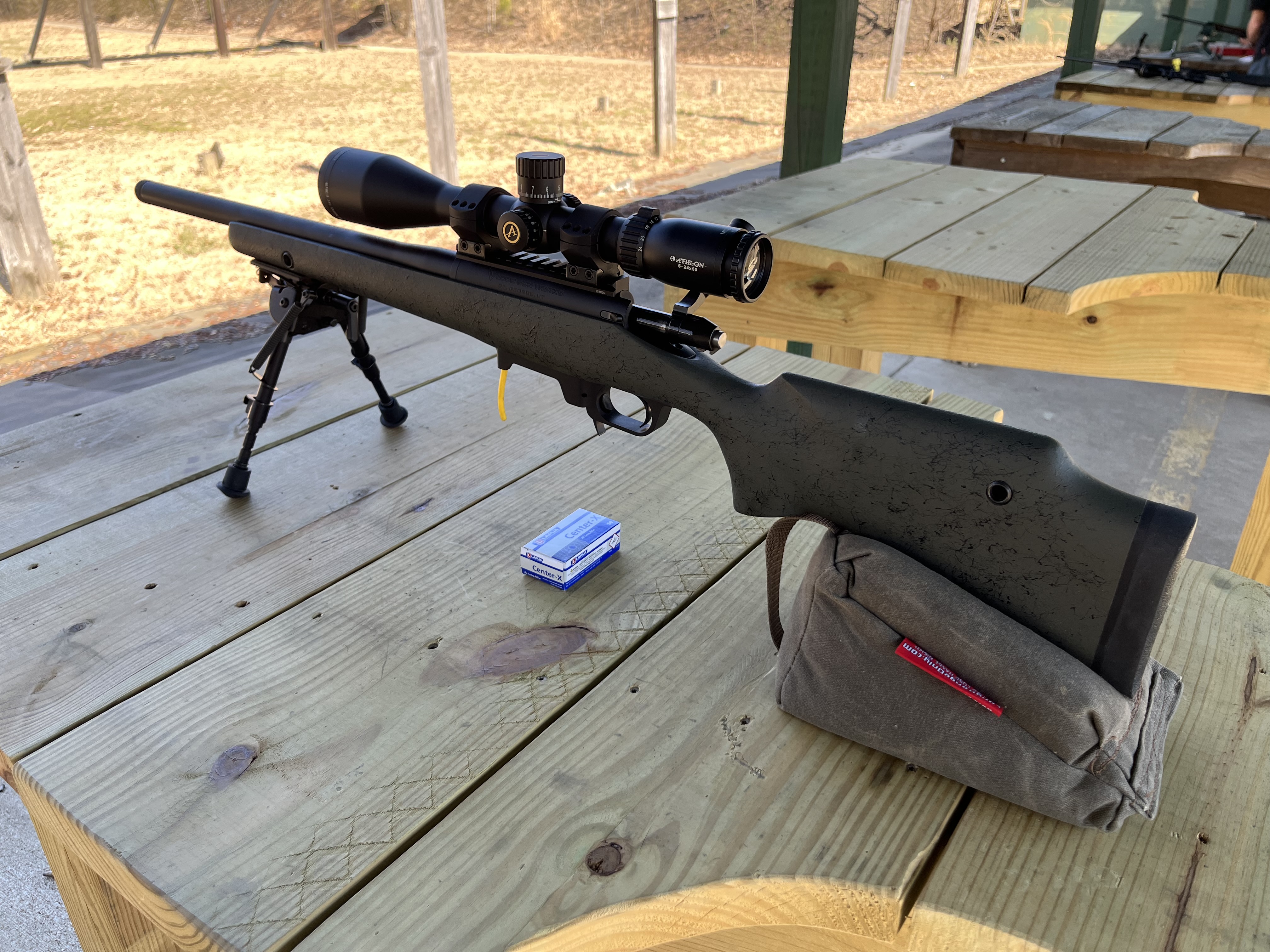

New scope for my Vudoo Single Shot all ready to go.
S&B 10-60.

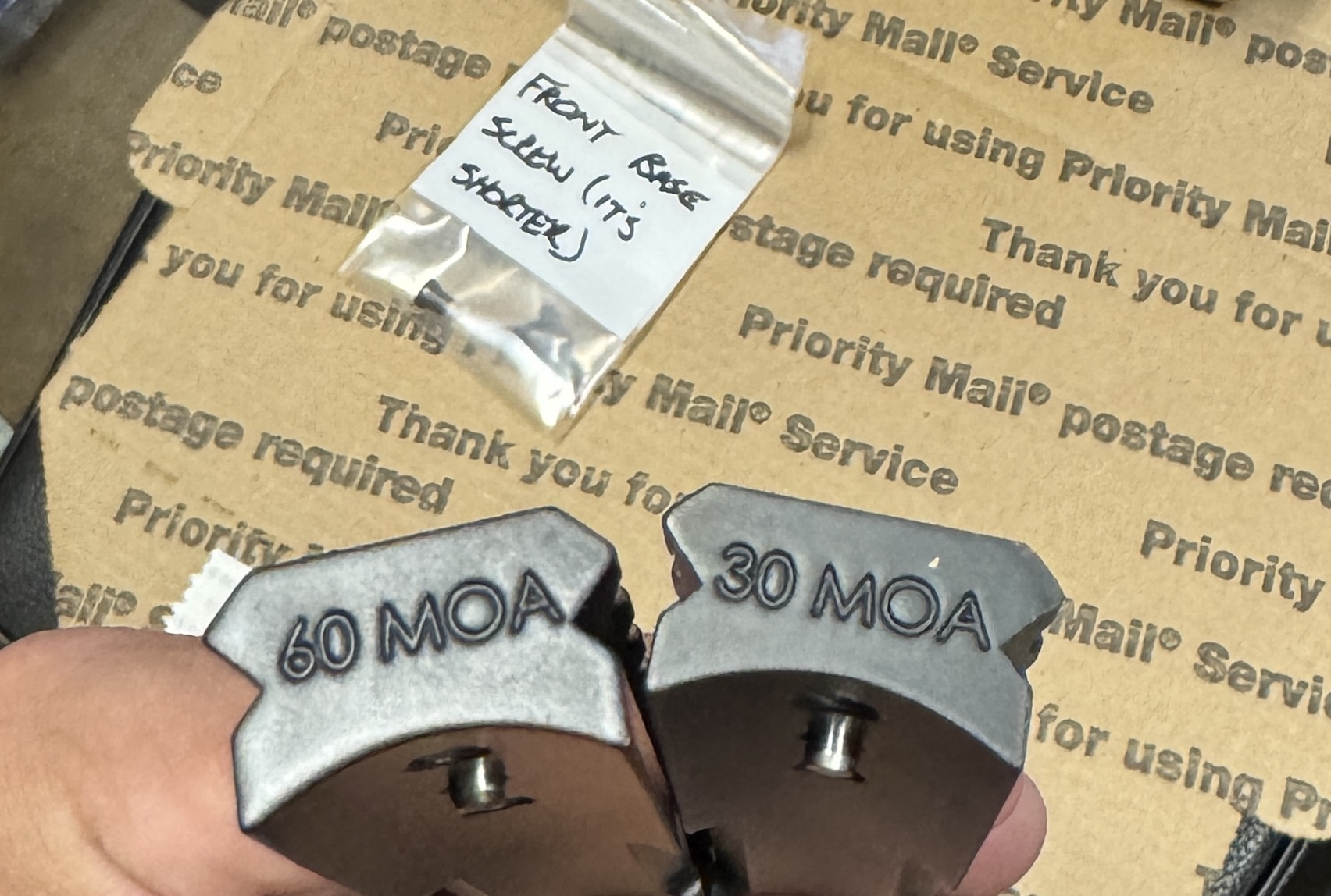

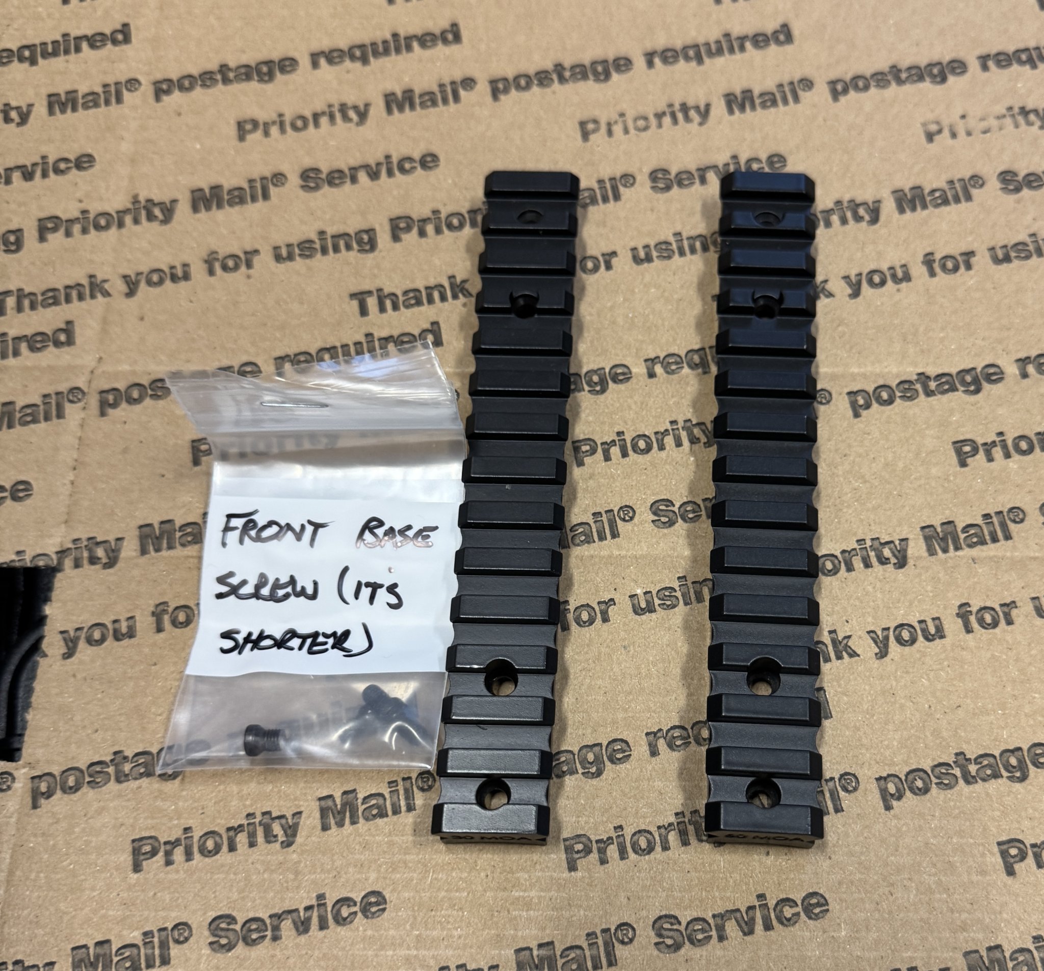

I was looking to switch out my 40 MOA scope base for a 30 MOA one, however the 30 MOA is out of stock everywhere in Canada.
Does anyone know if the Area 419 R700 Improved Scope Base will fit a Vudoo 360? I assume yes, but just wanted to be sure.
No I don’t believe a 700 base will fit and you need a Vudoo specific. Why do you want to change? 10 moa difference is not a lot.
Current running a 40 MOA base with a 20 MOA mount. Was fine with my ZCO527, but I recently switched over to a TT735 which has 5mil less elevation. My 50 yard zero with it is 0.4D as my scope ran out of elevation.
The Canadian distributor won't have anything until the April export and that's not even confirmed. Was hoping to fix my issue before NRL22 Nationals in May without buying another mount.

Near Manufucting in Canada could make one for you, I’ll bet. Whatever MOA you want and probably better than anything else.
Guy is a legend. Call him, don’t email. He’s got a couple of websites that basically show the same stuff.
I'll try giving him a call tomorrow.
I also found someone that does custom cant and ships to Canada. Anyone have experience with Murphy?
I do. He’s awfully good, but I must admit Richard at Near is perhaps better. Richard’s R700 bases have a little recoil bump on the underside that Murphy doesn’t do (last I saw).
However, Murphy makes lots of stock rails that Richard would have to make custom.
I particularly like a titanium Tikka rail I had Murphy make. Can’t go wrong, really, with either.
Richard ships like lightening; Murphy ships average speed, sometimes slow. I think Richard’s pricing may be higher, but perhaps it’s a wash for you canucks.
I’d definitely give Richard a call, but this is what his site says, emphasis mine:
Remington 700 SA 10 MOA and 20MOA
Remington 700 LA 10 MOA and 40MOA
ALL BASES 175 plus airmail
Last time I had an Alphamount made it was basically custom-ish though so he’ll probably work with you and his stuff is truly beautifully made.

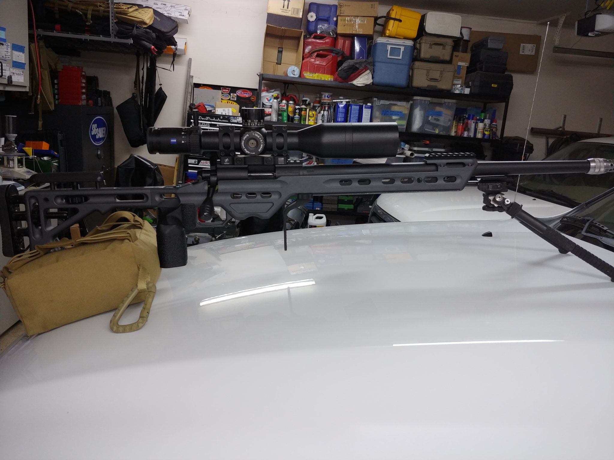

My VGW V22 Apparition in MPA chassis, Harrell tuner brake (helps tame the crushing recoil of 22lr), 30MOA rail, 20 MOA American Defense mount, Zeiss LRP S3 scope, and Gray Ops bag stop. I switch between Harris, Atlas and Warne bipods.
She's a shooter for sure.
