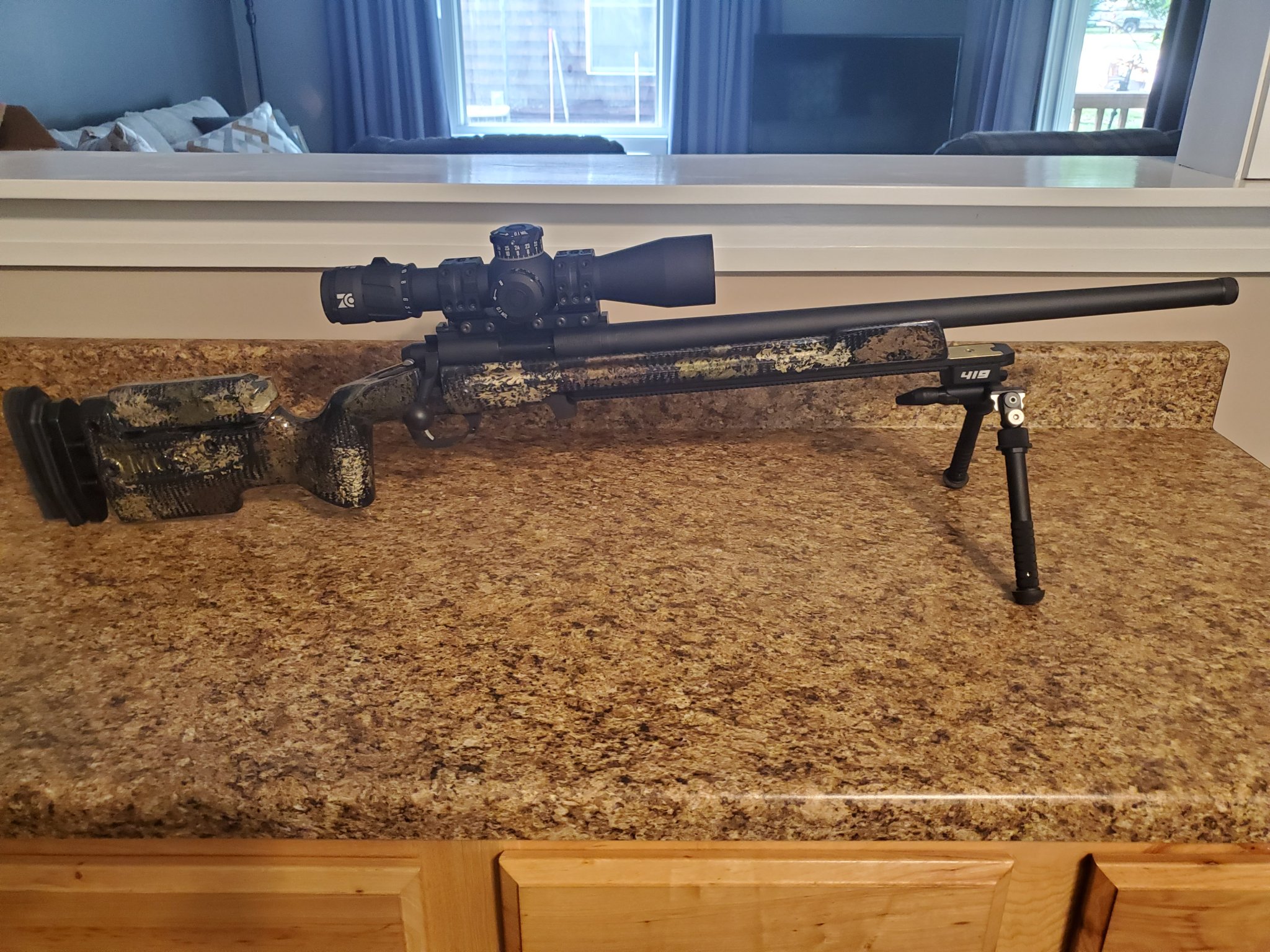

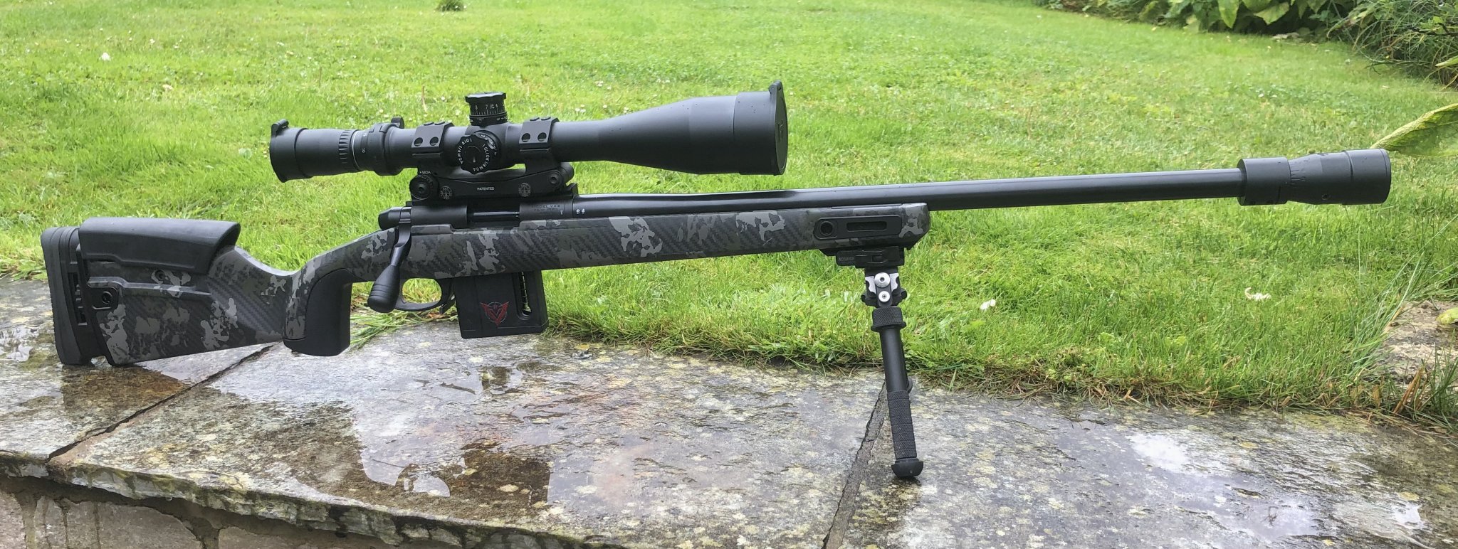

Sweet looking outfit. I just ordered my tuner tonight.basically at 50yrds 1 small hole for 10 shot group. Really excited to see what I can get at 100yrd.First opportunity to play with my UK built Vudoo'd action rifle , start testing ammunition brands. Unfortunately the rifle's better than me at present re. holding consistent groups at 50 yards, but in saying that Lapua Centre -X seems to be good and the new SK flat nose Match equally so. Will have to use a longer range to set up the tuner, its just bolted on and screwed in a present.

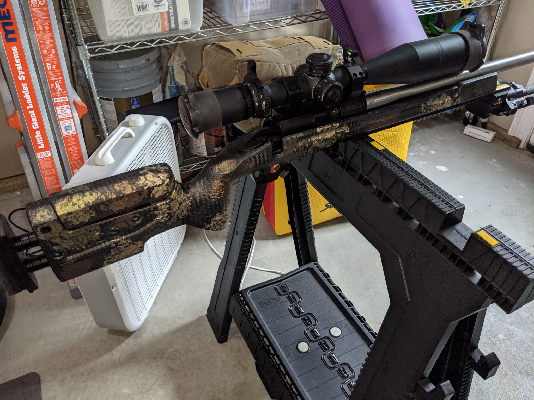

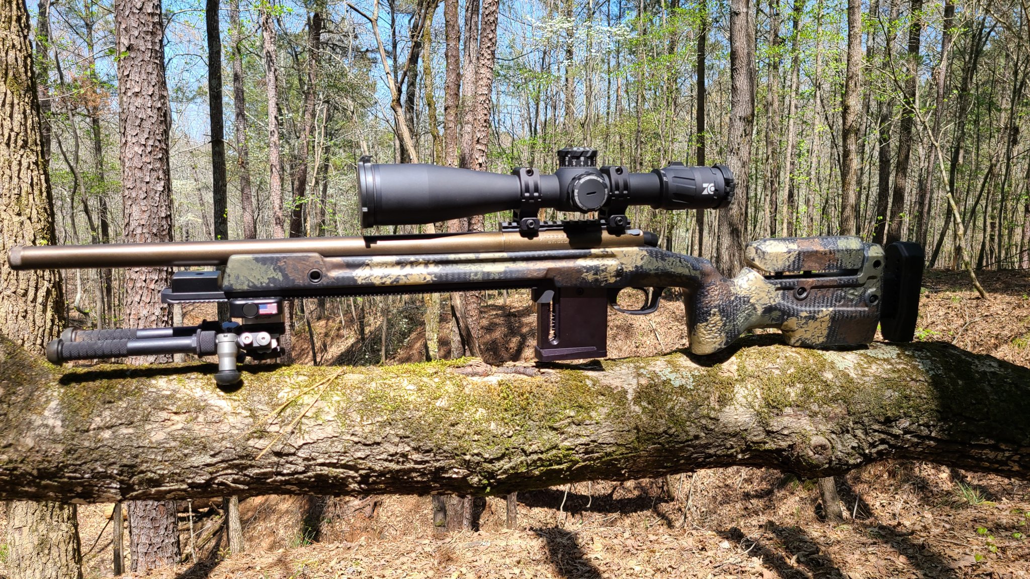

The build concept was a mirror of my 6mm Dasher range rifle so it sits in a Gunwerks Verdict stock. Bartlein barrel, tuned Jewell trigger. Scope's a March 10-60 High Master on the ERATEC mount - who's adjustments match actual POI results
Thoroughly enjoying this rifle.

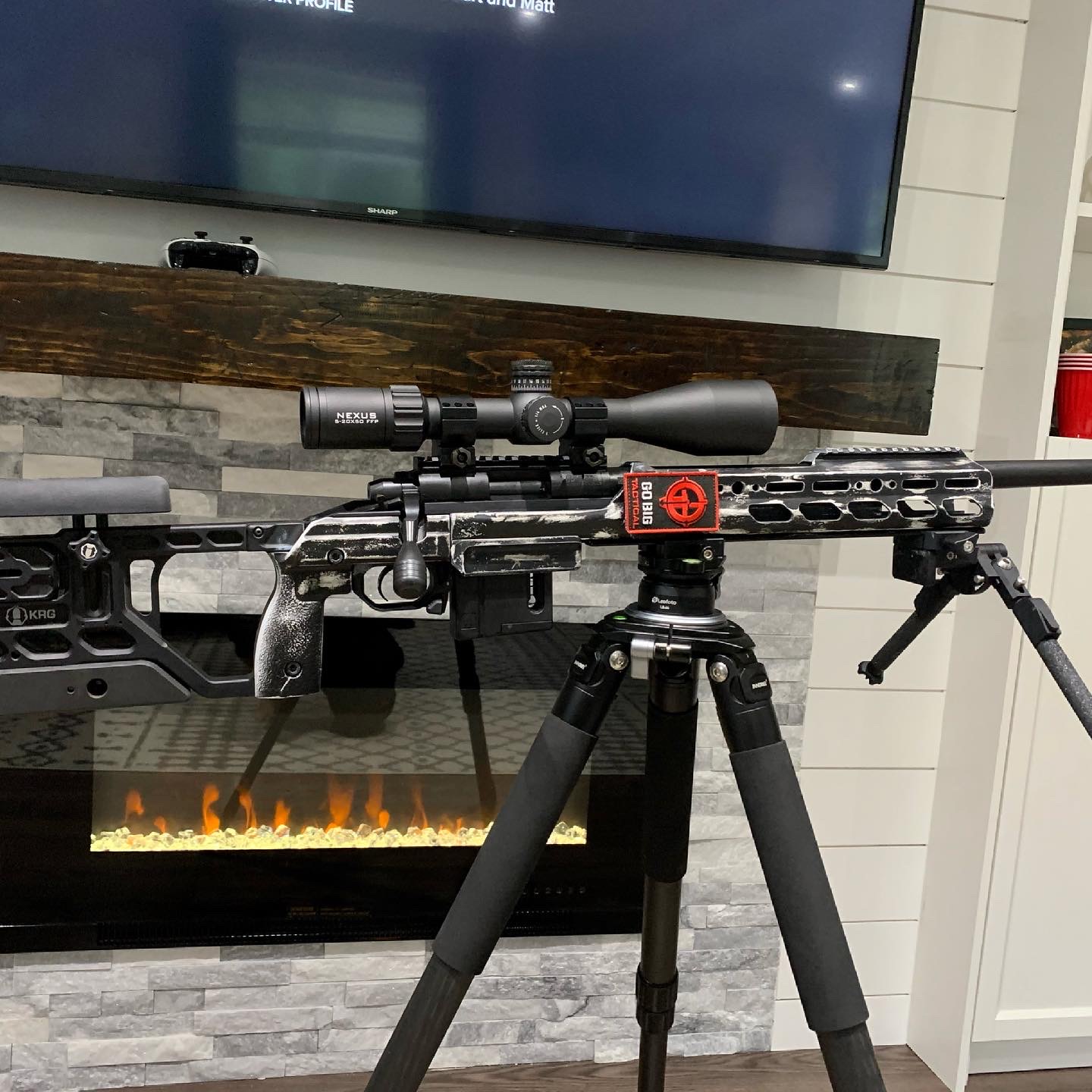

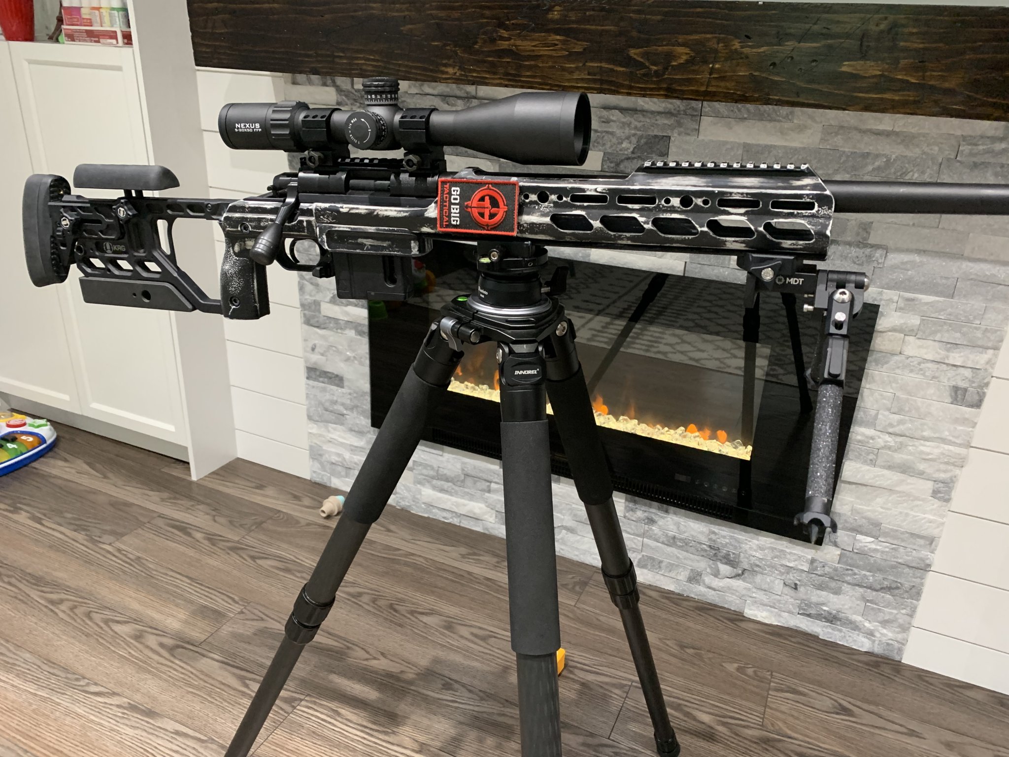

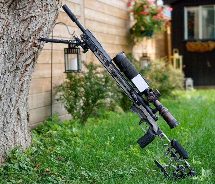

Yes! Looks great!!FINALLY got to join the cool kids' club.

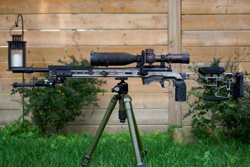

V-360 with 22" MTU barrel
Manners TCS
ZCO 4-20x
Spuhr mount
Yes! Looks great!!
This is my next setup. Let me know how it balances and what model of spuhr Mount is on it.
Also, I was debating about asking Manners to moving back the bottom about a 1/4 inch since the gap between the grip and the trigger guard is significant..
Hmm, from my inquiry, it's possible to move it .400-.500 back closer to the grip.I asked Manners to do that, and they said that there were some difficulties in doing that. I ended up selling my Manners PRS-TCS.
With no weights on the back, and all 7 weights in the arca rail, and the bipod off the front, the rifle would balance in front of the mag well... and it was hefty.

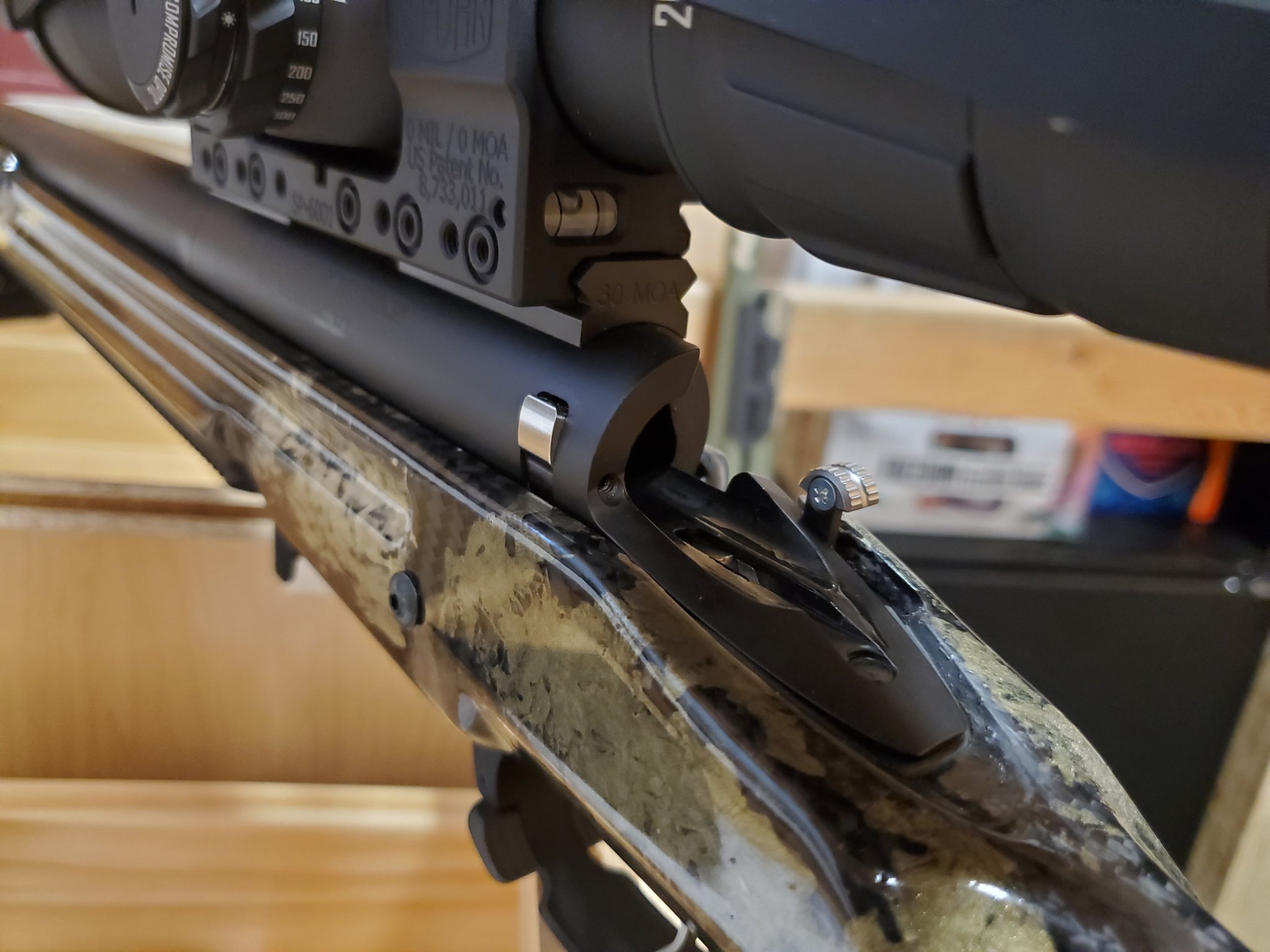

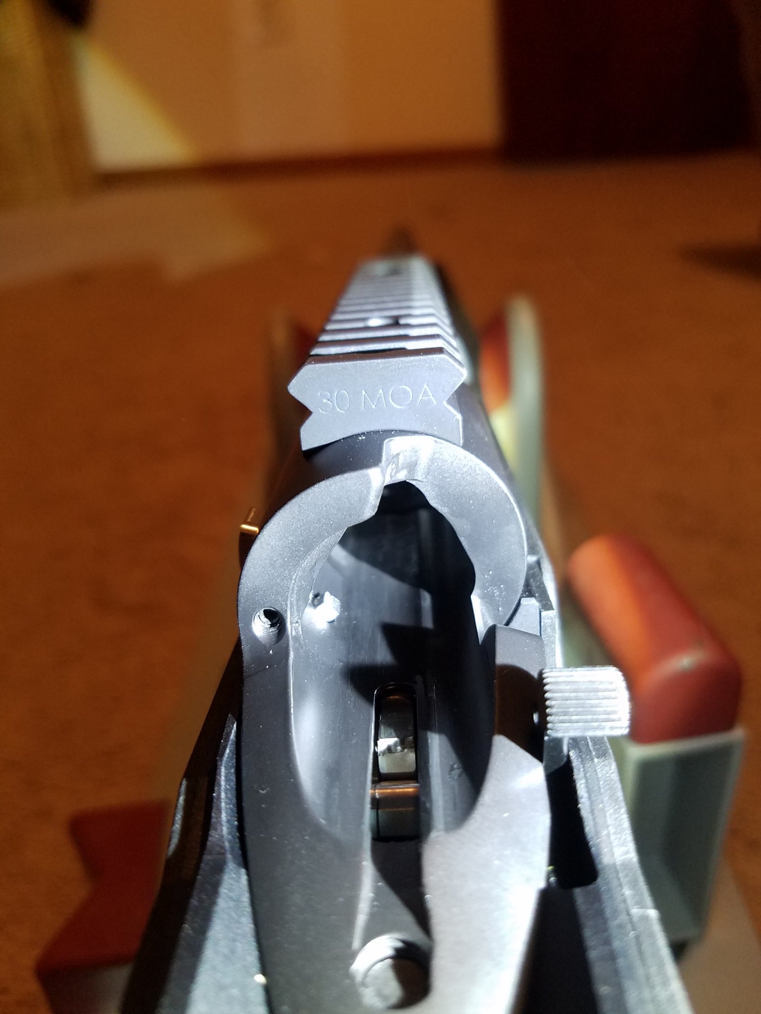

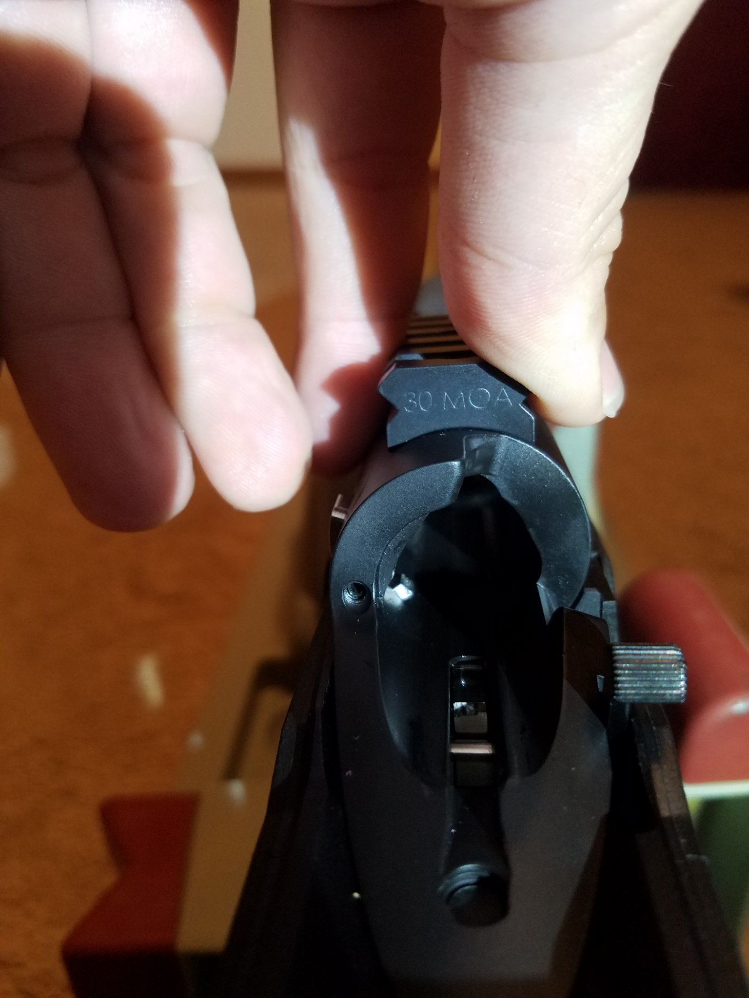

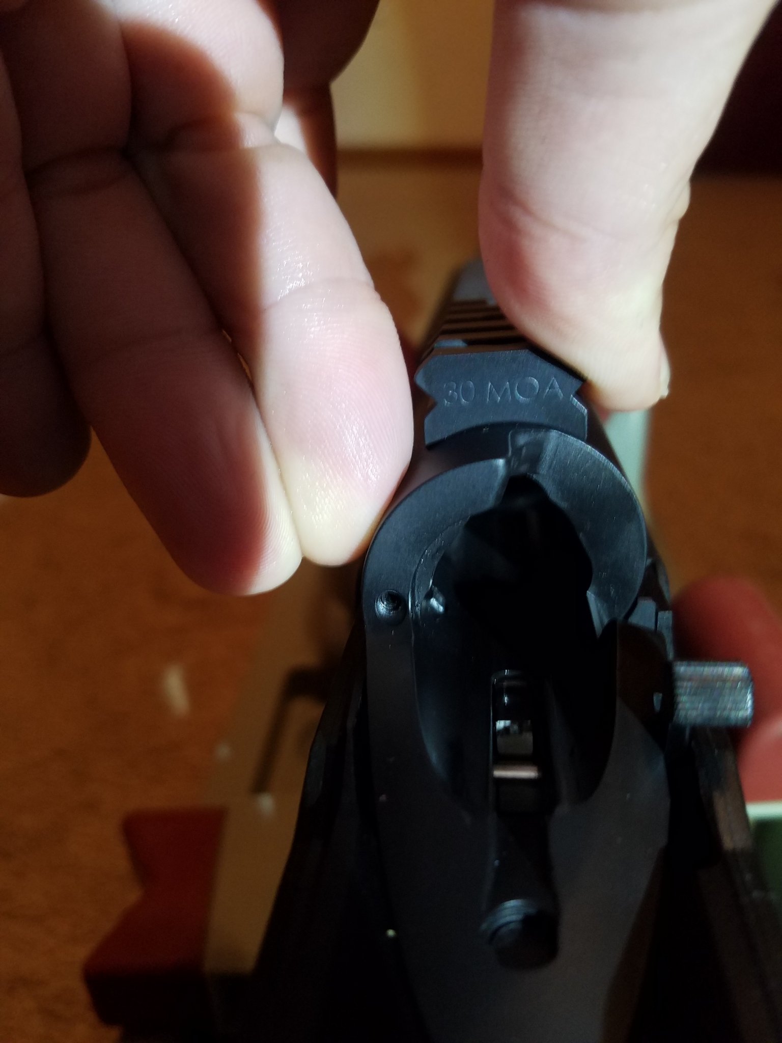

Running into an issue with my 360 where I can't get the bolt in. When I press down on the silver button it doesn't fully retract on the inside. There's maybe 1mm or less that still sticks out on the inside. Am I missing something or just short a few brain cells as it's been driving me insane for the past hour. Should I file it down a bit on the inside?
Edit: On another note the markings on the action read V22. Is that normal? I thought it would read Three 60.
Seems like I need to keep the button depressed to insert the bolt.Bolt back in action? On my standard Vudoo I just push the bolt in. No need to push the bolt release to reinsert. Is the 360 different due to the three lugs?
Post a pic of how it’s being pushed. Pushing the bolt release should pivot it out of the way of the bolt so if it was removed it should be able to be replaced.Seems like I need to keep the button depressed to insert the bolt.
When I depress the button it doesn't pivot the piece on the inside out all the way. There's maybe 1mm or less sticking out still. Is that the same for you?Seems like I need to keep the button depressed to insert the bolt.
My lugs are in the exact same position however the handle is at more of a 3:00 position. I'll try to see if I can get it at a 2:00 tomorrow as I'm not home right now. The main issue is think is that the inside piece doesn't retract 100% when I depress the button. One of the corners in all the way in but the other one sticks out a bit. I'll try to get a photo of it tomorrow to post. Will also try to push it in from the inside through the ejection port but that isn't really a long term fix imho even if it works.If I push this button in, the corresponding 'tit' (for lack of a better word) moves out of the way 100%, it's too dark to get a picture of but I suspect you know what I mean, Rob.
Yeah, bolt unlocked would definitely make it difficult to insert.
So when I insert my bolt, the bolt handle is up (2:00) & I've got lugs at 12:00, 4:00 & 8:00. That should tell you if your bolt is unlocked & ready to go back in.

That's true, I did not think about that. Good thing I read your reply before doing that and possibly be stuck with a bolt I can't remove.I wouldn't insert the bolt by reaching through the ejection port cause how are you ever going to get it back out?
On my bolt stop the top to bottom is angled to match the action walls when depressed, but from front to back those edges are completely straight (once again matching the action walls). All 4 side walls on my bolt stop are completely flat. Which corner sticks out on yours, assuming it's the one facing the back of the action?

@J-HamPost a pic of how it’s being pushed. Pushing the bolt release should pivot it out of the way of the bolt so if it was removed it should be able to be replaced.
Have you tried to just push it in? Maybe @RAVAGE88 can help out.

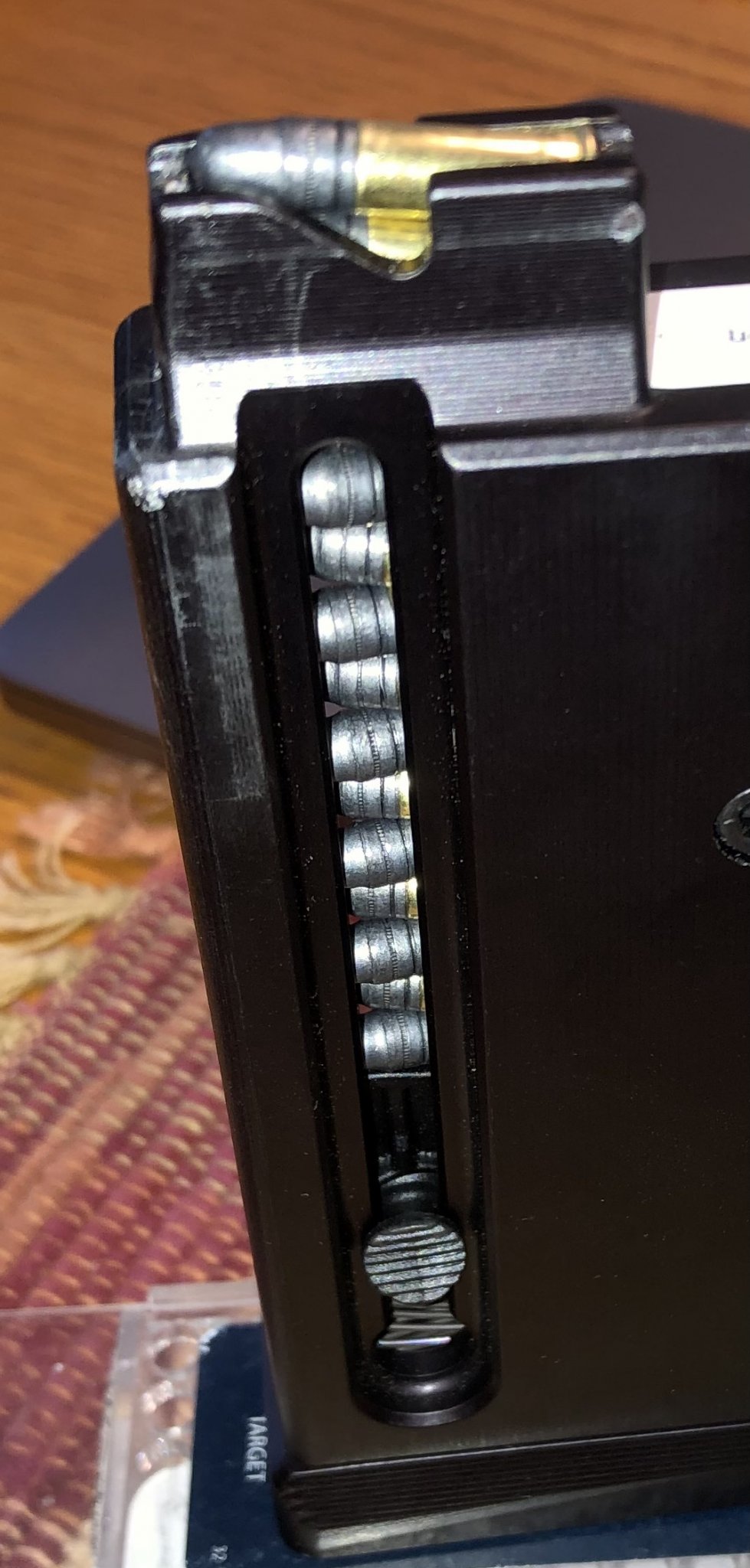

There is a video from Vudoo on how to load the mags, before there was a mag loader. Do that and you won’t need it or have problems. Otherwise if anyone wants one of my mag loaders you can PM me and I can send it to you.Is there a video on this mag loader and it's function in relation to "rim locking" somewhere?
I watched that video, just not a 100% convinced yet that there isn't one slipping over the rim yet.There is a video from Vudoo on how to load the mags, before there was a mag loader. Do that and you won’t need it or have problems. Otherwise if anyone wants one of my mag loaders you can PM me and I can send it to you.
I've never had rimlocking in thousands of rounds through my Vudoo with polymer and aluminum magazines, so I can tell you that with proper technique it will not be an issue. But as I said, I'm happy to part with the two loaders they sent me...I am not using themI watched that video, just not a 100% convinced yet that there isn't one slipping over the rim yet.

Very close to my set-up. With a 20" MTU and 5-27 ZCO. To get the balance I wanted had to fill all weight pockets in the 419 rail and remove all the steel weights/spacers from the buttstock.FINALLY got to join the cool kids' club.

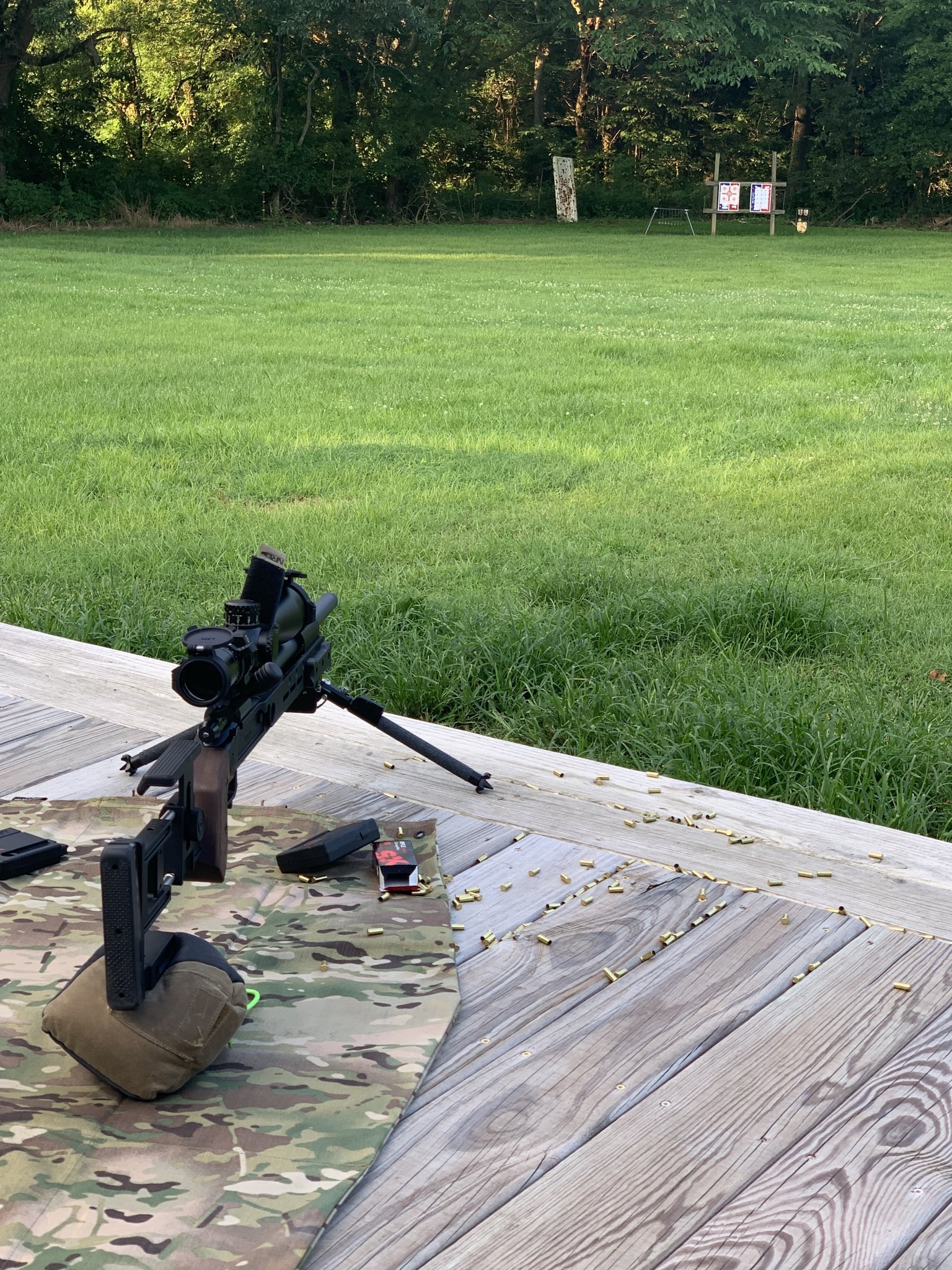

Just wait till the ceracote wears in. The thing is mint after 1k or so cycles.Just picked up my new 360 today. Super happy gun shot great right out of the box tiny hole at 50 and about half inch at 100 with center x I went with a 22mtu not threaded, trigger tech diamond in a foundation exodus. Glad I went with the 22 mtu rifle balances right in front of the mag well. Running the bolt takes a minute to get used to wants to bind if you try to manhandle it but with the the right technique it runs great I’m sure it will smooth out with use.
Does the 360 have any advantages over the Gen 1 V22 other than bolt throw and bolt disassembly?I spent some time with my new 360 this afternoon after our local PRS match. Running the bolt with the round bolt knob feels a lot like my AI centerfire rifles.
With random boxes of non lot tested Eley, breaking rocks on the backstops from 200-300 yards was easy. Hitting a 6 inch plate at 410 yards was very doable.
After I get a couple hundred more rounds through this it will be time to send it out for lot testing.
The Vudoo staff member down in St George that does the cerrakoating does an outstanding job. One of the best I have seen in a long time.
All in all I am very impressed with the 360. Might give my 2 lug Vudoos to my god daughters. Between them and my 40X repeaters I am knee deep in 22 bolt guns.
