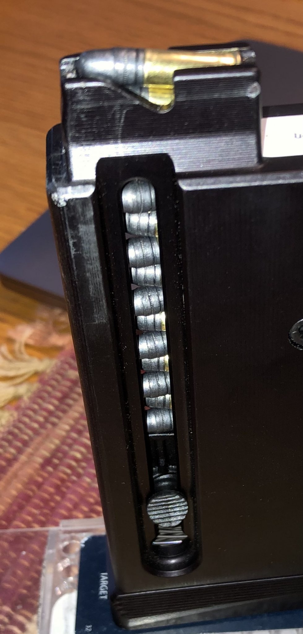

I think it's been mentioned elsewhere, but let me say again here from perspective of personal experience: with my 15-round magazines, there seems to be a correlation between "nose down jams" and the orientation of cartridge noses in the mag.
Look at the photo. While case heads are obviously single-stacked, the bullets alternate left-right-left in the column. My experience is that, if two or more bullets aren't alternating as shown, there is an excellent chance that a bullet nose will fail to "pop up" into the requisite nose-high attitude as shown in the Vudoo video, oftentimes even when the video's "attitude correcting" measures are taken.
I don't have a sufficient verified sample size yet to say the alternating-bullet-attitude thing is a sure&certain cause of failure to feed reminiscent of rim lock. But pay attention; we'll see.
(And yep, that's CCI SV ammo in there... I didn't wanna get Lapua bacon grease on my fingers for this learned post :rolleyes:...)

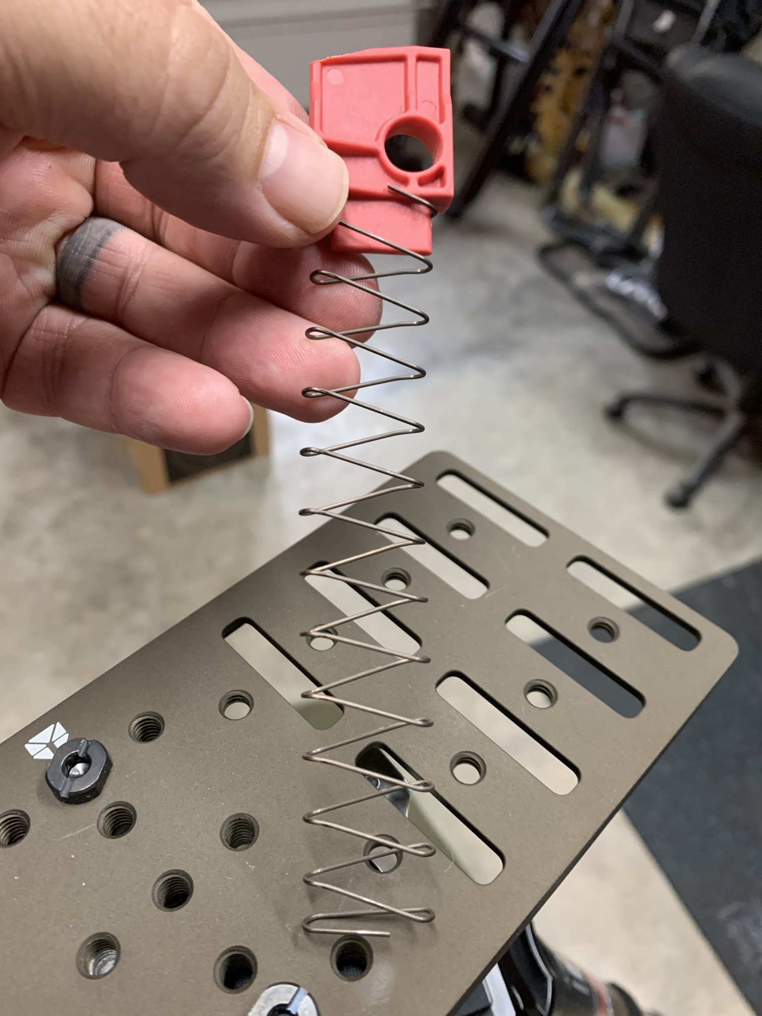

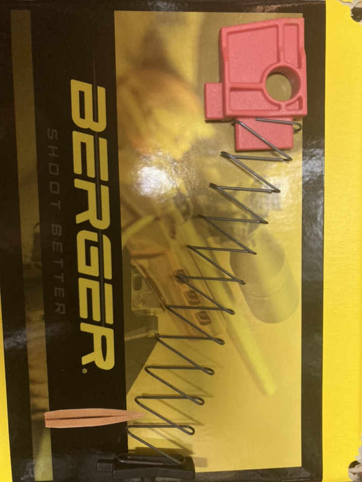

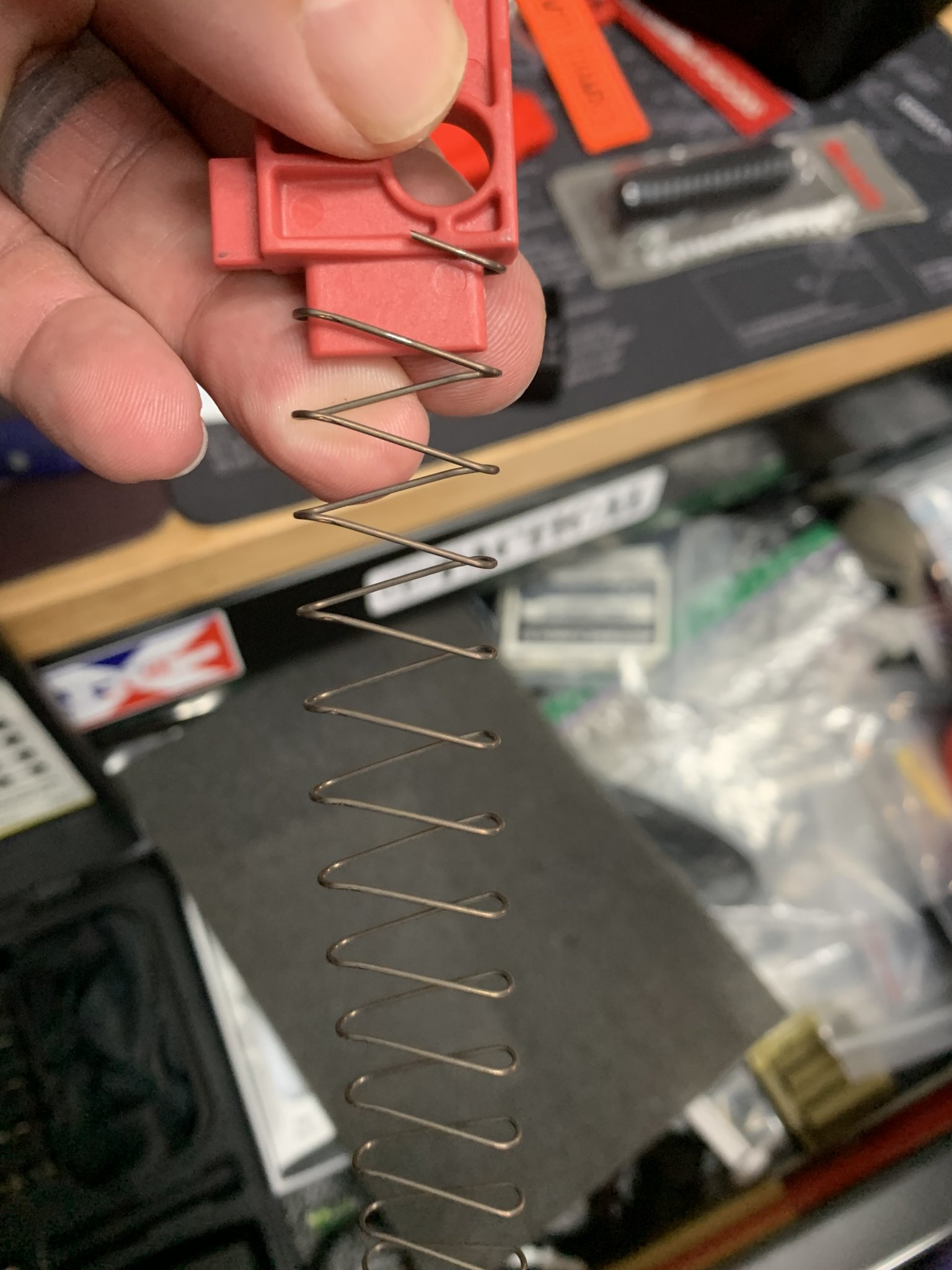

I have been having un reliable feeding issues from my 15 round magazine from day 1. I have only had it for a couple of months and plenty of the Glass filled ones so it wasn’t an issue. I wanted to use it at a PRS match this weekend and it just wouldn’t work. I was told some things to try and made it a little better but random just not feed at all. A few messages back an forth from MB on IG page as that’s where I was when I was thinking about it.
I think I have a spring issue and it will be solved. I was loading it for the 3rd time tonight just cycling ammo through and noticed the spring was not stacking on the follower & was binding up under it. Here is a pic as I don’t figure the video will upload. I sent the video to MB and waiting his response. I know 100% Vudoo will help me solve the issue.
It is a 15 rounder and came from Vudoo that way. I think it was done to help with Nose Up feeding into the chamber.
MB just confirmed I have a spring issue. It should be flat on the top towards the follower. I’ll try to make it set as flat as possible against the floor plate and run it.

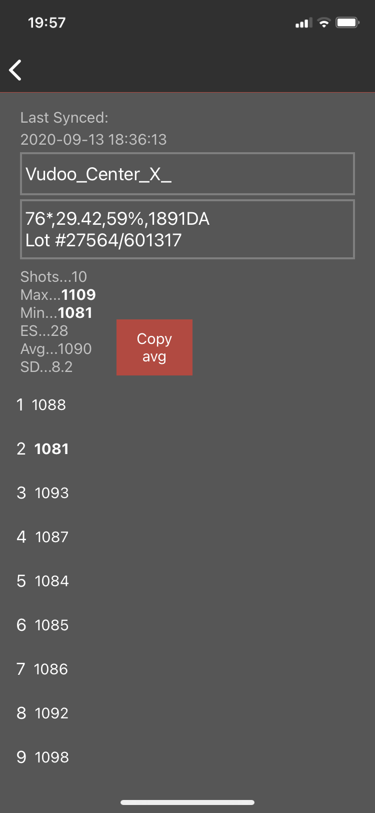

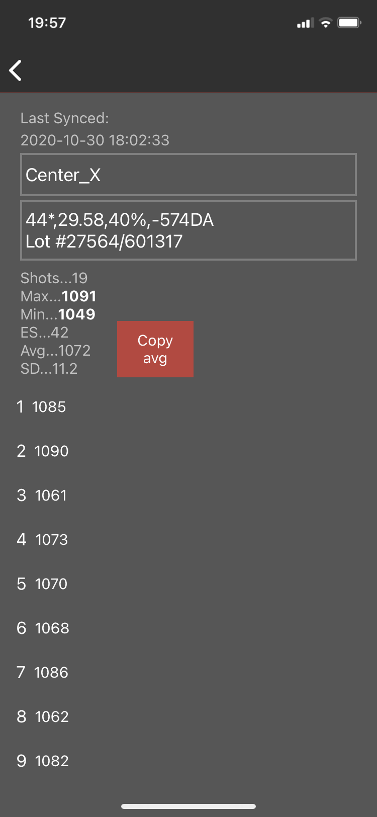

I've been getting higher velocity measured by VS. not sure what's that all about. Kind of screws me up so i stopped using v3 and just do a MV calibration in my Kestrel.
For you guys with 22 inch barrels what’s your average velocity with center x. Having trouble getting my magnetospeed sporter to work lately
How do you know if the velocity is higher than it should be? Did you get a reading on another chrono? Or multiples to make sure which is right? If just using what you are seeing down range then I doubt it’s the velocity and more with the BC or environmental conditions.
I use the Magneto speed chronograph, center x and sk long range was shooting hotter , I'm talking 1199 for CX. This wasn't just one shot either. Maybe there is something wrong with my v3. Dont know. But with the same setting i wasn't getting such high Numbers with a 20" V22.
Is that the new box center x?
I would check the settings again and then try and find another chrono to verify.
No, it's the older box. I haven't played with the v3 since and now that my buddy got one I'll be able to verify. Trust me, it puzzled me.
Since then, I took my kestrel, took environmentals, distance to target (200yd) and calibrated MV to actual hits. It's been right on since then (i did that to each ammo I'm shooting) .
Reactions: Rob01
1092 wow that’s faster than I thought. @Badjujuu your barrel a 22 inch? I don’t have a kestrel trying to figure it out old school lol
Dpending on the lot of Center X it is anywhere from about 1065 to 1106fps in my 18" barrel. Interesting fact though is the SD in each lot is around 6fps on average so as long as I stay in the same lot I am good.
Reactions: Badjujuu
Yup, 22 MTU - I'll be heading to the range Friday so I'll run the V3 again on it. I believe my sensitivity setting was 6 last time I ran the magnetospeed.
I'll bring my 20" as well to bounce it against it

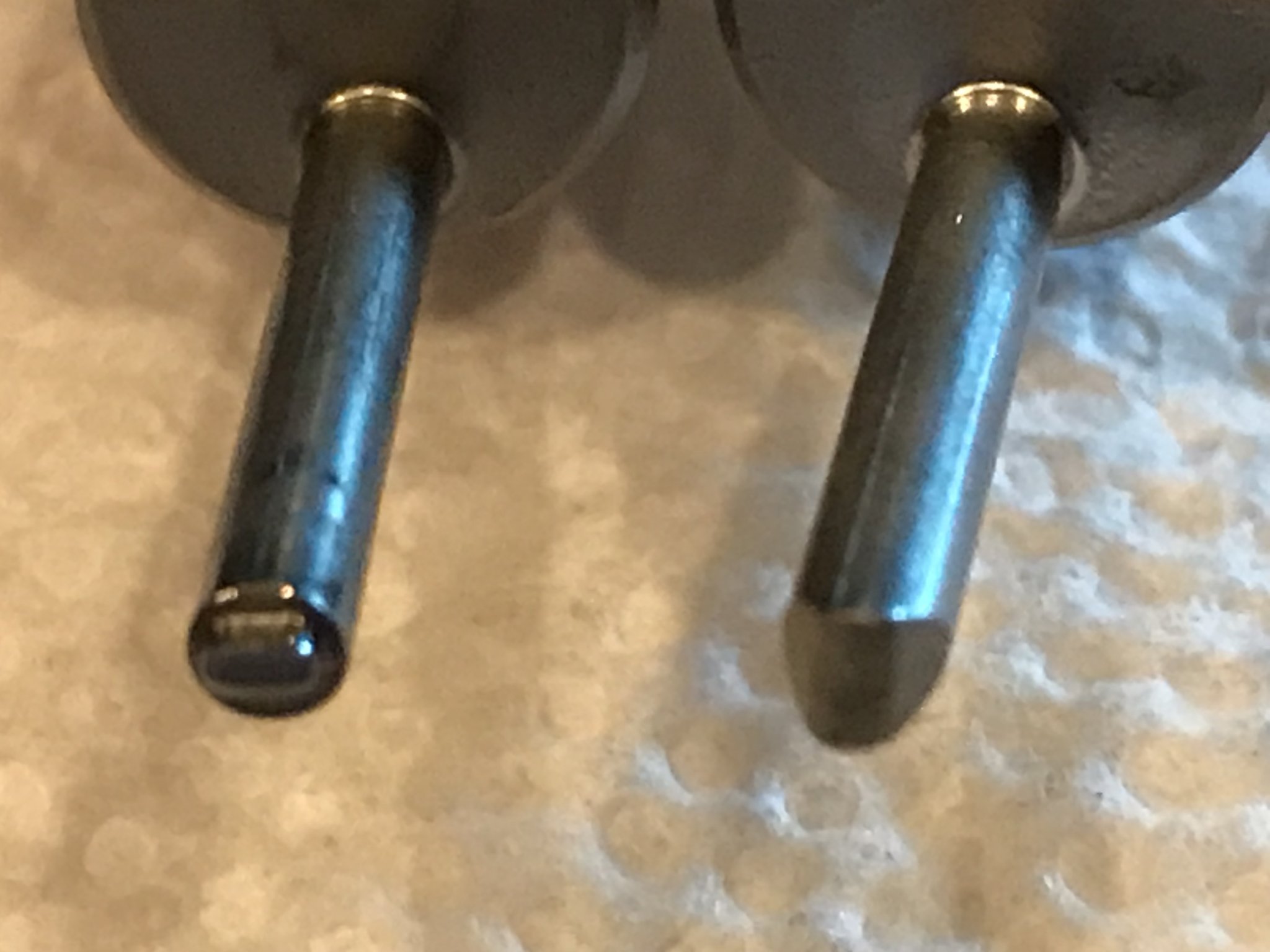

Picked up my Three 60 this week. Kinda nice to see a company that could easily thrive on the success of their Gen 1, and sell only that model for decades, continue with evolutionary changes in an effort to keep improving. I know the current wait is difficult (and largely due to circumstances out of anyone's control), but I personally don't mind. And I appreciate the few who strive for excellence these days. I'm not a fan-boy of ANYONE (well, ok, one Person.), but... well done Vudoo/MB.
I wasn't expecting the firing pin change. Interesting. Gen 2 on the left and 360 on the right.
I sent my gen 2 in for maintenance and while it was there they swapped out the firing pin. They didn’t say why but I was assuming it was the result of some issues they were having with design, kind of like a recall. I guess they’ve moved on from that style.
I think I have a spring issue and it will be solved. I was loading it for the 3rd time tonight just cycling ammo through and noticed the spring was not stacking on the follower & was binding up under it. Here is a pic as I don’t figure the video will upload. I sent the video to MB and waiting his response. I know 100% Vudoo will help me solve the issue. View attachment 7671551View attachment 7671552
After my found Mag Spring issues above and @RAVAGE88 telling me to just flip it over as it would be G2G. I figured the spring needed to be flat on the floor plate as well. It was 100% flawless for 60 rounds last night. I did not cycle the bolt slow and I didn't cycle it fast. Just a fluid motion keeping the plate in view of the optic through the whole cycle. If you have a Vudoo problem of any sort MB can solve and will do everything he can to do so. Thanks MB I appreciate it. Now buy s good bottle of Bourbon (Weller 12) and enjoy some of it this weekend.
