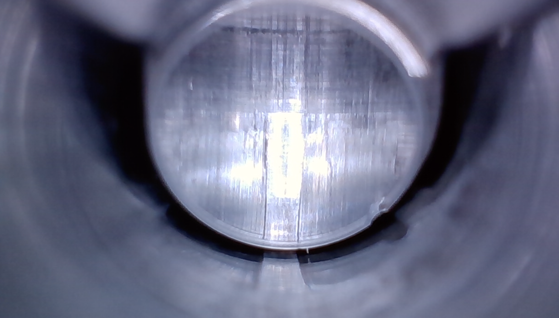

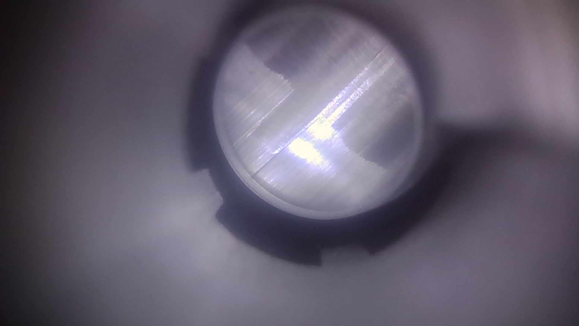

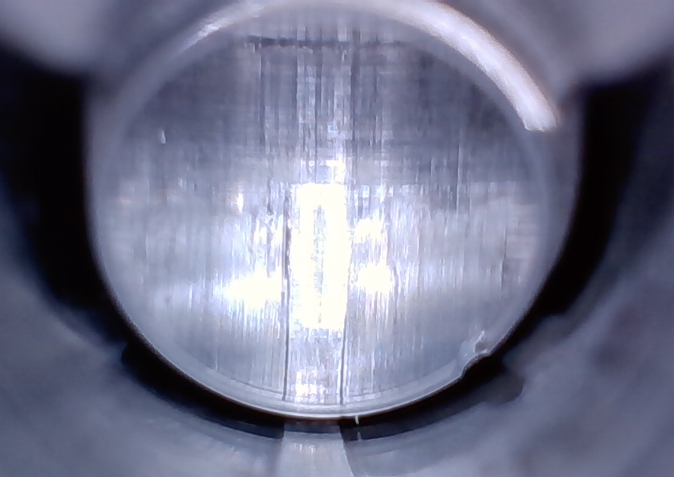

Finally got my 360 back from Keystone. About 50 rounds into it, I was having extraction issues pretty consistently. Can't remember what the extractor is supposed to look like but I think I might have broken the extractor. The left side looks different. Hopefully this is my extraction issue. If not, I've got bigger issues.
What ammo are you putting through it, that you're having extraction issues with?
The lower one is the tensioner (left), the upper the extractor (right). Your bolt looks normal.
I was using SKLRM. If my bolt is normal, now I'm stumped. The SK is the same ammo lot used before I sent it off. FYI, the barrel is a green mountain barrel with Keystone Match chamber.
On a right-handed action, the right side in the bolt is the extractor, while the left side piece is called a "pusher" or tensioner - its purpose is to keep the shell pushed over to the right to keep the rim under the extractor hook. This is the case with all the Vudoo & Rem 40X RF actions. My early Gen 1 V22 repeater worked great for about 500rds, then started having issues with extraction/ejection. This was back in 2017 when the first V22s were released. I called and talked with Paul, explaining what was going on, and he told me that they'd made some changes to the extractor/pusher parts, and offered to fix it if I'd send my bolt back to them. I explained that I had some experience with tuning those parts while working with the two 40X actions I'd had converted to repeaters to use the V22 mags, and was very willing to modify the parts myself. He promptly texted me a video showing precisely what they were doing to change the parts, and I was able to modify mine with very little effort or time. That rifle has worked with 100% reliability ever since.
But with your 360, I'd be calling John at Keystone to get his opinion.

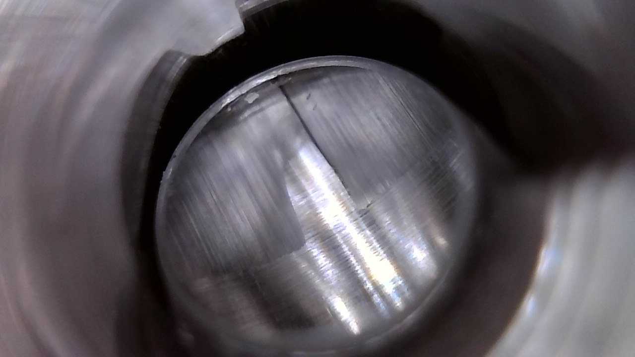

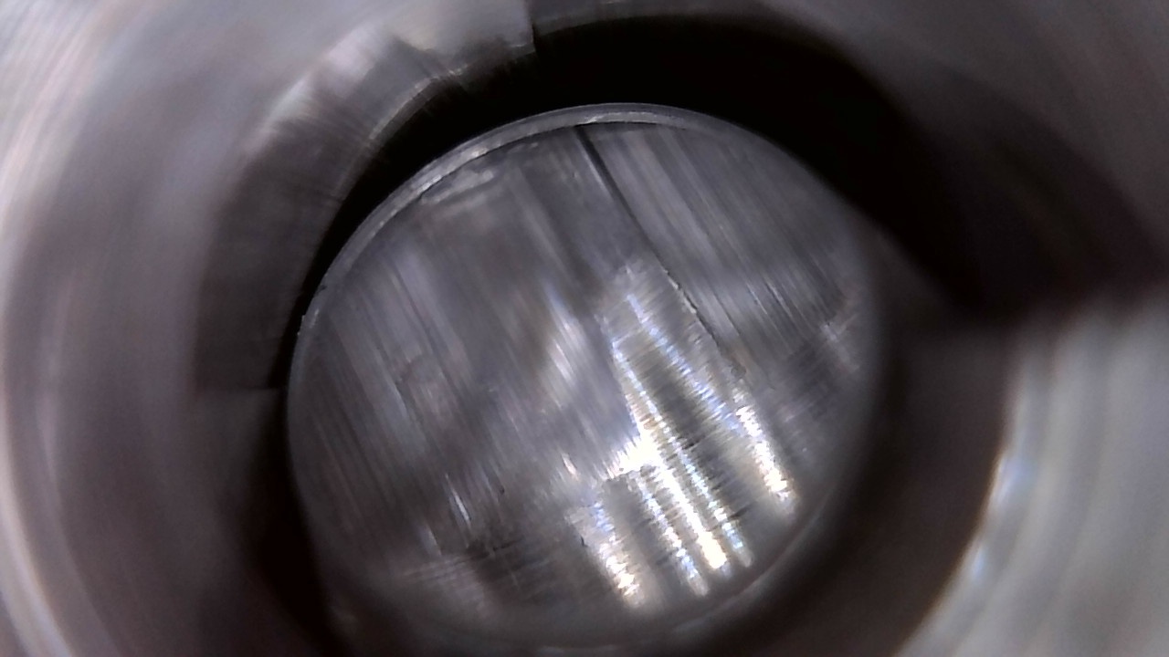

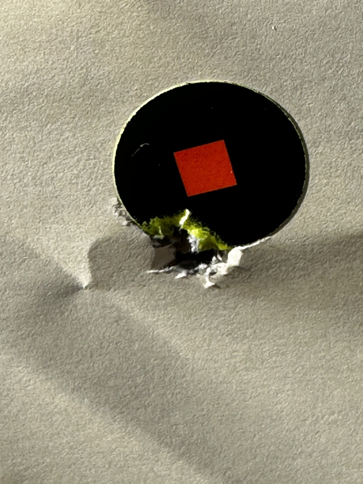

I have been studying the primer strikes on my Vudoo and noticed how strong they were. Several types of SK ammunition end up with the rim bent they hit so hard. Had me debating if that affects accuracy by affecting seal, headspace or rebound after impact? what's the school of thought on this?
Below are pics on my primer stikes in the Vudoo. Notice the bent rim on the SK Rifle Match in the second pic.
The Eley imprints have me baffled. I am second guessing I mixed up my casings between the Vudoo and another 22? As expected, note the light Eley imprints, but also makes me think Eley have a harder case head in their brass?
thks
PQ, you might want to shoot 5 rounds of the same ammo, with a lighter spring in the Vudoo, or maybe a have turn in on the bolt. Either/both should lighten the ignition strike, and lighten the case imprint.
These are hard to tell visually. I started about 2 years ago measuring case depth with a dial indicator. It's helped me understand how consistent my ignition was (or wasn't), so I adjusted the spring setup and moved my trigger hanger to get a very consistent 0.021 case depth across 10 rounds. This might be something you want to consider. FYI.
Reactions: RAVAGE88
