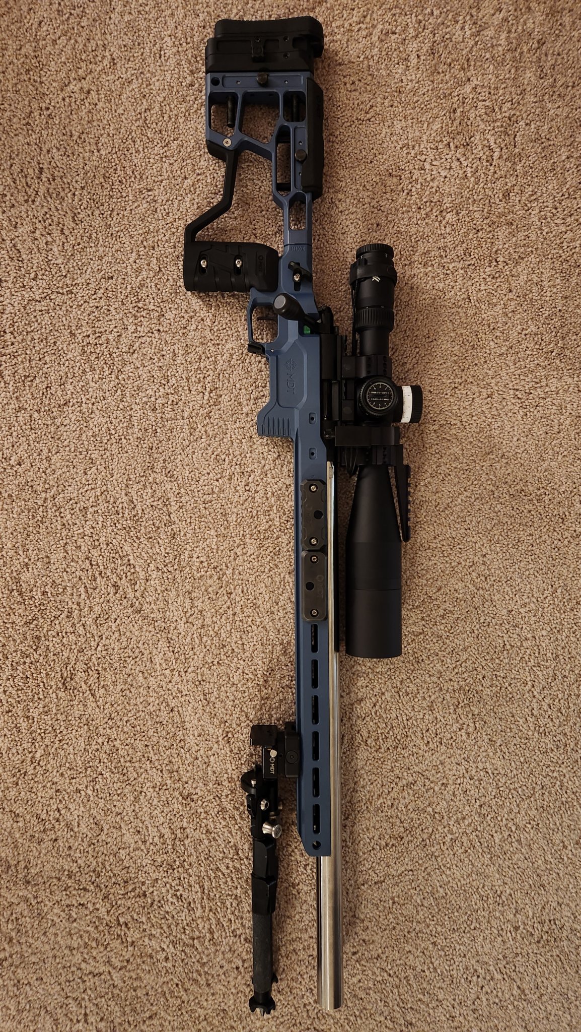

Looking for input on a Vudoo 360, specifically barrel type and length for an MDT ACC Elite Chassis
I just watched a video from eagle eye shooting and he had one with a 24" barrel and said it balanced perfect so I'll lean that way.

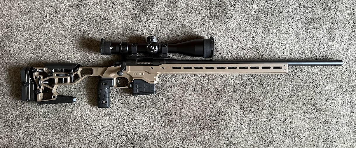

Here's a poor photo of my RimX with 22-inch Shilen (Heavy Varmint contour) in one of my MDT ACC chassis. In my mind, a 22" barrel looks funny in an ACC (too short). Note that the barrel has a KSS tuner on it; its adjustment sleeve extends back from the muzzle so, in a centerfire application, a brake can be screwed on in front of the tuner. In this case, you can see a thread protector screwed onto the muzzle.
I'd go with 24" or even 26" for an ACC. Balance will also be improved with 24".

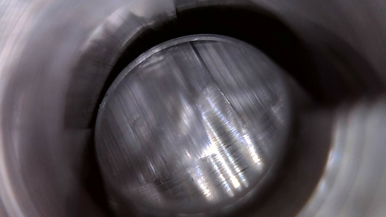

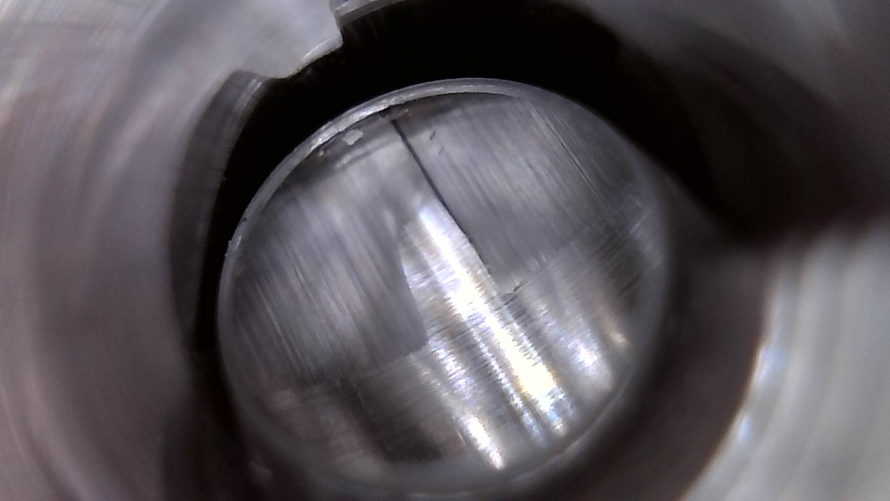

What borescope was used to take these pics? If possible, could someone post a pic of the scope itself?
Thanks
TKH
This is the one I used to take these pics. Plugs directly into my phone. I can get you some pics of my scope but it will be a couple days.

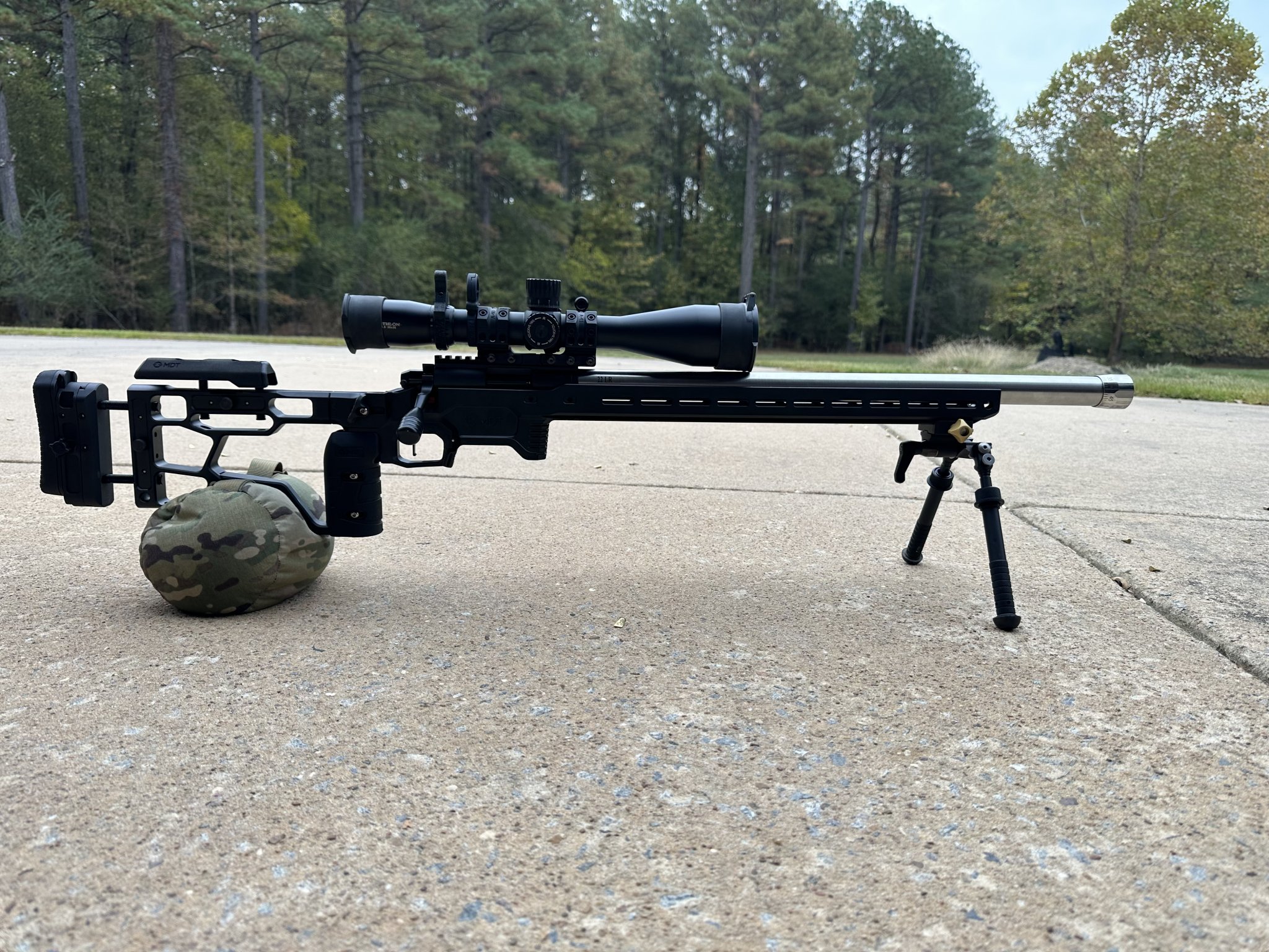

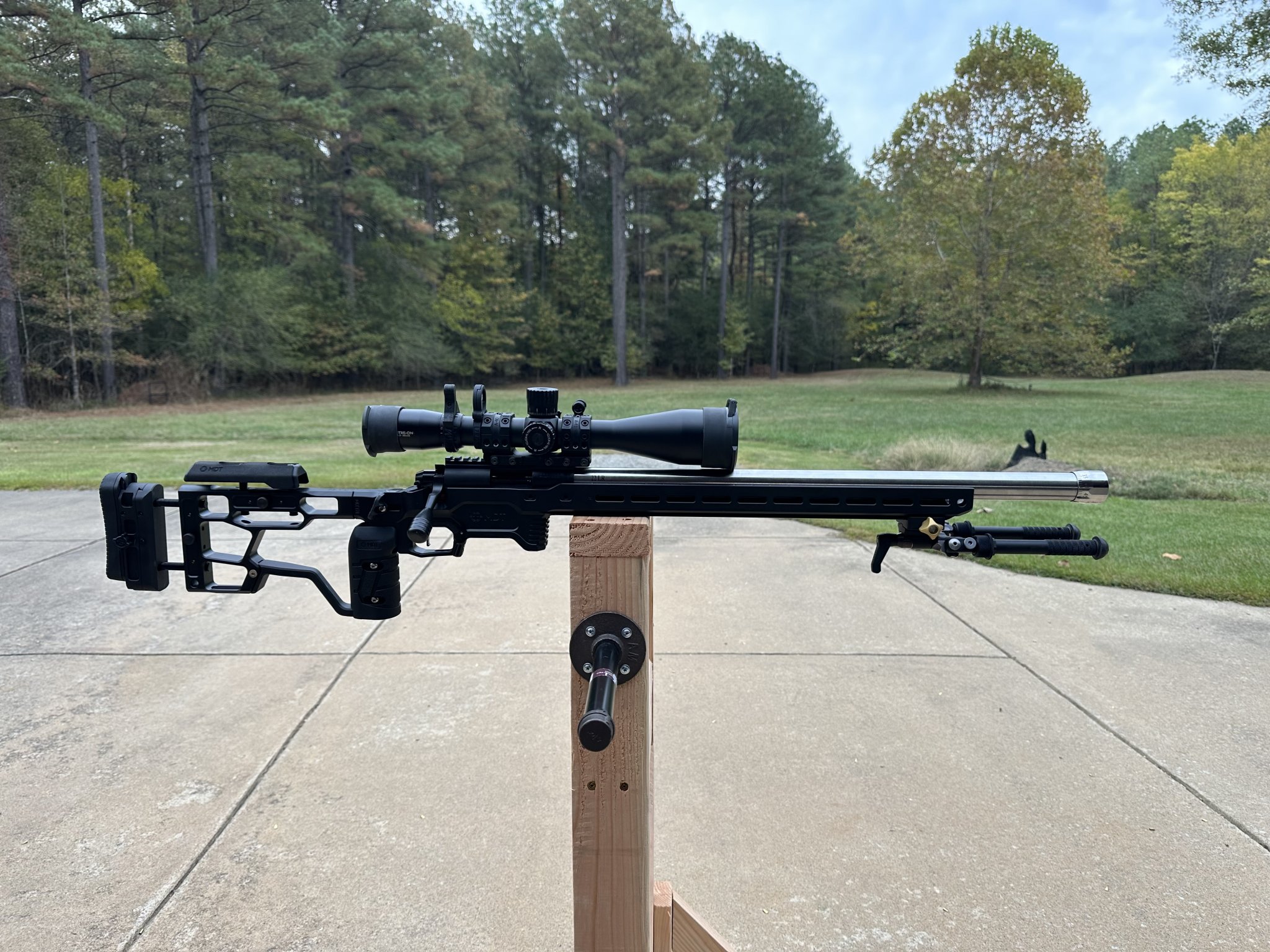

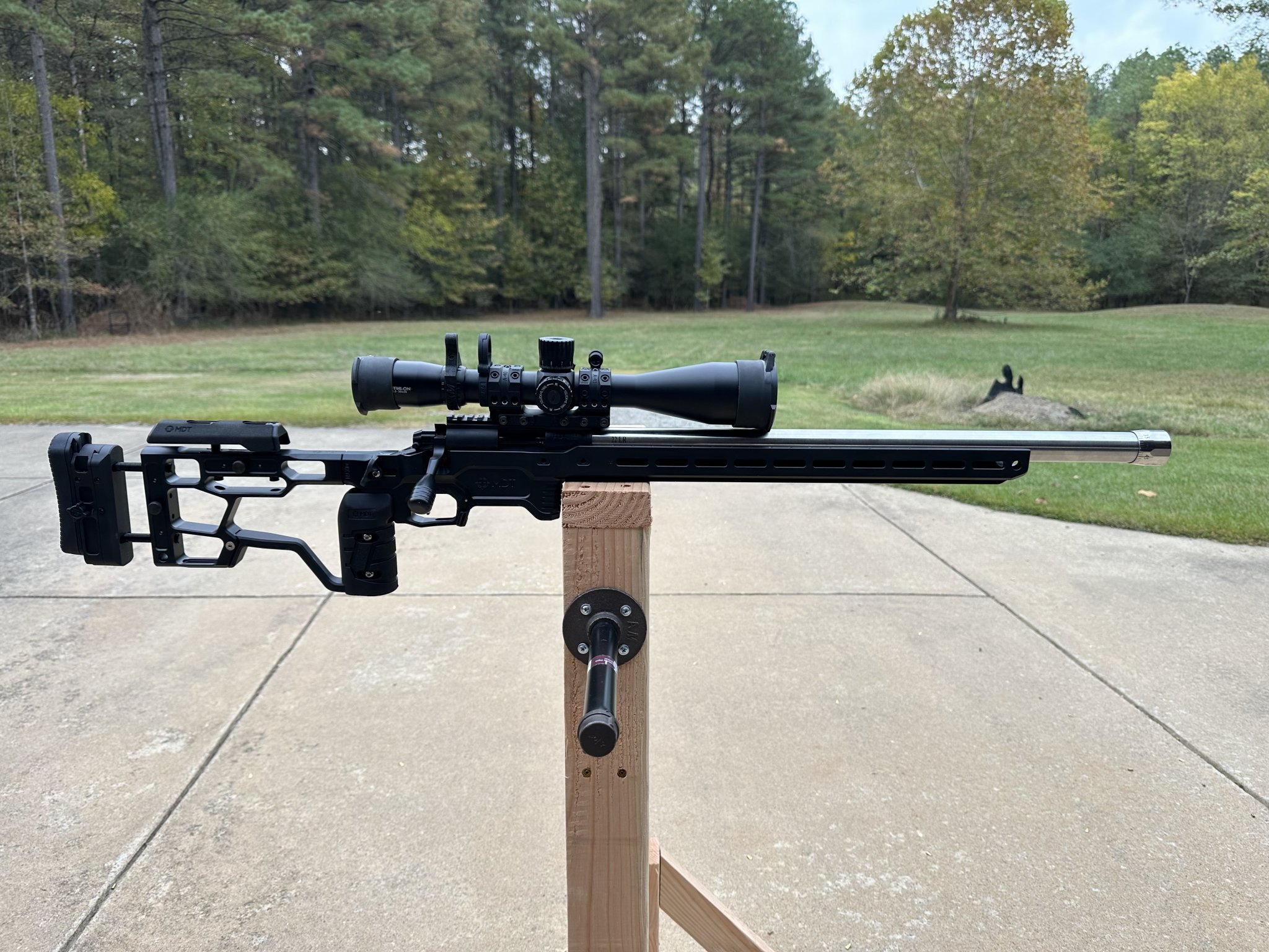

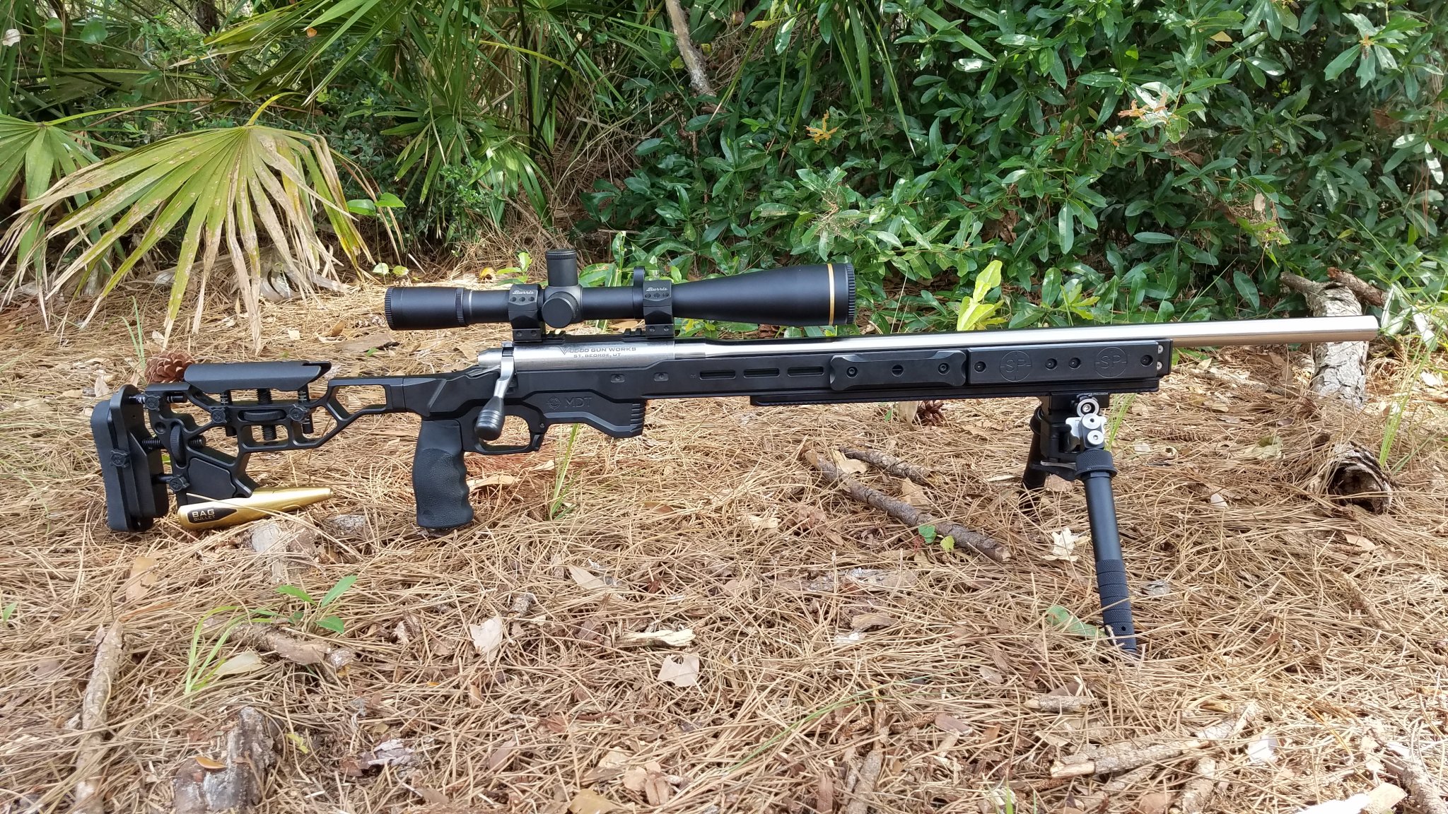

This is a 360 with 25” 1.25 straight taper and EC tuner. MDT ACC Elite balances very well as is. For a narrow barricade I need just a little weight out back. On a 2x4 it balances at magwell without bipod and about an inch in front with bipod.
Thanks, Vudoo offered a 24" with an EC Tuner on the build sheet (bartlein barrel). Waiting to hear back from them on that so I can pull the trigger. Thanks for posting the pic

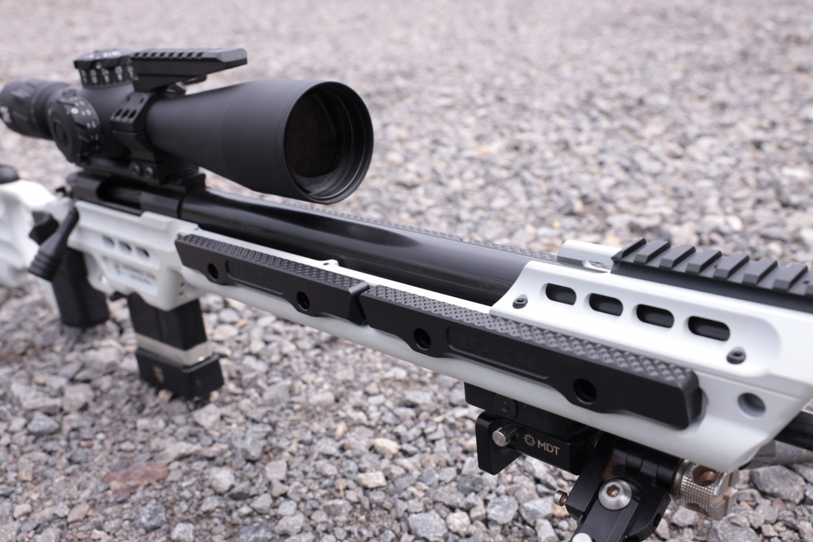

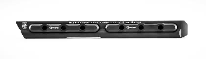

I have a 26" 1.2 straight - in the Matrix Pro, I had to run internal weights and the steel spigot.
I totally did not expect it to need that much weight to balance out. So I'd probably need a 24 inch 1.2 straight at the least to balance out the Matrix plus internal and side weights and keep the bipod on at all times, Yikes. Is the Matrix Pro that rear heavy?
Yep. My 23" MTU required both sets of grayops weights, and still kind of wanted a bipod at the end to get it to sit freely. Now if you go a lighter scope / rings that could help too.

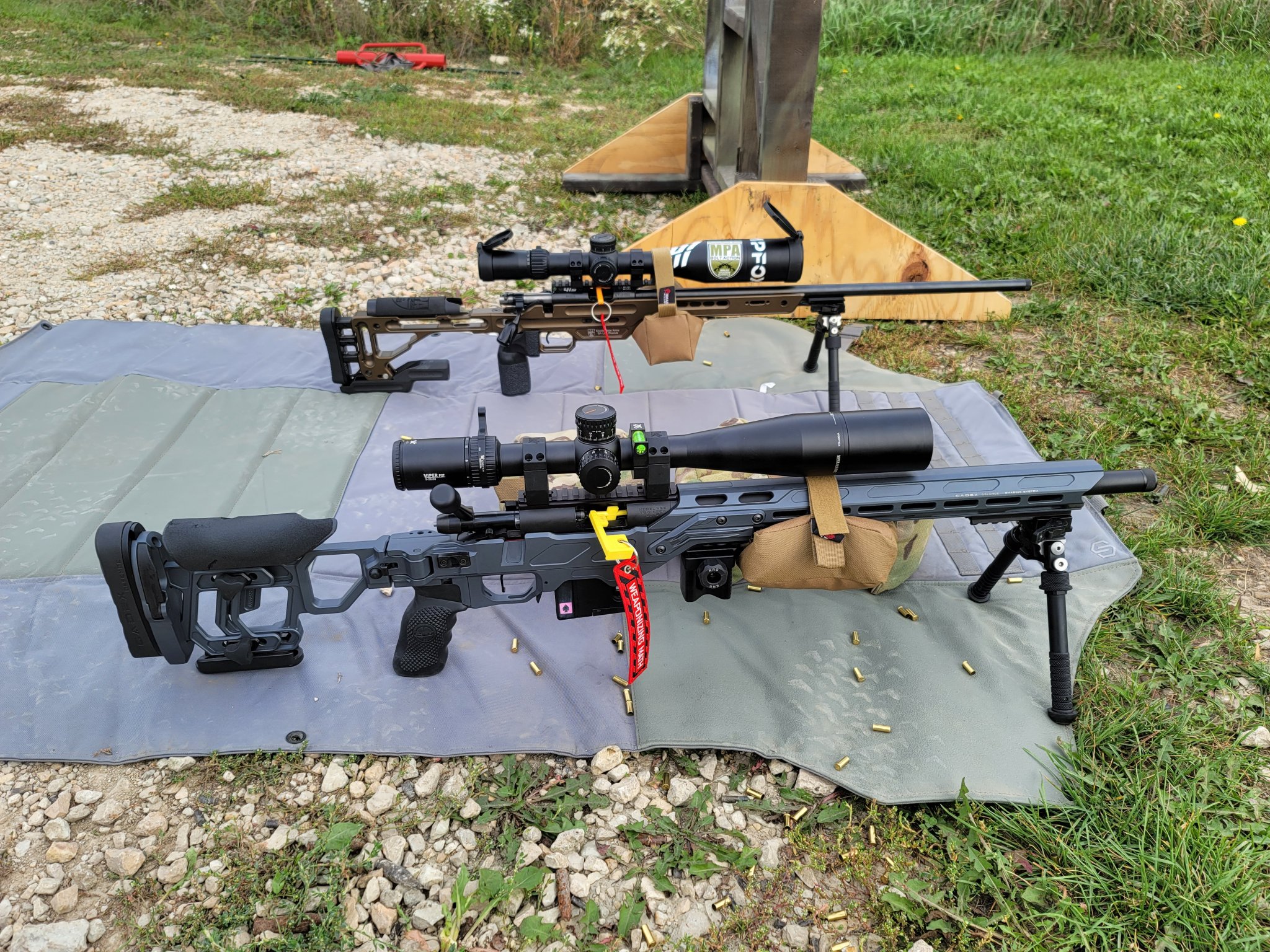

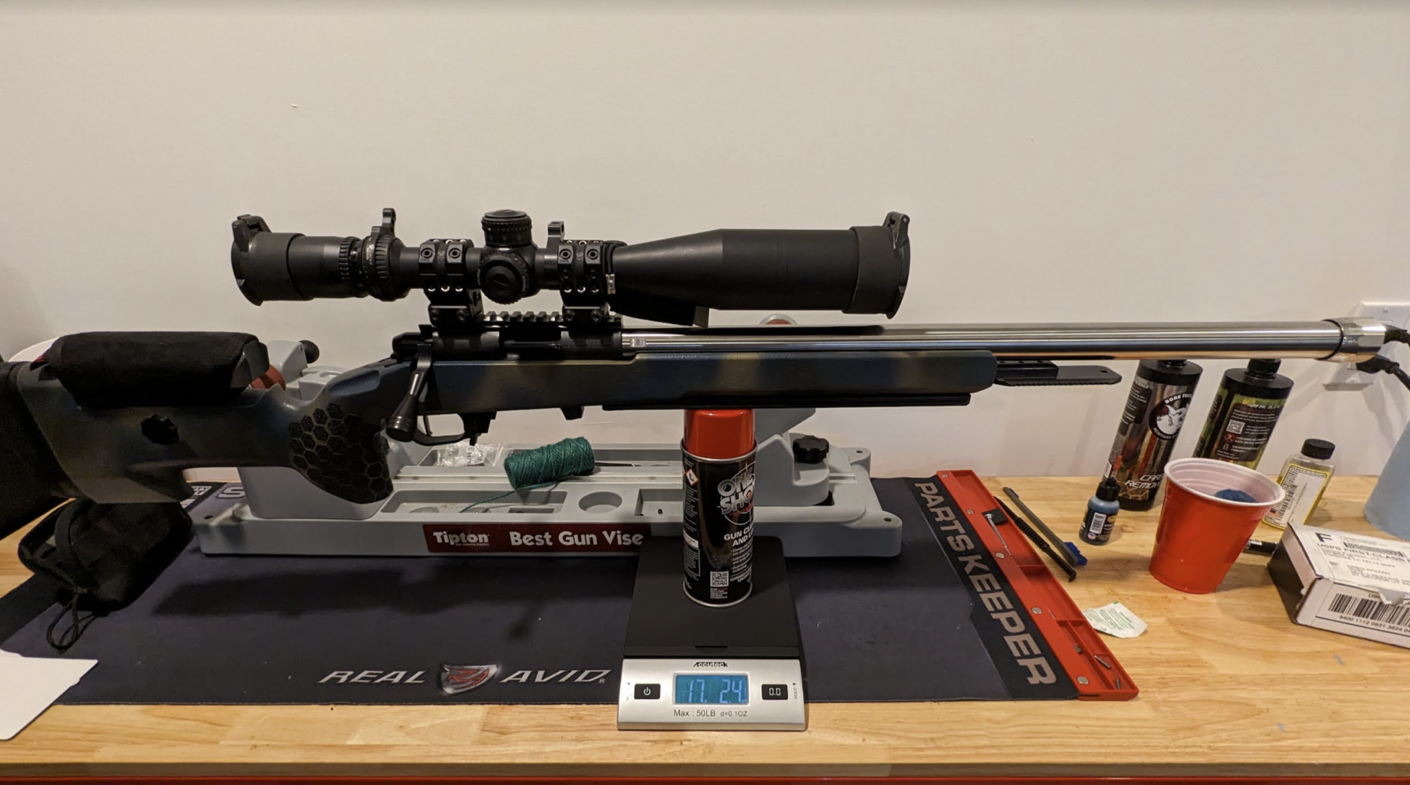

For reference, 26" straight taper in an ACC Elite. Still put all the internals in to get it to balance. The elite is pretty heavy in the rear, but the razor gen 3 isn't doing me any favors in the balance department either. 23 lbs and could still use a touch more weight out front.
Is the black gen 3 the exact same scope as the brown one or did they make other changes for euro opti?
That's the way to go. My Manners TCS with a 23" 1.2" straight and no extra weights balances nice and is sub 20 pounds also.

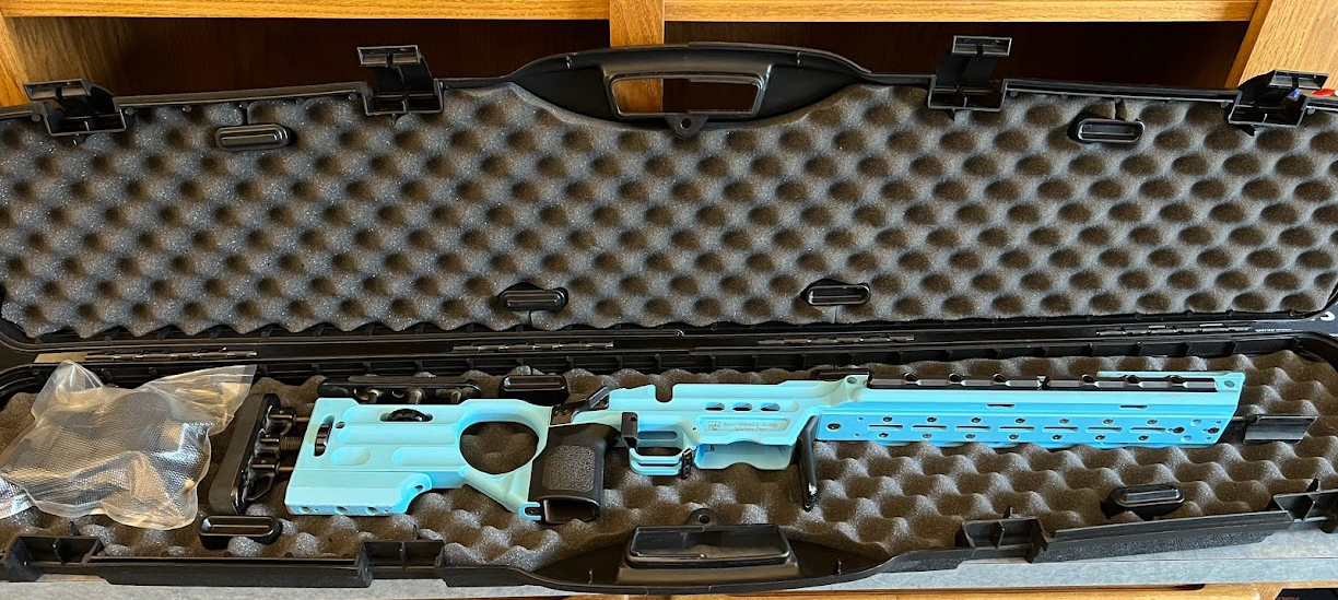

Took another step forward in my Vudoo 360 Build. Just picked up an MPA Matrix Pro second hand for a good deal. Just need to finalize the decision on the barrel. Still flip flopping between getting a 22 inch kukri (because I like the look) and dealing with the challenge of balancing it or going with a 22-24 inch straight 1.2 for balance.
I also have the MDT ACC incase I don't like it or can't balance it how I like (currently hosting my brother's .223 R700)

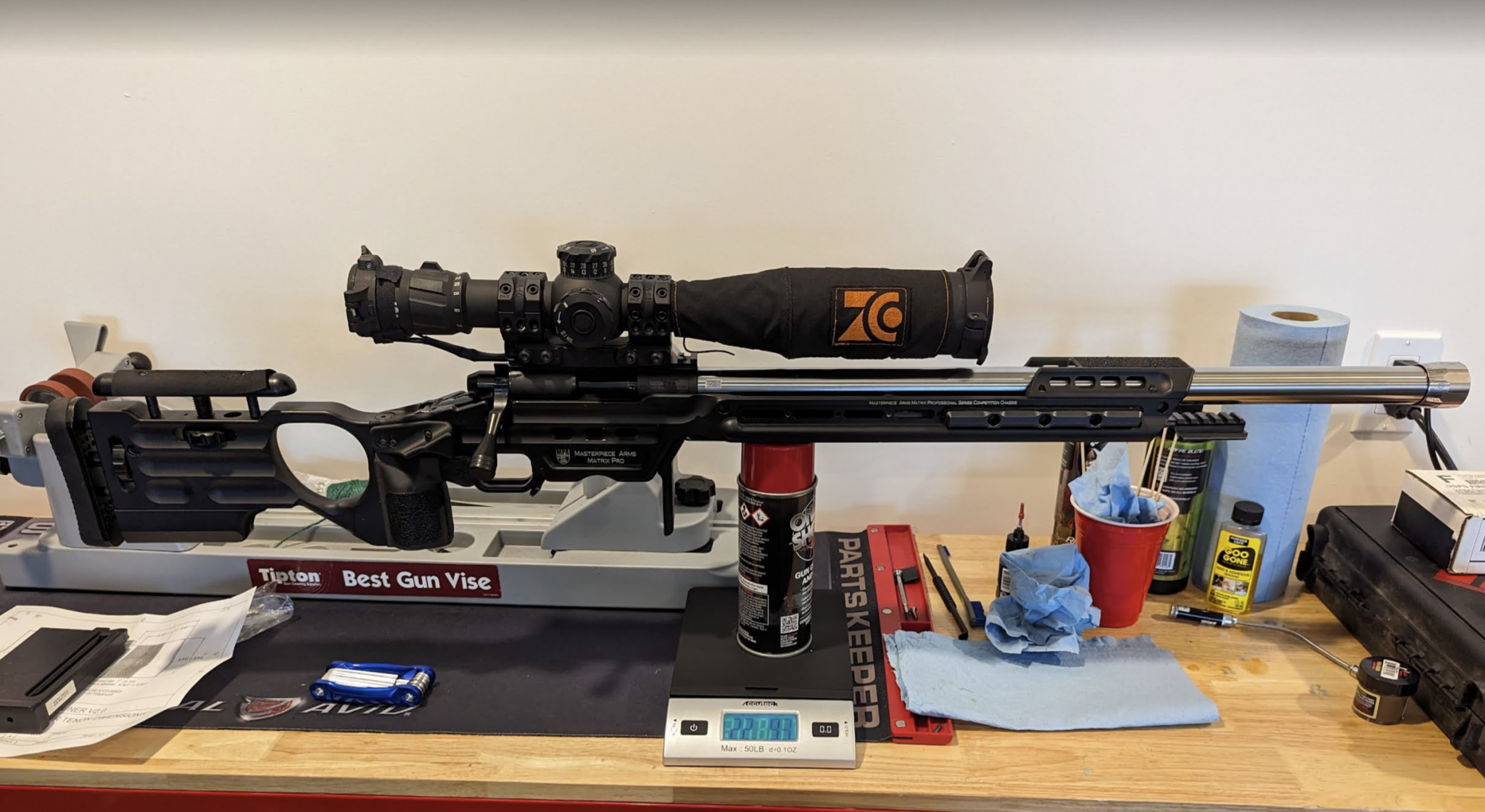

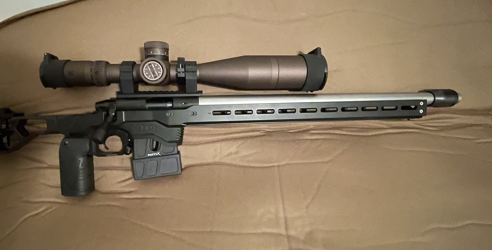

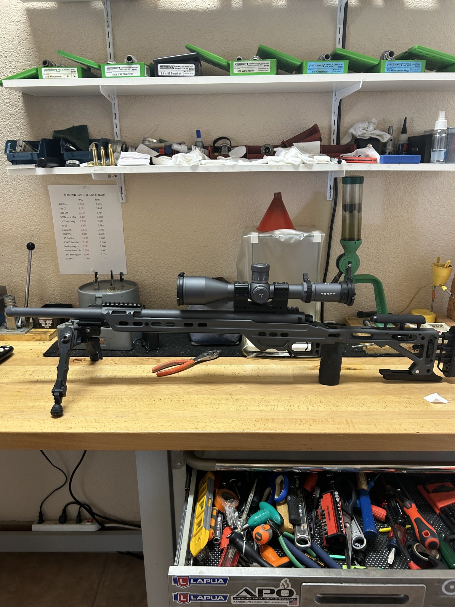

I just bought a 22" mtu and put it in a matrix pro. It shoots great but to get the balance I wanted required a lot of weight toward the front. I believe it weighs in right now at 20.6lbs with scope. I think if I had the chance to do it over I'd really consider the 1.20 barrel. I believe that would have helped the balance.
That's great feedback. I was also thinking if I got the 1.2 barrel I could always trade someone for a MTU or Kukri if I really didn't like it. They seem in demand enough. If I did go that route I'd still have to decide on 22 or 24 inches. I've seen a few photos of well balanced Vudoo Matrix Pros with 24 inch 1.2 barrels that balance really well at weight in at around 18lbs. Haven't seen anyone pick the 22 inch 1.2 barrel though.
