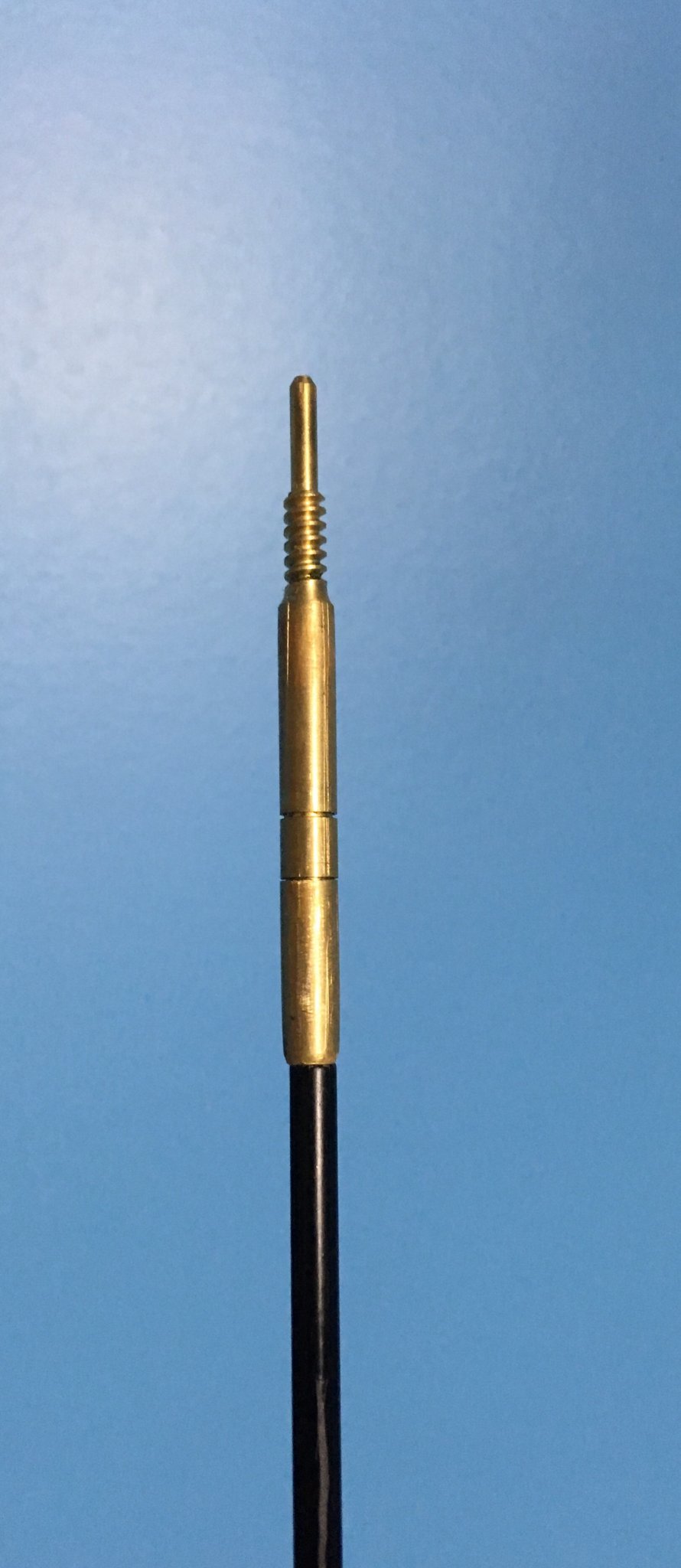

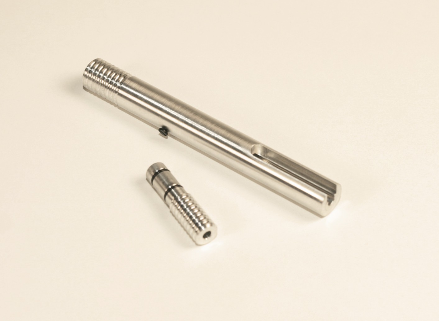

So the bore guide we buy from Vudoo is for rod diameter less than .187 or something. Since alot of .17 Cal rods have a 5/40 threads (that I have nothing for cause all of my stuff is at least 22 Cal), I was thinking about boring out the hole to accommodate a 22 cal rod. The smaller piece. Anybody seeing a problem with this?
It's made to accommodate 20 cal rods, which are about that diameter. I would not do it. I would spend $30 and get dewey coated rod instead.
I like the idea though..
Not just the rod but the brushes, jag, etc. . And do they even make a guide and jag in 22 cal with a 5/40 thread? Already have a ton of this stuff in 22 cal and a good 22 cal rod

I drilled and reamed it to .200 to clear my boretech rim fire rod (.195)
Works good
Works good
Actually just did the same with a 7/32 drill bit that miked around .210. Works great with a Tipton 22 cal. Brushes fit through adapter but small patches a bit tight. Works like a charm...
The Bore Guide itself accepts 22cal rods. The adapter that plugs into the guide is for using a smaller rod.
