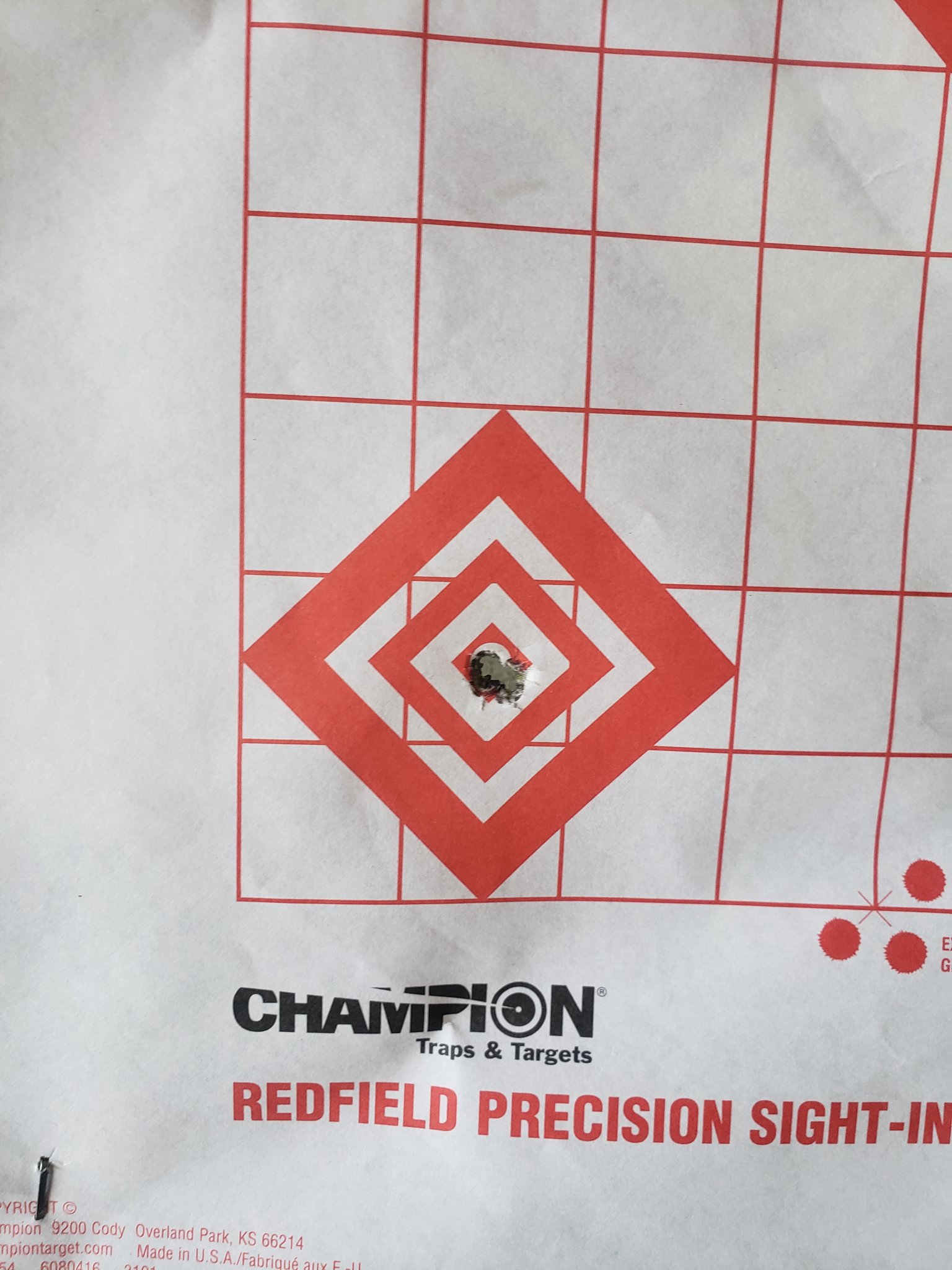

I have owned and shot a few Vudoo's. 3 of them were shipped to Eley testing. They all shot well. I like them and they have great modern features. A rimfire is still a rimfire. I now own no Vudoo's. I have a Win 52 that shoots as well and likely is a bit more accurate. It suits my current uses a bit better. Most would prefer the Vudoo. Not a thing in the world wrong them and the maker should be congratulated for bringing this much needed rifle to market. Great folks to deal with BTW.
Reactions: gpkon66 and Bradu
will shoot all days in the 0.1s at 50Y and in the .5s at 100Y
I'd like to see that. :D
Considering that the Eley and Lapua test facilities record the best results by computer.
The best 40 shot aggregate is just under 12mm outside to outside.
Just under 1/2 inch, indoors from a jig with the best ammunition available
and some of the best rifles in the world, at 50 meters.

First as a Vudoo owner, 22NRL shooter, usually placing at the top in my small pond, 22LR ammo is 22LR ammo, wind is wind. Your not going to see 1/2 minute groups at 100 all the time often over 1”. Just based on that alone.
But.... for anyone who thinks the mags are just good or = to other good mags they are completely missing the point. The mags go into our belt clips just like or centerfire Rifles, blind mag changes are fast and just like our centerfire Rifles. This is a huge deal.
Triggers, for thoughs running 2 stage triggers on their 700 foot print actions, like a Huber or Bix and Andy you can run the SAME exact trigger. He’ll you can run the same single stage trigger too. This is very helpful for practicing.
Additionally, you can use the very same stock or Chassis until you can afford another one with a relatively inexpensive barreled action.
Currently it is simply the VERY best 22 trainer hands down.

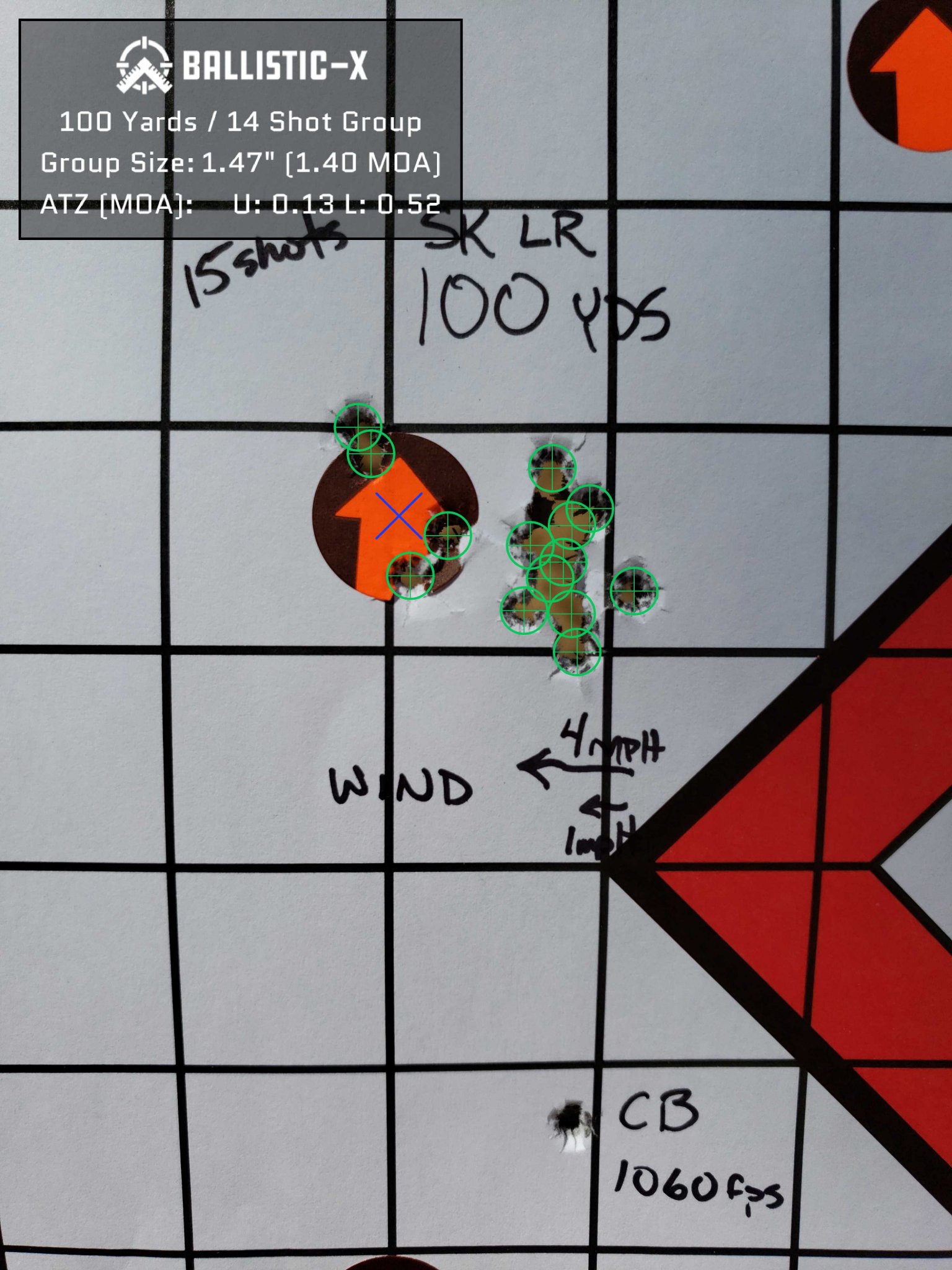

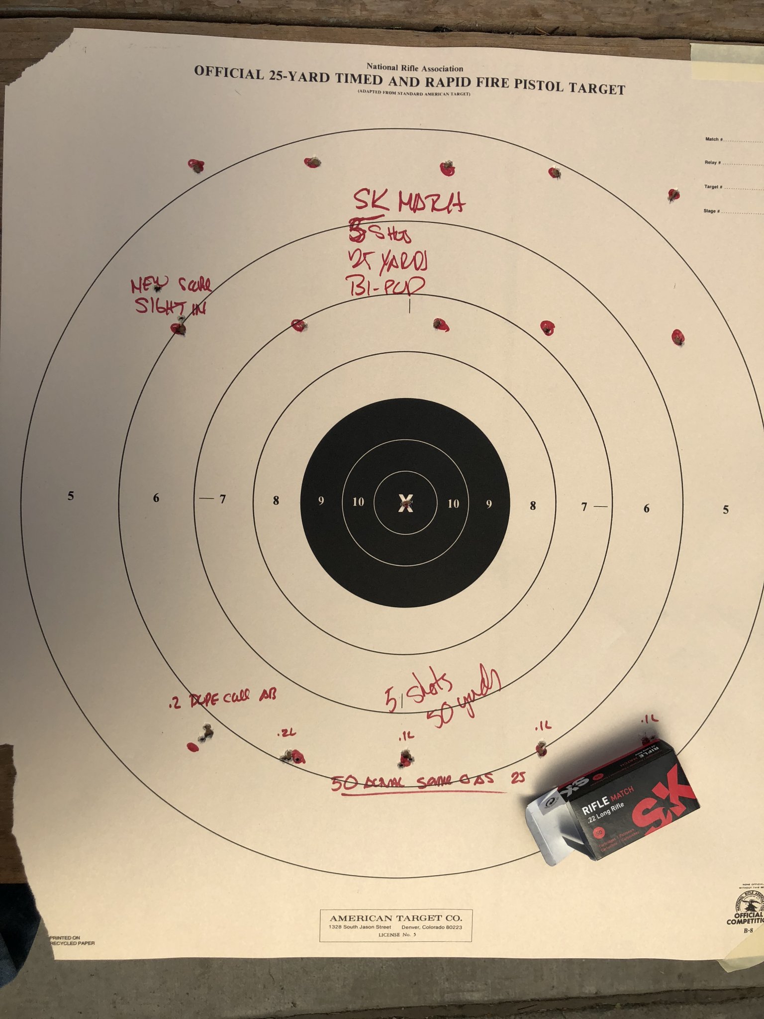

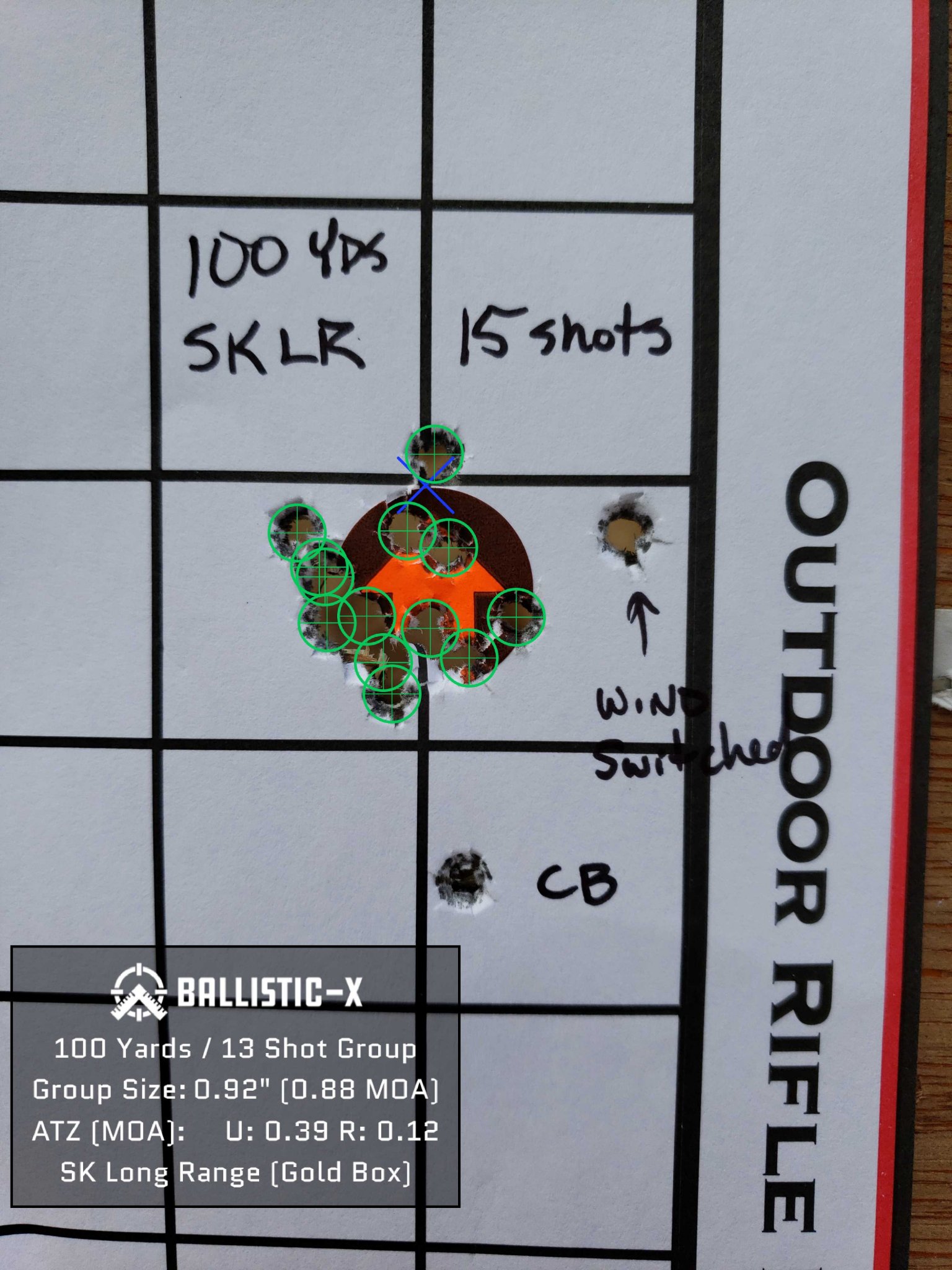

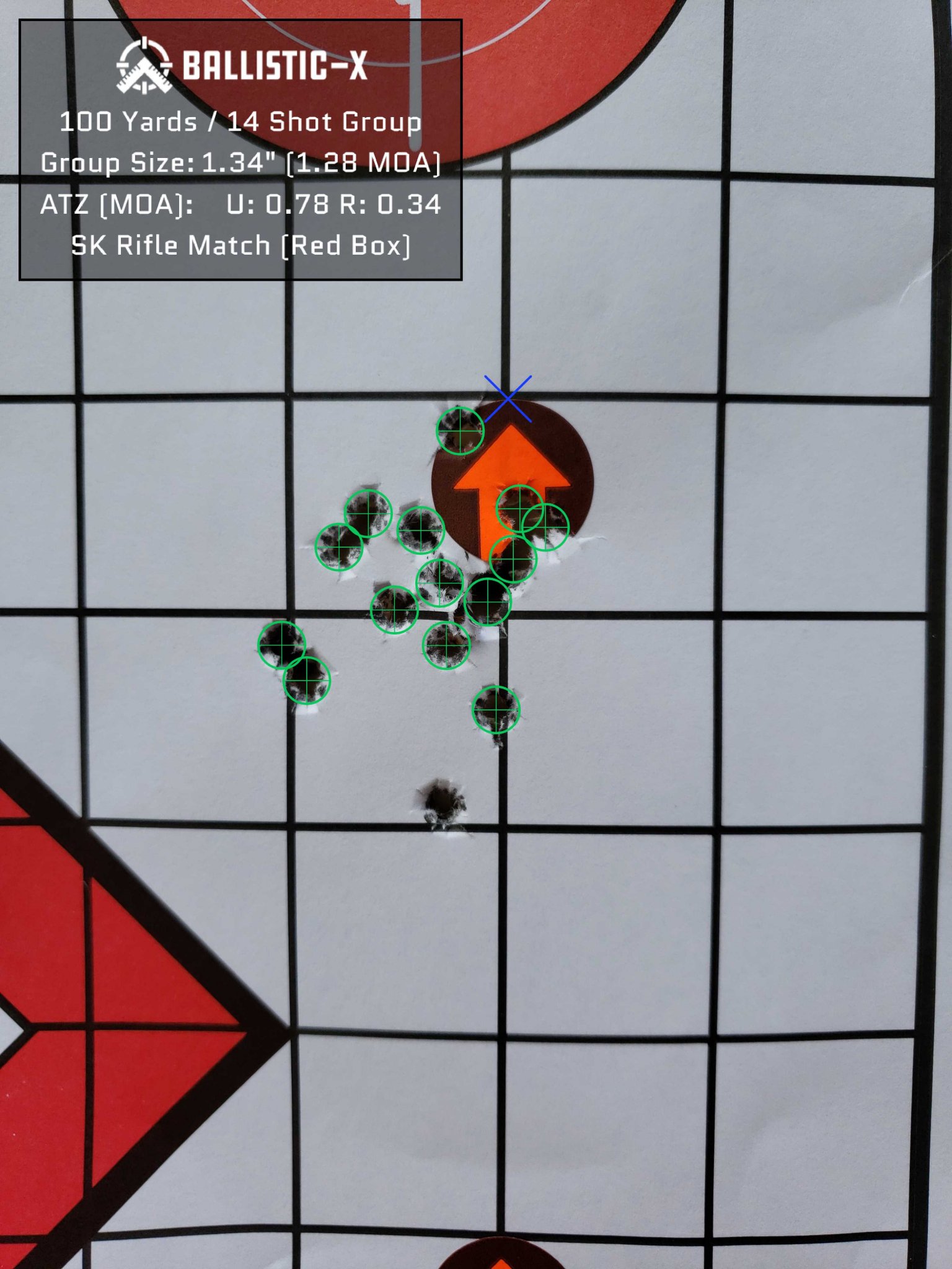

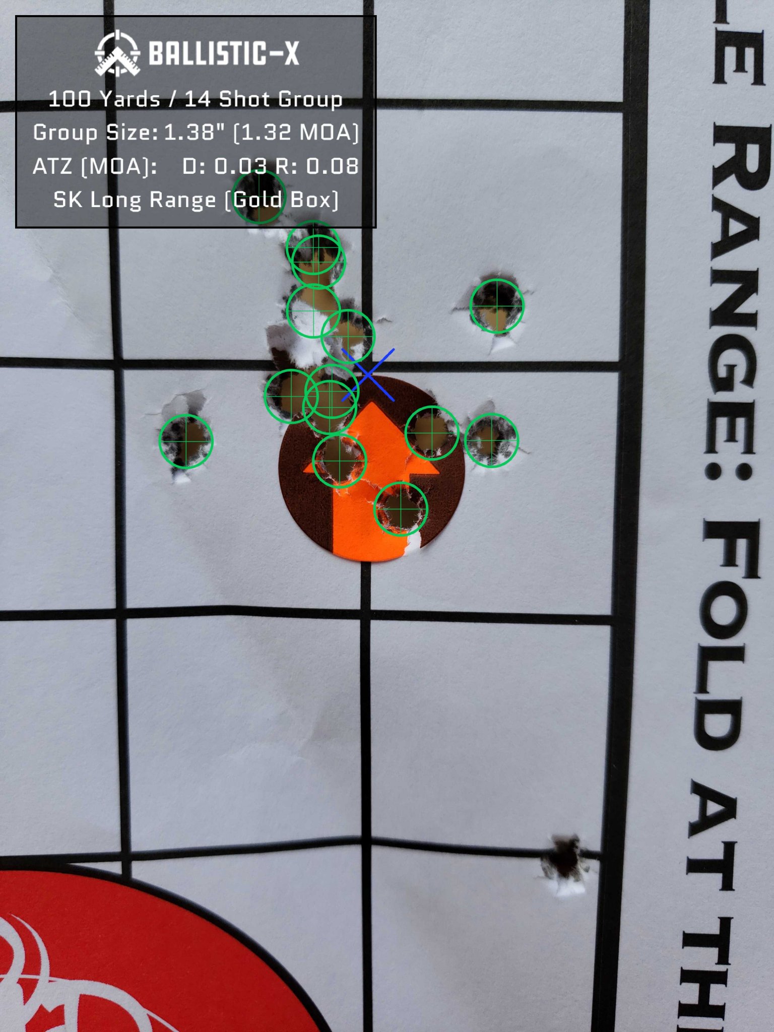

Just shot these at 100; RPRF, Shaw barrel and SK Long Range ammo. $400 gun, $200 barrel, $600 total. 15 shot groups working to read wind for each shot: (note I tossed the CB shots from each group as they are 40-50fps slower and always hit 1-2moa low in cold/cool weather)

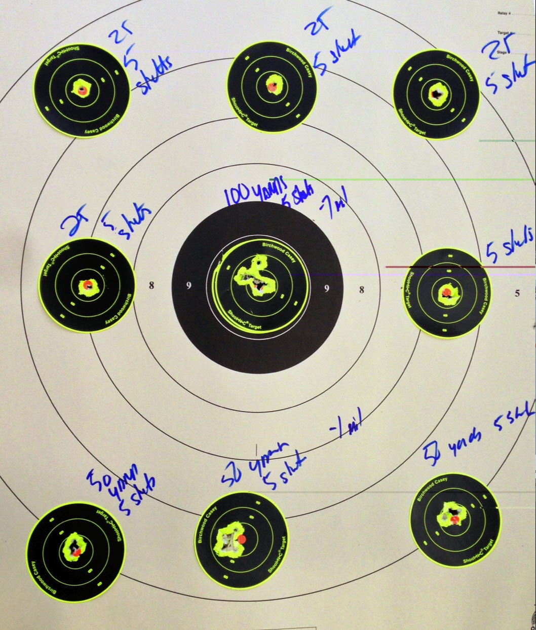

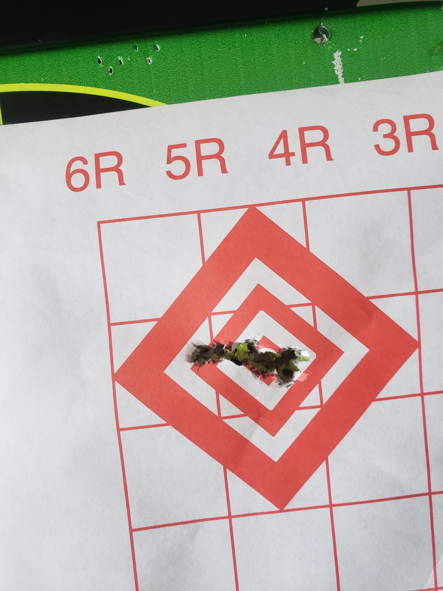

Here is a target all from the same day, outside on a bipod. At 25&50 with 100 tossed in You can really see that the ammo has got a lot of vertical and a little bit of wind in the 100.. wait for it..
FWIW - just ran it the 100y group on Ballistic, not a bad 100 yard group, even with the first shot high.
^ What? Wait, --- this is from a PCP air gun that cost as much as the Vudoo.
^ This is rimfire, sorry for being a prankster.. the target represents 110shots, 50 shots at 25y and 60 shots at 50y (one in the center at 50 yards).. BY 100 the ammo starts really showing it's ugly head and truth be told I really took my time on these shots on a windless morning.
The point I am trying to make is it doesn't really mater if you have a air rifle or benchrest gun, if the manual of arms is not the same as your centerfire or does not work for the task.. The Vudoo is all about the manual of arms..in an accurate package.
