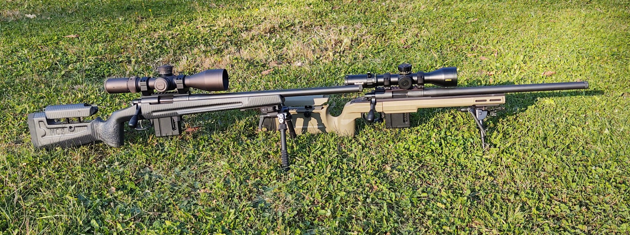

Here are the current two Vudoos (they are for my daughters):
You have some lucky kids. Nice shooting.
