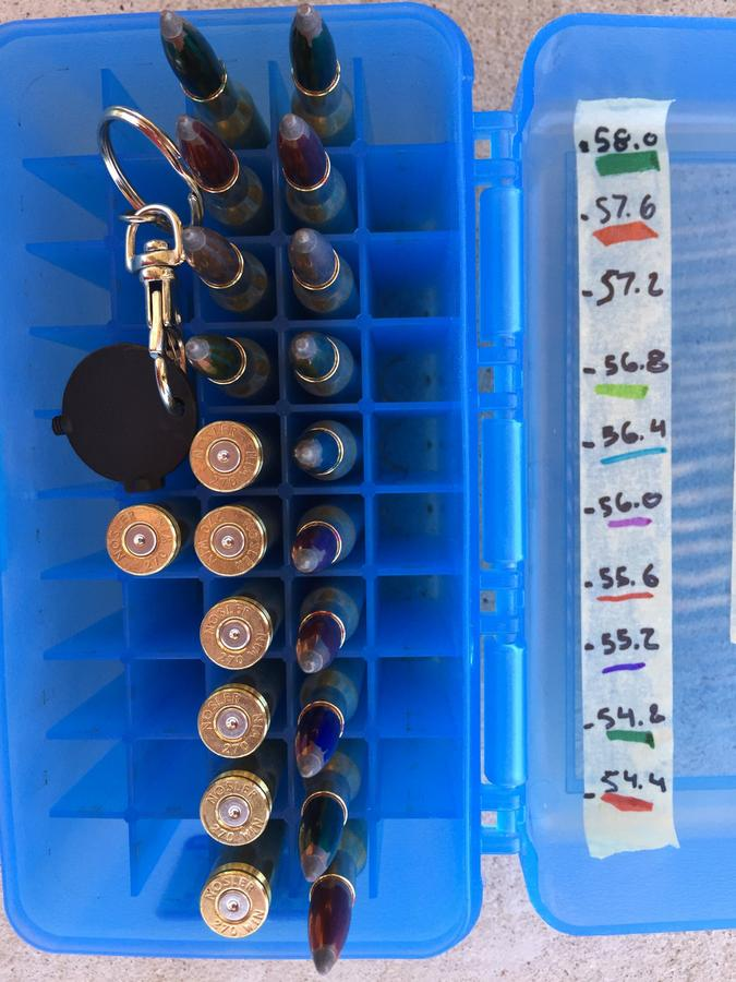

Cool. Now one to mark 'paint' bullets like Lowlight had in a post a few months ago. Would be helpful to quickly identify loads and CBTO by just looking at what color the bullet is.

I think the point of that was to see the colored impacts without needing a camera downrange. I tried that shit and it didn't work very well for me. Very faint markings on the paper
I tried it also and brought my loads to the firing line with the intent to shoot a modified ladder at 328 yards. My shooting buddy asked me if those were my "gay pride" loads. I about fell out laughing.
And it also did not seem to work that well for me either. What little color markings that were left on the paper were so faint as to make individual load determination not possible. I did want it to work and I did enjoy triggering my friend with all of the purdy colors, but it really didn't have much value. I must have done it wrong.
Ive been coloring the bullets for ladder tests to avoid having to walk and mark every single shot. I just lay its on its side and roll it while I mark back and forth on the bullet. Sure the colors are sort of feint on paper but the only time I have had an actual issue is when I was shooting on a waxy sort of plastic coated paper- they feel the type you get in the mail from advertising mailers. A normal copy paper or white cardboard transfers enough color over for me to tell when I get the target on a table in front of me. Maybe a highlighter doesnt work as well as a permanent sharpie.
I color them in an arrangement where I wont have a orange next to a red or a blue next to a purple. Having a contrast between the various loads makes it easier to decipher the results afterwards. A red next to a blue next to a green next to an orange next to a purple. The results climb up the target so even when repeating colors a red and green at the top and a red and green at the bottom wont be confused for one another.
I did it for the same reason and in a similar manner to what you are doing and even used Sharpies and a white uncoated cardboard. But, it still was a bit of a bust for me. As mentioned, I did want it to work, as it would make it a bit easier for me (actually a lot quicker). Maybe I'll try it again sometime with a different target paper.

I had great success using Sharpie on the bullets when doing ladders. Easier when you have a 600y NRA range with pits and a buddy though
