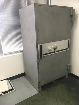

    Tl-30
    7114626
    This one is a project- no combo
    Reactions: HeavyAssault
    Condition: Pre-Owned in very good condition
    Rating: UL TL-30
    Price: $2000 Firm 61 x 27 x27 - 2400 pounds

    a quick search- do your own and be patient
    Tl-30
