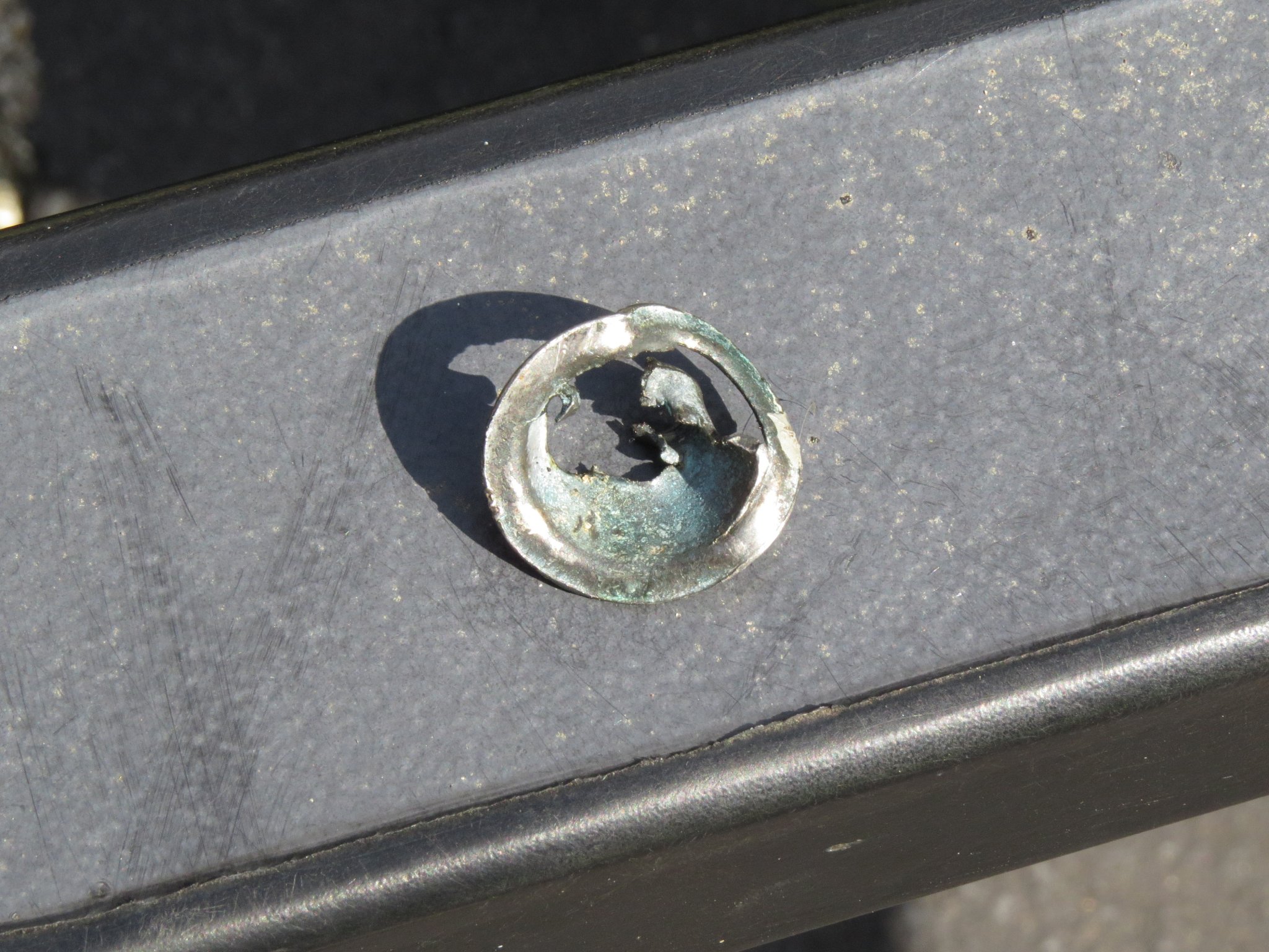

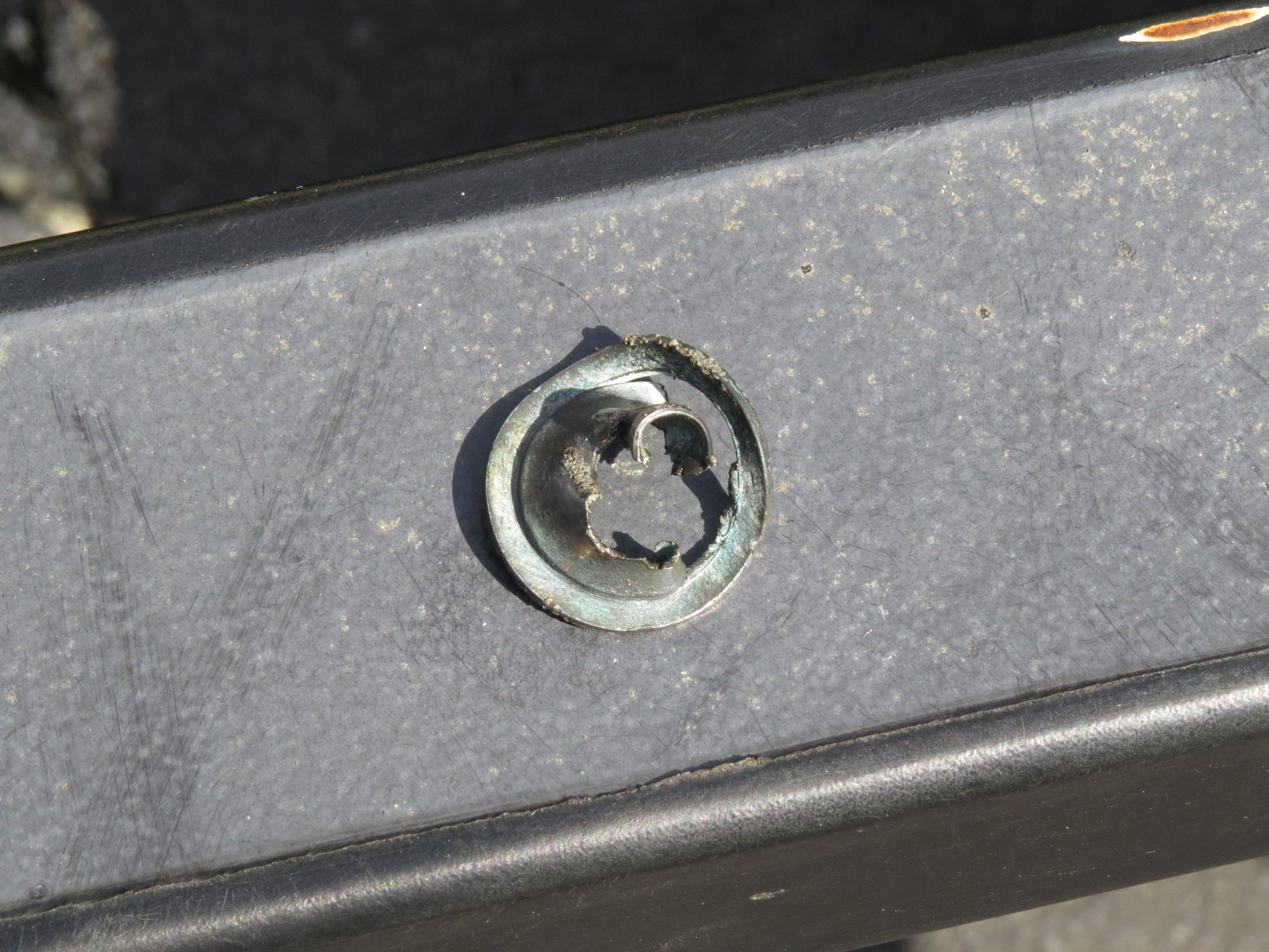

I'm not sure but I believe my damage was a dumb self inflicted injury by not following the minimum barrel length rules.
Using an 18" instead of 20" minimum recommended for my 6.5 PRC.
I didn't hear or feel anything different when the blast baffle came loose I just noticed on my 3rd,4th and 5th shot of the day my impacts were hitting all over the backboard.
I thought my scope was crapping out on me so picked my rifle up off the bench to go to my truck to check my scope mounts and the second I tilted it down it sounded like rocks in a tin can. (It was one of those "Oh Shit Sick Moments".....
I unscrewed the thread adapter and this was the first thing that fell out along with about 5 or 6 other pieces of "Oh Shit !" LOL!
