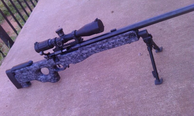

My 40X
[IMG2=JSON]{"data-align":"none","data-size":"full","src":"http:\/\/i663.photobucket.com\/albums\/uu356\/b529\/photo45_zpsfubvlt4f.jpg"}[/IMG2]

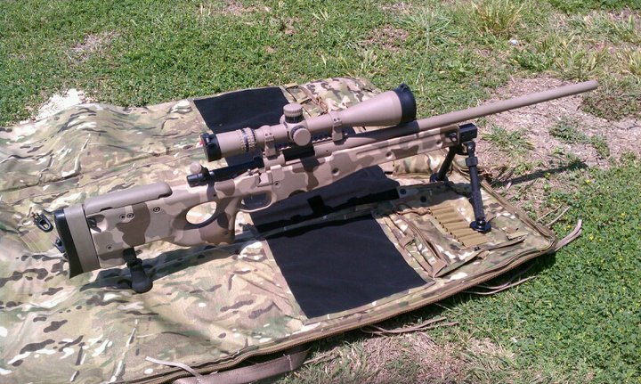

I've been enjoying my older 722-style 40X repeater conversion from Jelrod so much that I've been thinking about sending him my sole remaining 40XB for the conversion. But to do another 40X repeater, I'd need to sell the Stiller 2500XR/Krieger/Manners rifle I built. $$$ doesn't grow on trees, and sometimes you wind up making tough choices, but I've also enjoyed shooting that Stiller, and the Manners Elite T4A with its molded-in GAP camo finish is a sweet build...

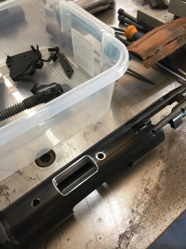

Just came in from the shop for a break - have been working at getting a Lilja tite bore blank ready to fit & chamber in my 40XB. Set the action up in a TruBore alignment system 6-jaw and trued the receiver face yesterday, then decided to pick-up & chase the receiver threads just because I could. The threading insert didn't cut a single chip until the last pass, and then it took a very even cut all the way in. Those are by far the truest receiver threads I've ever chased on a Rem 700/40X action - would not have needed done at all, but you don't really know until you get the action dialed-in & start single-pointing them.
So since I've done all I can to the action to get it ready for Jelrod's CNC machine, I'll go ahead with barreling it. That way Jelrod can tune the extractors with the bbl that's going to be on the finished rifle, and there'll be that much less work to do to complete the rifle when I get the converted action back from him. Not in any hurry, as I think he's just now getting on the actions that required new barrels, so it'll be another 3 weeks or so before he's ready to do another run. Really looking forward to working with this Lilja bbl & comparing the accuracy to that of the Krieger on my Stiller, and Benchmark on the 1st 40X.
