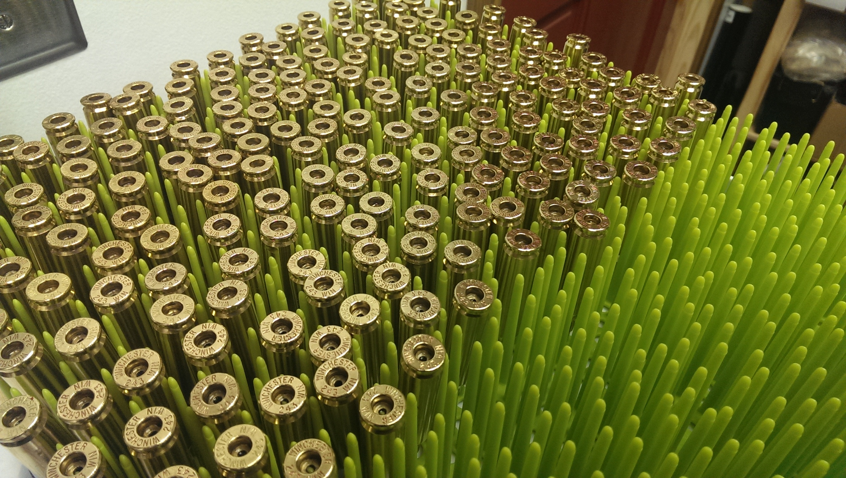

Who knew they sold reloading accessories in the baby department of Target?
It's called "Boon Lawn" and they also make a smaller one called "Boon Grass." Amazon lists them, as does Bed Bath and Beyond, but I wanted one immediately, so I tracked it down at a local Target. Works great! 25 bucks.

Luckily, I don't have any kids (that I'm aware of), but I did first see this at a buddy's house who has a newborn and immediately began thinking of how to apply it to shooting. He had all the latest stuff, including an IR camera baby monitor that alarms if the kid quits breathing!
that's a pretty neat idea...ive just been laying them primer hole facing up on a piece of cardboard tell dry.
I've done the oven thing and without distilled water my brass comes out looking like shit.

Whoa! That's a lot of brass! I was standing them up on a paper towel, but it was taking too long to dry. My reloading room is in the basement and even with a space heater, it stays about 62º, which is why I suspect it takes awhile. I thought running them through the annealer would let me cheat, but the energy needed to evaporate the water messed up the annealing process. With this thing, they were dry 12 hours later. And it prob didn't take that long, I just didn't check any sooner.
Best dryer I have seen is a simple 2x4 square frame with 1/4" wire hardware cloth screen stapled to the bottom about 2' square with a couple scraps on the sides to keep it from sliding off the AC condenser outside. Load up and place over the fan blowing hot air when the AC is running and leave it there for 15 or 30 minutes. Don't have to run anything extra on the light bill to dry, just use the hot air you generate normally.

the thing i like about cp's grass mat is the fact that you can inspect all the flash holes easily. im super paranoid about sending one of those pins down the barrel.
i do mine in the kitchen sink. i line em up on the edge of the counter ontop of a large towel so i can shine flashlight in the case mouth and behind to be sure flash holes are clear. then , slide the towel back and do another row. then i shingle them as shown and put a high speed fan on them over night. next they go into an open top box till im ready to load.

i will be making the screen rack for the hvac unit outside for this summer definitely though.
looks good cp! always thinkin how somthing could apply to the game.i can totally relate.
