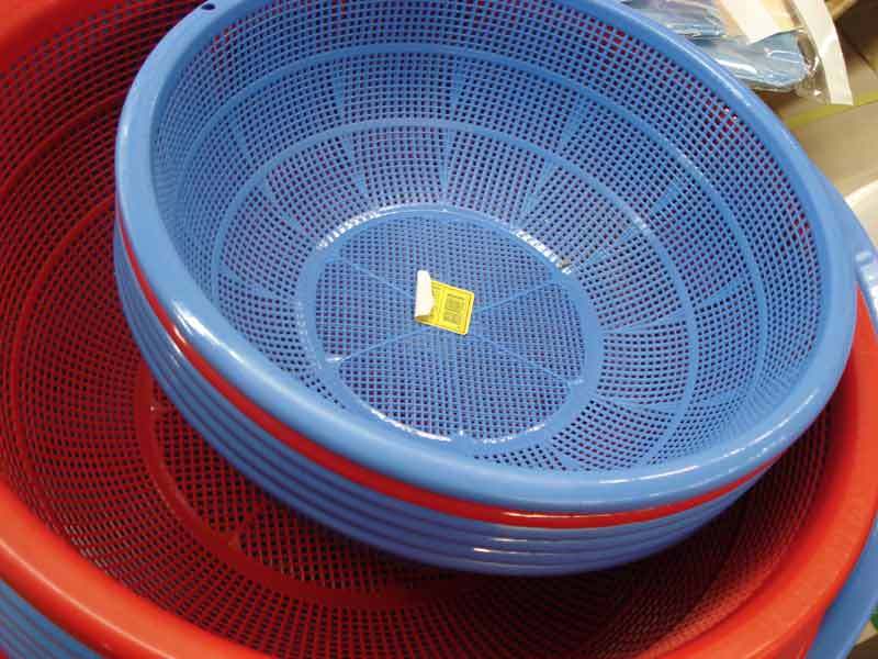

    Go to your local Korean or Asian market and go to the accessories aisle.
    pick up one of the plastic basket sieves like the photo attached.
    Go go to Walmart and get a plastic tub that's slightly bigger.
    Use sieve to get gross media out and hand dump the ones in the case

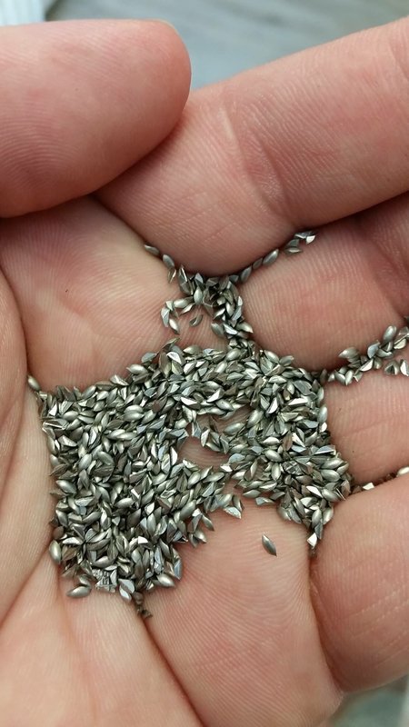

    I''m still looking for the perfect sieve. I don't have "standard" (if there is such a thing) sized or shaped media. The pins I have are smaller than the ones offered by companies like STM, so even in a fine wire mesh strainer, a few will still pass through the mesh, but they do a phenomenal job on primer pockets!

    do what I posted then. The Asian plastic sieves are made of all different shapes and sizes. I get ones that have holes the size of 9MM cases and it holds all my rifle cases while having no issues dropping media though.

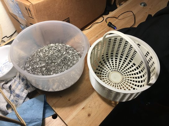

    One day my wife was throwing away an old lettuce container with a basket in it, the kind you keep lettuce in the refrigerator. I had an idea. I got it out of the trash, and I now use it to seperate my brass and SS. Pour my brass/SS into the basket, fill the bowl up with water, spin it back and forth and all the SS pins fall through. I have an STM separator, and a I've seperate them by hand, but so far, this is the quickest and easiest.
    Inalso put strong rare earth magnets in the sink strainer to catch any SS pins that try to escape.
