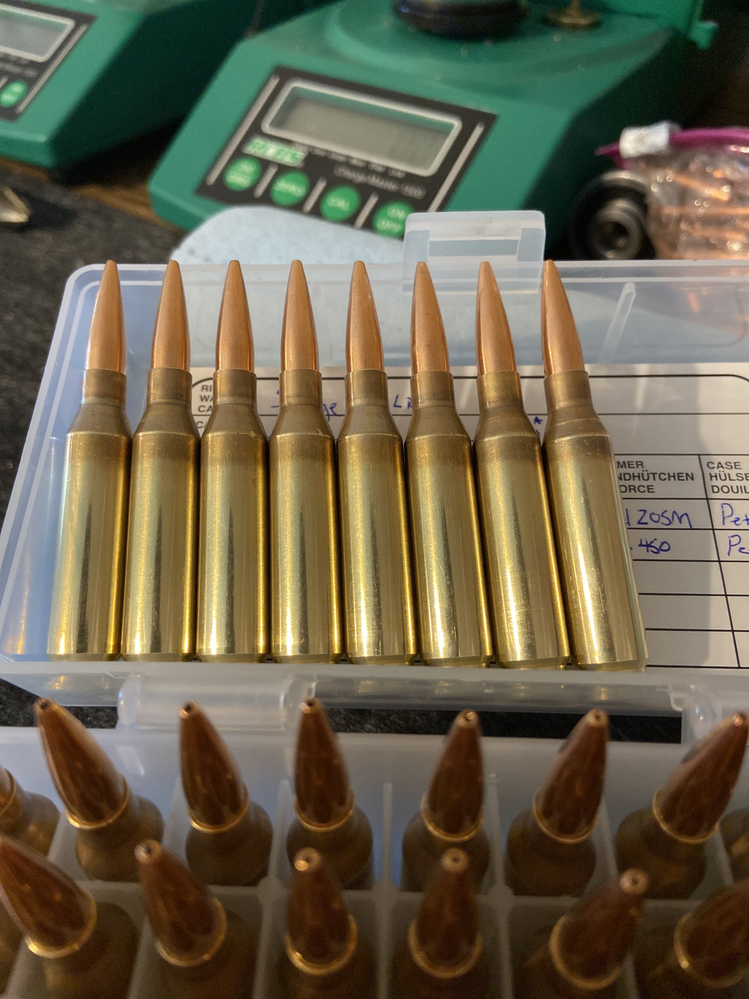

I like my brass looking better than brand new. I de-cap. Wet tumble with stainless pins for 2.5 hours with 1 squirt of Dawn....if it will clean a duck...it will clean carbon muck....then a tiny scoop of LemiShine equivalent. I use the Hornday wet tumble media separator and really give it a whirl and all pins come out and don't go flying everywhere.
