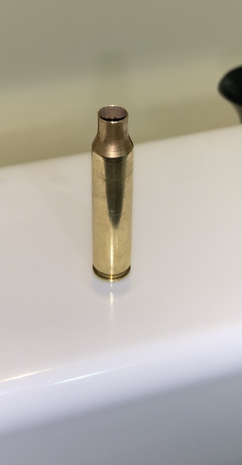

I love shinny brass, so I've switch to wet after decades of dry.
Most complain that it takes too long due and too much work having to dry out the brass. In my experience and the method I use it seems to be quicker for me.
I only run the tumbler about 30 mins if that long. After it's been running for 15 min, I turn on my electric food dehydrator and set it at high (158 degrees).
I spend most of my time in emptying out the stainless media from each case before dropping them into some clean cold water to rinse them out. Then drain them out before dumping them onto a dry cotton bath towel to get most of the water off them, before placing them in dehydrator for 15 to 20 min.
When they come out they go straight into the anealer. After that I'm ready to load them up.

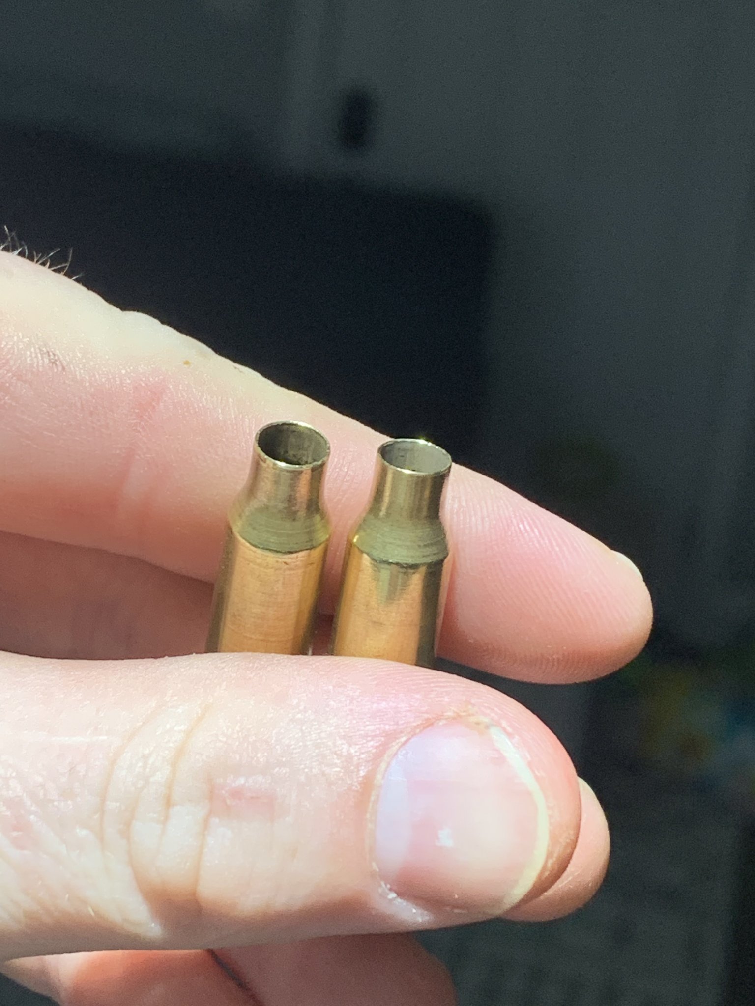

Nothing dirty with the necks. I dry tumbled for years and never found the inside of the cases to be super clean. Dropping the ss pins the cases come out really clean, and the insides are clean enough but not shiny. Just looks tarnished is the best way to put it.
I run expanders through them with 0 issues
I run expanders through them with 0 issuesView attachment 7832039View attachment 7832040
That’s exactly what mine look like or cleaner maybe
Side note I do not dry tumble, I meant the difference with or without pins.

I’m not getting all the carbon out of my necks either I don’t think they’re not sparkly clean and they shoot good and it’s fast so I’ll probably stick to it and let primal rights dude have rice cough and an angry expression about it all on his own.
I don’t get all the carbon out of necks from dry tumbling to the point of seeing nothing but brass, but they are absolutely clean enough to load.
