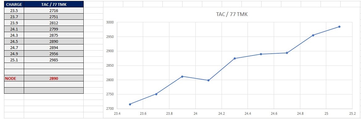

Working up a load for my 223 bolt gun. Using 77gr smk bullets, RP brass, CCI 400 primers, and TAC powder. I’m using the 10rd ladder test (shot 9). Went and shot today and am looking to see what my node is and where I should narrow down loading 5rds for group testing
23.5gr-2716
23.7-2751
23.9-2812
24.1-2799
24.3-2875
24.5-2890
24.7-2894
24.9-2956
25.1-2985
Me looking at it it looks like between 24.3-24.7gr is the sweet spot?
Put it in a graph, for me, seeing the results helps.
Looks like 24.5 could be a node.
