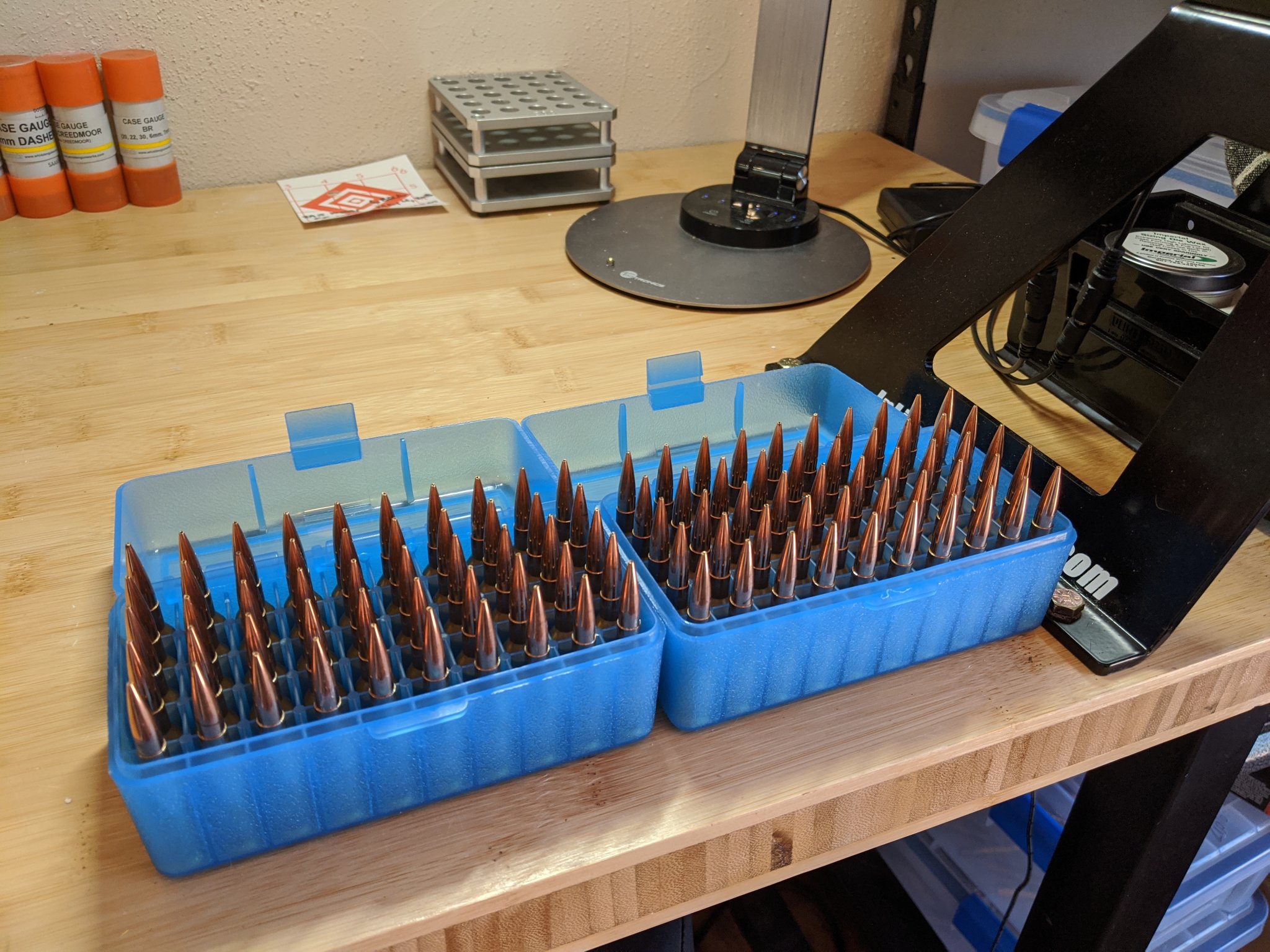

Hand primed x105 virgin Lapua .308 cases with BR2s during naptime.
Prepped them during yesterday's naptime, lol.

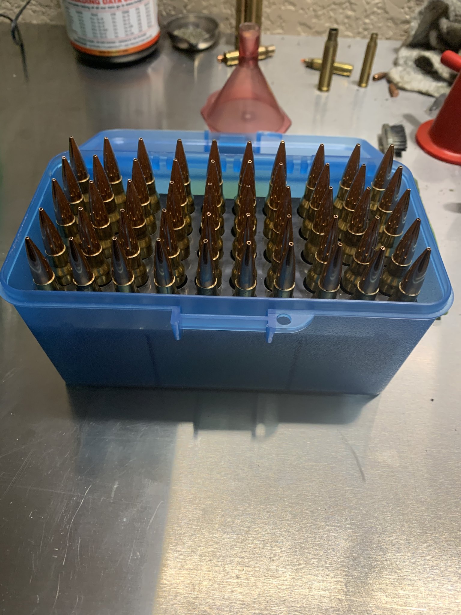

Gonna throw 47.1 grains of 2000MR and seat 175 smks at 2.82" tonight after the tots go BACK to sleep...

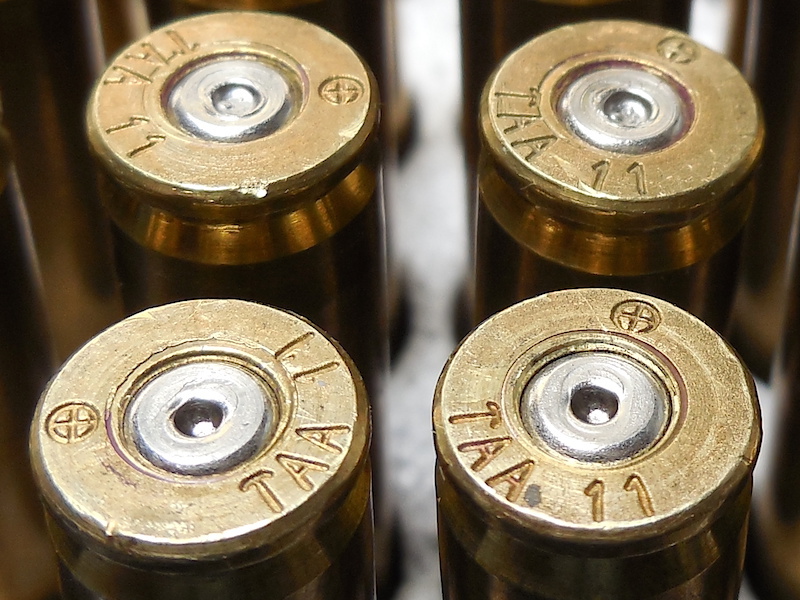

Had about 400 once fired 5.56/223 cases given to me by a friend that had acquired them with a used tumbler. Most are Lake City of mixed years and of those, 110 need primer crimp removed. Otherwise they were all decapped cleaned and re-sized. I'll be annealing all of then after I get the primer pockets uniformed.

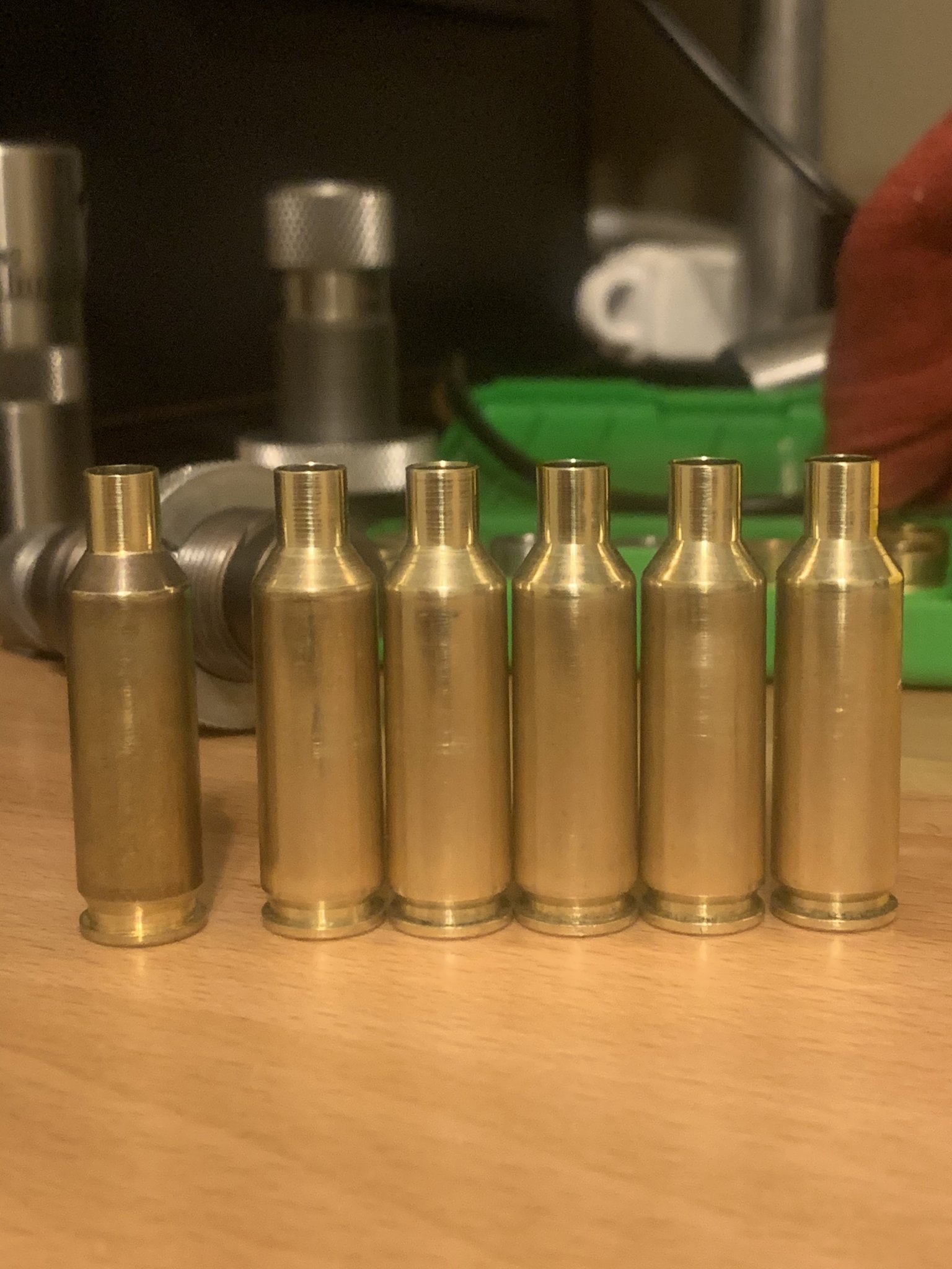

Made 5 test pieces of lapua 6gt

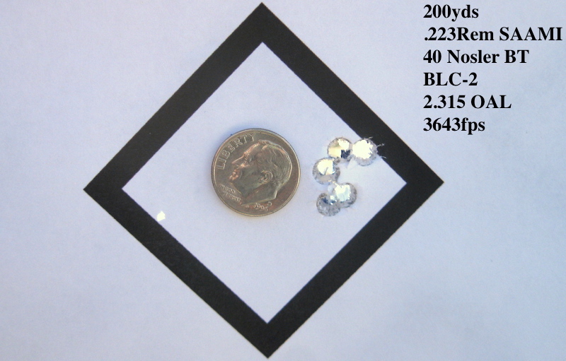

I loaded up some things for testing a freshly bushed bolt. Then ran the pressure up with some 40 Nosler BTs in .223 Rem.
Bolt:
Group:
I hope I can do that more than once. ;D
Old "Max book" load in the background, and new "+P" load in the foreground.

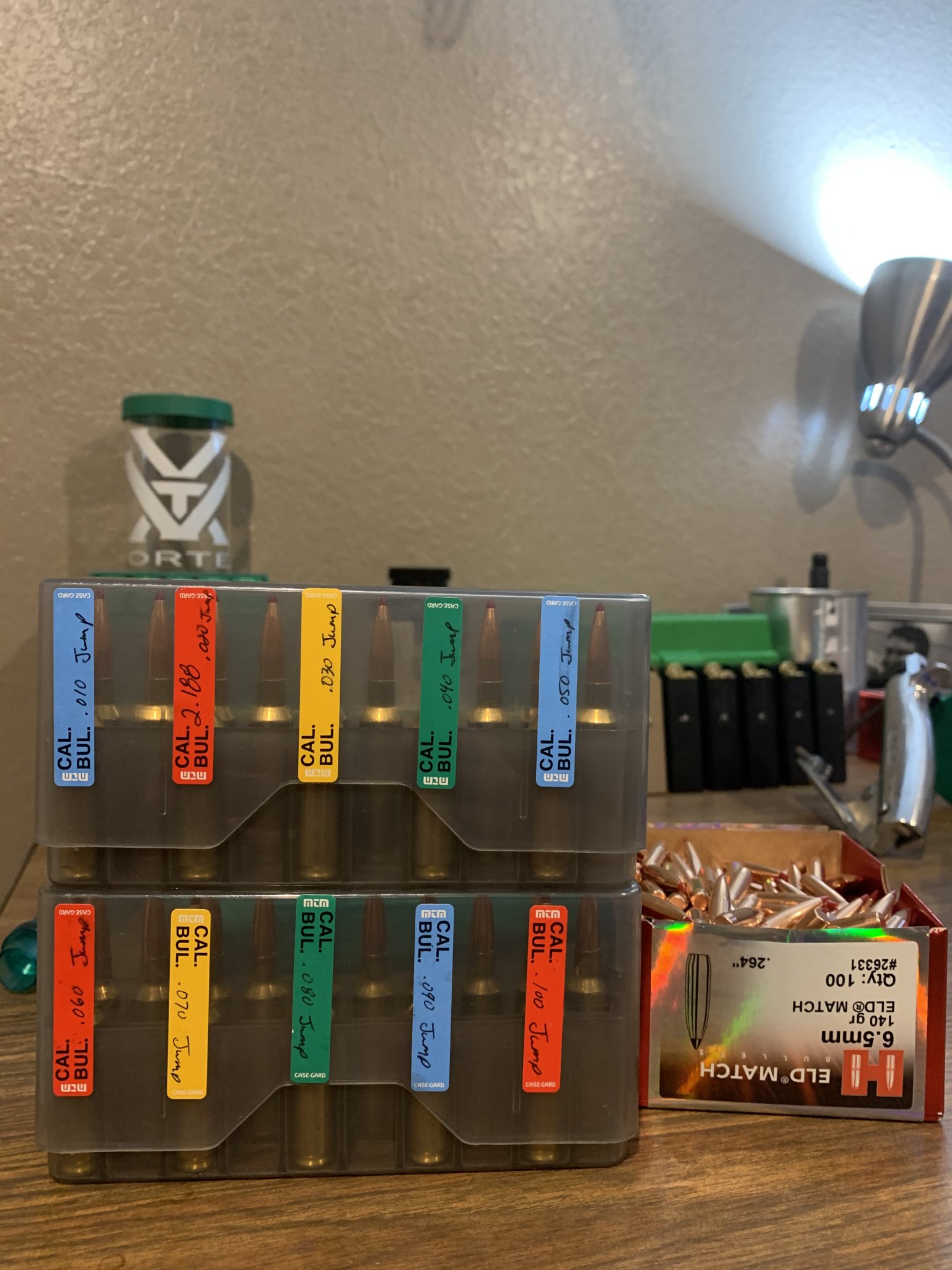

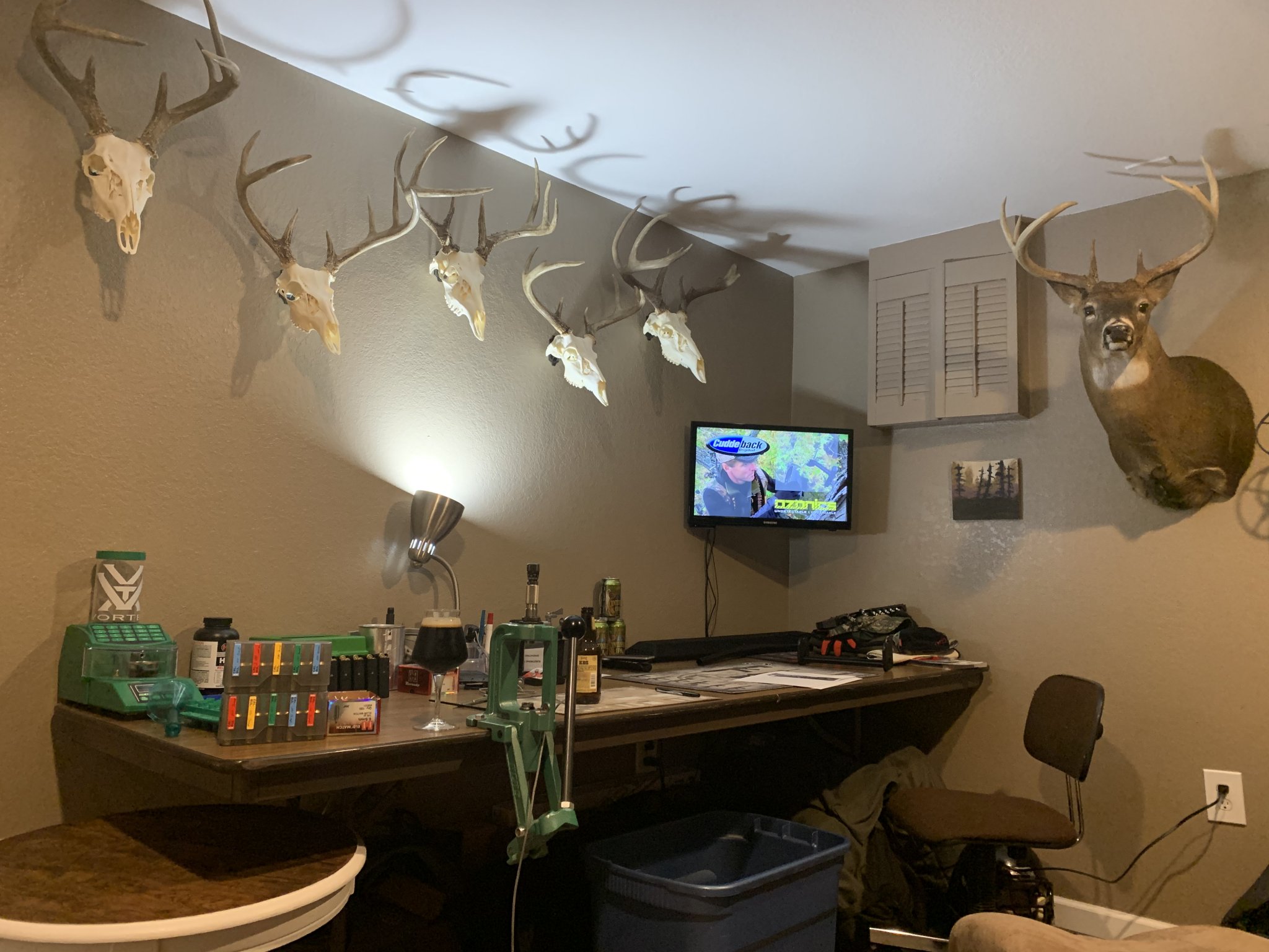

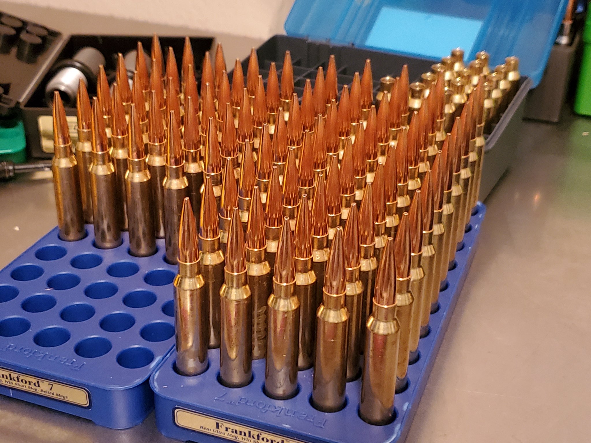

I’ve never shared my room in here. Nothing special, but it’s a decent little escape. I just finished up loading up my standard 6.5cm load and I saved back 30 cases to play with inspiration of Scott Satterlee’s newest PRB articles and Modern Day Sniper Podcast on bullet jump. Basically just .010-.100 jump In .010 increments with a .264 140 ELD-M in a 6.5cm.

Did you see a lot of difference in numbers with the more consistent seating?
If you enjoy getting into the weeds, you can mess with the amount of primer anvil compression. .005 vs .000 etc. It can have a noticeable effect. But only if you’re getting/need everything you can out of your ammo.
