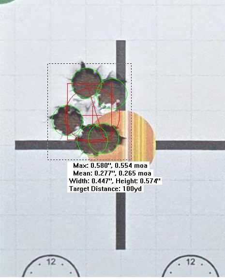

Loaded 50 rounds of 300 PRC ammo for a semi long range competition as perfect as I can make it. Weight sorted everything and then weight sorted the loaded rounds.

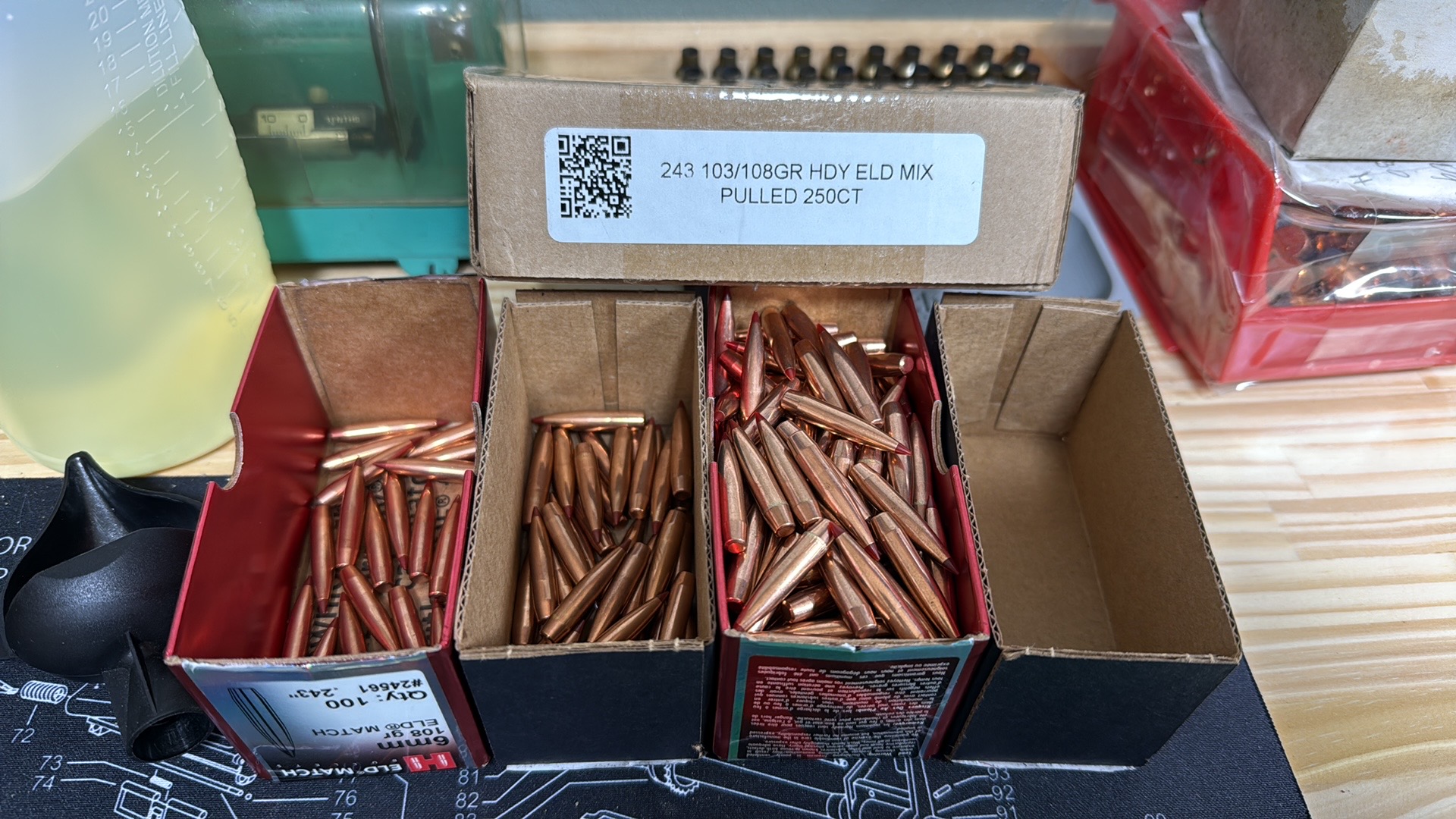

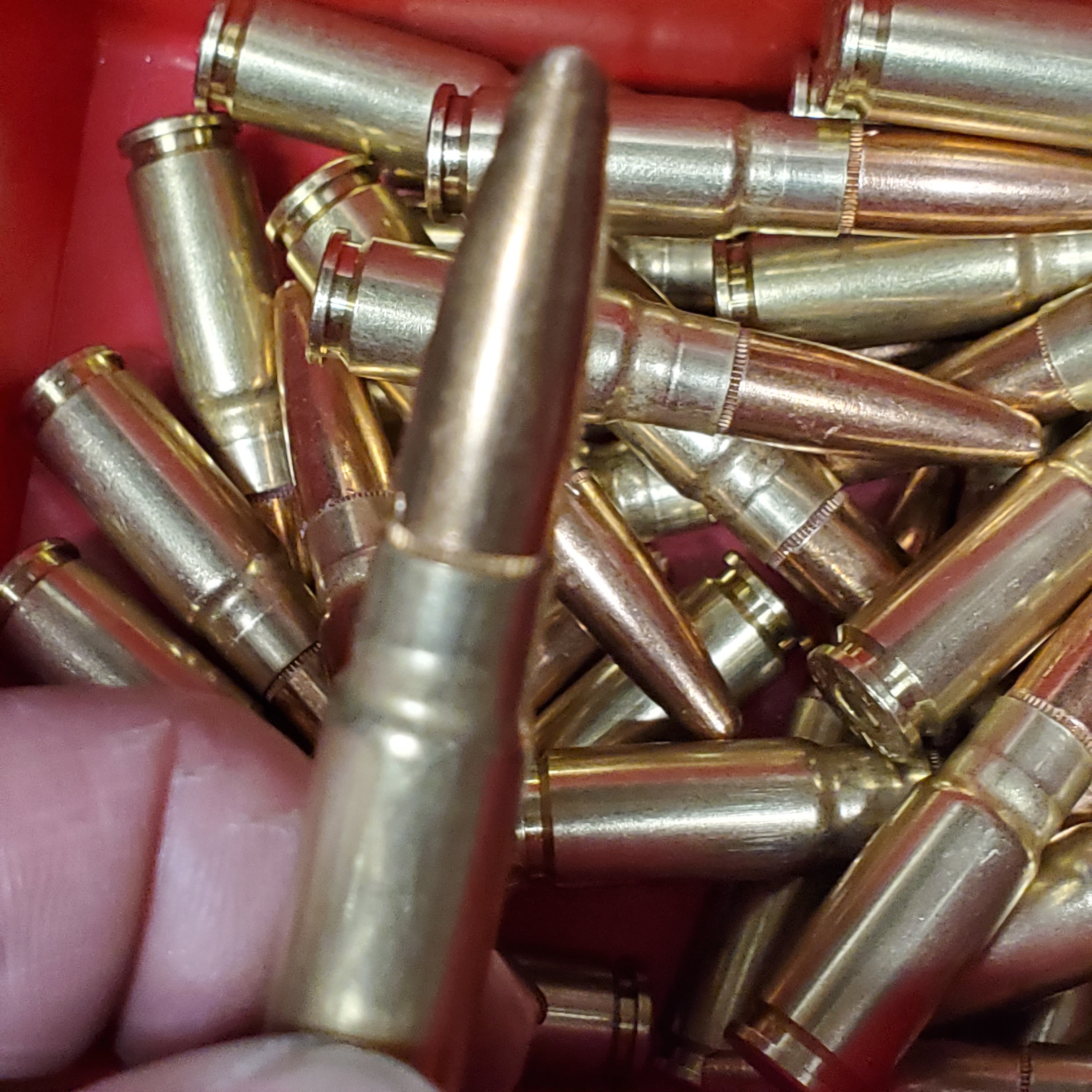

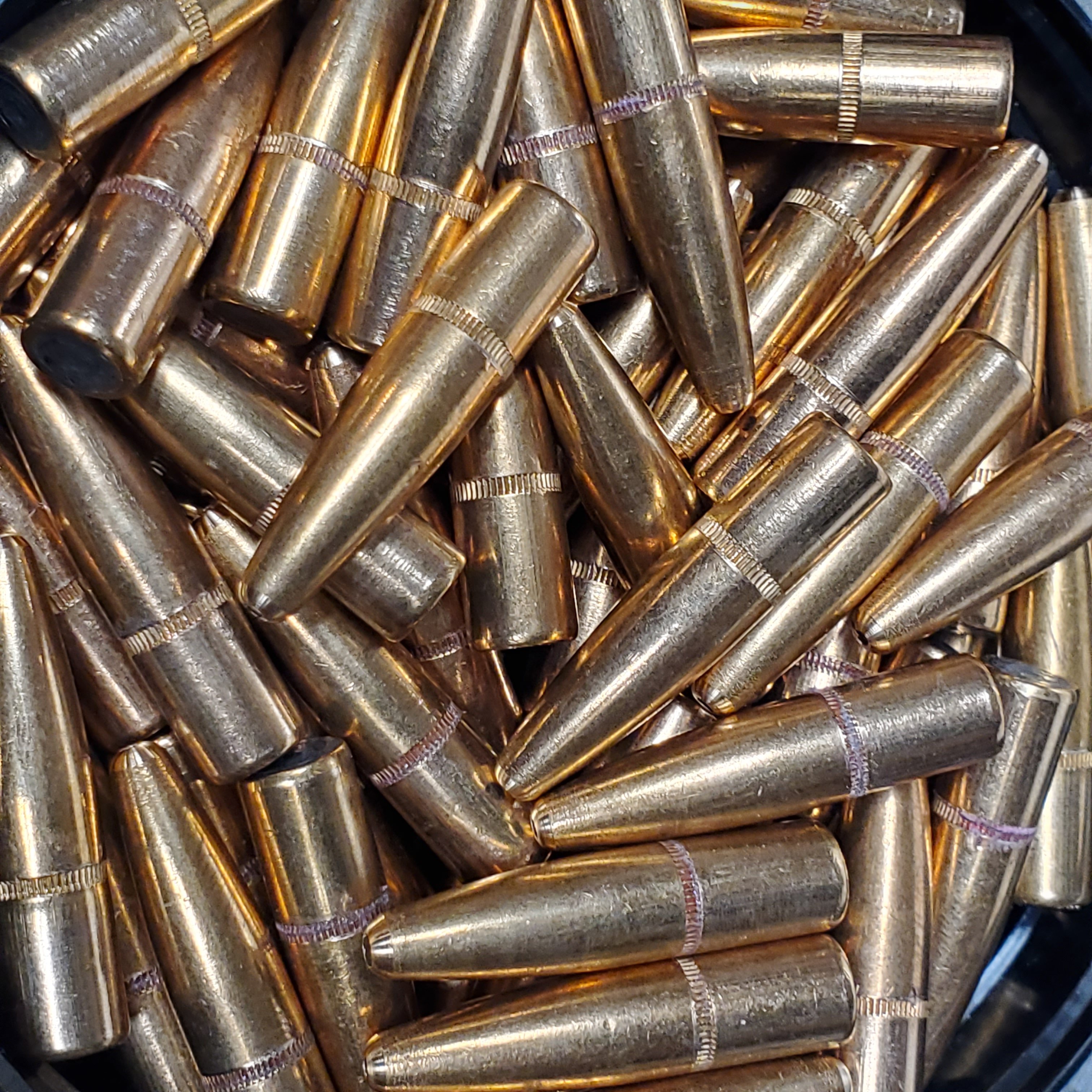

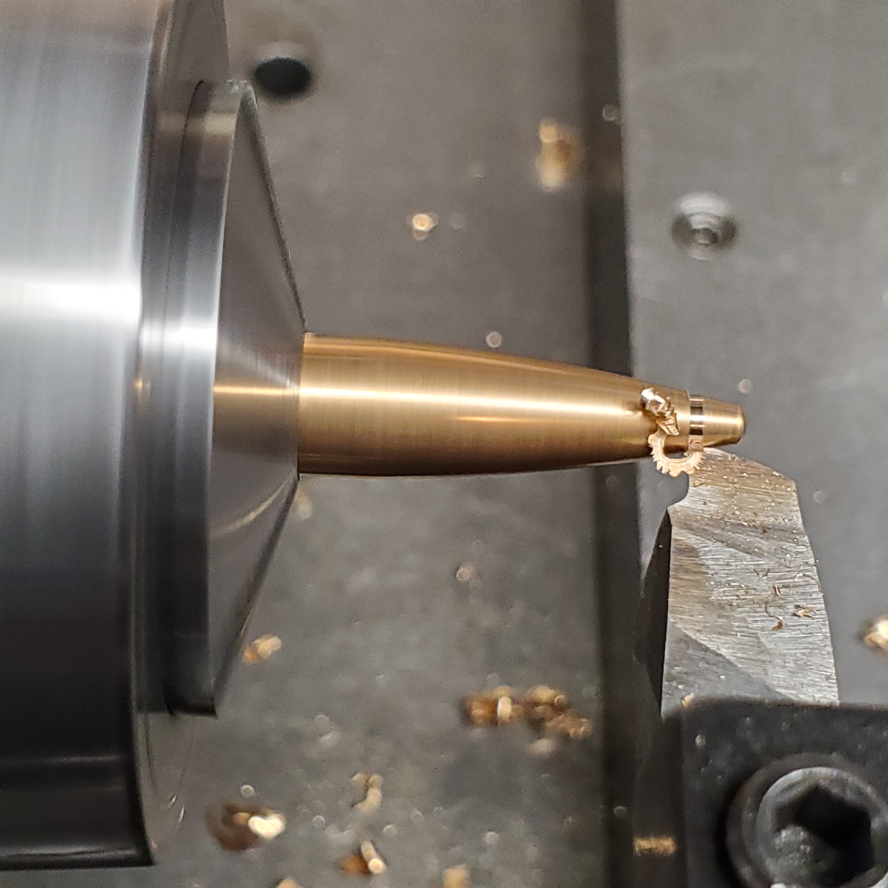

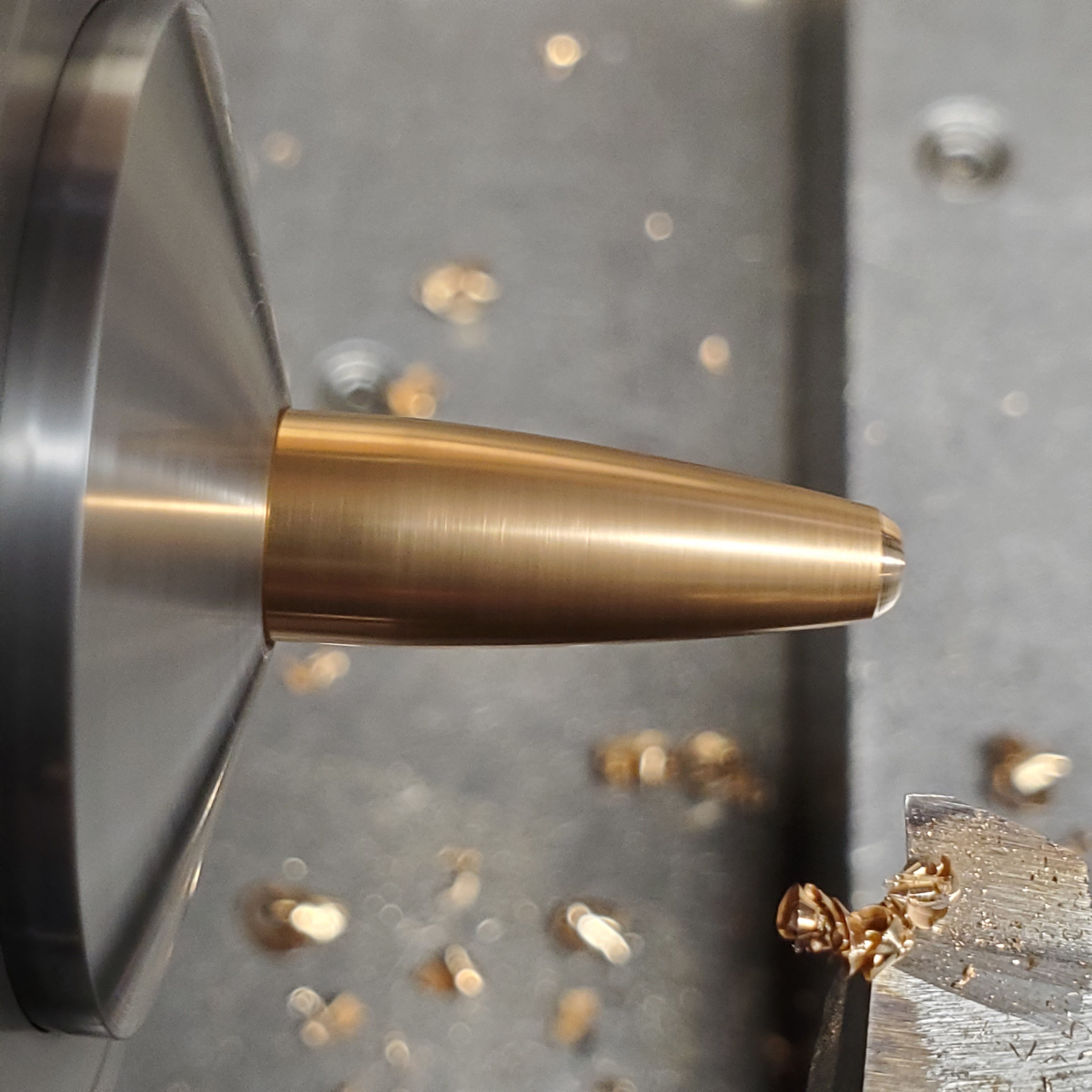

Cutting bullets & re pointing to fit the magazine of the 338 ARC improved, and loading them in a progressive press.
Notice the false shoulder on the 338 ARC neck, to get a bit more velocity out of the light supers, but unchanged for subs, and still have good fill for subs as the long bullets take up most of the case, way down past the neck.
Notice the 338 ARC has a dedicated mag now...especially those blunt 307 gr bullets.

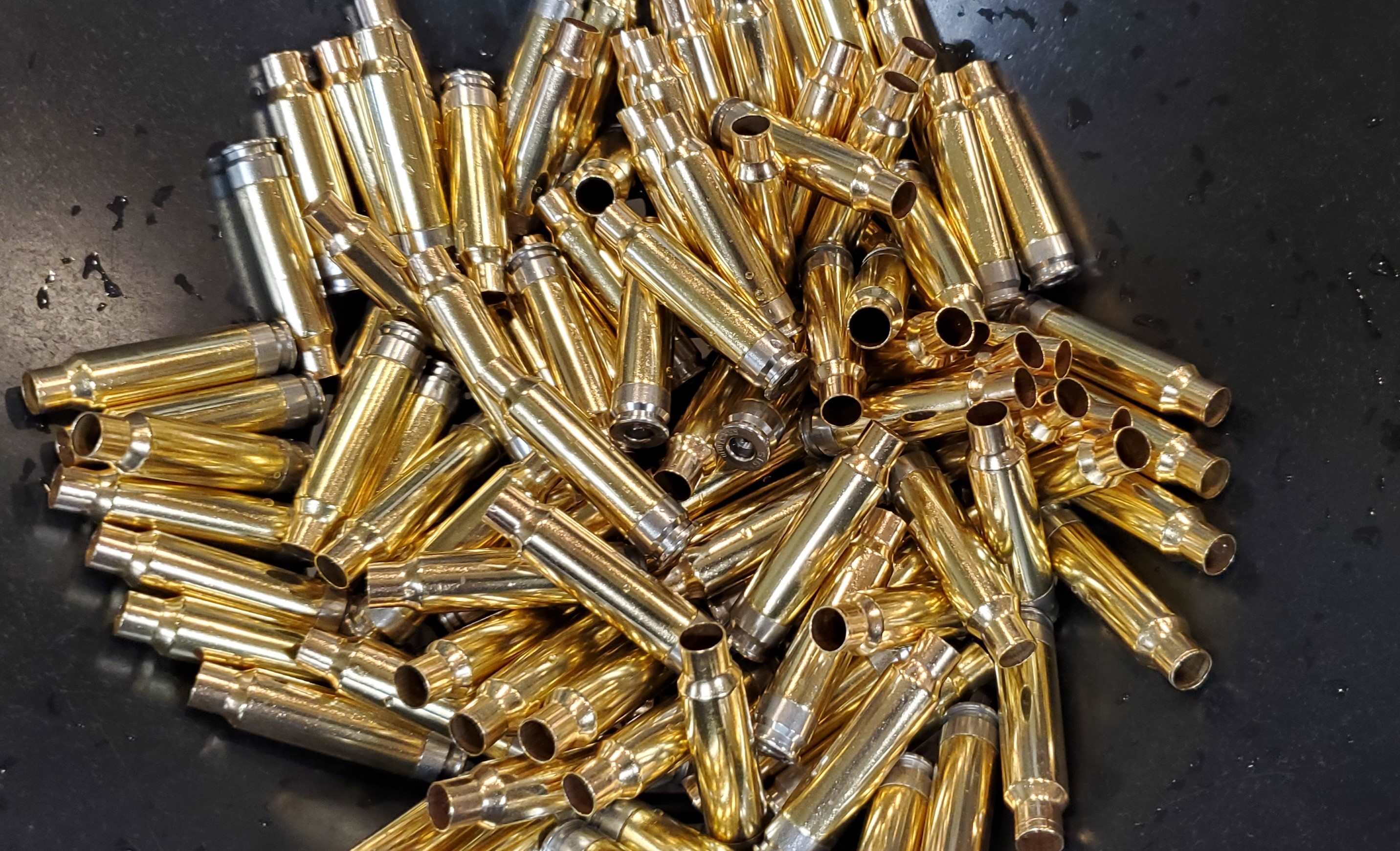

Since I want to fire form some cases that I can measure their case volume, I’ve annealed, sized, prepped and loaded up 10 cases that I’ll also measure velocity to get some idea for velocity with a load of IMR-4064 that I’ve used before. Primers that were removed were reseated to the same depth as before (.004 blow flush).
The rest of the cases were put through my annealing process as well (flame annealing to a red glow) then expanded the necks with a .305” expander mandrel. Once all the cases are fire formed, I’ll then turn the necks to .014” thick.
To make sure all the powder is out of the cases and take care of the oxidation layer after annealing, I wet tumbled them with SS pins (25 min).
Took the clean cases and FL sized them all, dry tumbled to remove lube and trimmed to length. Here the finished product:

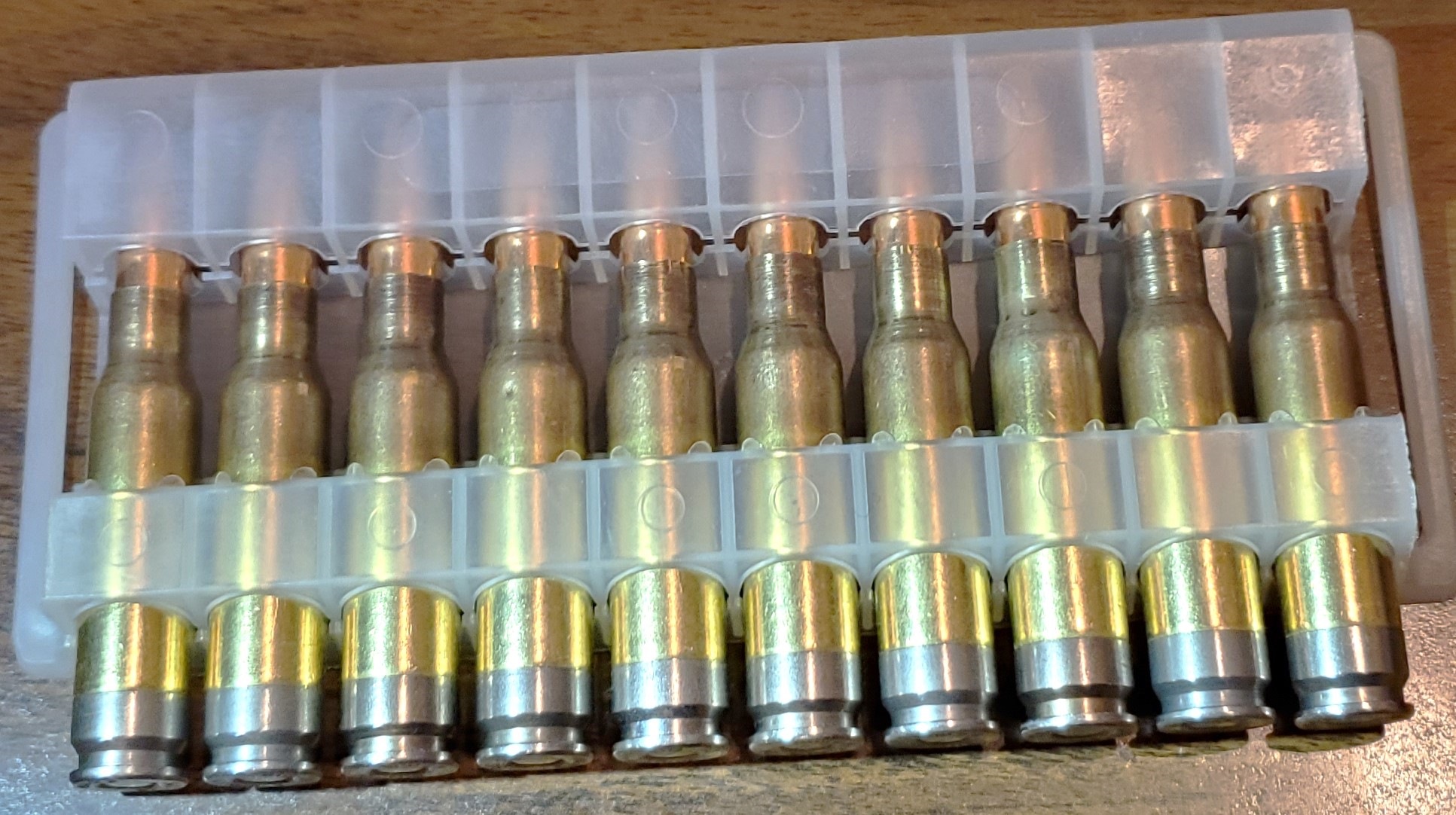

Finally got around to firing those 10 cartridge's I loaded with 41.7 grs of IMR-4064 behind some 190gr SMK's that's been just laying around for some time. This was simply to fire form them that I can measure their case volumes before I load the rest of them up. Case volume wasn't quite as much as I expected at an average of 56.3 grs H2O and the case weight averaged 165.5 grs. Neck thickness for these cases varied from ~.014" - ~ .015" on various cases. Case head space measured ~.001 longer than my fired Lapua cases, though they started out a little shorter.
SD was 4.7 with ES of 15 for the 10 shots, which is surprisingly good considering I reseated the primers that had been removed to the same seating depth. For an arbitrary load I used, it did surprisingly well (it's not a powder or load I plan to use, being it was just for fire forming).

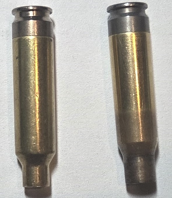

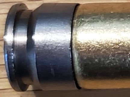

The transition from the steel head to brass body appears to have tightened up nicely (left is an original case, right is a fired .308 case):

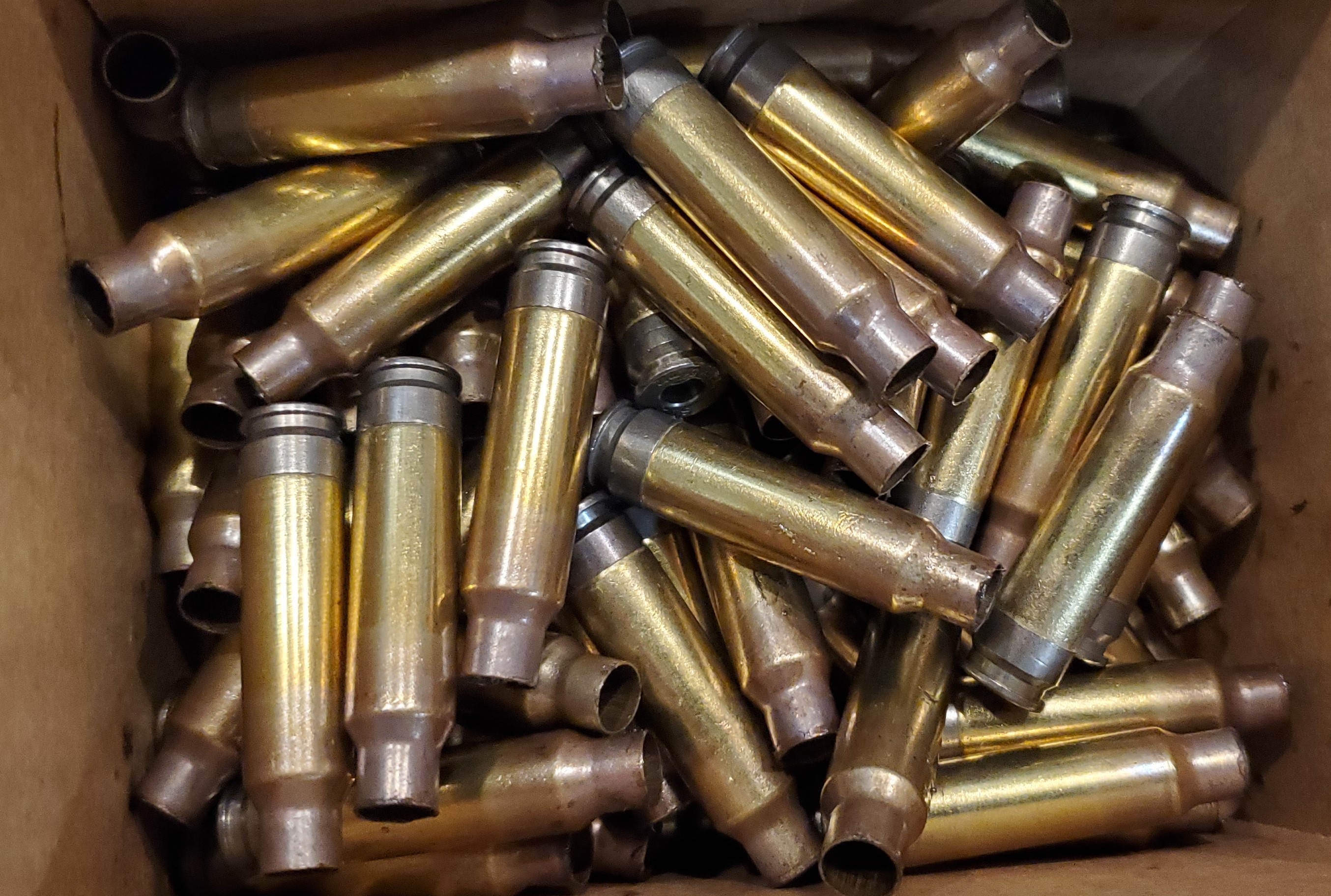

After going through the box of cases that I processed , I did find there to be the 4 different headstamps. That vast majority had the 24 and just 6 that had "277 Fury" stamped on them. Those without the "23" or "24" are much lighter at < 149 grs (those stamped with Fury also weighed in that range). The 23's tended to weigh right in between those and those stamped with 24, though 4 of the 23's were at the same weight as the 24's, the 24's all being the heavier.
Since I've got 4 more boxes that I haven't touched, I guess I'll just have to go through them and sort these different ones out. 😵‍💫

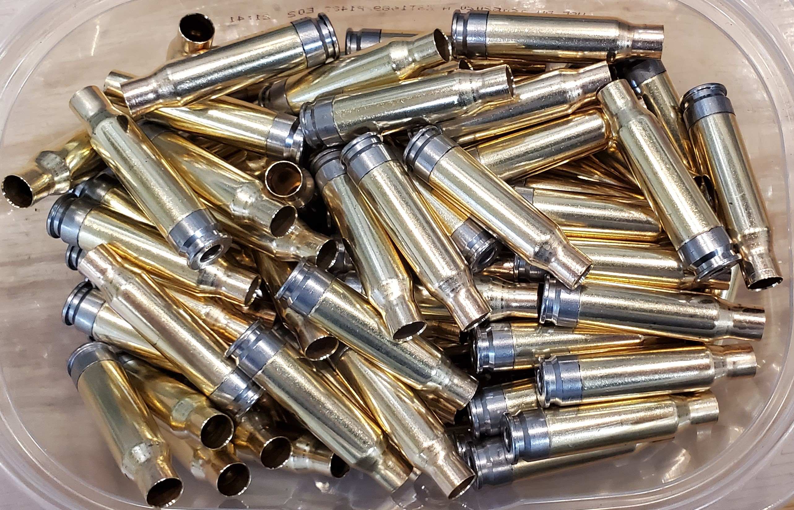

I did the same. I have 200 of each 24 head stamped brass for 308 and 6.5 Hybrid cases.
I would say this though, if you have a AMP annealer, they all are close to the same Aztec code. Mid 130 to mid 140s. Good thing with the boxes of brass from American Reloading is that they do not come with 100. So I can sacrifice a few cases in experiments and not feel guilty destroying them.

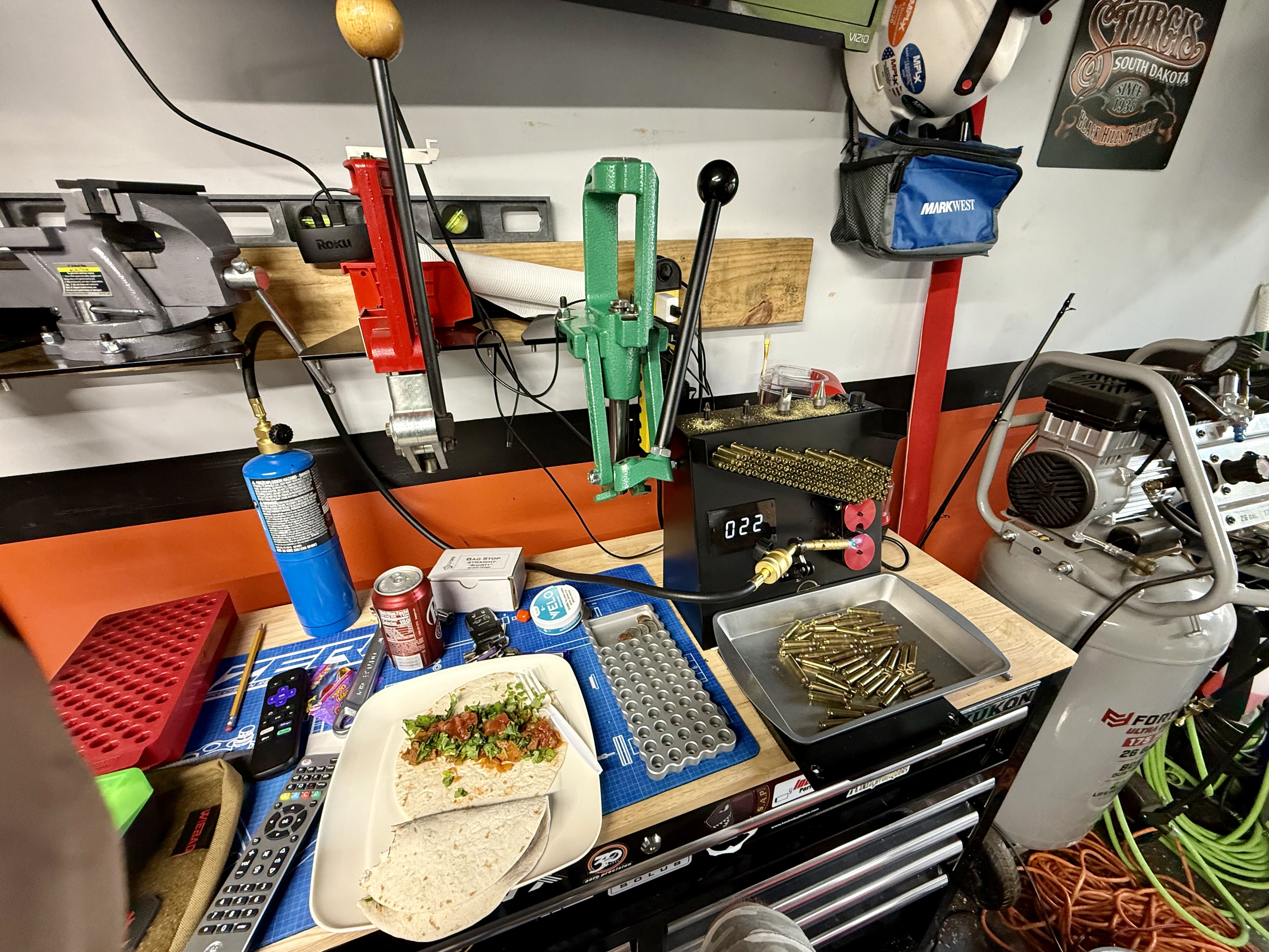

I cut out a few hundred crimped primers and working on complete case prep. Got a new WOA 20” SPR barrel, gonna figure out what it likes with 73gr eldm’s and Tac.
Ran about 30 rounds through it today of Frontier 75gr BTHP from 100-350 and it shot that fodder VERY well.
Hopefully I can come up with an easy mag length load this turd will like.

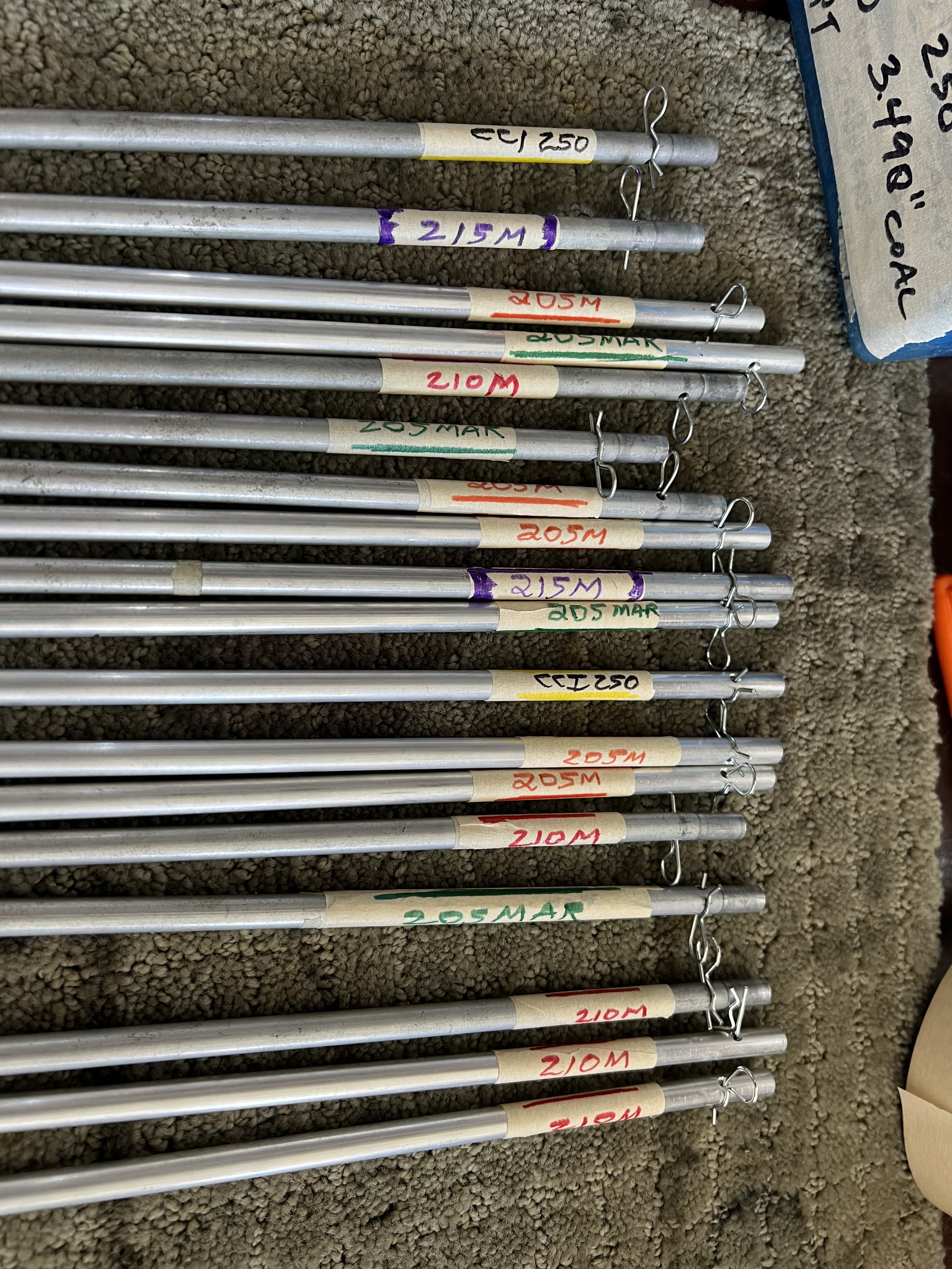

I labeled and color coated my primer tubes with the colors matching the sealant used for the primers. The only one that gave me grief was the 205M because I can’t really tell the color so I designated it orange

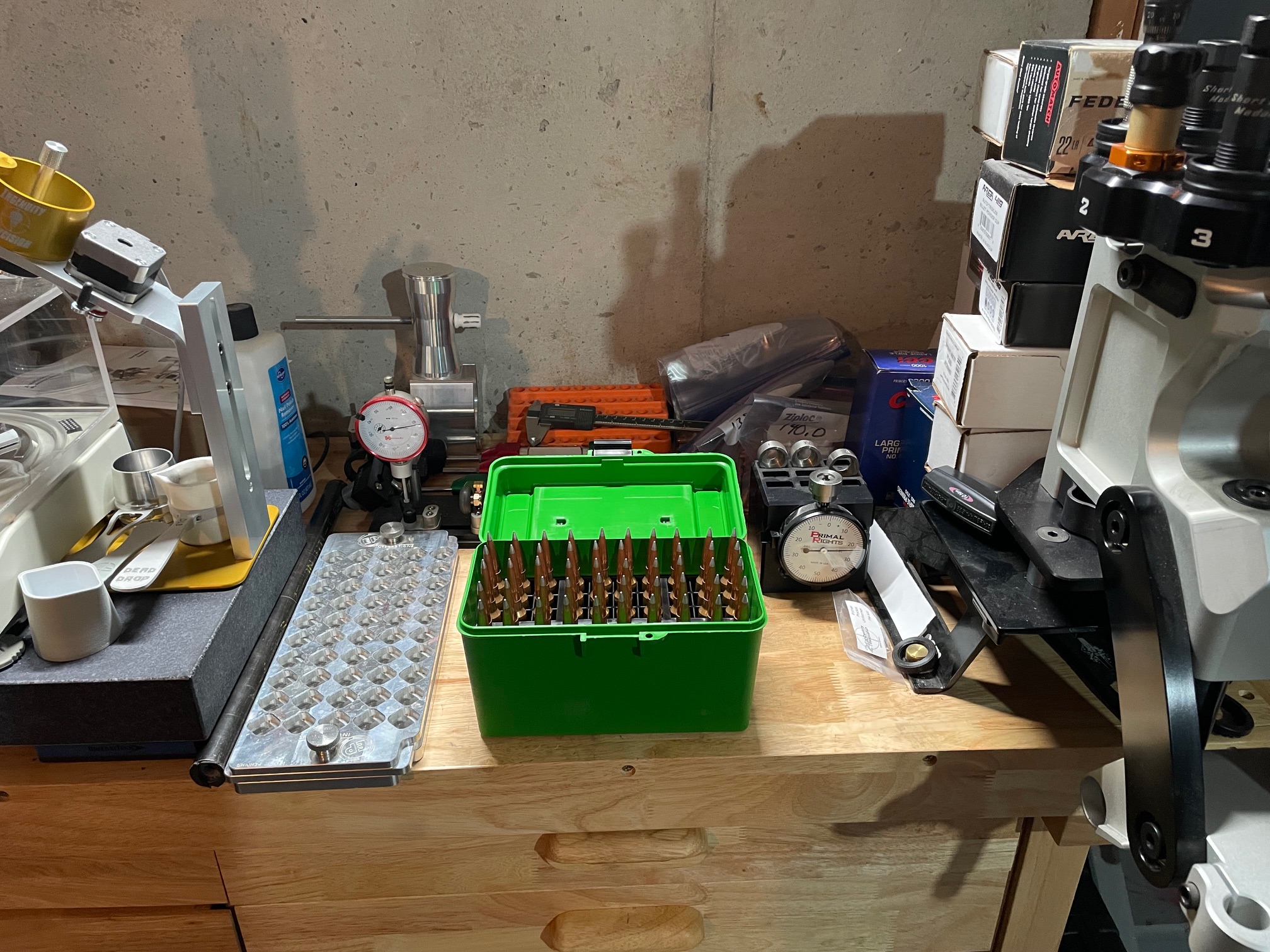

I've been prepping 308 still. Doing shoulder bump. Comparing it to what I measure on some FGMM, the shoulder bump there is 1.620". I'm seeing that spent brass out of my bolt gun has a bump at ~1.625". If I bumped 5 thousandths, would that be too much?
Yes. Try to keep it at .002"

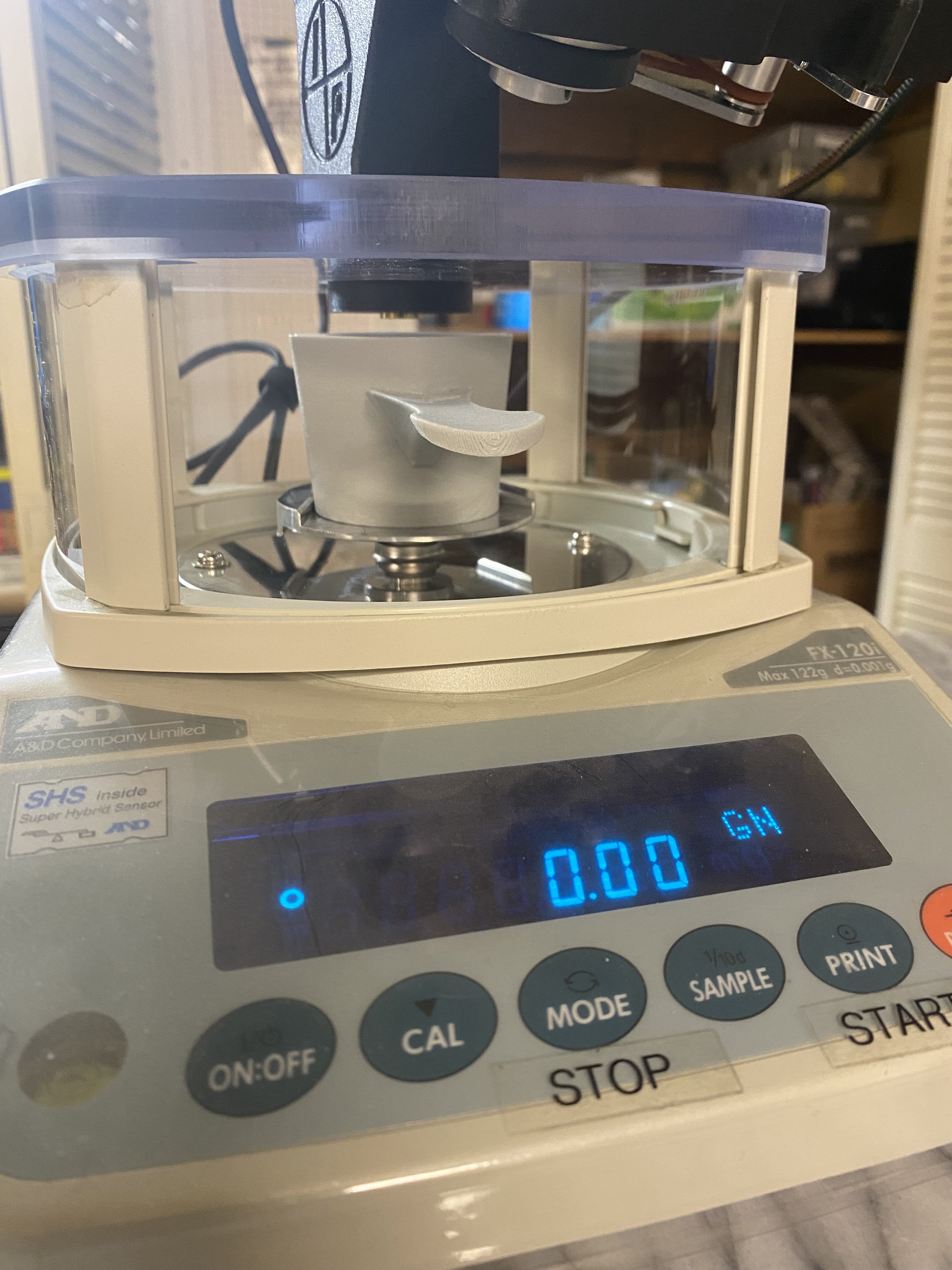

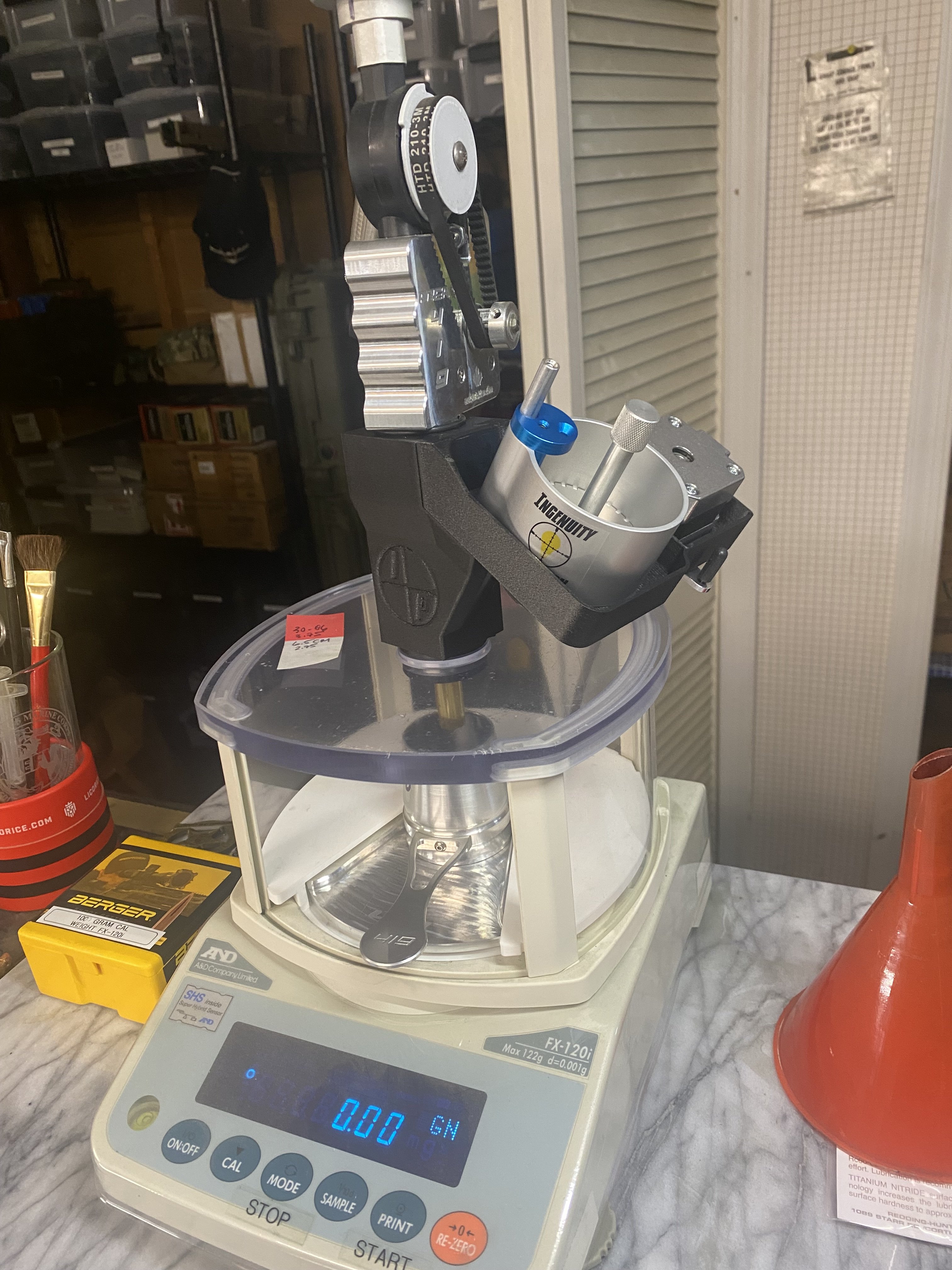

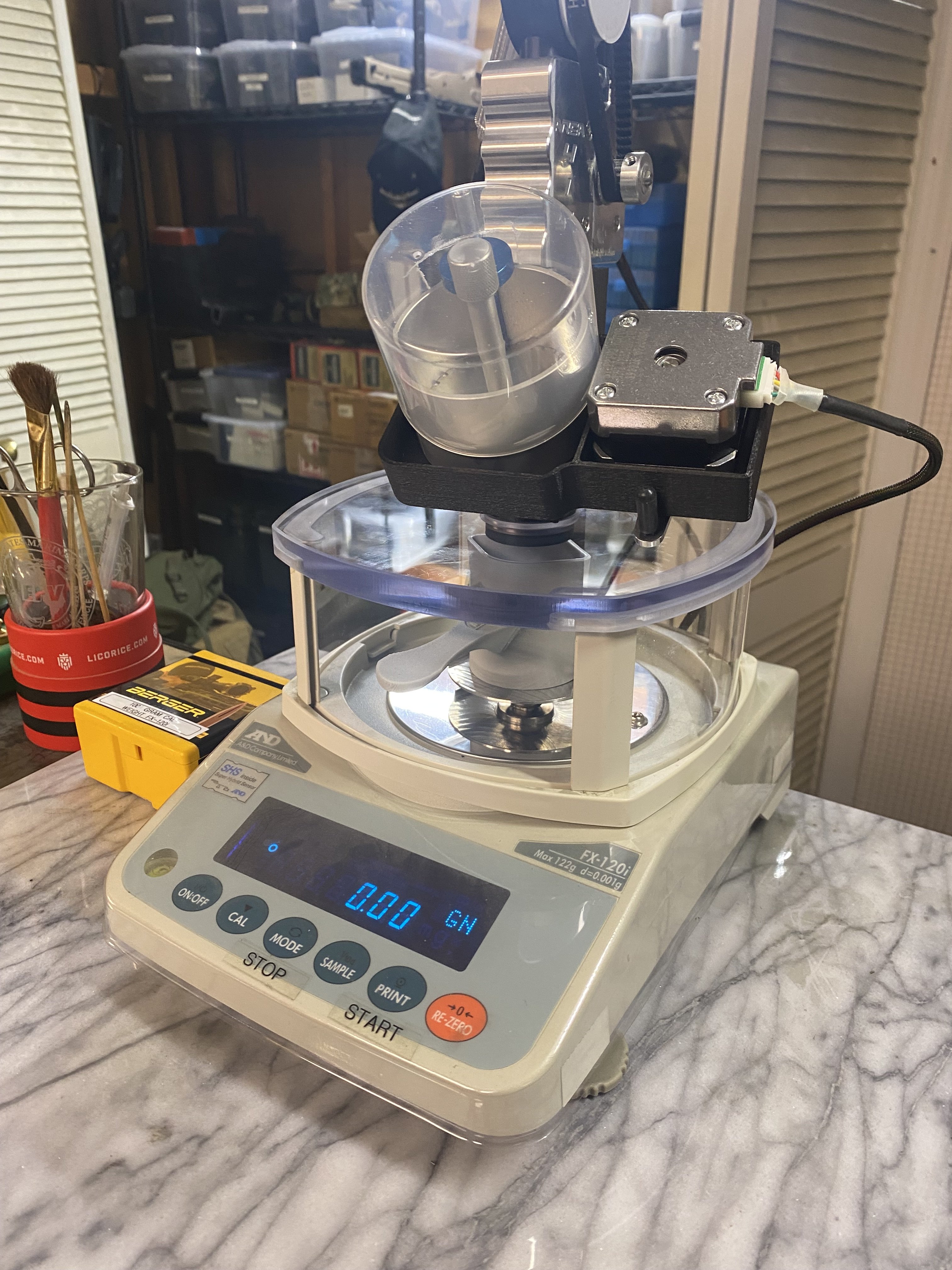

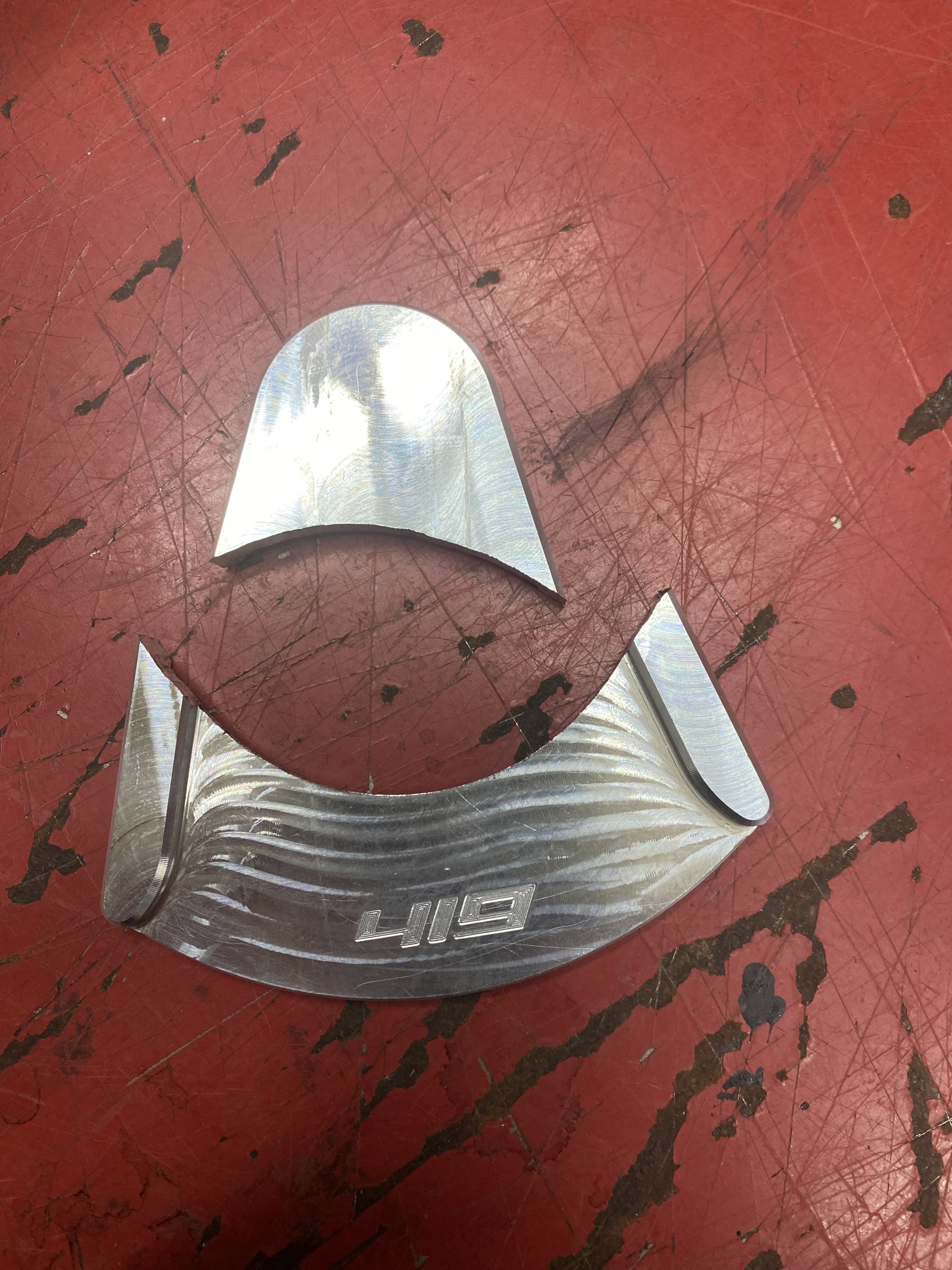

I might do that with my v4. What cup holder is that mounted to the scales plate?
That’s an Area 419 platen that I cut the wings off of and then chucked up and turned down on my buddy’s lathe.
Made it easier to clean up bounced kernels.
