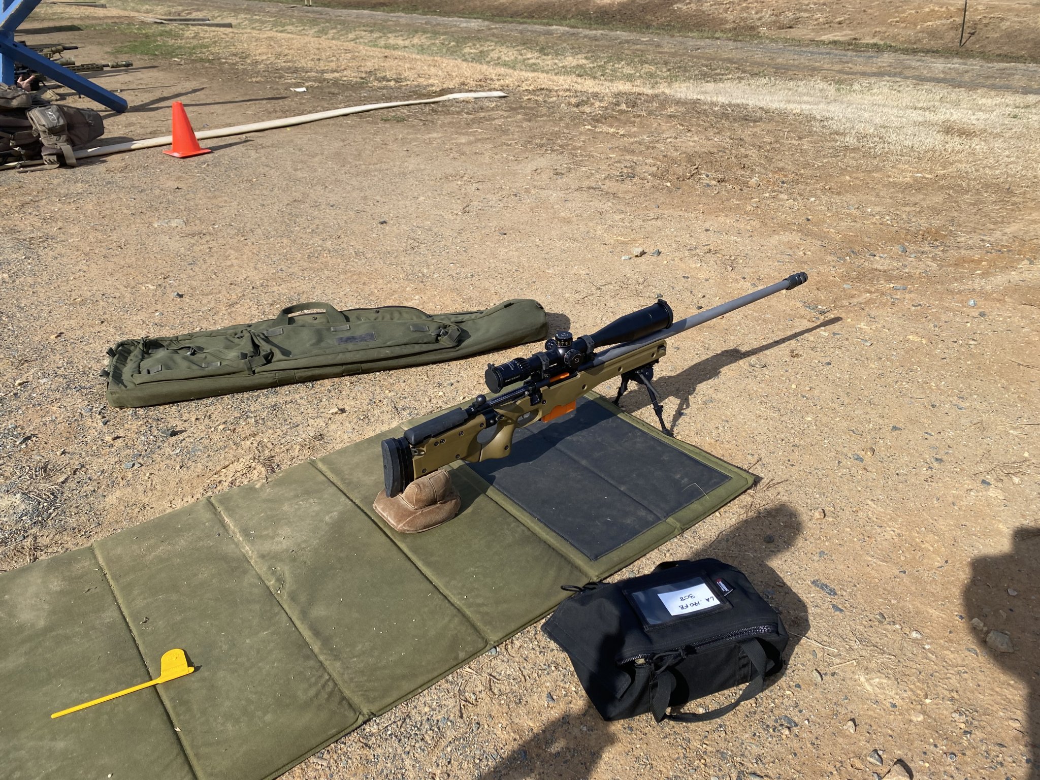

Can we get some pics of the rifle? It's a long action?
There was a picture of it in the original post, in the fog on Range 4.

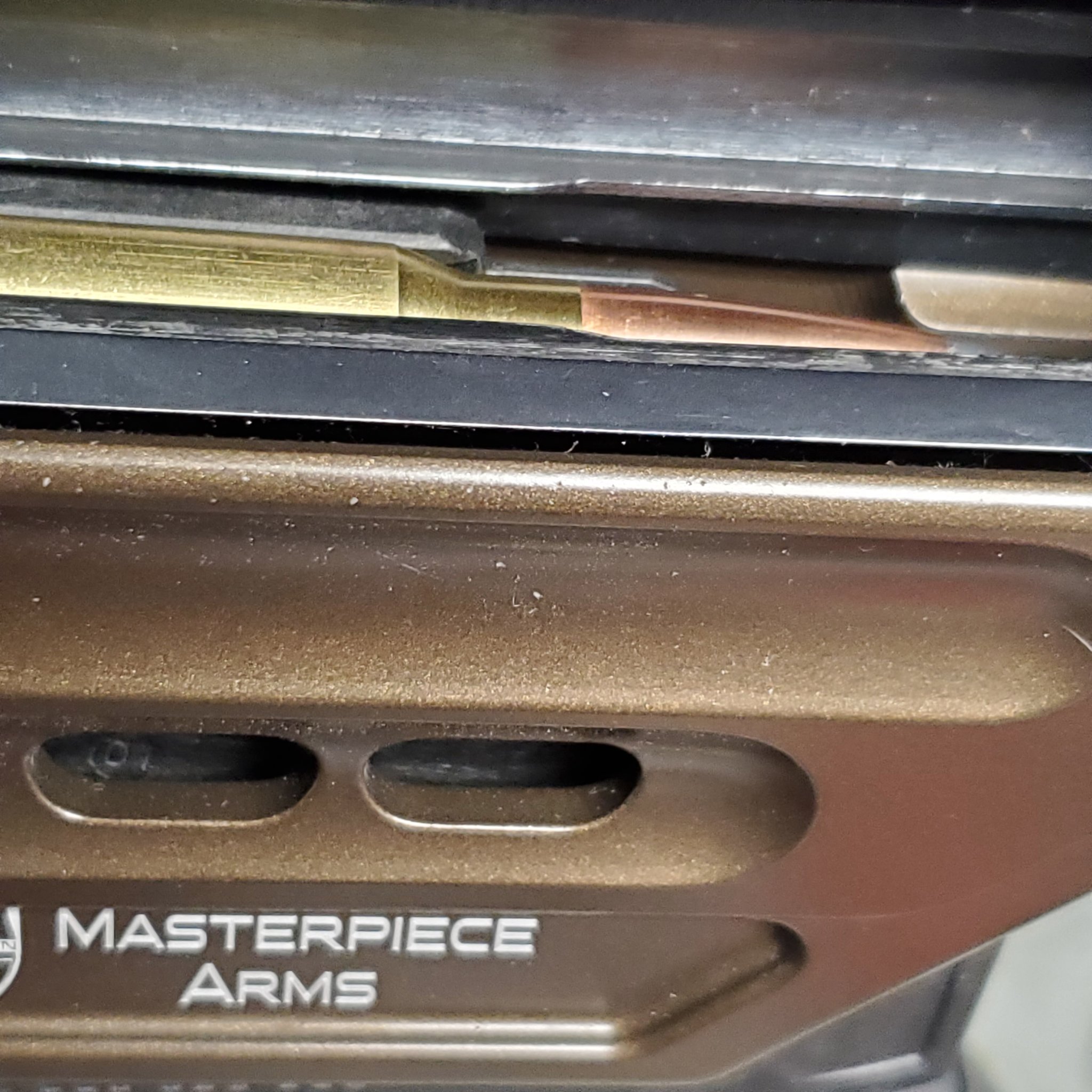

Marines using the 1K range yesterday so I had to settle for steel @ 700 zzzz.

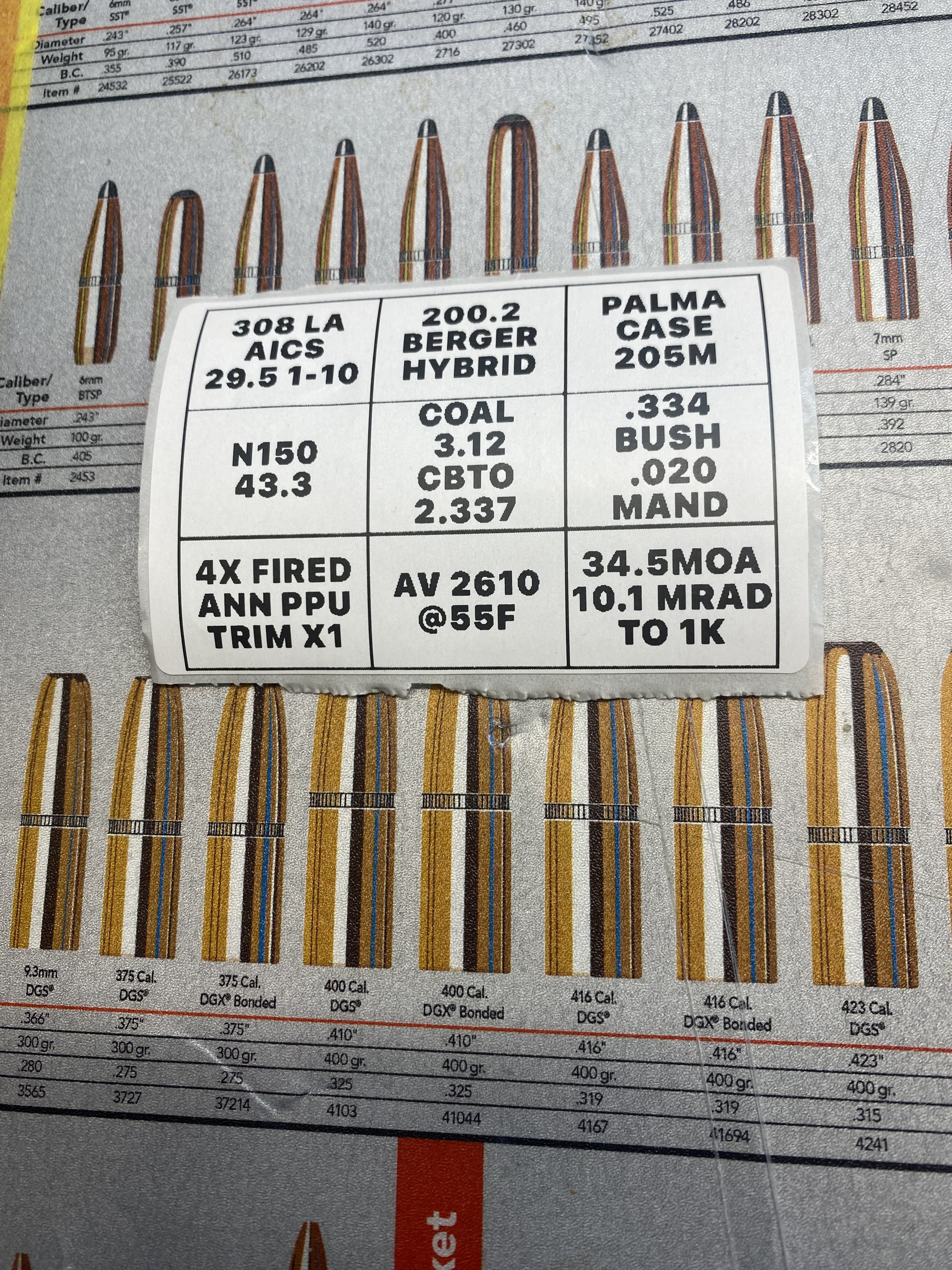

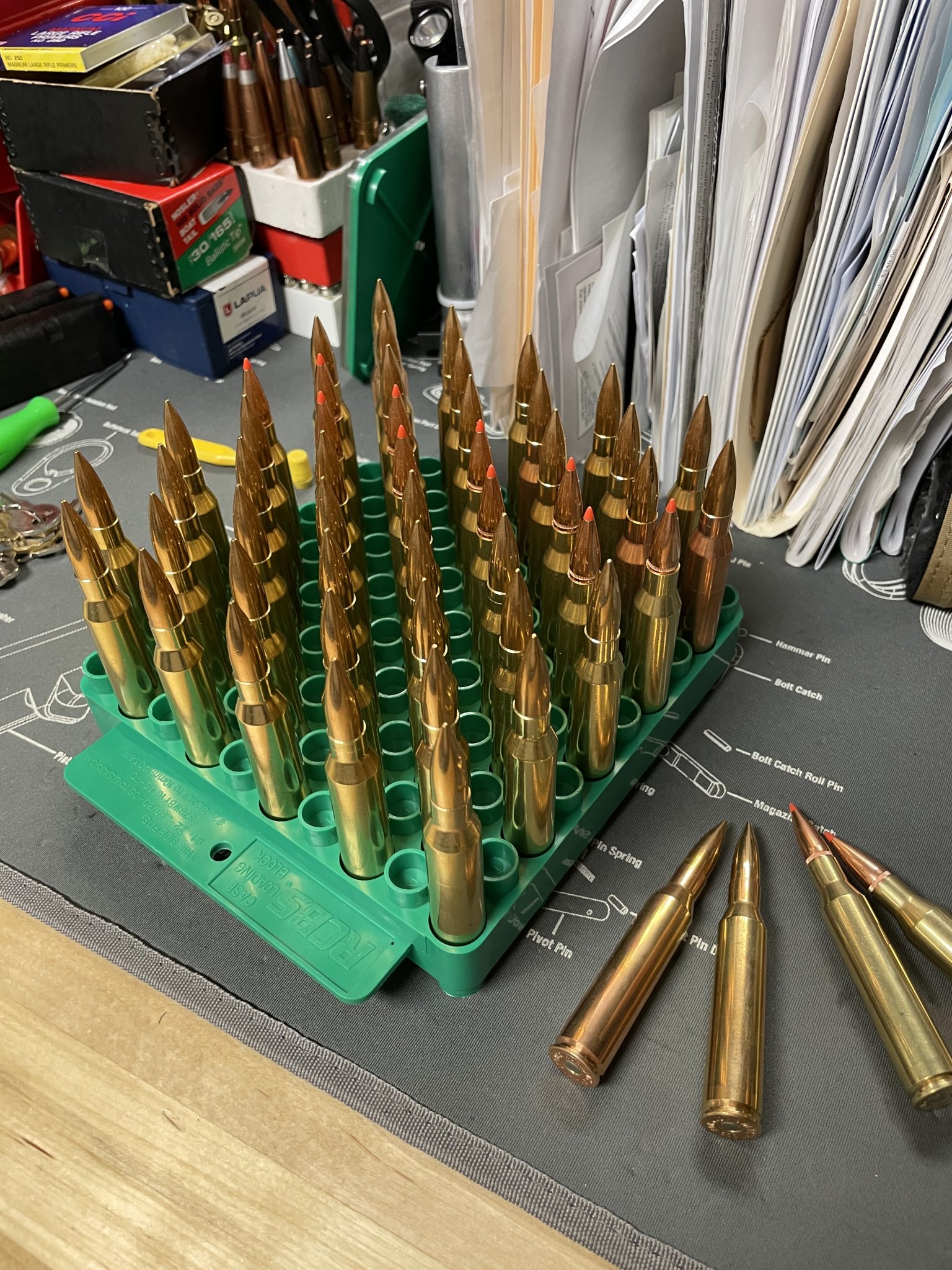

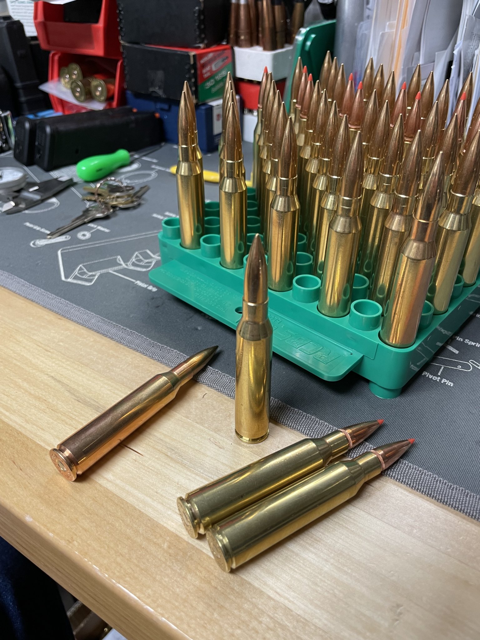

Loaded some modified 6.8X 51 mm hybrid cases to 308 Win in a long action 8 twist.
For maximum 308 Win performance.
230 gr Atips at 2700 fps, then on the opposite end...
Some 110 gr Barnes around 3750 fps.

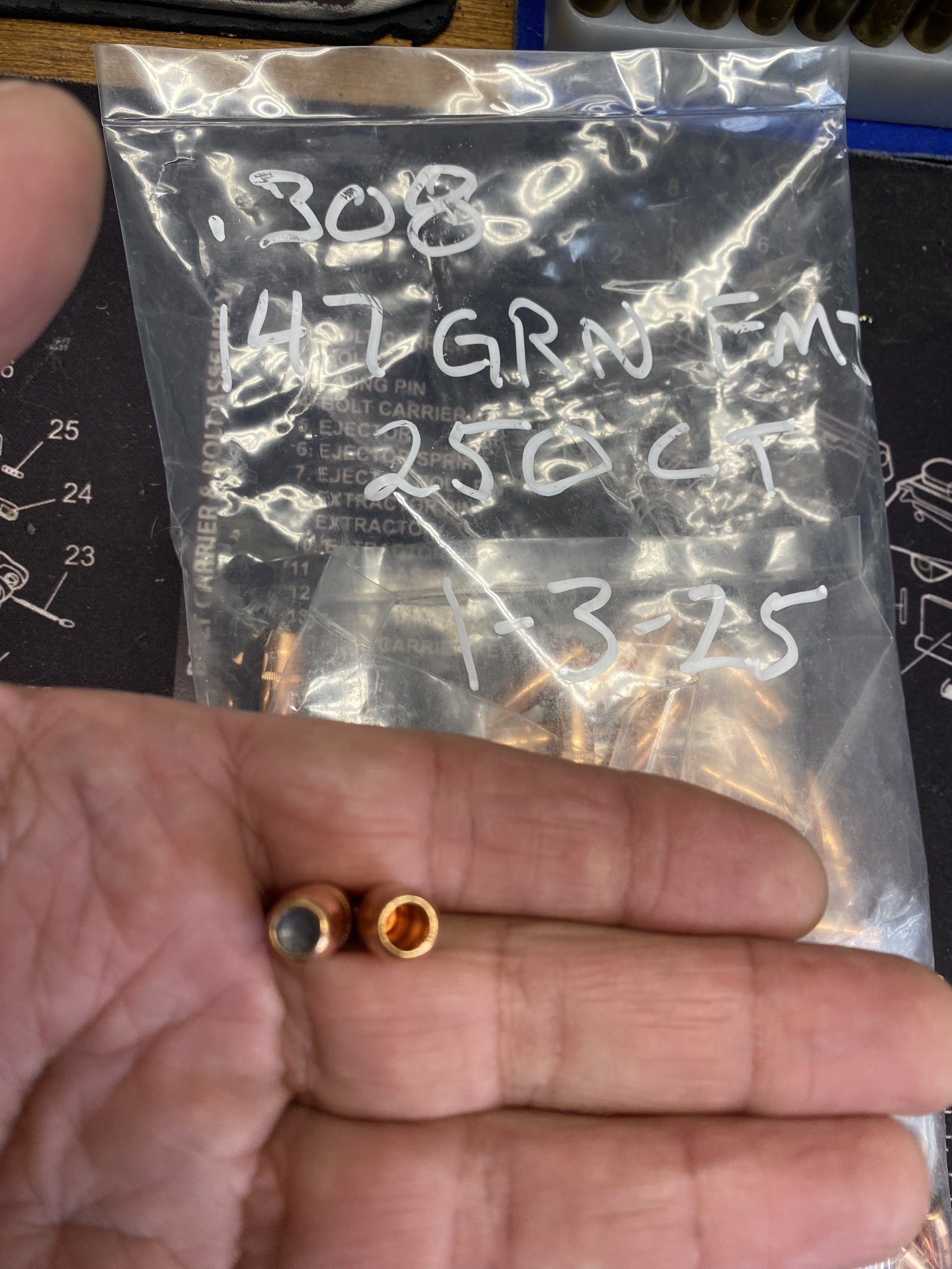

What are the chances I managed to spot this fella as I was pulling this bag out to look for other pills? Empty as my head. Brand new bag, I just gotta remember where I bought them...I reckon reloading should never be taken lightly...see what I did there..? ;)
If you using a single stage press, you’d think you’d pick up on that pretty quickly.
A progressive with bullet feed, you could have problems!!

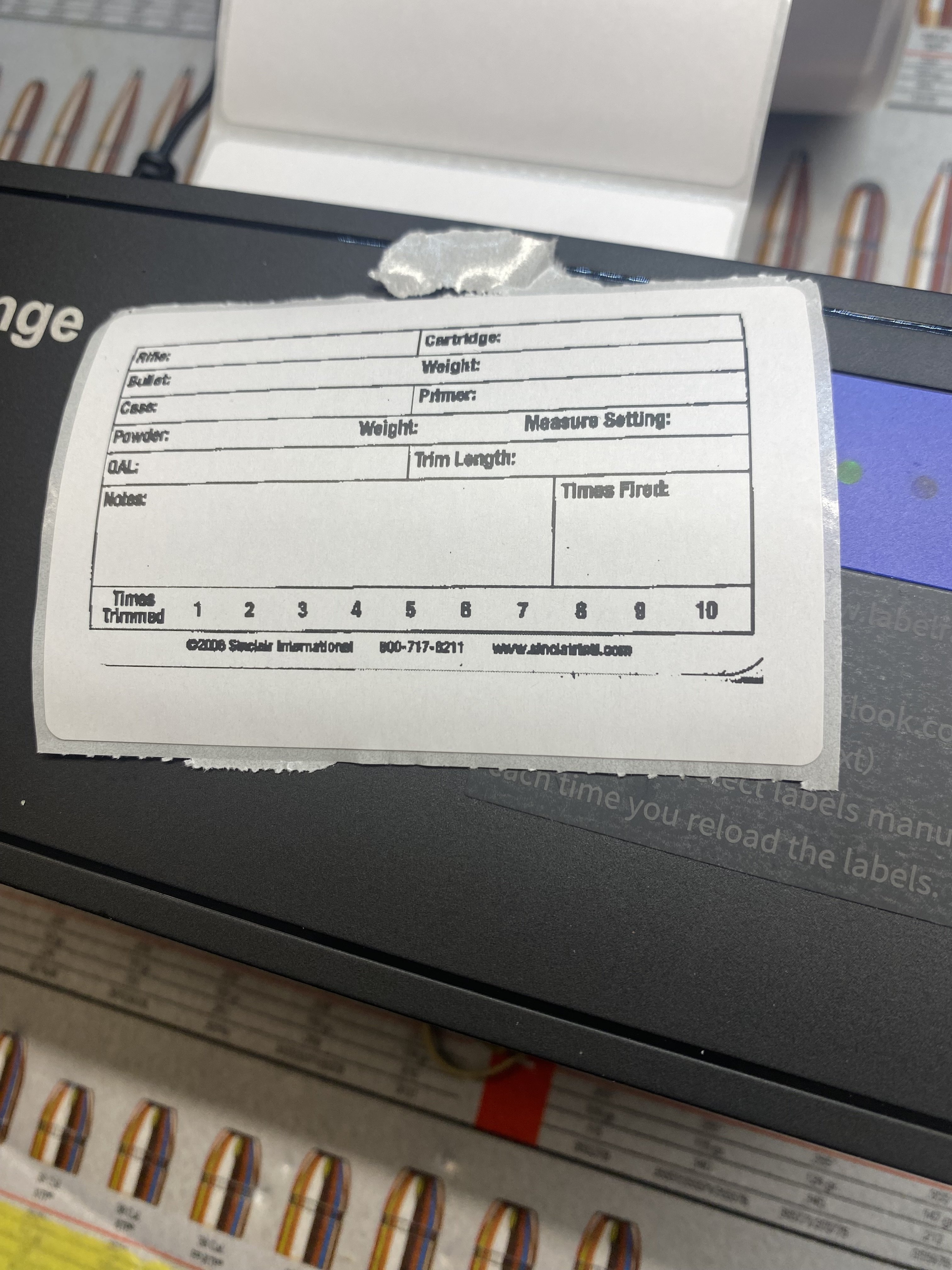

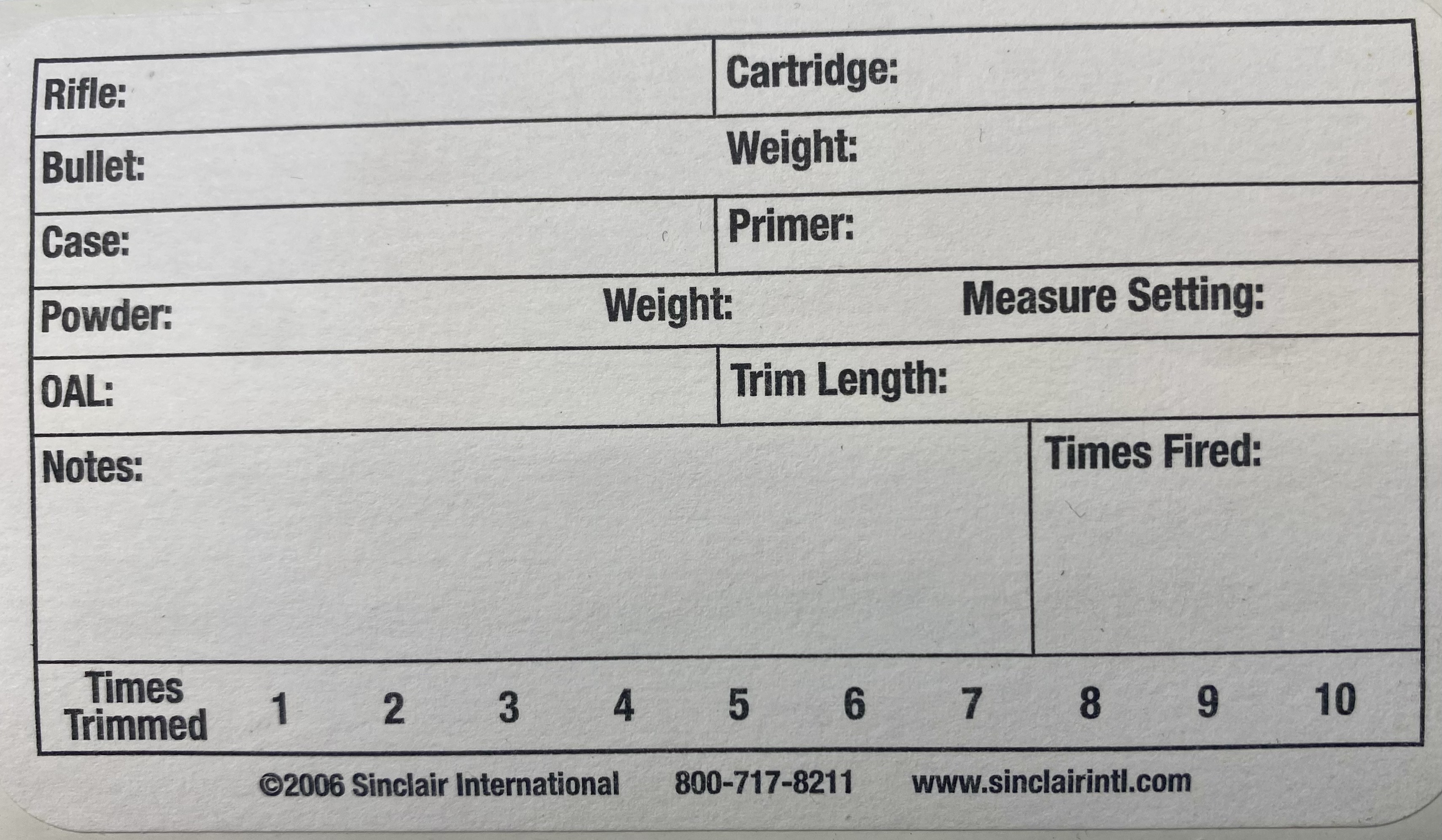

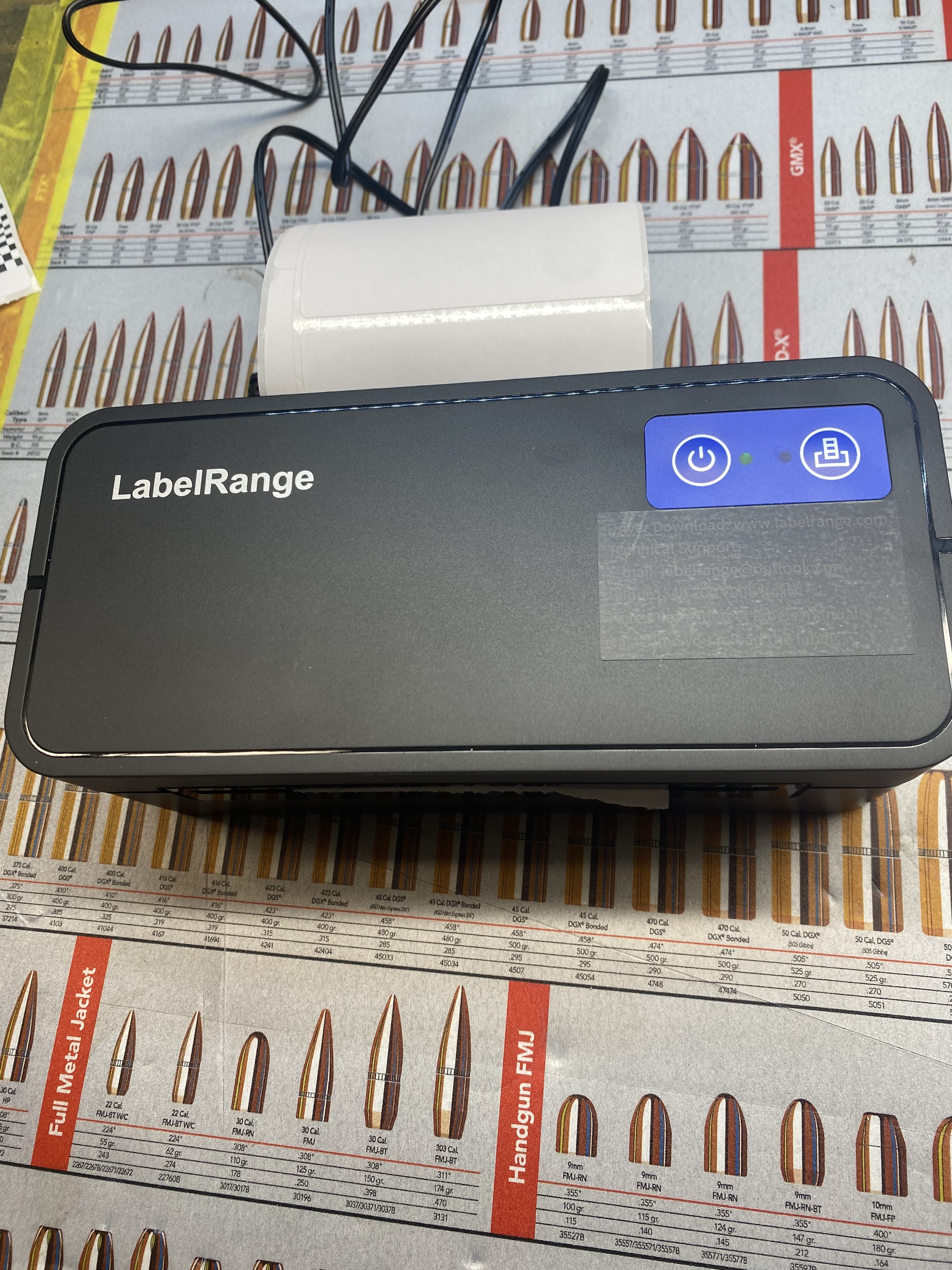

Fucking around with a cheap Bluetooth label maker- my favorite Sinclair load labels have been out of production for many years and I’m running out of them.
Labels are 2x3
A picture of a Sinclair label
A label printed from the picture… I gotta scale it up and take a straighter picture, but.. this thing shows promise
Edited to add:
Here’s the final version; I made a blank template. Just add info and save as new.

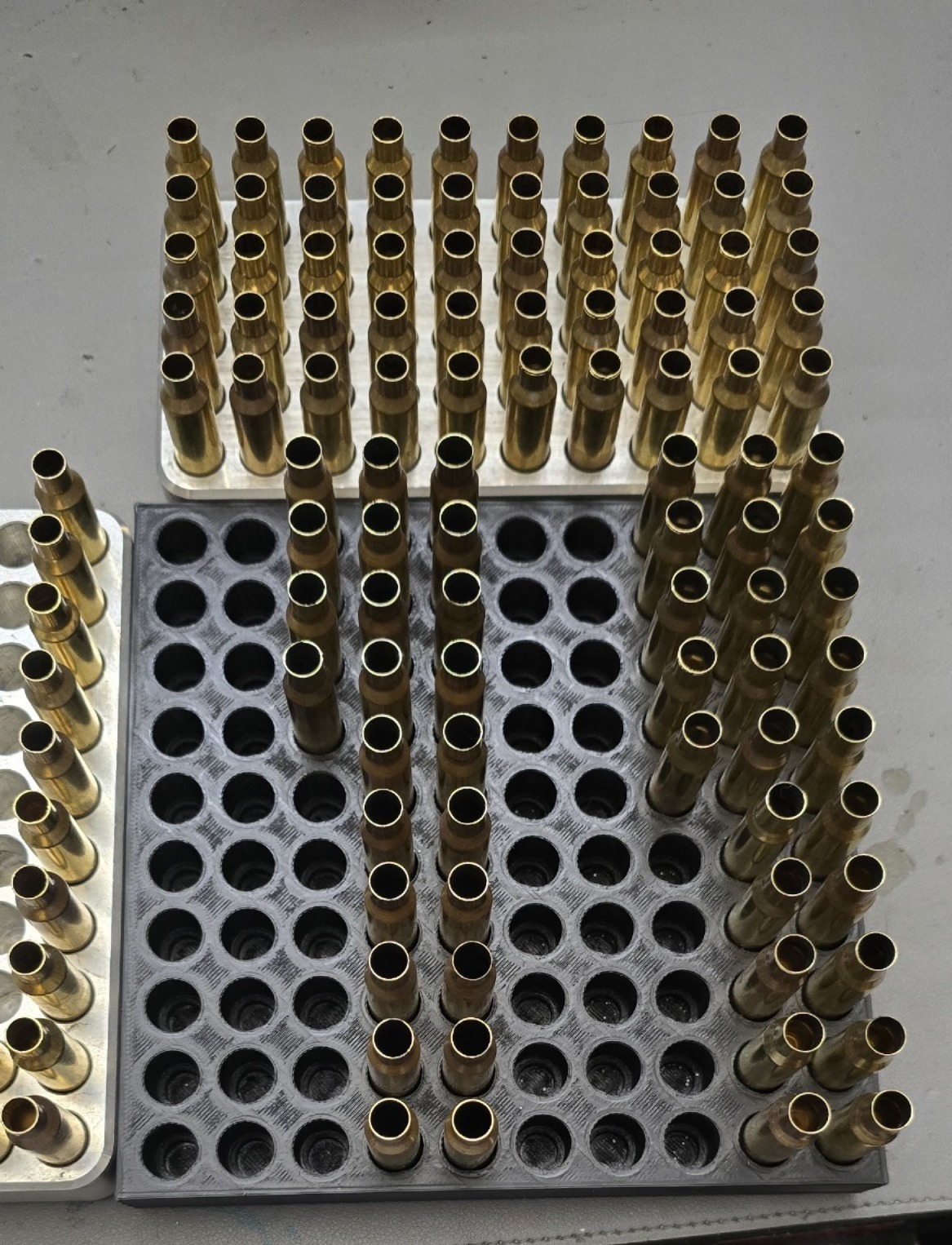

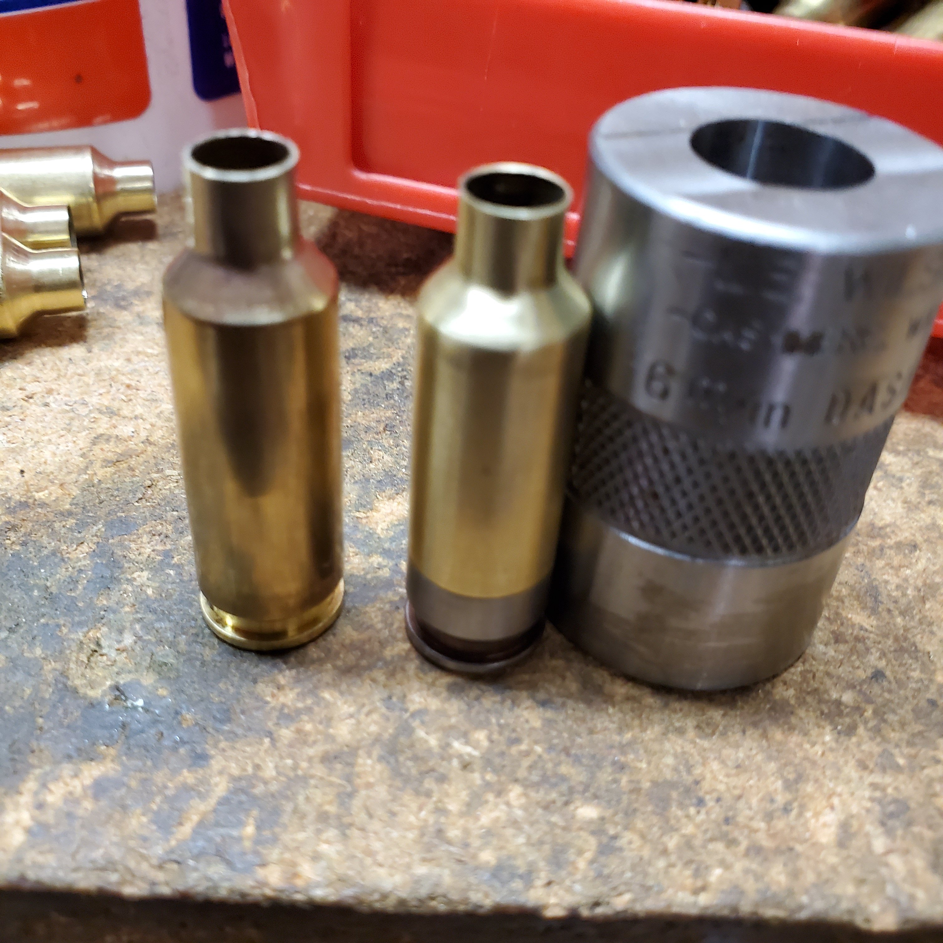

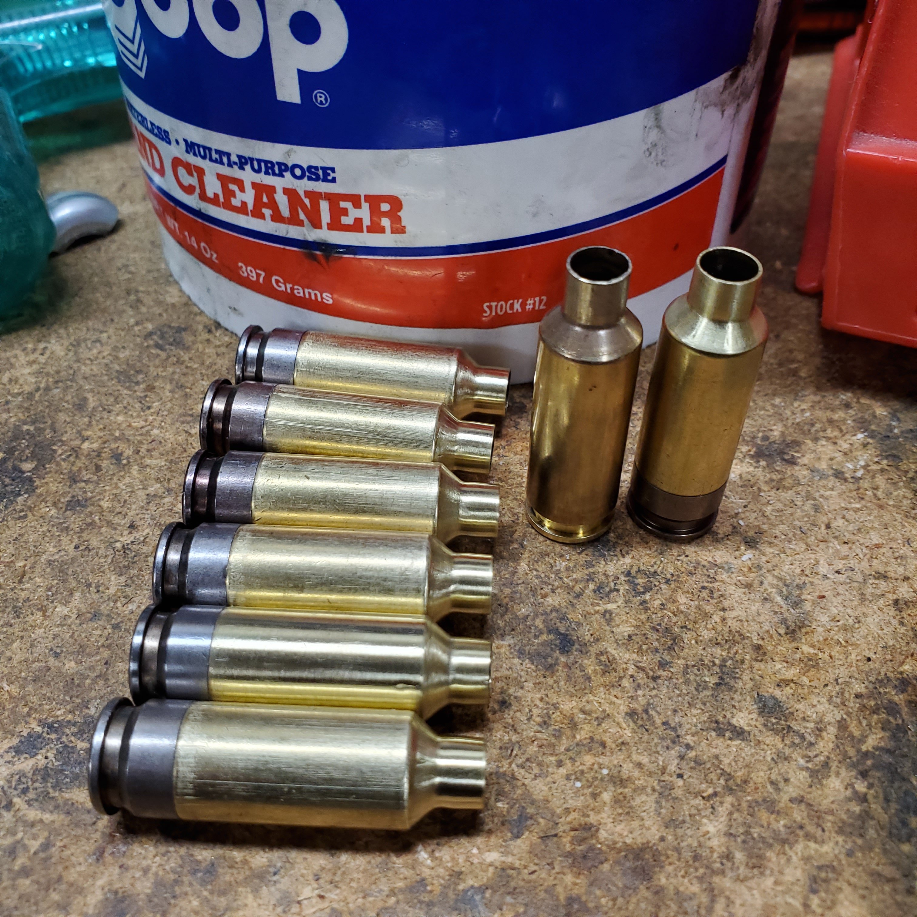

Playing with the idea of hybrid cases in the 6 Dasher. It was a successful endevor...
But needs to be streamlined to be worthwhile.
107 gr SMK at 3200 to 3300 fps?
Probably Not something you'd shoot alot of rounds through in a day.

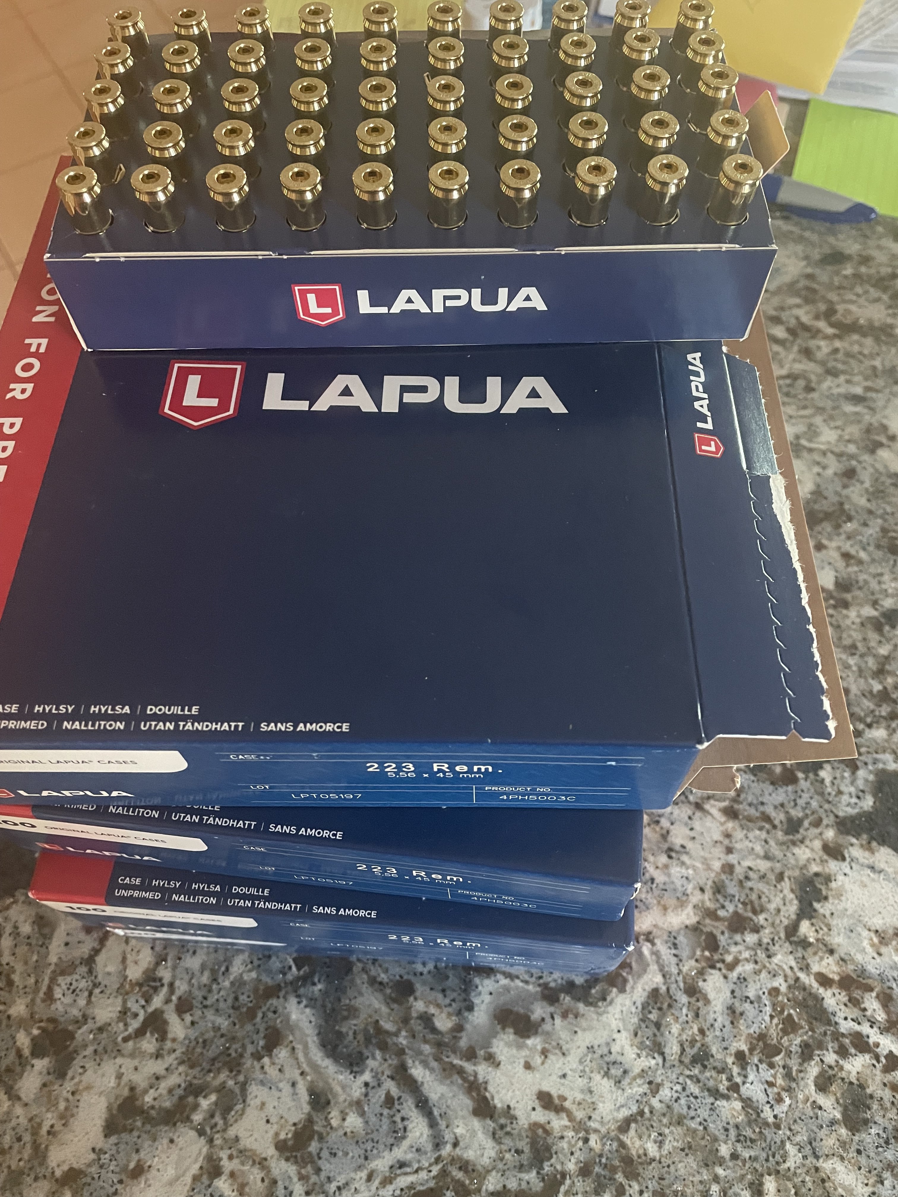

I have notifications from many multiple places for Lapua 223 match brass. Interestingly enough, late last week I got two notifications of Lapua 223 match brass in stock from Midway and Powder Valley. Amazingly enough I got them as I was just sitting around, right place, right time for once. I actually managed to get 400 pieces of brass before the bots.
What’s interesting is that instead of the blue plastic boxes they used to ship in they now come in cardboard boxes.
