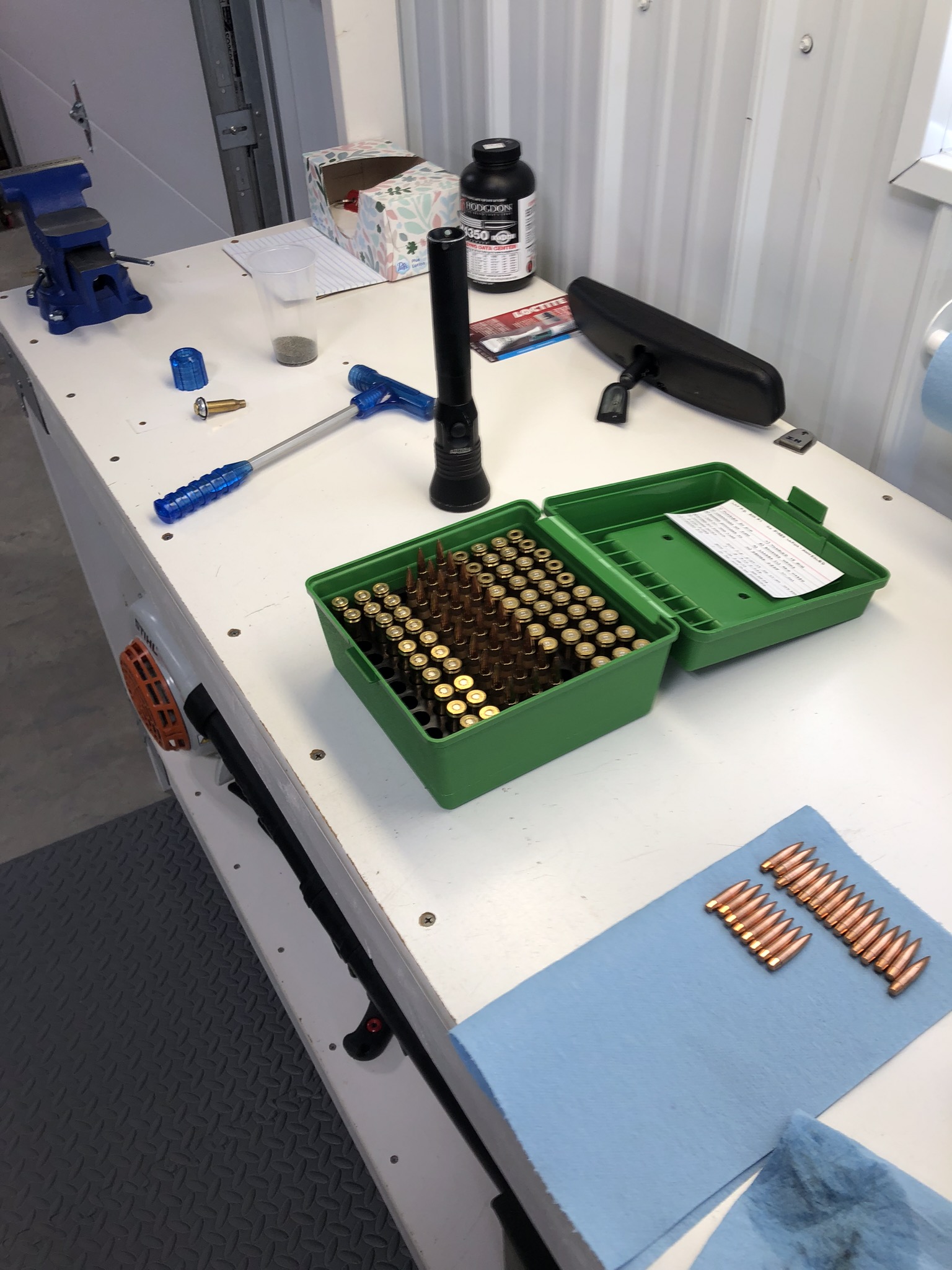

Pulling 260 loads for the old barrel. New barrel likes a tad different spec. Wife calls this unreloading 😂
That many at once is worth having one of these and the collet for it:
She should put that term in wikipedia with a credit.
I like it. Unreloading
I may have 25-50 rounds to pull down for improper shoulder bump.
What makes it suck is they're load development, damn it.

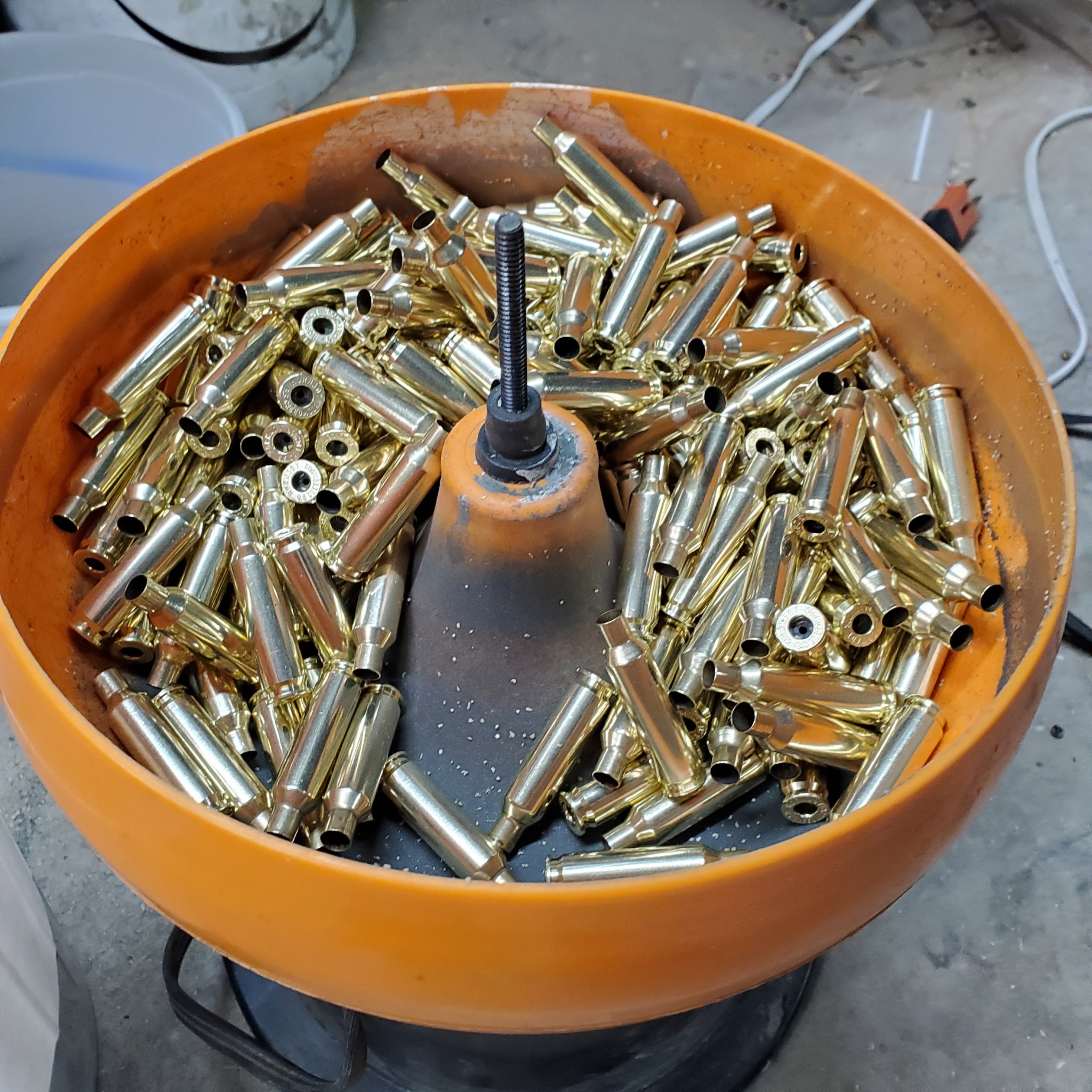

Pretty busy harvesting Nanking Cherries and Currents.....but, managed to powder coat some 400 grain bullets for my 460 Smith. The oven is in the pole barn near the harvest area....just monitor the time and remove the bullets. Multi-Tasking! 🙂 Got them sized last night! memtb

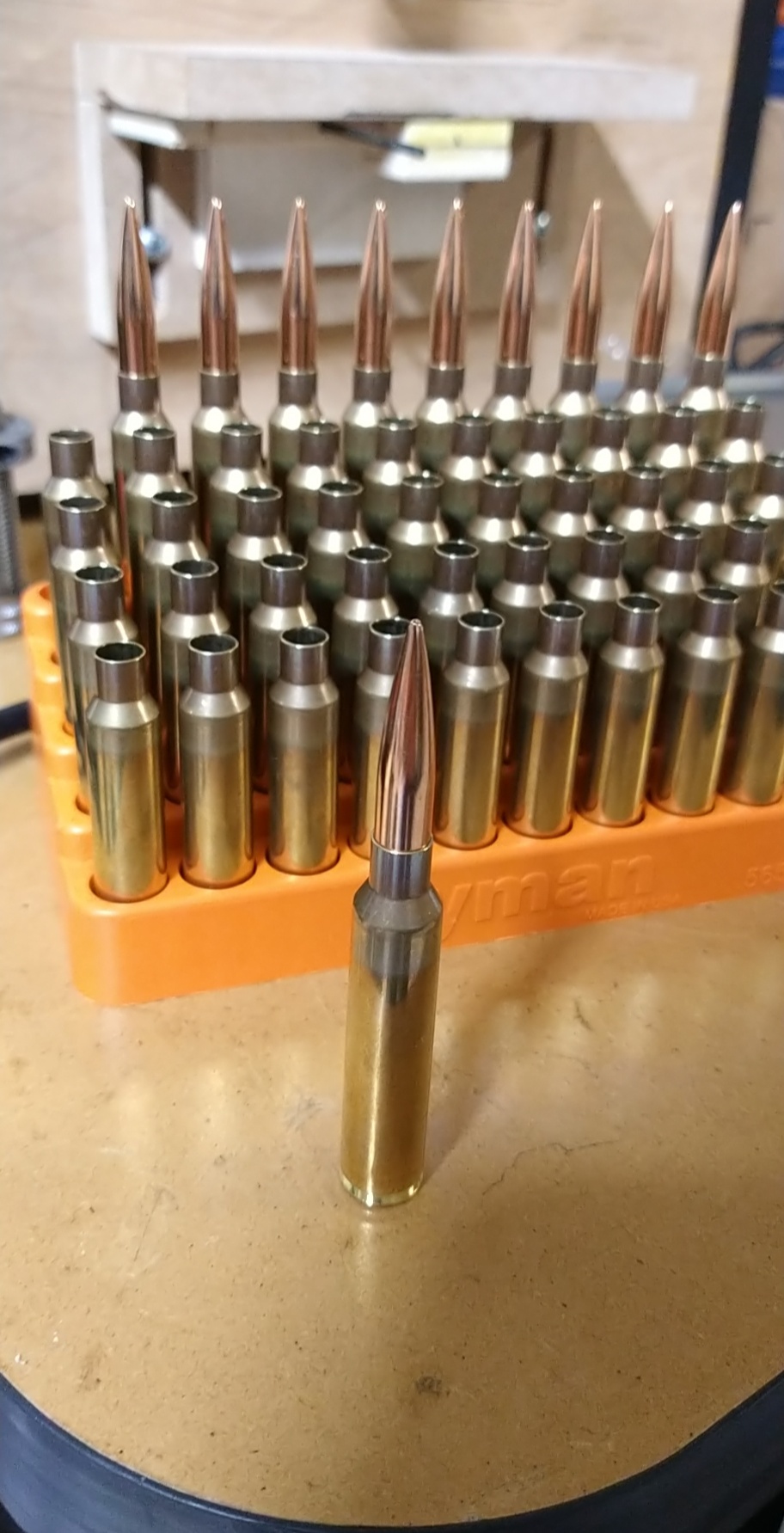

Brownells delivered today...Ran the first 100 of 500 Lapua 6.5CM small primer pocket over the mandrel die, trimmed and chamfered.
Also scored 500 Berger 140gr Hybrid pills.
Realized I'll need a new small pin decapper, which is also ordered.

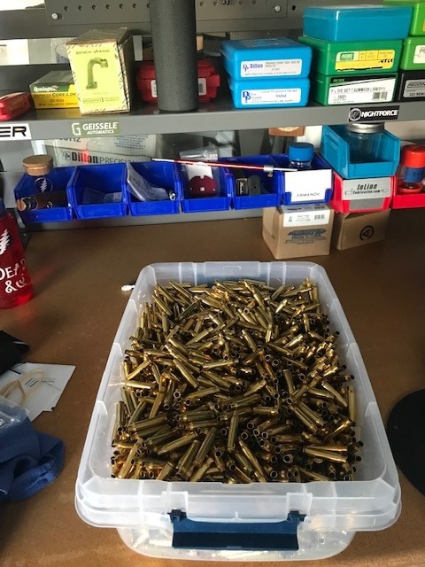

Also pre-tumbled a bunch of brass. I had a bunch of range pick-up I obtained but after running some through the Dillon for decapping I discovered the case feeder doesn't like dirt and bits of gravel. Just a short round prior to decapping and annealing to knock the dirt back and to be kind to the equipment!
I decap on a lee app then tumble to keep the gunk out of ss press or dillon.
Also if there is brass with offset flash holes you don't wreck your "good dies". You can "feel" them on the app press.

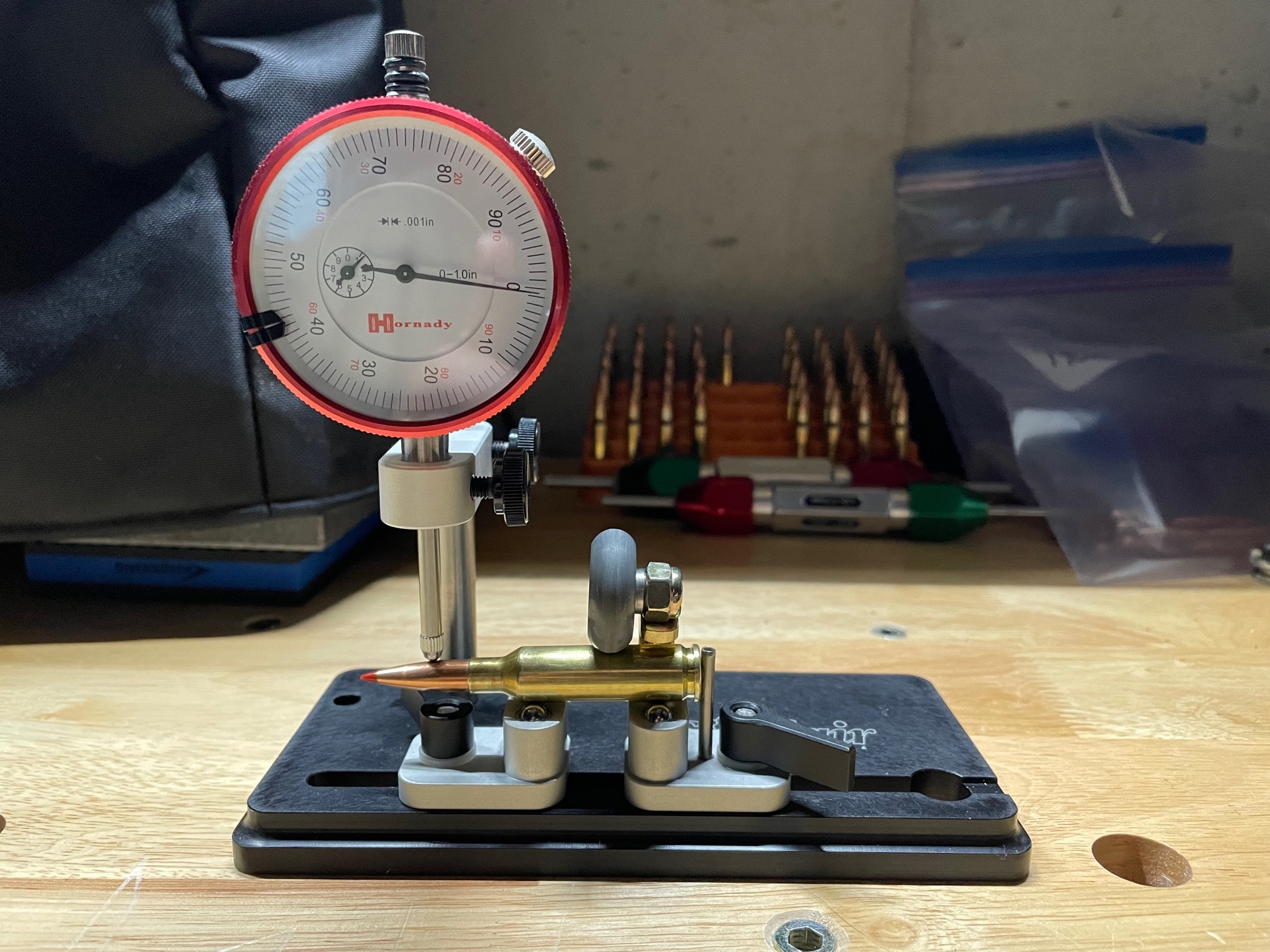

Remeasured my fired ar brass.
Damn.
My new barrel is 1 1/2 to 2 thousands tighter than all the rest I load for.
Last 60 shots have been at a 1 1/2 thousands bump.
No loading, extraction or pressure signs noted.
Was running everything at 5 thousands bump to allow for filthy suppressed operation. Decided to go 3 thousands.
Open for suggestions.
I know that gas operated guns are not the same as bolt action guns. On my 6gt I have 2k shoulder bump ,and it works good on me.
I also would like to know on your bump ,for your brass, as I too have an AR . This is where I learn .
Well I'm not claiming to be an expert.
Conventional wisdom for new reloders has been to start bolt guns at a -0.002 bump and semiautomatic at -0.004 to prevent problems.
There are many posts and videos on how to get the minimum bump for your bolt guns chamber.
As long as your bolt guns chamber is reasonably clean and bump consistent many shooters remove some of that "slop" for better accuracy.
An AR is different in that it is always a work in progress as far as blowback slop into the chamber. A suppressor compounds that quickly.
My sons convinced me I was cleaning my AR's too often.
So ok I did my own acid test.
I ran it suppressed and not half the summer and into the fall. There was stuff oozing out, I had to stop and clean the scope due to residue during shoots.
I was using 3 1/2 - 4 thousands bump. I venture over half a case of ammo easily, no accurate count.
The bcg recived a wipe down and lube occasionally and put back in the slop. Cfe was the powder.
My sons were laughing at my lifelong cleaning fetish.
Along came deer season and decided I wanted to get blood on the AR. Got out late in the season.
Cold crisp below freezing my bcg would not chamber a round.
This was with 4 thousand bump.
A quick clean with oil and a field kit blood was had.
I may continue to shoot my range toy with 1 1/2 thousand bump but my SHTF sbr and all others are staying at 3 1/2 minimum.
Cleaning regimen on that gun reverts back to every session. Three fowlers and it's gtg.
I'm hoping some of the expert's here will offer advice.

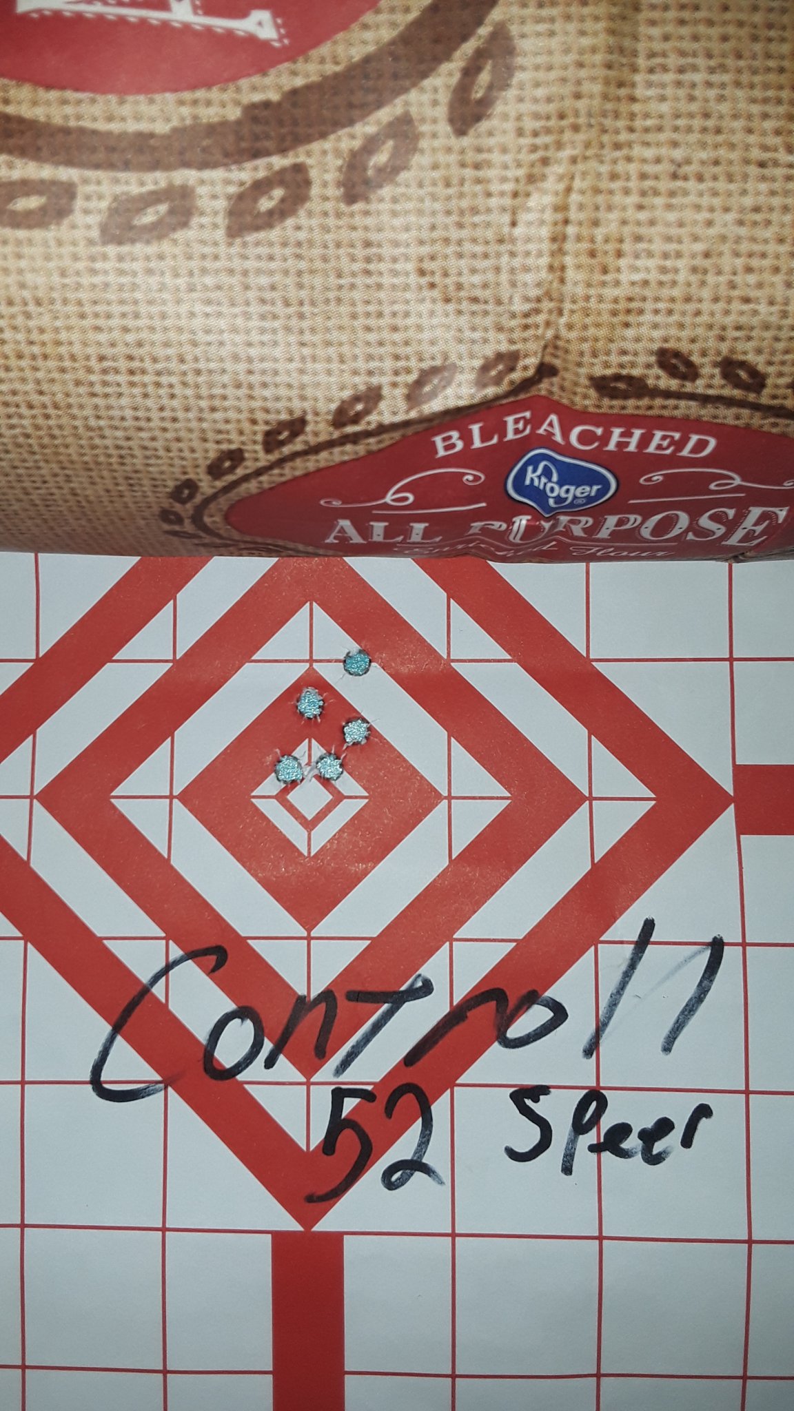

Best of six groups initial ocw test with Bob's 55g and H335.
Always the first round flier per group. Arg

I would just trash the barrel and replace since it's a cheapo but a couple different 52g and 55g loads with bulk / seconds for bullets and two different powders have put up some nice loads. (.3g inc ocw)
I have not yet done .1g powder testing on iether load yet and not tweeked seating yet.
For all intended purpose this ar is a joke. Carefully assembled out of some midgrade parts but the barrel is a 16inch 150$ midway stoner.
My scope is a Bushnell 4.5x18 mil tactical with thick tactical retical. I'm 62 and rickety but not so bad behind a scope and 2 1/2 lb trigger.
Most all my reloading knowledge has come from the hide. Thanks to all my mentors.
The 52g speer load is off my dillon.
Notice my damn first round flier ever present.
I got to figure it out thier killing my groups.

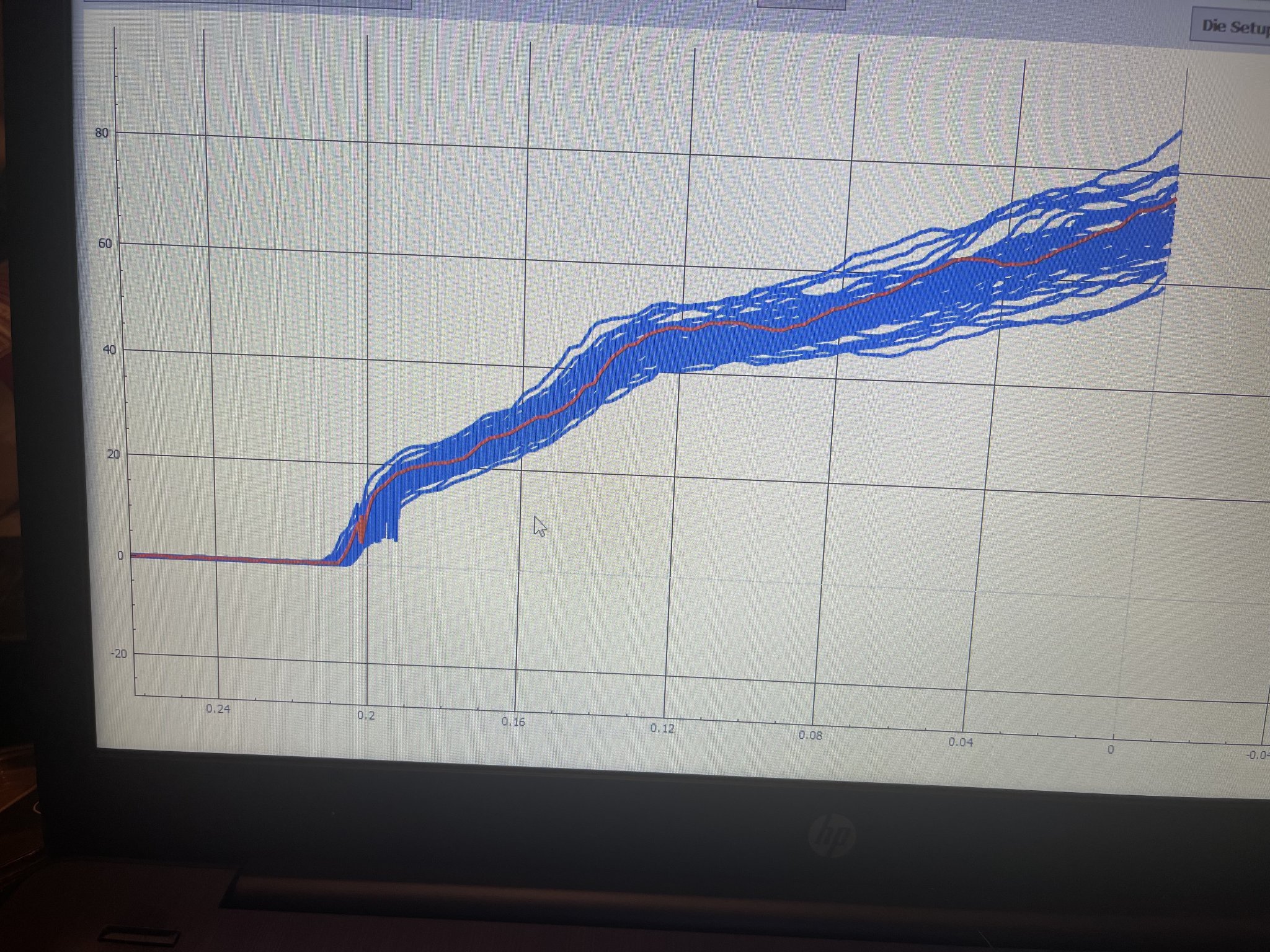

you think is worth the money , in your opinion
For me, yes. Worst case, even if turns out the data isn’t all that practical…..I never have work a handle again to seat bullets.
Multiply that by thousands of rounds a year and it’s completely worth the price for me.

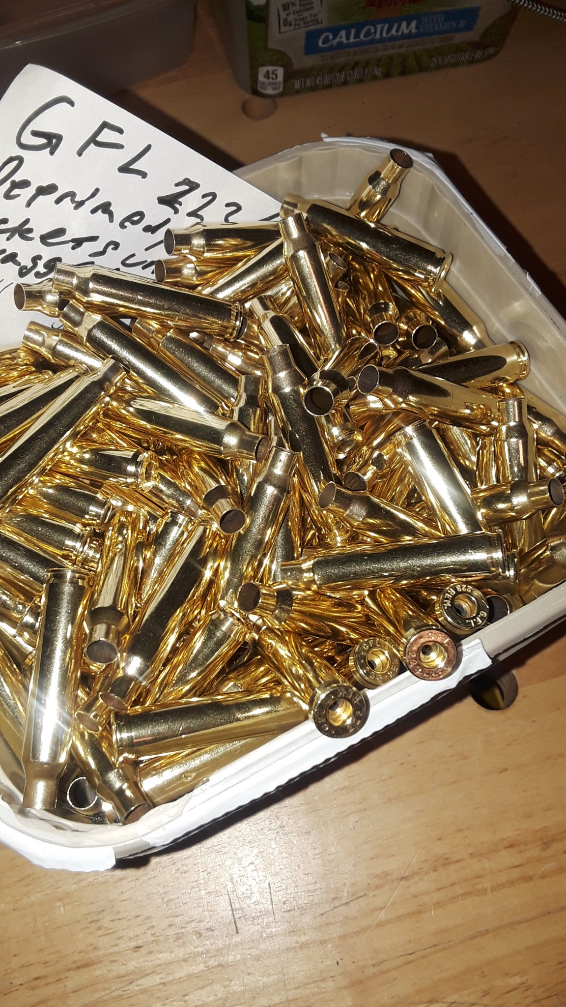

Long day interupted by grandchildren and reloading.
Had 306 pieces of GFL range brass and found 1 more cull. So 305 in the tub. Pockets done and full length sizing finished.
Tumble to get sizing wax off.
Clean uniformed pockets will prime like butter.
Not one flash hole clogged.
Tip: use lizzard bedding wallnut, mineral spirits and nufinish wax, the thing is you have to tumble it long enough to get it to flash off.
The wax will harden on the brass and the material will dry and pour right through a small flash hole. A tap on the basket separator and out it comes.

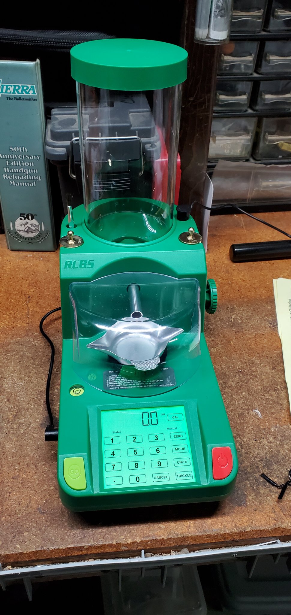

Today I scored A BUNCH of Accubonds, Partitions, Interlocks, and Interbonds for .243, .270, 7mm, and .30cal for CHEAP! I'm pumped about being able to do load development without spending a fortune.
Happy to oblige :). Went back and forth for a good long time on beam scale w/ a trickler vs one of these new fangled things. Sam Millard from Panhandle Precision finally convinced me to try it and I have to say it was a great addition to the bench. Natchez had them for $240. Ive spent more on less lol.
That was a good buy ,I have the charge master 1500 , which I bought here at the hide.
