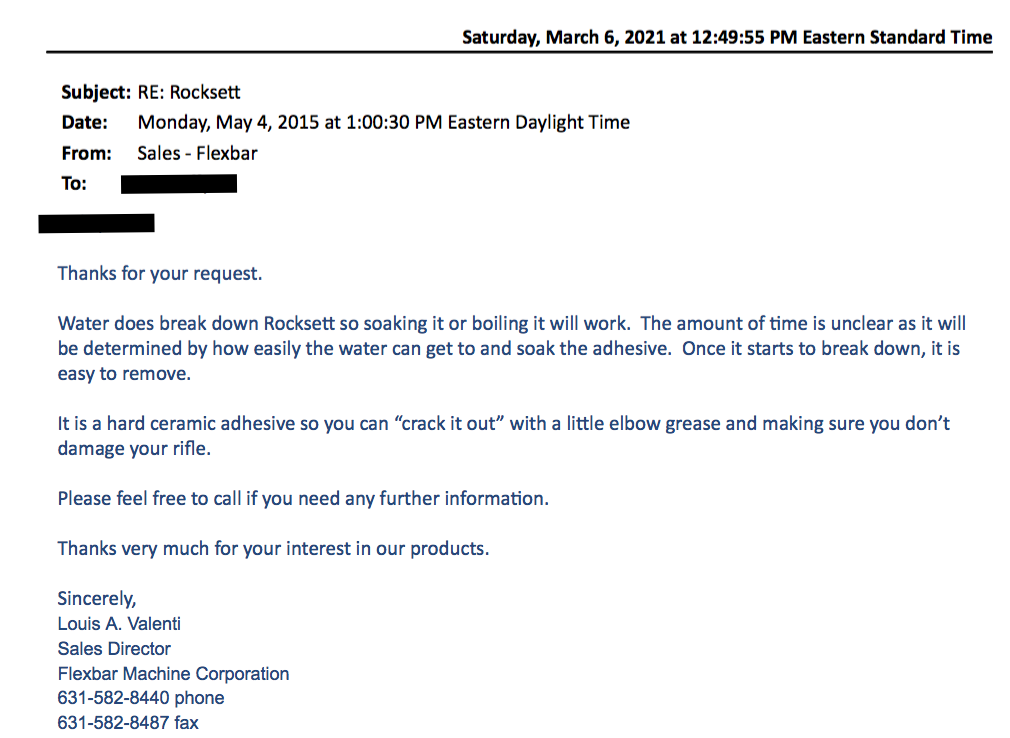

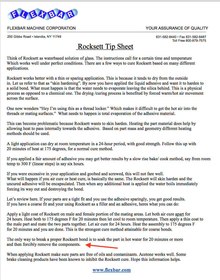

Exactly! That's why I only use Rocksett on firearms. Especially gas block set-screws, and muzzle devices.272 breaks down around 500 degrees, rockset is 2000 degrees. Muzzle devices can hit 500 easily. I have no problem removing rockset it is high temp not high strength.
Probably should have gone with my gut rather than follow the instructions! Oh well, don't need to remove right now anyway!A tiny dot of rocksett keeps it from backing out

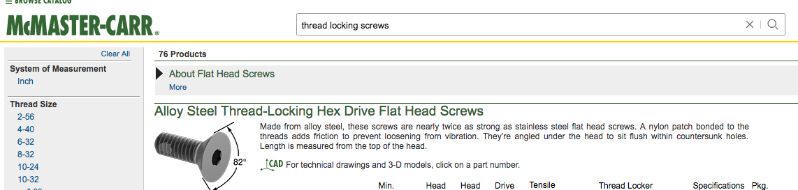

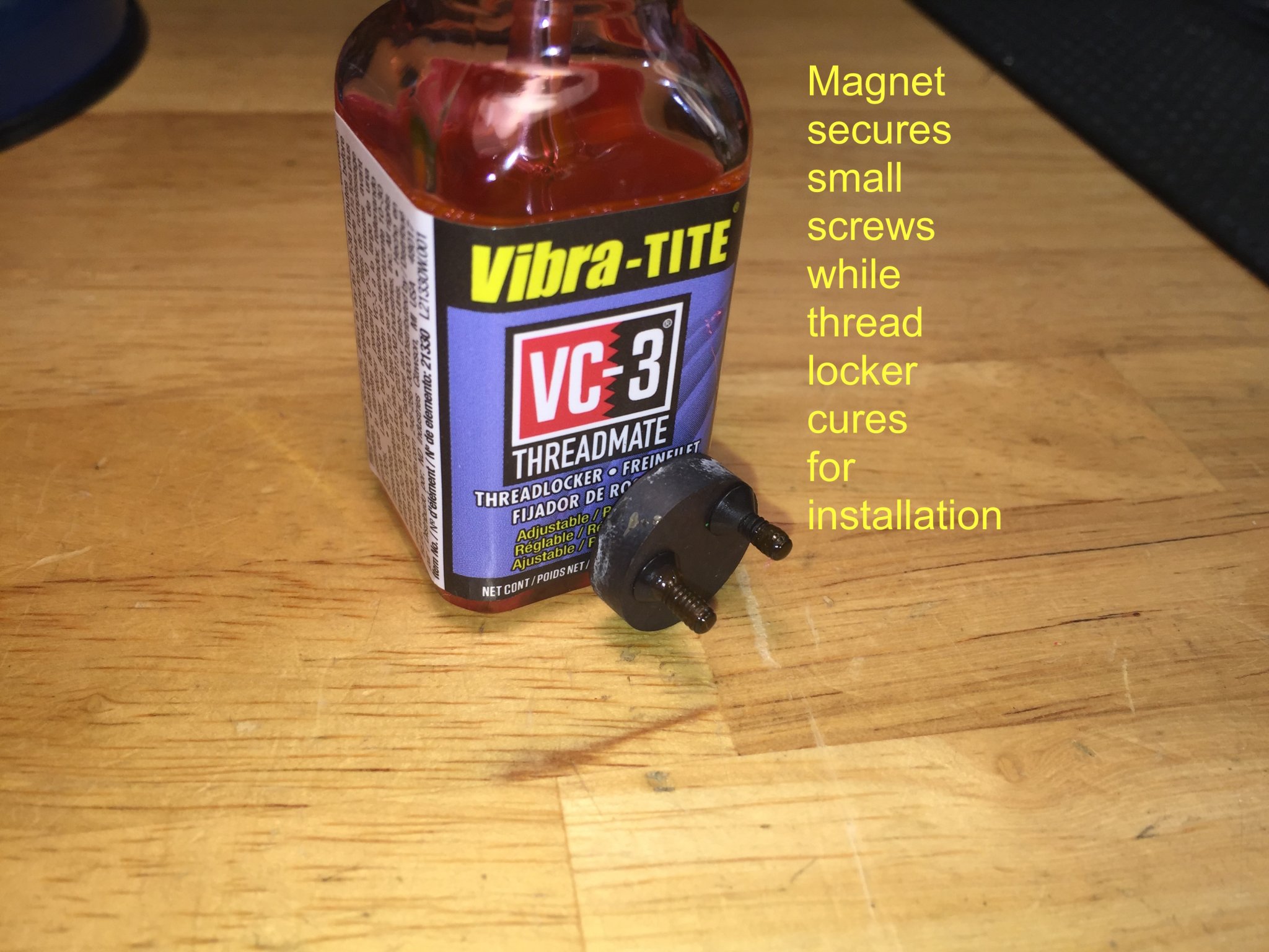

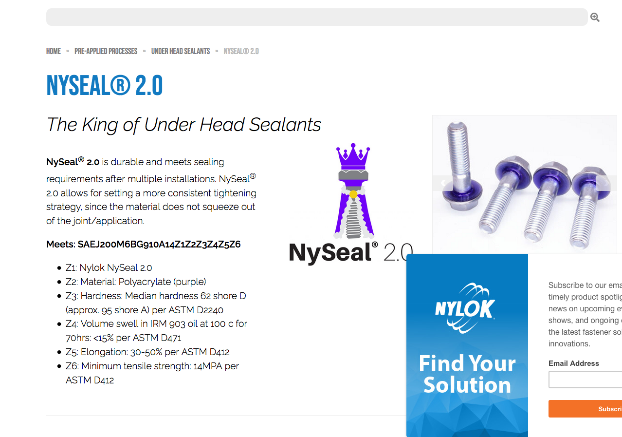

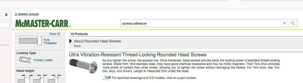

There are a number of different polymer "patches" applied to 180 deg of threaded fasteners, all variations of proprietary Nylok. They function not as adhesives but rather as hydraulic compression to the threaded engagement to resist loosening with vibratory impact, as such they are not heat-sensitive. Vibra-Tite is the working man's version of applying such a method to fasteners on the bench; I like to use a magnet to hold small gunsmith sized fasteners while it cures for installation. Magpul uses the yellow style, M&P uses the red style on their rear sight set screws etc. Not being an adhesive, its useful in applications such as rear sights that might require loosening / tightening as you adjust your windage at the range; usually good for 4-6 adjustments / per fastener. You can order fasteners with the adhesive applied from sources such as McMaster-Carr. As shown, sometimes the nylon is applied under the fastener head, not the threads proper.I was told that yellow thread lock is 3M Scotch-Grip, tough to remove on small fasteners w/o heat

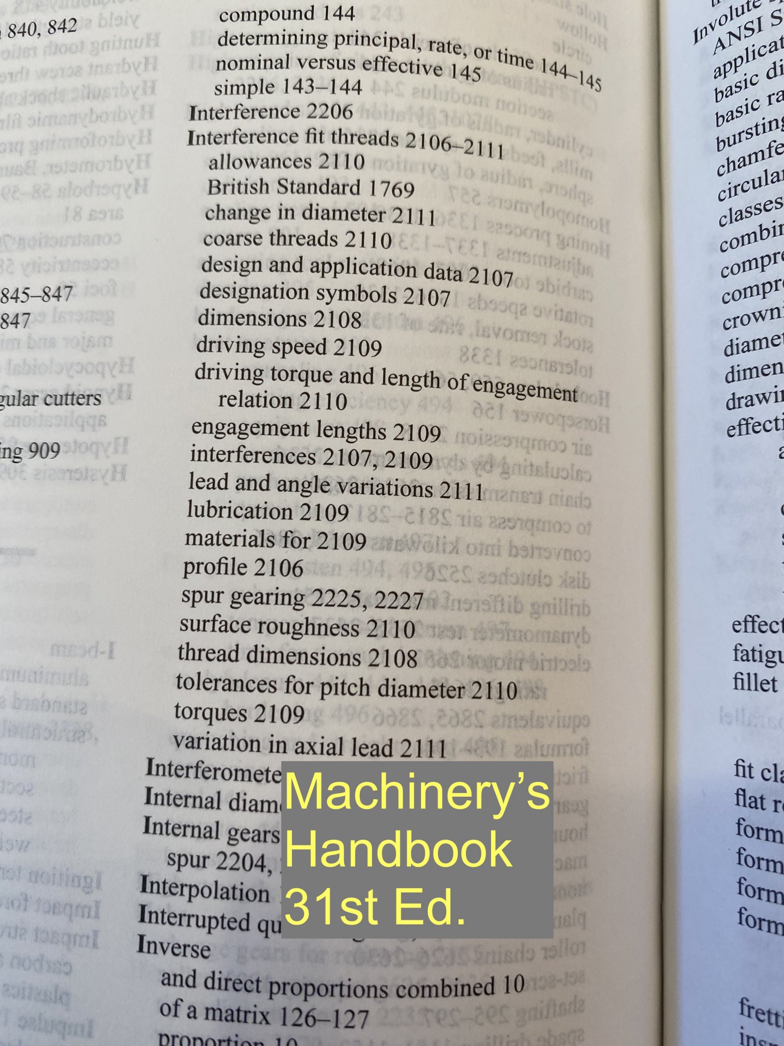

Trust but verify.Might want to look up what an interference fit is in Machinists Handbook. Has a specific meaning.

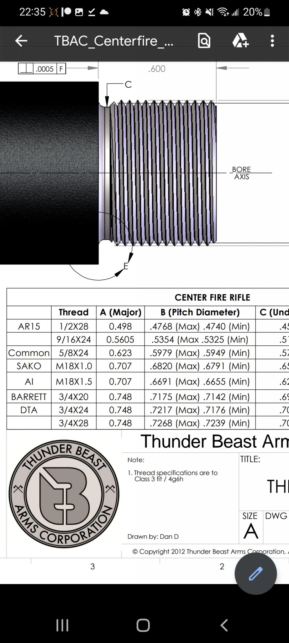

Threads are not cut to a class 5. They are recommended cut to a class 3. Reference TBAC thread page.Trust but verify.

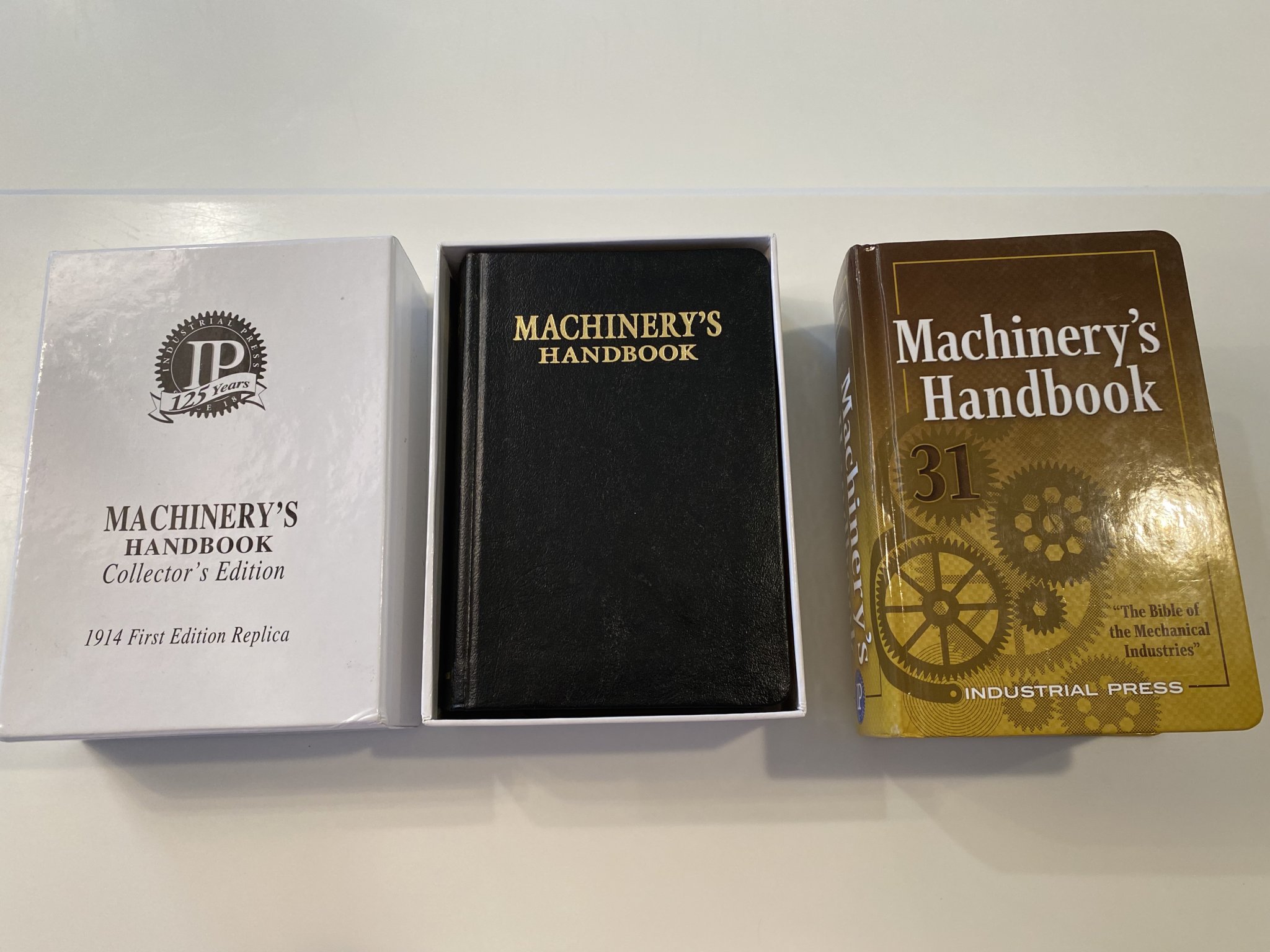

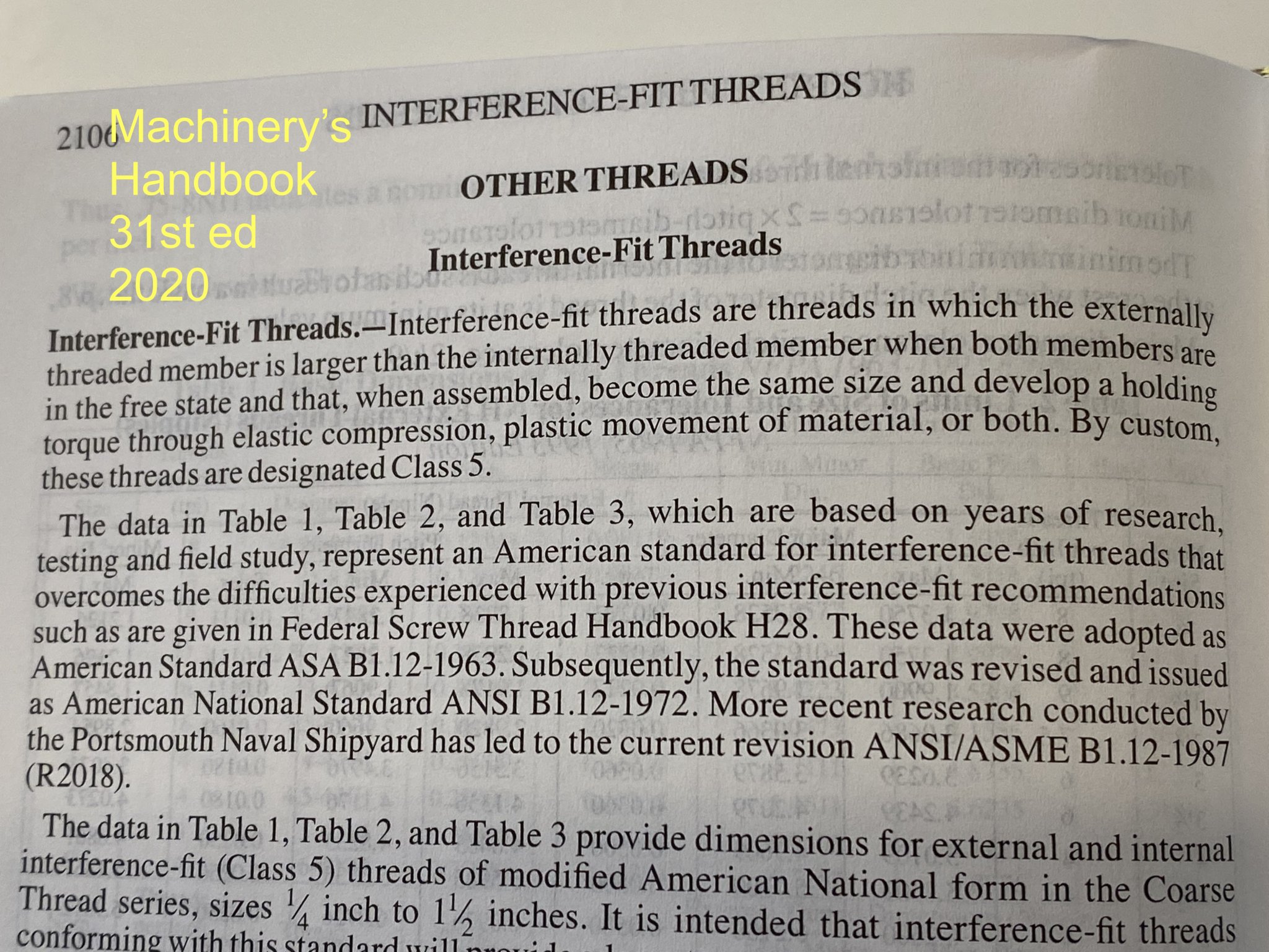

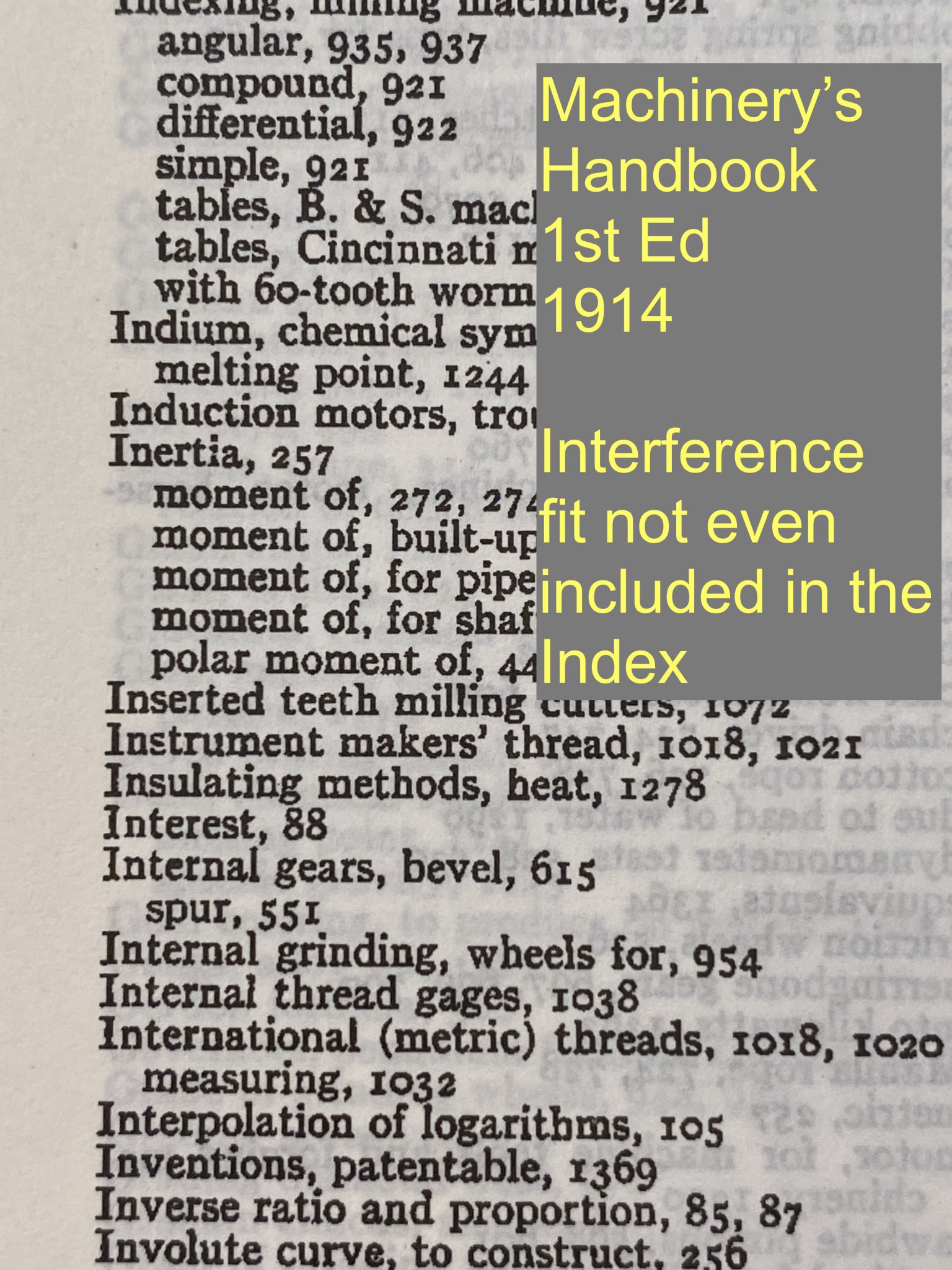

I'll play. To entertain the viewing audience at large this is from my library.
In the original Machinery's Handbook 1914 Edition, the term interference fit was neither defined or referenced. The latest 31st Edition defines an interference fit. A lot has changed.
View attachment 7934882View attachment 7934883View attachment 7934884
Adding something plastic to the thread does not change the tolerances of the thread. It just means the threads are dirty and fit tighter.
Yondering was saying that it becomes an interference fit. That is not so.
