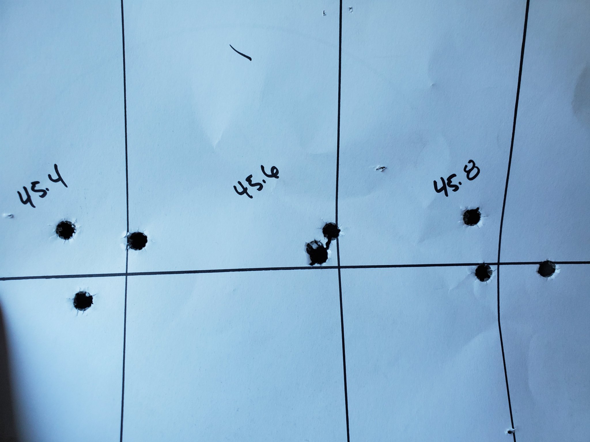

I'm just starting out and with a brand new barrel and caliber for me so i don't have a defined load yet. I can effect generally nice grouping with both pistol and with my .222 varmint rifle.....but definitely need to work on the more profound calibers. I will say the 6.7x47L is much more comfortable to shoot as compared to the .308 which it replaced.
It's all been 3 shot groups of different loads (albeit with the same projectile, FL sized brass and primer) shot prone at 100 yards using a rear bag and an old but satisfactory Caldwell front rest.
A total of 57 rounds were to date shot through the gun.
The first 20 were factory loads during break in as defined by the barrel maker.
I then shot 37 rounds of a ladder development type. My resultant group size seems to be hovering between a very honest .45 inch to .7 inch. 4 of those rounds were fouling rounds which left me with 33 rounds to review.
I have one group that looks promising to me at .45 inch where all three shots are horizontal with just a little air space between the 3 shots. The other groups produced somewhat triangular patterns...and if i understand the process correctly i should focus on a consistent horizontal grouping.
I'm going to try to duplicate that promising load to first of all see if it's reproducible, I will also try out plus minus a grain of powder keeping all else the same.... and subsequently will also try out some small variations around these particular loads with respect to bullet seating depth.
